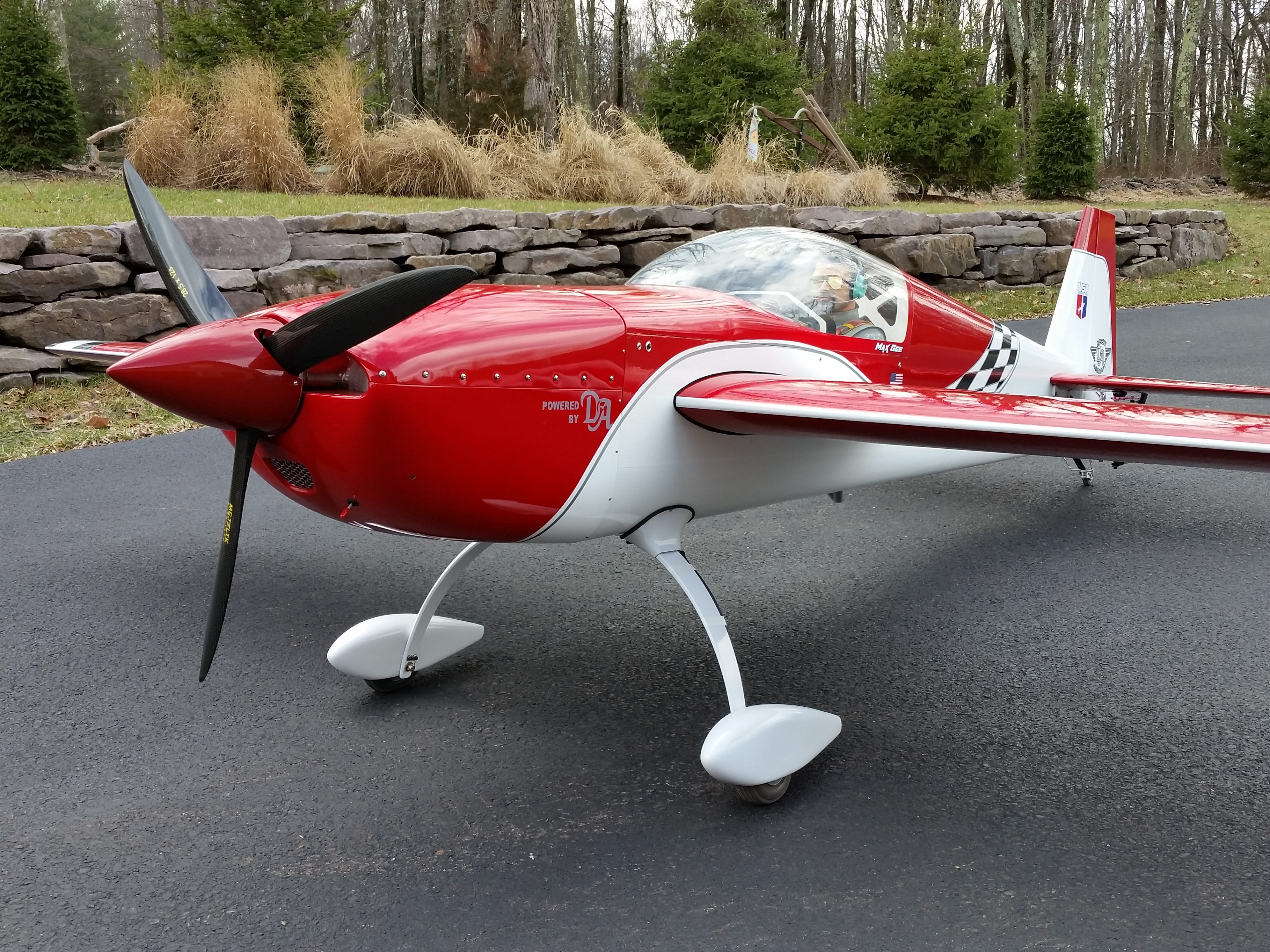

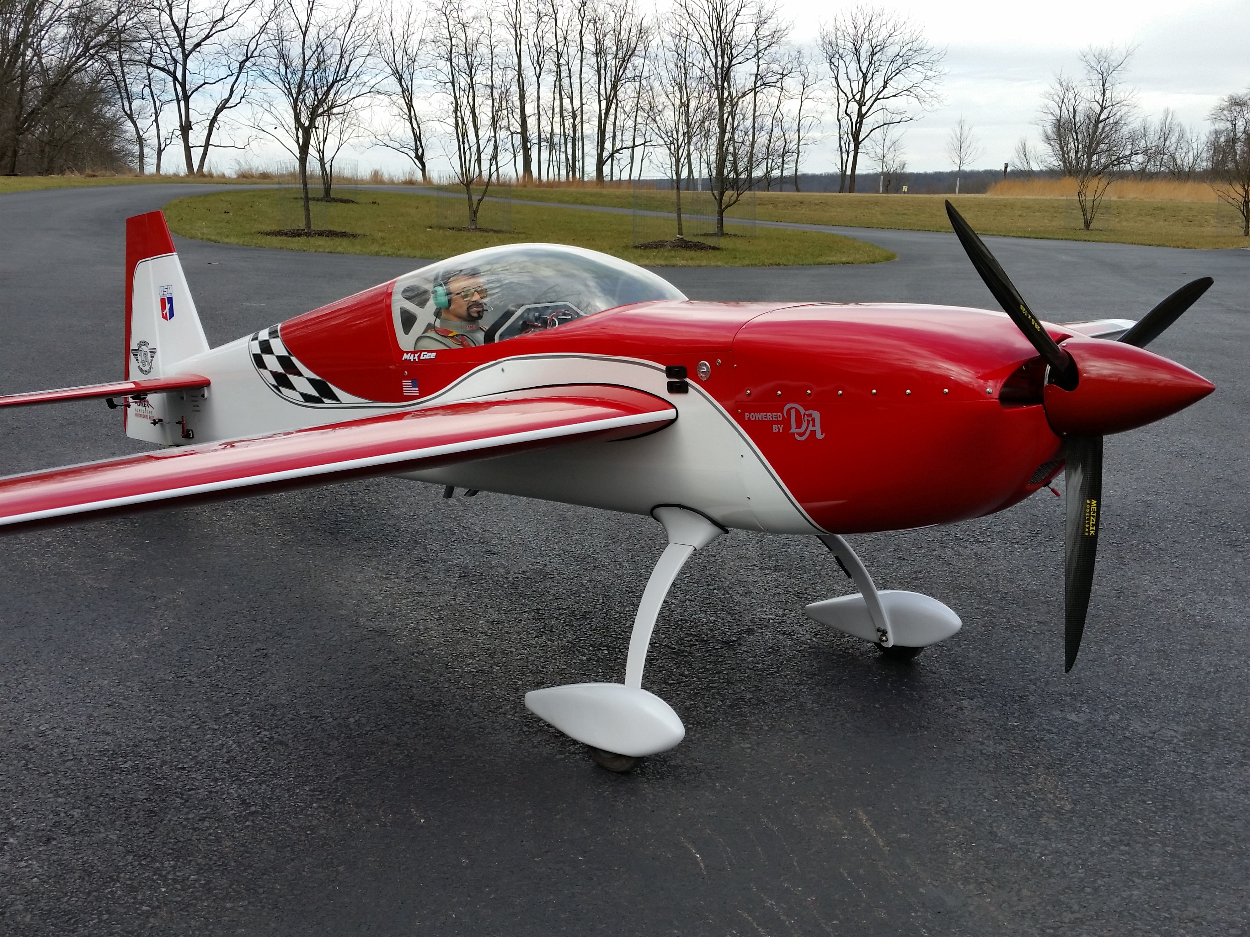

New Pilot for my Carden Pro 124
Like the way you supported the exhaust neat simple and light. Man those things are long it must move CG around a lot.

Yeah.....between the 170 weighing a couple pounds lighter than the 200, plus the pipes running that far back I ended up moving all the switches, regs, Rx's, and batts up front. Batts are two Fromeco 7800mAh against the back of the motorbox. Two Sahara regs, two Futaba Rx's and two switches.
CG is within 1/8" of the middle of the recommended range for this plane.
:fist_pump:
If it didn't get there my other option was bring the rudder servos
forward
outta the tail (push/pull) and make it pull/pull. Thankfully I didn't need to do that!
