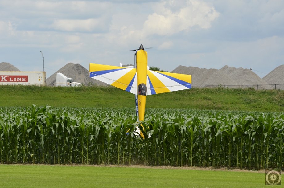

Oh yea, the 210's you had at Corn Huck were AMAZING machines!! Had a blast watching you wring them out:way_to_go:
