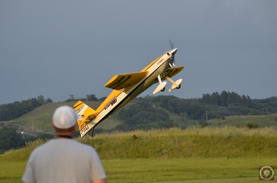

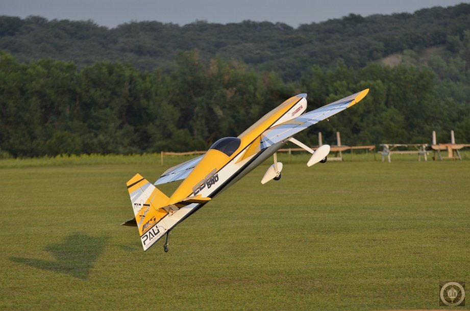

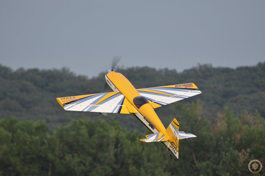

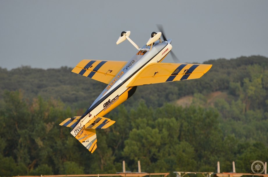

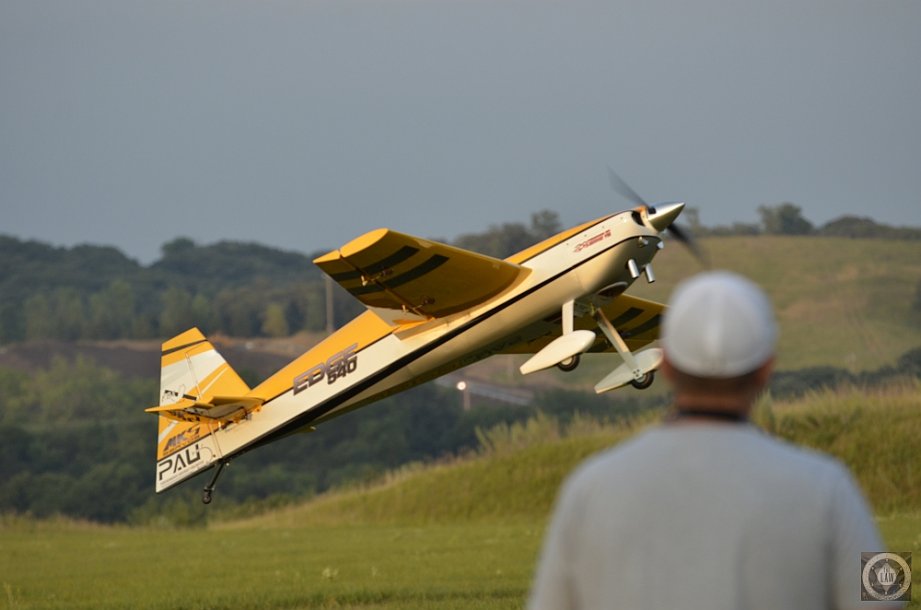

Well we got out again for three more flights, nobody spraying for weeds but the sun was not shining for a great video......oh well, wind was not too bad and we had a blast!!! I got some tail-dragging and on the non-video flight I got a little nose up torque roll just to see how it sounds.
So being an engine guy I want so badly to turn in this low needle just a touch.......but it is running SOOO good and there is not hesitation, there is not overly sloppy mess on the plane and I'm doing it the way Joe told me to and it is working awesome!! I did tune the high needle just a tickle today. It is starting and running nice and we'll push a couple gallons through it as is and then tweak that mid range a bit.
One thing I am noticing is that it starts up great but almost could use a "half" choke setting to fire when I only let it set for 10 minutes or so between flights. From cold, starts no problem. I'll probably dial that in to my TX to make it easier next time out. The rotary valve needs to be a little juicy but not too juicy to start nicely when already warm. I'm digging the smoothness of the operation in the air so far though!
