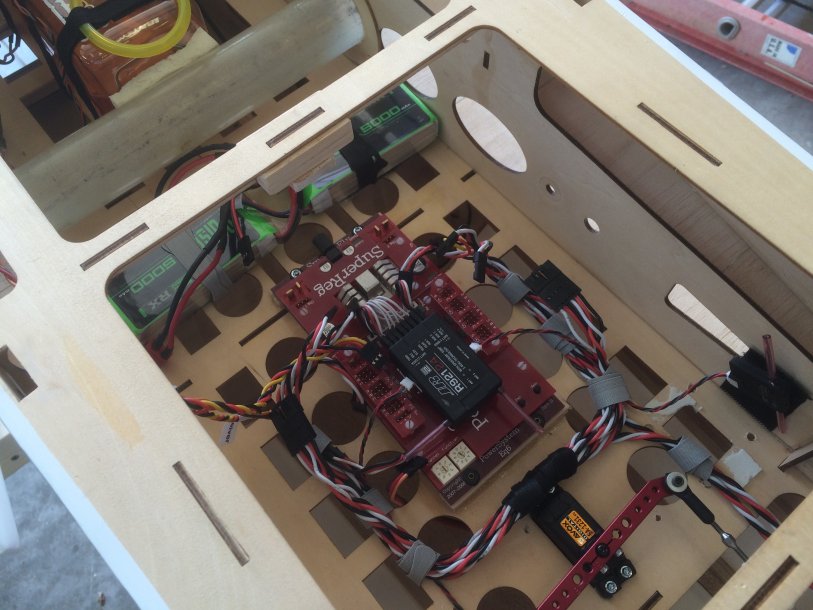

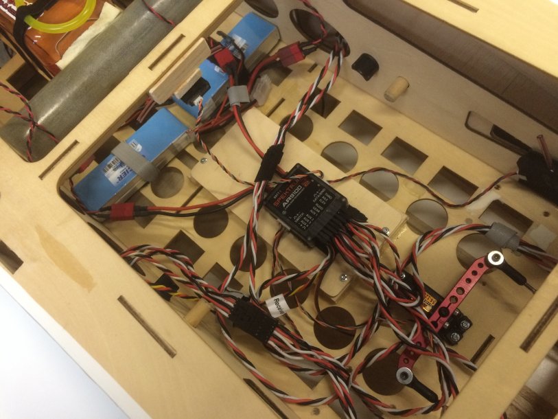

I took the Smart Fly out, put the power safe receiver in and set the plane up again. I just ran out of time to tidy up the wiring. For some reason the wings keep showing up upside down in my pictures. I'll get it right sooner or later. :)
