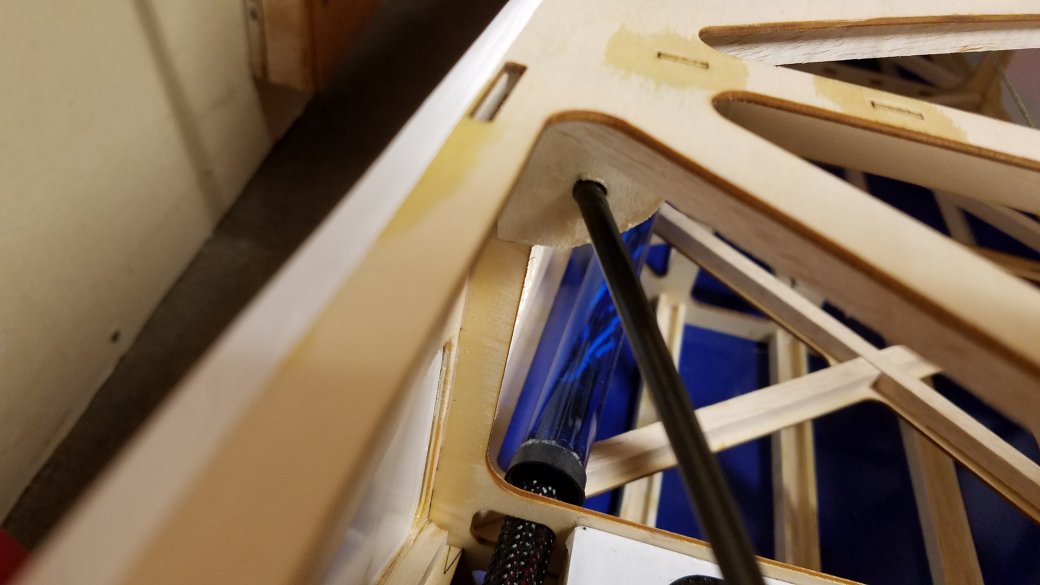

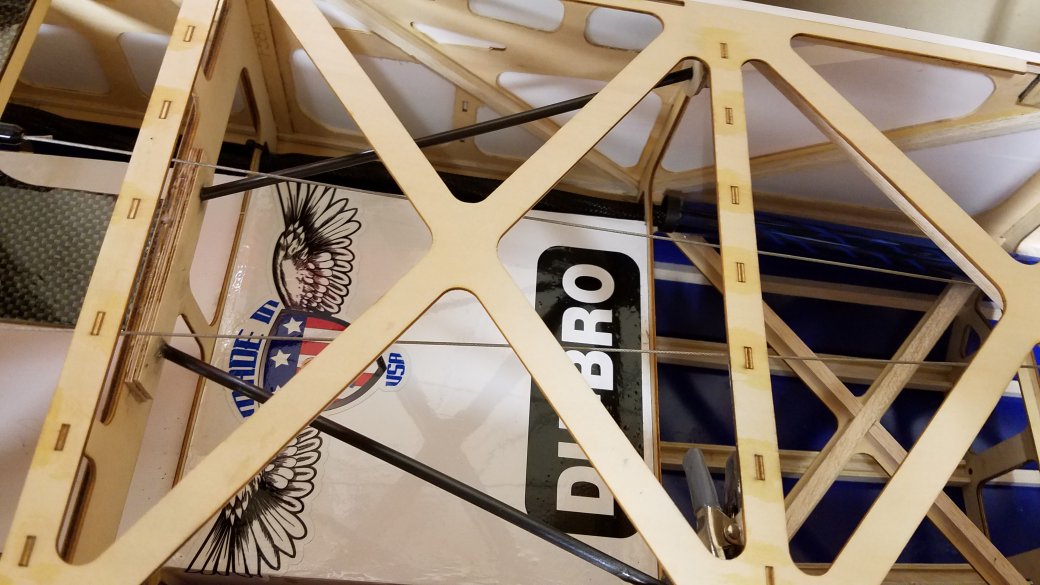

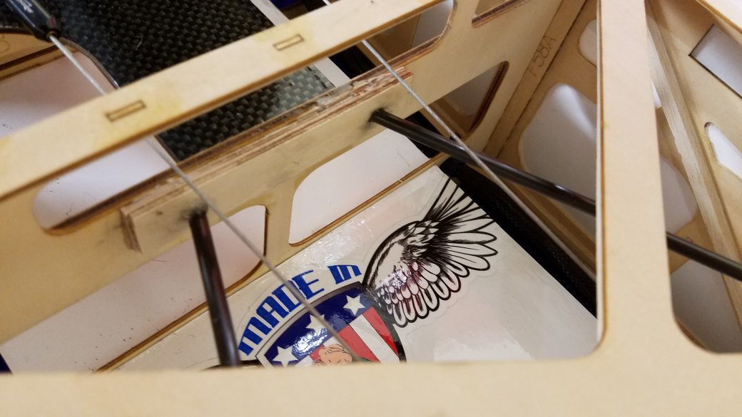

@Tavis is building a 122" Pilot RC Extra, as well. He's 3/4 of the way done. He's got 18 servos in it @Terryscustom , haha. Anyway, he noticed something about the rudder tray... that even though the tray itself is stout... what it is mounted to is not. He told me he could move the whole tray 1/8" by pushing down on the pull/pull cables. When I got home from work I checked mine and it was a little worse than his (presumably since I have already flown mine). I'm wondering if this is why I always thought these planes hunted around on knife edge? Anyway, we both fixed it with carbon fiber rods... I went one former back and he went two. It don't move now. ;)

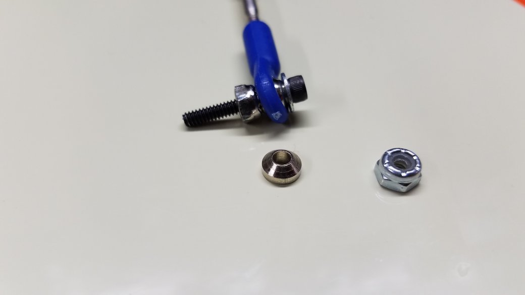

Some trivia... I've stopped using conicals for the most part. I'm using locknuts now. :)

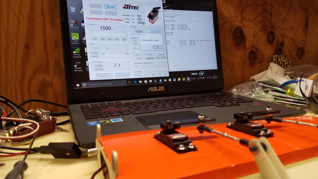

I also decided to program my Hitec brushless elevator servos on my Sukhoi (for whatever reason). I used the Brushless Programming dongle and software program. It has a "RC Mode" feature where you check with your radio whilst you're programming. I didn't notice it until I was done so I'm not sure it is WYSIWYG, but I'm excited to check now.
Tavis's plane is completely different. It is my big aileron thin wing, thin tail section extra so it requires lots of servos.
The only time I ever noticed one of my 6 Pilot Extra's hunt on KE is when I had it to tail heavy. The Pilot Extra does not need to be tail heavy to fly all out 3D. In fact mine are all just slightly nose heavy.
