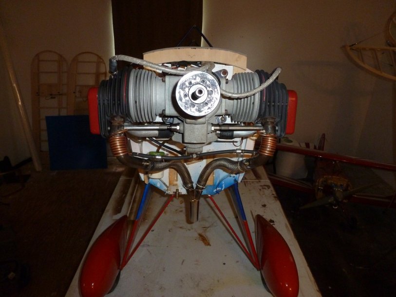

On the other site a fella gave me an idea of sealing the end of the tube and drilling a whole on the side for injection. That is what I did, inserted it 1/4" and brazed it in position then wrapped it eight times. This should be about as good as it is going to get.

Should work good. Forgot you were running a four stroke somehow. Injecting the oil close to the exhaust port shouldn't be an issue like it can be on a 2 stroker. I have heard of drilling several very small holes to get more of a spray than a dribble. I have thought about just smashing the end flat to get it to spray more. Never actually played with a smoke system yet, though.

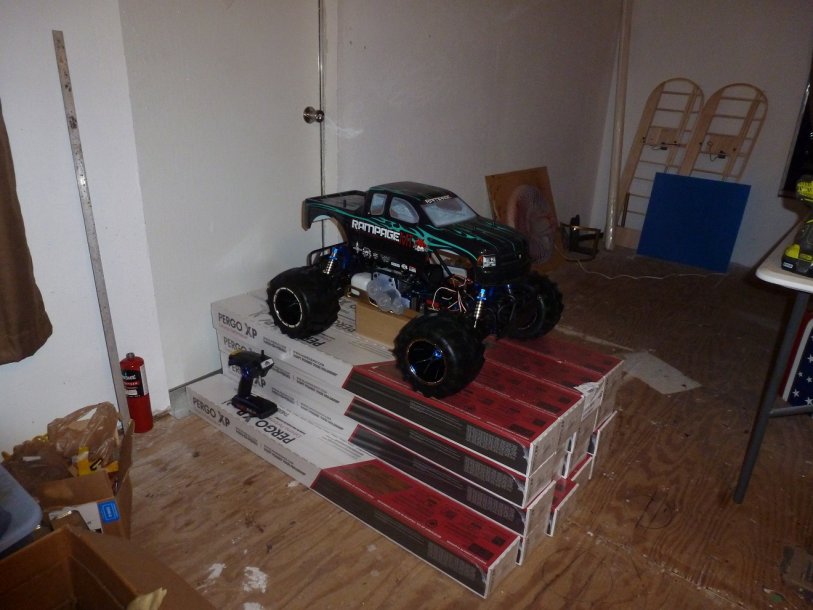

Lookie what I got for my birthday, Saaaaweeeet! It is a 32cc Rampage from Redcat Racing, I haven't ran it yet but it look's to be a monster.
