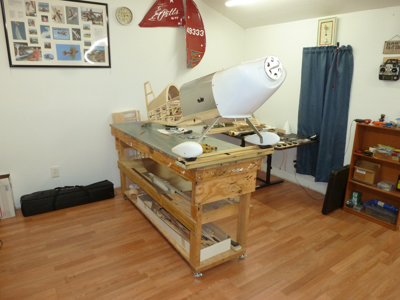

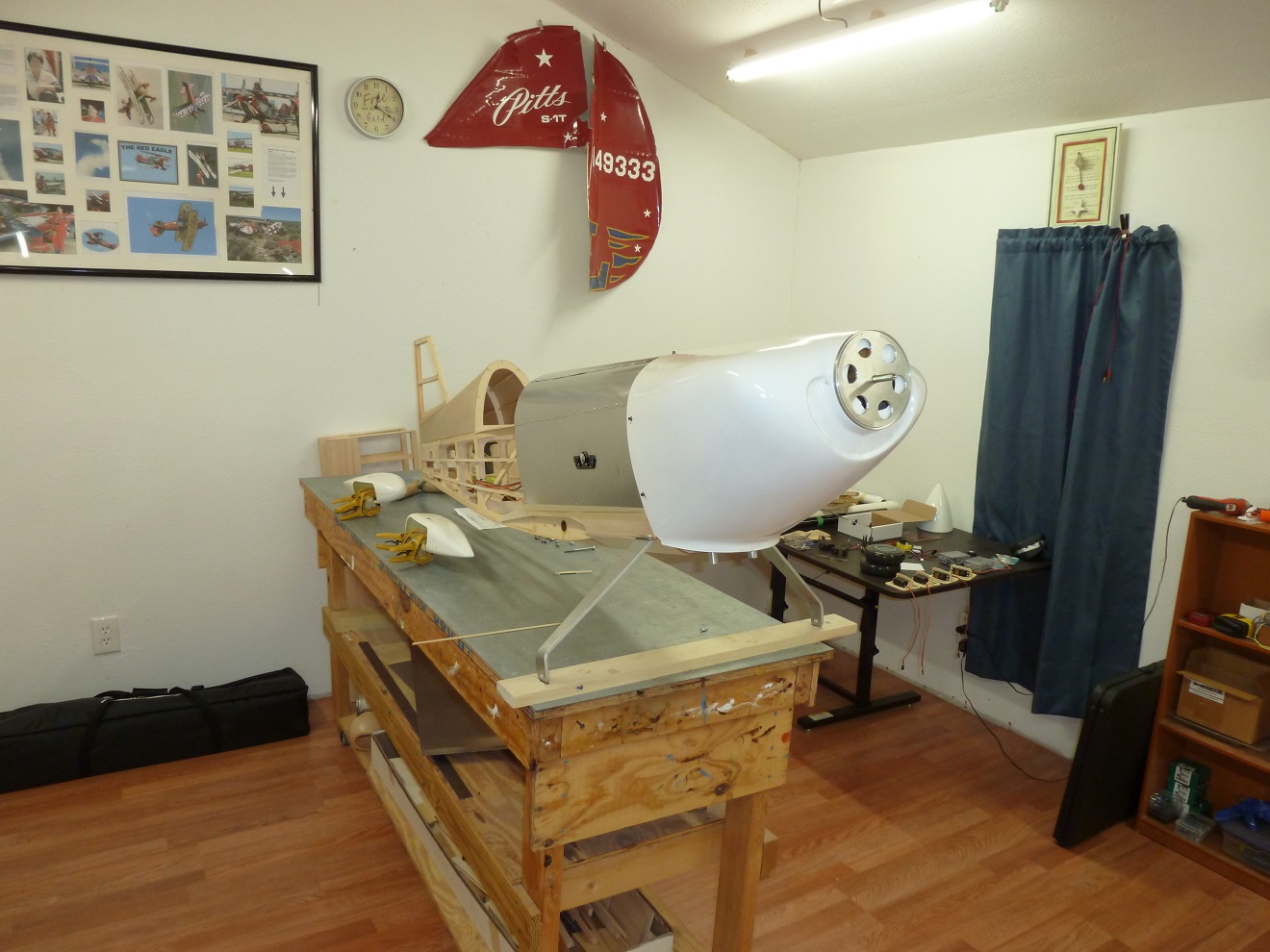

Been doing a little work on the Challenger the last couple of days. Did some changing out of the electronics, switched the 14 channel Rx for a 3 channel with SBUS and using one of the X10's from Xtreme Power Systems. The removeable panels for the nose are done and the cowl is mounted. I am currently working on getting the pants set up with their hardware.
