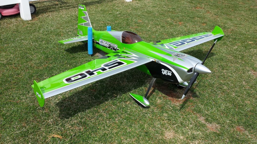

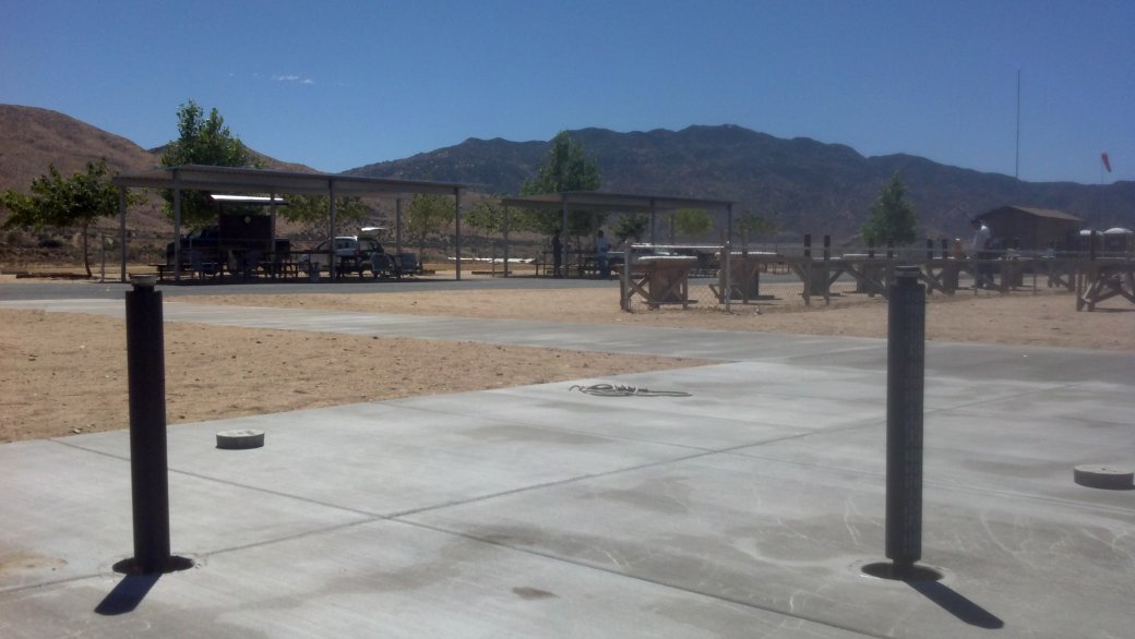

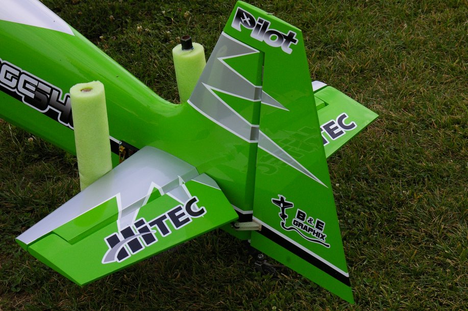

We have pipes in the ground that accept conduit with pool noodles. Very quick and easy to use. We are planing to add some larger wider spaced ones for holding the wings on planes larger than 35%. There are bricks buried flush with the ground between the pipes so you can locate them easier. If not the clover will hide them very quickly.

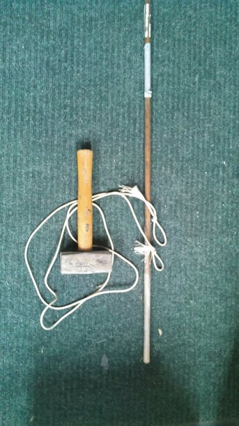

At my home field the club put together a start up pad for those of us with big planes. For here at home I just use a long metal rod pounded into the ground with a nominal length of some parachute cord looped around the tail with a slip knot,,, so long as the engine is at a low idle setting there's no issue while removing to go fly. I've used this in a pinch or 2 when out flying by myself in other locations.
