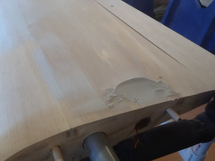

    Here's an example of when it gets to dry to spread easily.

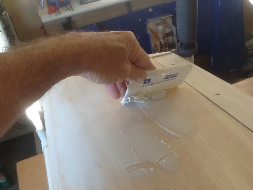

    Here's what we're after. I did the entire upper portion of the 103" wing in about 30 minutes. The sanding will be minimal because with the water, the spackling has the consistency of mayonnaise and fills holes, and indentations while the rest of it scraped off.

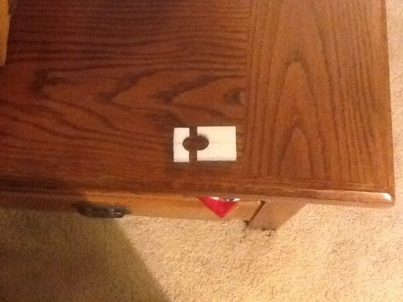

    Now for the good stuff. I went to a skylight manufacturer and they gave me three small pieces of a white plastic. Each piece is 1/2x 1x 5". I got it to use as the attachment for the gear doors to the struts. I drilled a hole in it that matches the diameter of the strut then cut it in half. A couple of holes and a couple of screws put it back together, locked on the strut.
    Here's a picture of what I'm talking about. The large end goes against the gear door, the small end is the cap. When screwed together, a pair of them should do the job.
