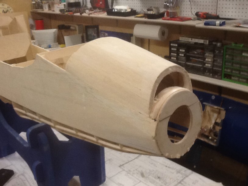

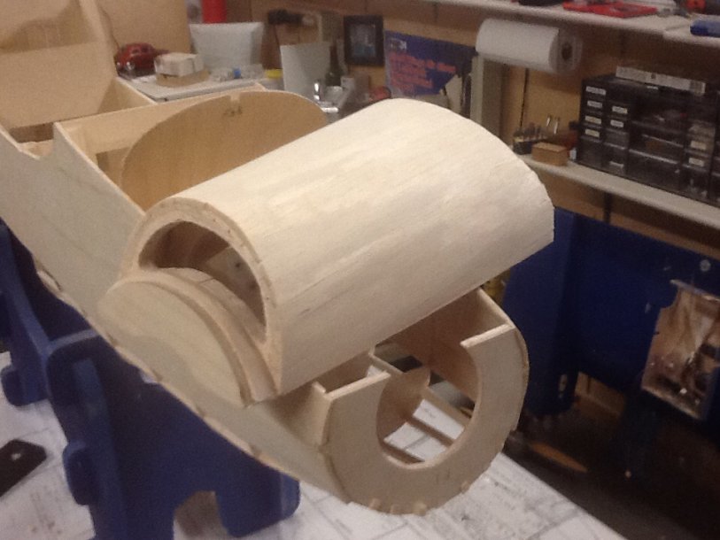

Here's a couple of pictures that show the results.

I haven't had a lot of time to work on the Mustang the last couple of days, but this morning after some much needed yard work I decided to do a little experiment. I came into possession of some scrap 1/4inch MDF. For those of you unfamiliar with that product, MDF stands for medium density fiber board. After "finishing" the lower cowl, you have to build hold down brackets under the front end just behind the spinner ring (F1). I was wondering if MDF was suitable for this purpose since I already had some. Here's what I found out. Yes, and no. The first thing I did was take a small piece of balsa and glued it the end of the MDF with thin CA. I let it sit for a couple minutes and then with just a tiny bit of pressure it snapped off clean. No MDF stuck to the balsa and no balsa stuck to the MDF. Hmmmm. Doesn't look good. Next a drilled a couple of 3/16ths holes and tapped them 1/4x20. I soaked them with thin CA and re-tapped them. Beautiful, sharp, clean threads. Using a nylon bolt, I couldn't strip the the threads using normal effort. I wanted to know what the braking point was, so I screwed in a steel socket head cap bolt and tightened all the way down. I grabbed my big wrench and with some considerable effort the threads gave up. Way more than you would ever use on a plane, and certainly more than a nylon bolt could withstand.
Next, I took some medium CA and glued a piece of balsa to it. I let it sit while I put up the mower and cleaned up some of my mess. When I tried to break the balsa off the MDF, the balsa broke leaving wood stuck in place. The only way to get it off was to sand it off. If the glue joint is harder than the material you're working with, it's sufficient.
So, there you have it, my 30 minutes of experience using MDF in model building. Oh, yes, I'm going to use it for my hold down brackets.
Red Raider
Ok, now I have several hours experience with MDF in modeling. I hope no one went out and bought any to use on your next project. I built the hold down plates like I said I was going to. When I trial fit the cowling, they were off by an 1/8th. That's way too much. I was wondering how I was going to get them out without tearing something up. I grabbed hold of one to give it a little tug and it came off in my hand. So much for its usefulness. I threw all the pieces I had in the trash.
