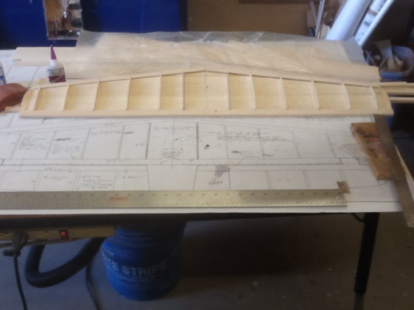

Here's the tail on the building board. I've never had parts that fit that this poorly from the parts sheet to the plans. Oh, well. That's part of the joy of building from nothing.

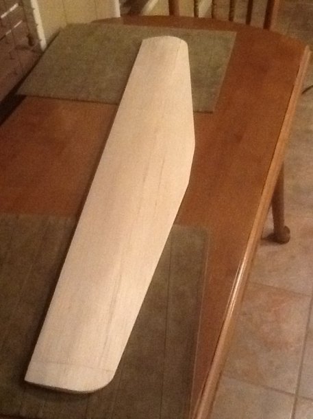

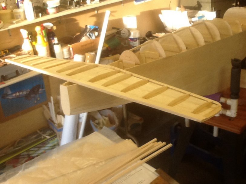

Here it is after I sheeted it with 1/16th balsa. That's only the bottom half. You have to put ribs on the other side then sheet it. But you have to attach the vertical stabilizer first. This is going to be interesting. It got too late to start another part tonight. So, maybe I'll get to that tomorrow.

I didn't realize until I built the vertical stabilizer why the plans call for building the empennage in halves. But, last night as I was putting it together, i realized that it would be difficult if not impossible to get them accurately square if they were completed. They both taper to the tips and using a square would not be possible. Having a flat side on each stabilizer makes it easy. Pictures to follow.

I spent last evening meauring and calculating and re-measuring to make sure that I have the horizontal stabilizer straight. It took a lot of sanding and then building back up what I just sanded off to get the saddle for the stabilizer so that I can set it place and it's straight. There are a few things that don't have to be just right on a plane like this, but then there are things that have to be as close to perfect as you can make it. The empennage is one of those things. My brother and I have toiled over things like this for years. we'll be building a new plane and one side of the tail is 1/16th off. Invariably, one of us will say "that's not close enough". The other thing is the CG. I built a P-40 exactly according to the plans. It was so tail heavy that I nearly lost it on the first flight. Took 3 more flights to get it sorted out.
