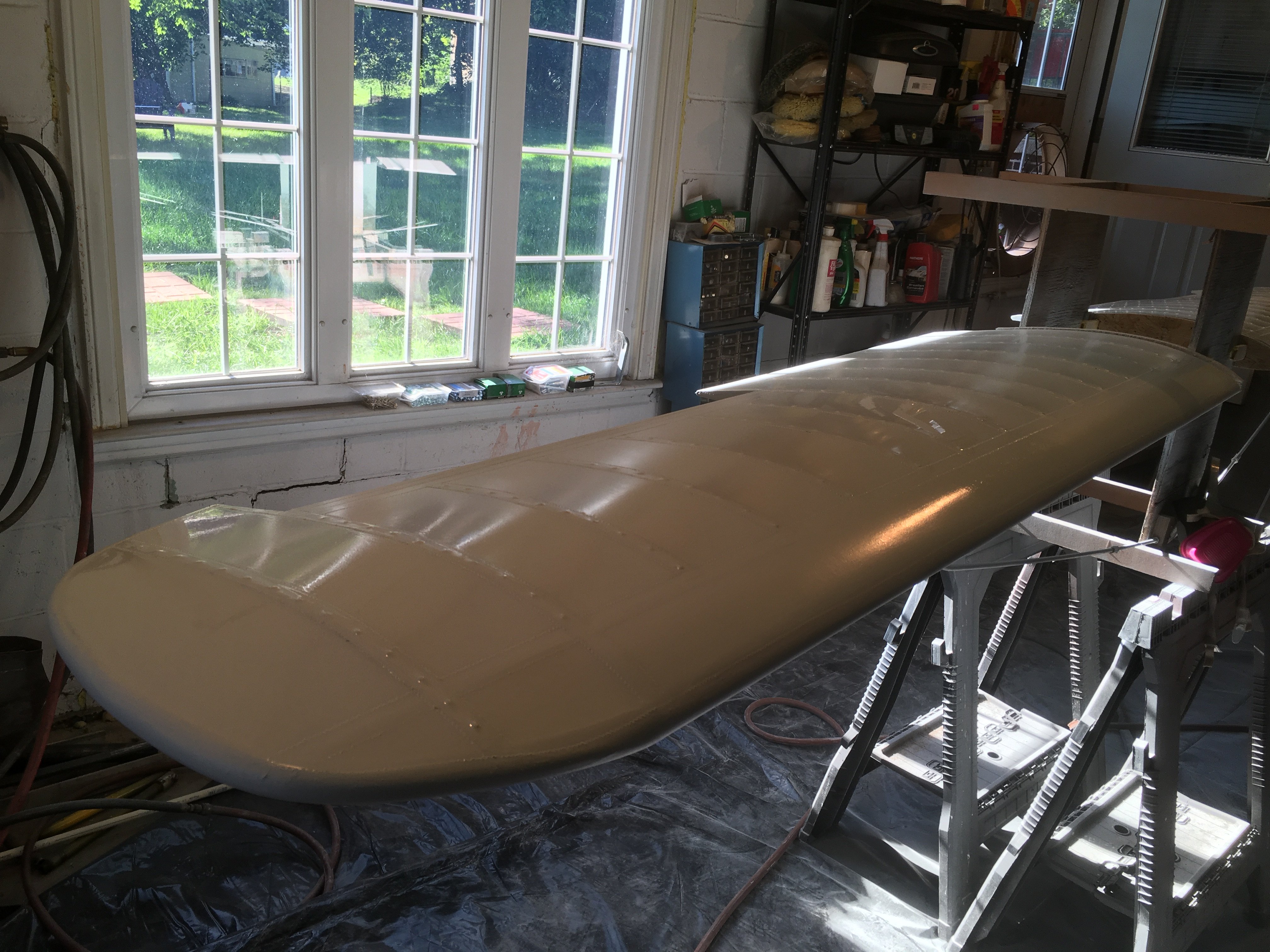

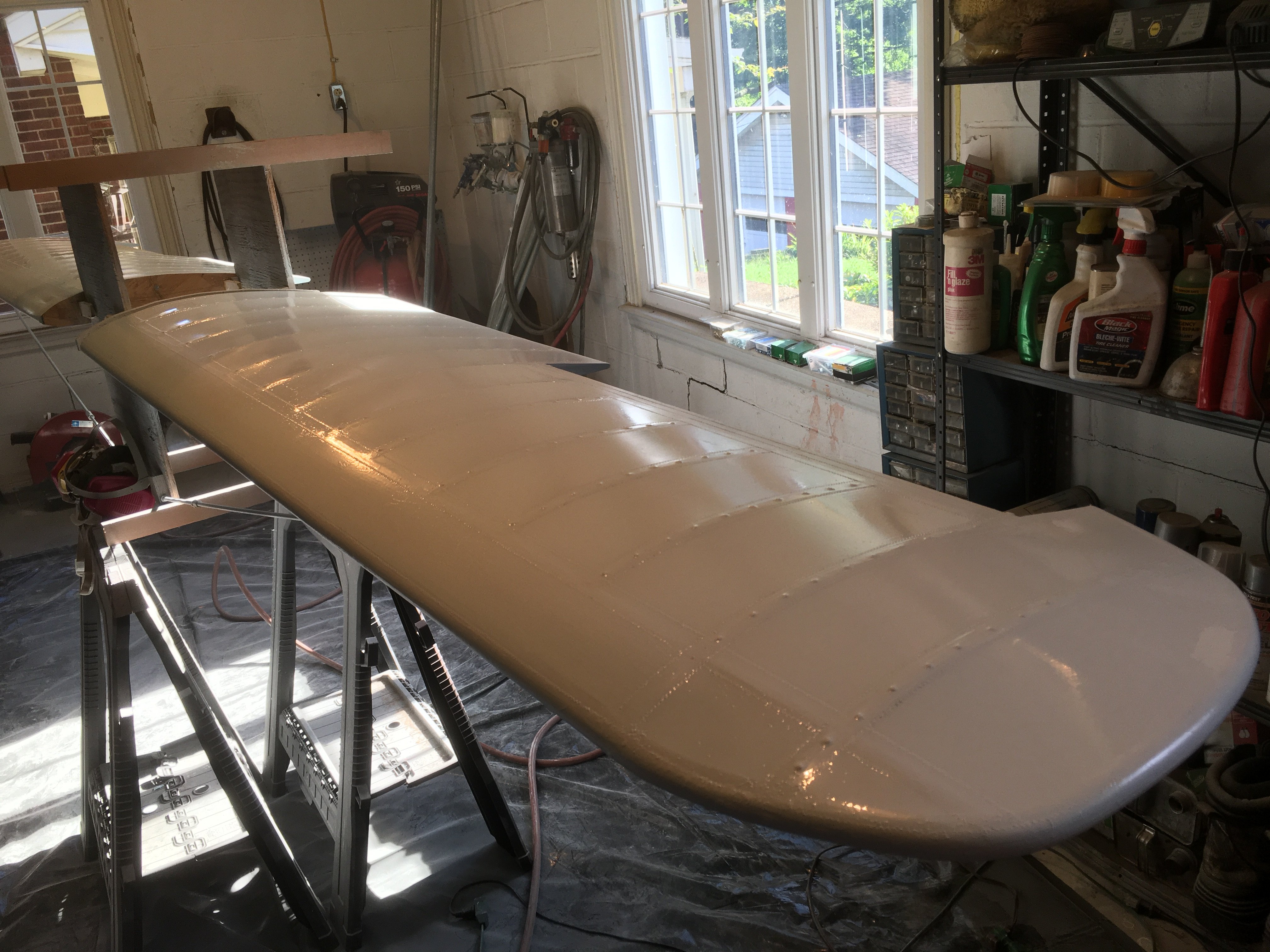

  3. Put two coats of Ekoprime on the wings today and ran out of primer. I had bought 1 quart of primer and discovered it was not enough to do the wing. I ordered another quart that should finish the plane. The primer really brings out the flaws. Need to sand the imperfections with 320 open cut dry paper. The primer does sand easy so by time the primer arrives it should be ready for final primer coat and paint. Based on the primer usage I ordered a second quart of 7AC yellow as well.
    Bottom line here is the wings will not be painted this weekend.
    The water based paint dries slow so I spend most of the afternoon putting on two coats. Paint a little, cut a little grass. All in all I'm happy so far, and no smell to deal with.

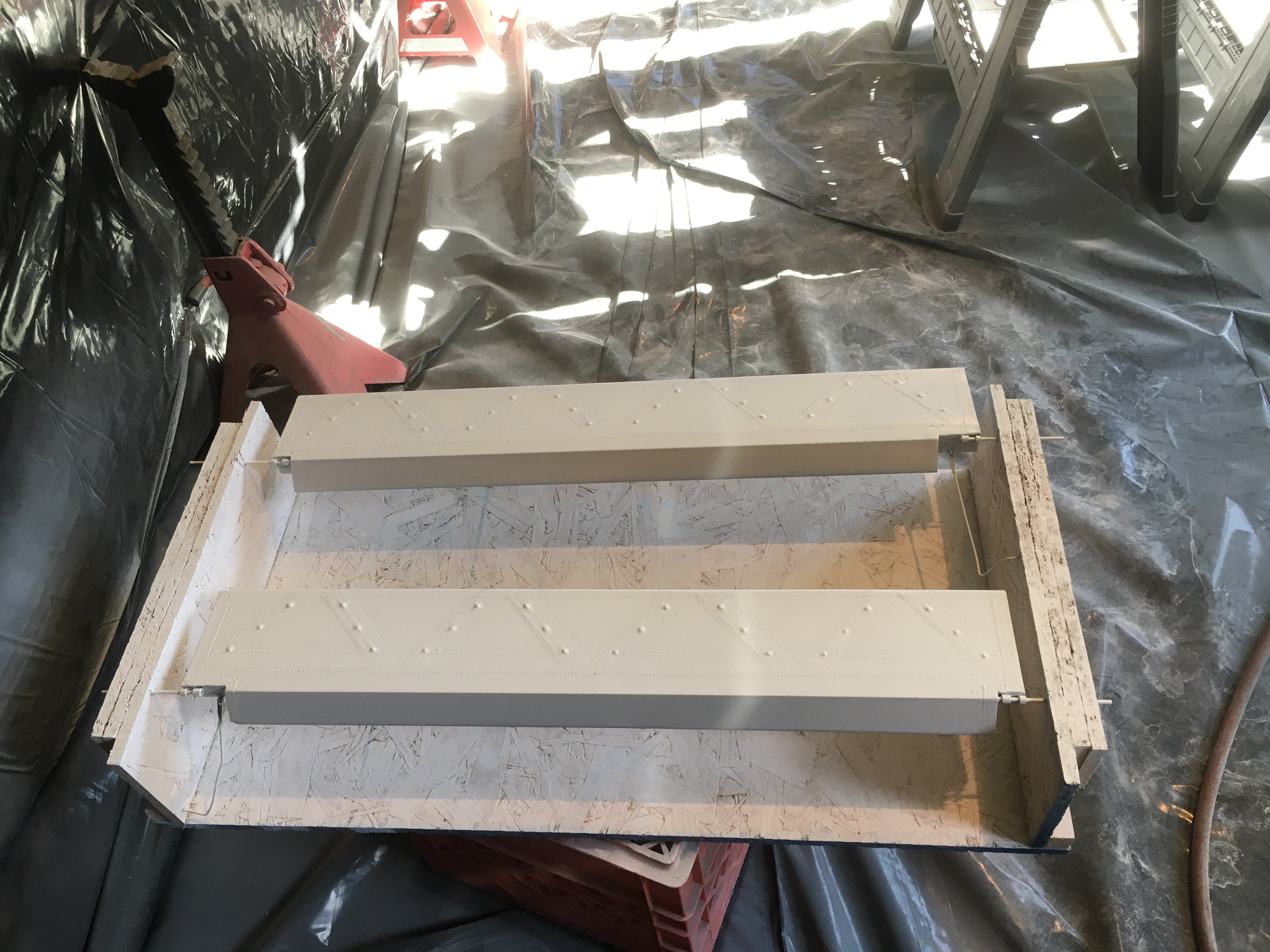

  4. Here's a shot of the ailerons in the fixture I made for painting, supported by the hinges and can rotate 180 degrees for top and bottom.

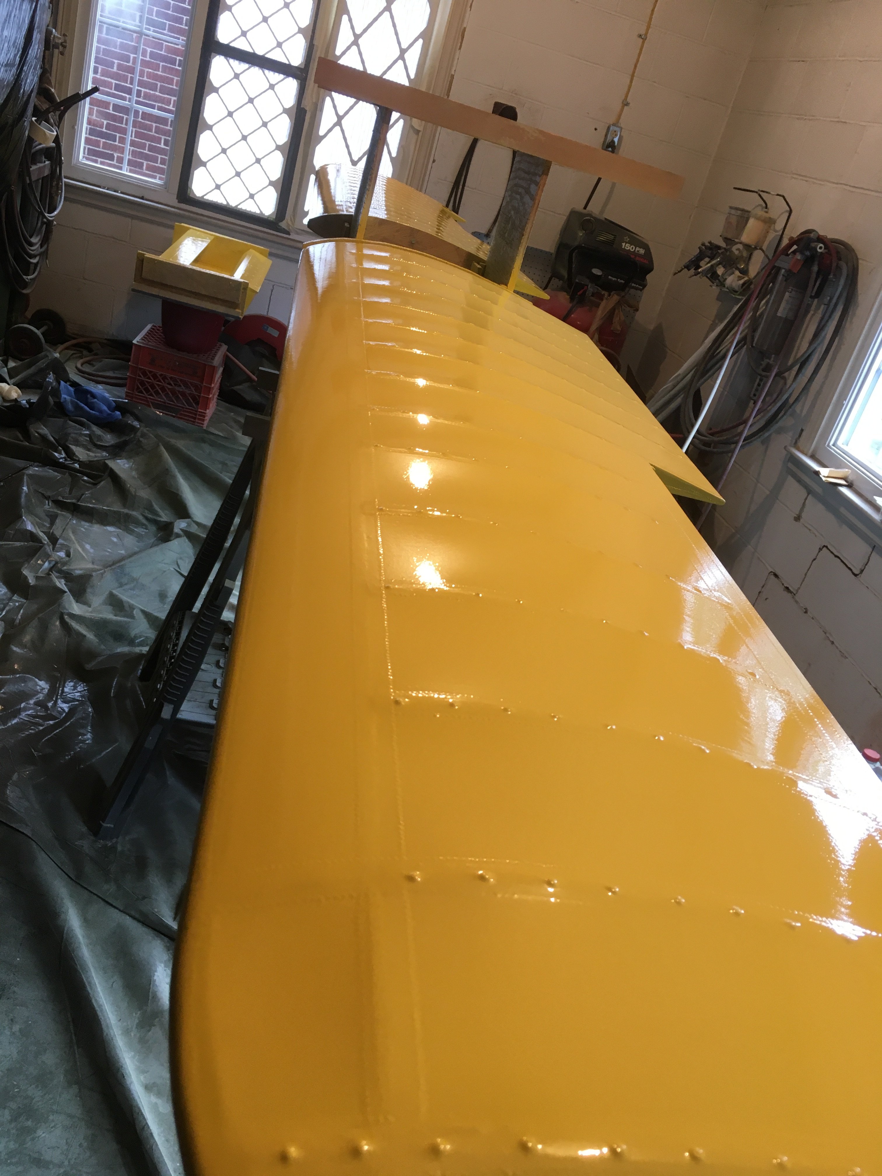

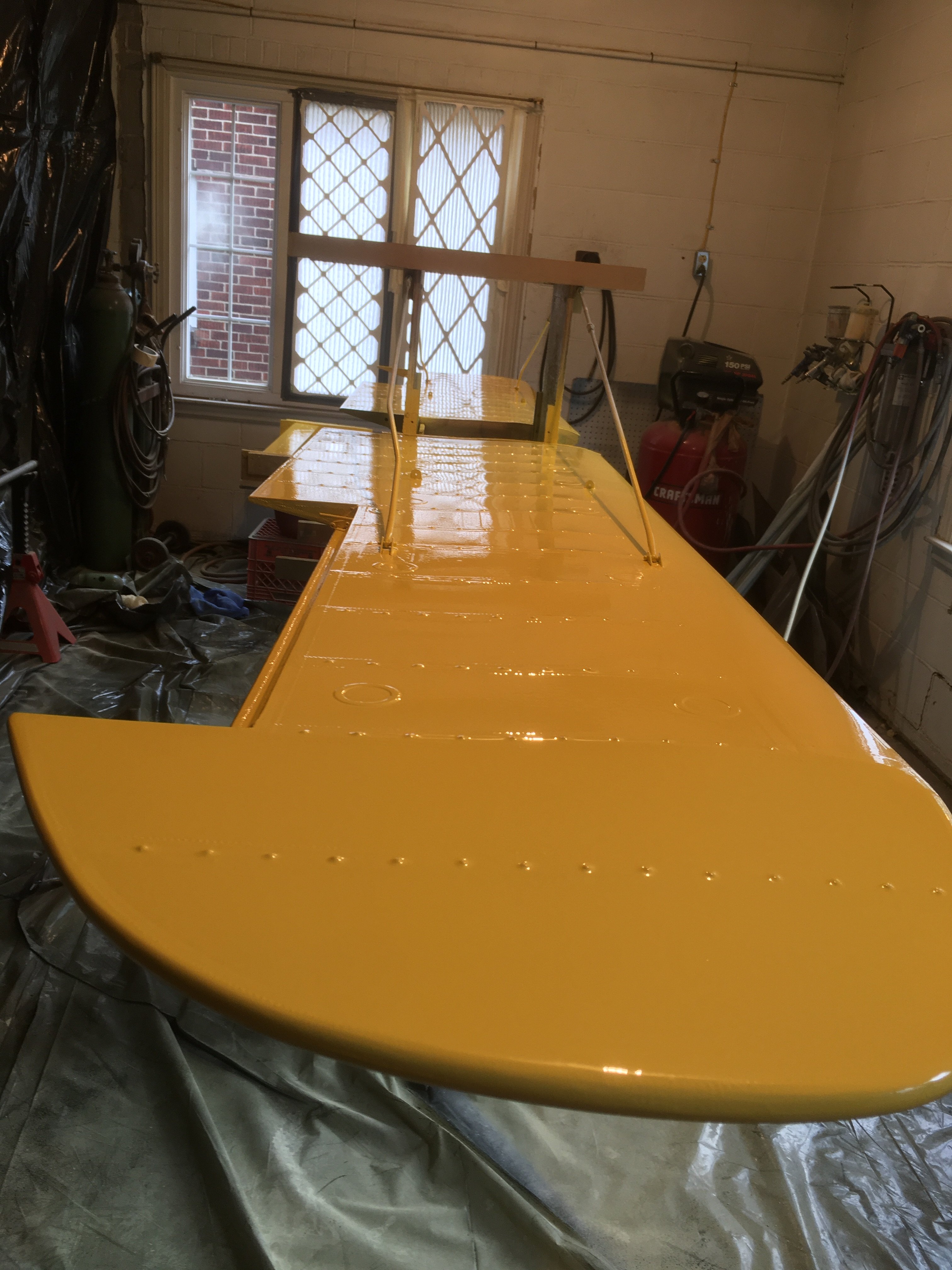

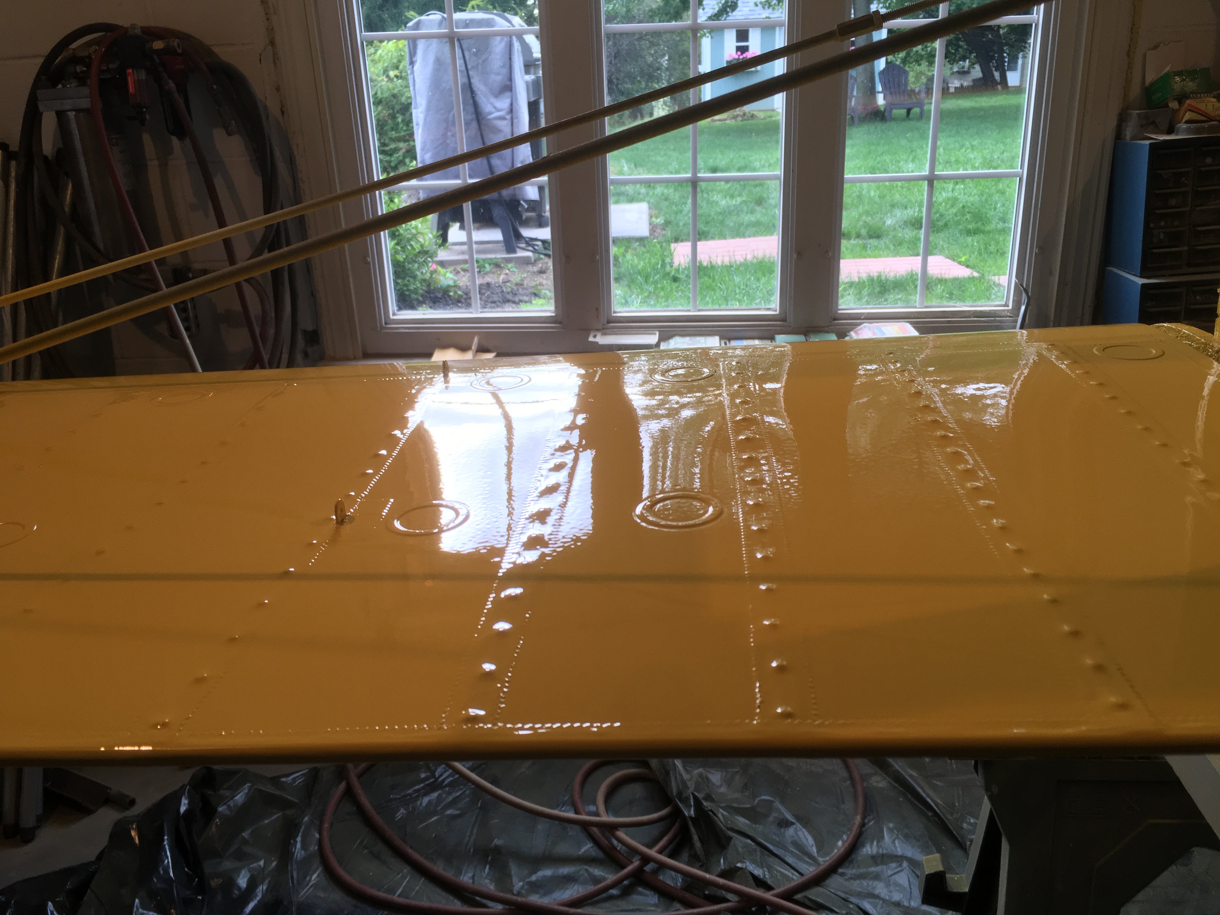

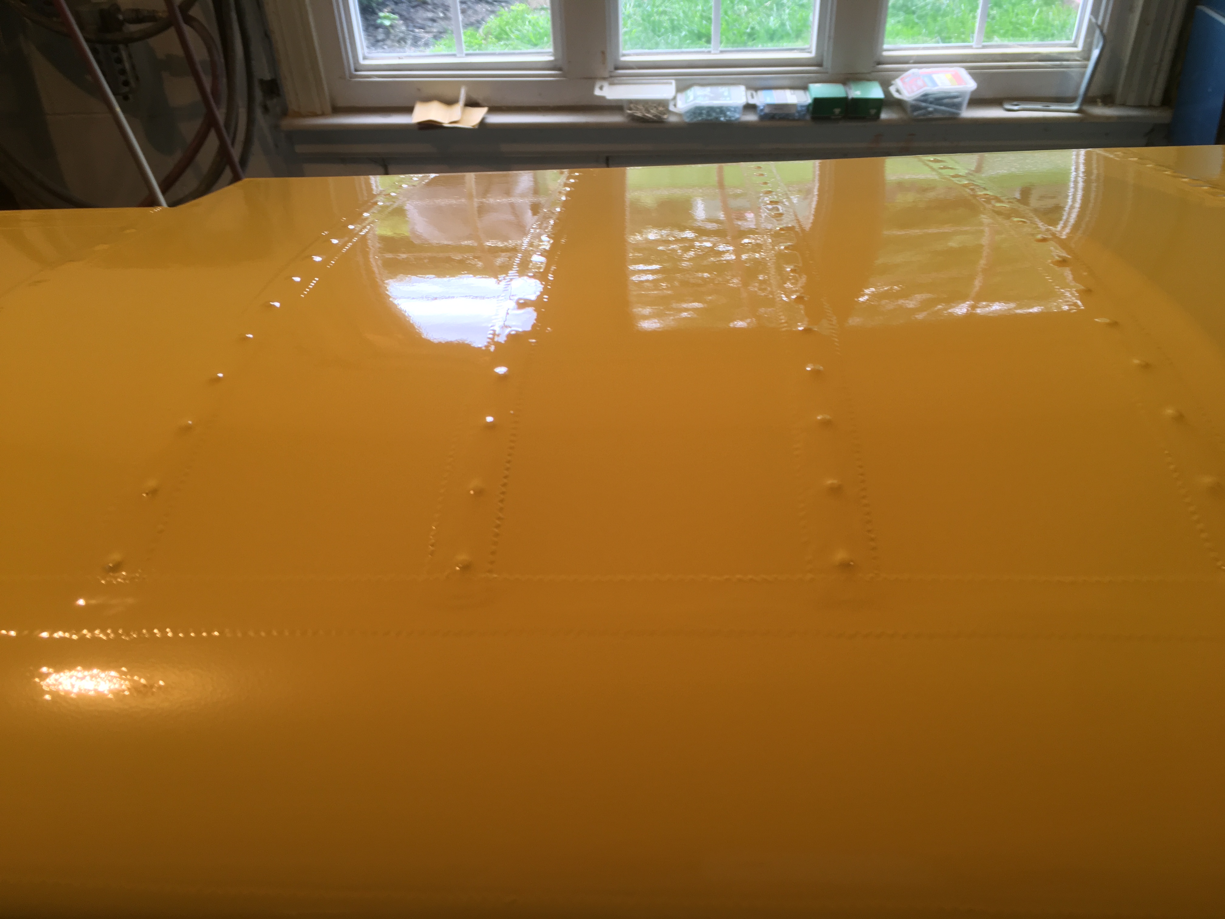

  8. Well today went as planned, got up early and put the final coat of primer on, finished up at 9:30 AM. Went and looked at flooring, got back home and final sanded the wings with 320 and red Scotbrite pads. Started with the yellow at 3:00 pm, finished spraying at 5:30PM. Three coats covered the white primer. I'm happy with the result. Dusted a base coat on, second coat at 90 degree to first, third and final coat 90 degree to second. The paint flows out nice. On the final coat noticed a few trademarks on the leading edge, I brushed the runs out with the back of my glove, stood the wing up vertically and the brush marks flowed out without any help. According to the paint manual, the paint needs 12 hours to cure. Tomorrow I'll get rid of the plastic sheet and get the grandson's slot car car track back where it belongs.

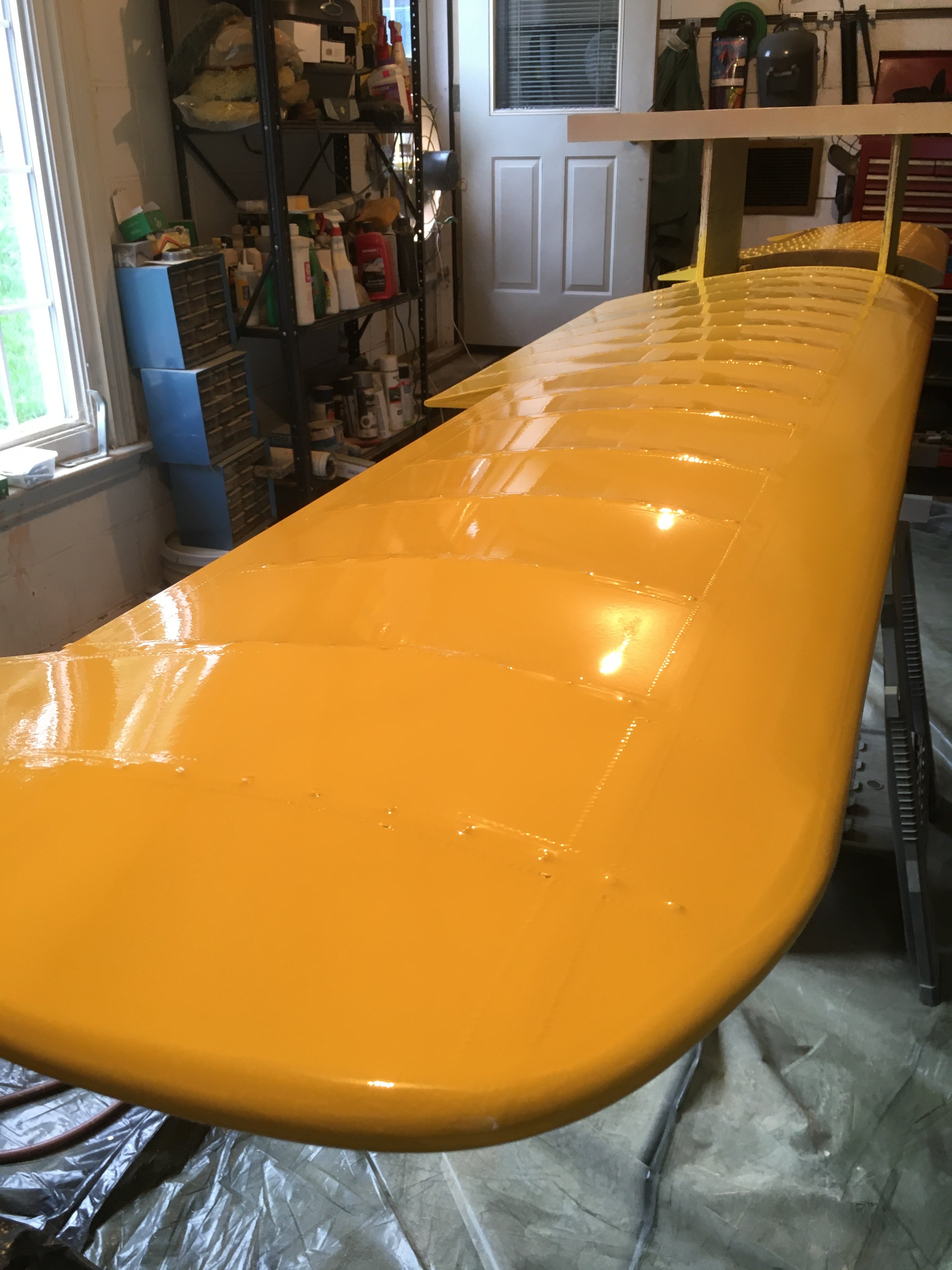

  9. A few more photos, bottom of wing. Got to help a friend with a plane tomorrow, wouldn't get much done on the Champ
