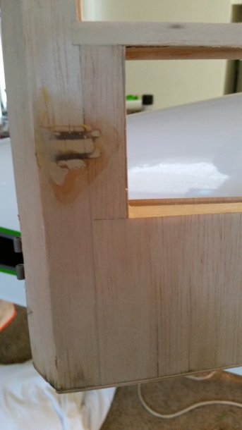

So without further adue, I thought I might add this little bit of an update. I had more time before I left this afternoon than I thought I would. I decided I had put off the rudder modification long enough. Since the Yak was originally set up with pull/pull on the rudder, and I am going with the modification to push/pull, it was necessary to remove the control horns from the rudeer and relocate them lower for the servo's. Since this earlier model rudder has no backing or supports like the later model rudders, I will have to open up the rudder and add a block inside to support the new control horns.

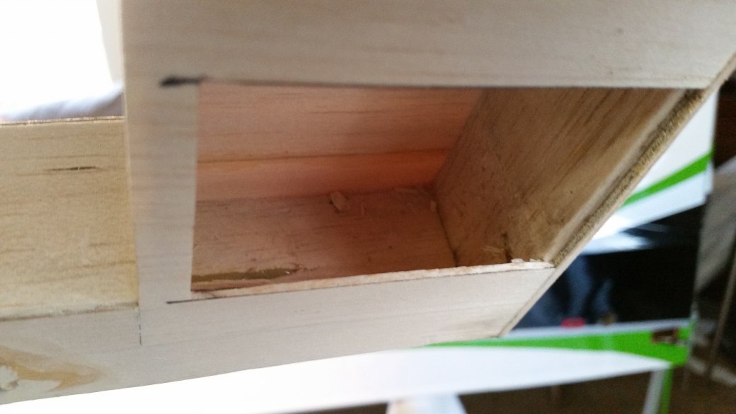

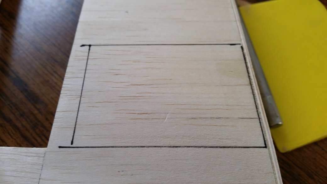

Once I outlined where I would open up the sheeting, I gently sliced through and removed the sheeting to allow an access hole.
Next I added a dense block of balsa just like used above in original location. Epoxied in and sheets replaced. When I get home on Wednesday I will touch up and sand the side of the rudder. Then, cover it also.
