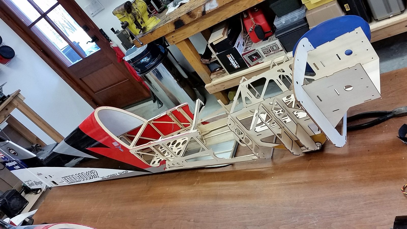

    A couple of years ago I bought the motorbox repair kit from 3SHD. Here it is snapped together (minus a few pieces) sitting in front of the better of the 2 fuselages I have. This kit will make the resurrection WAY easier than having to scratch all that together!!!

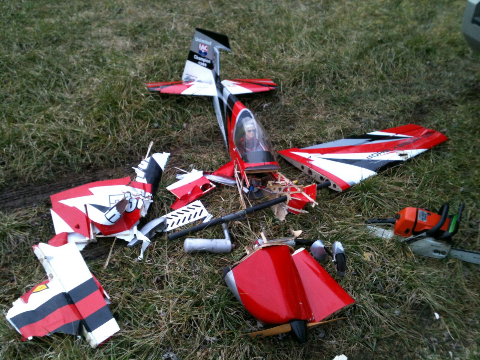

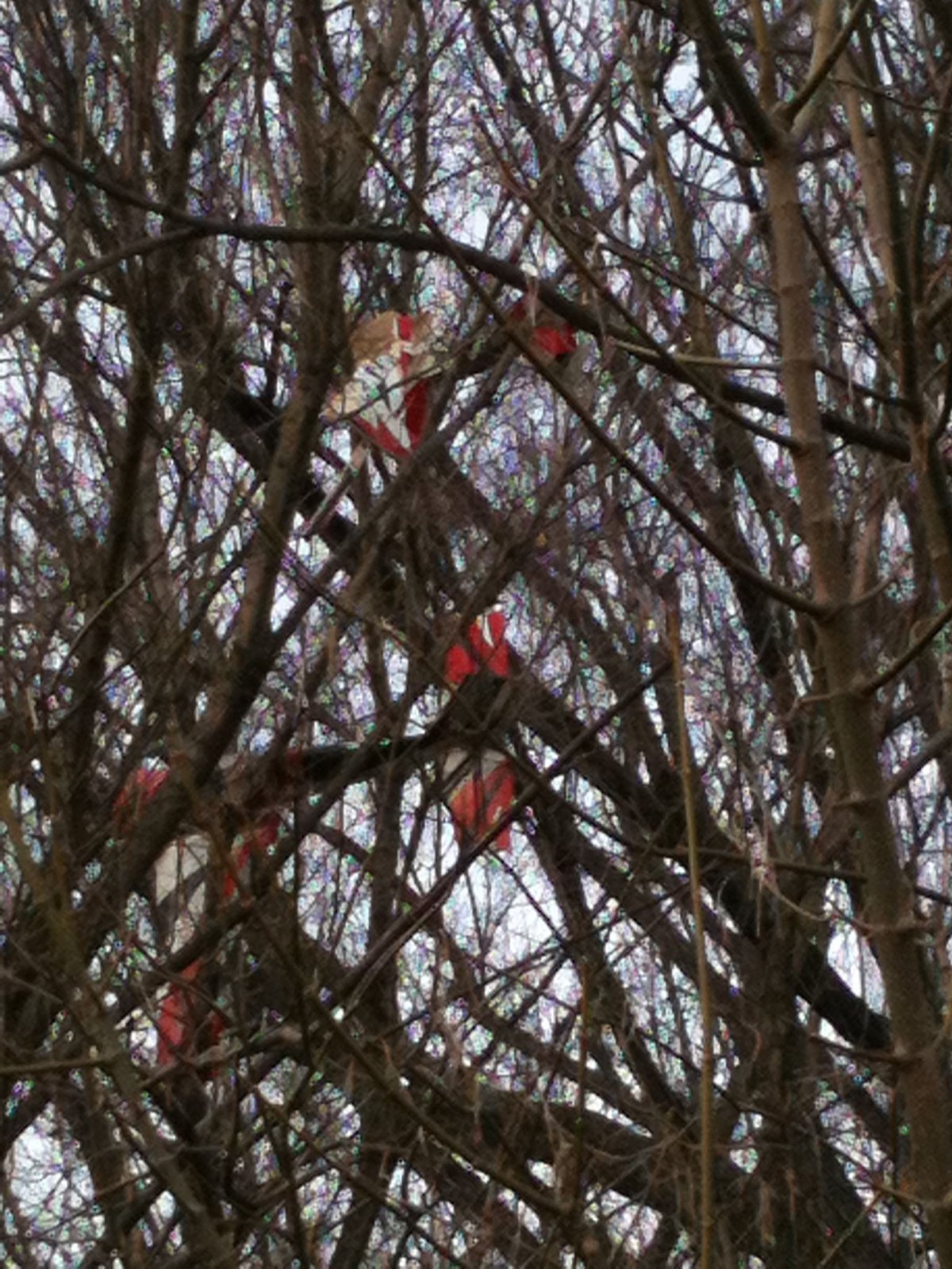

    Yeah....we had to cut 3 trees and my son still needed to climb part way up one to get everything!

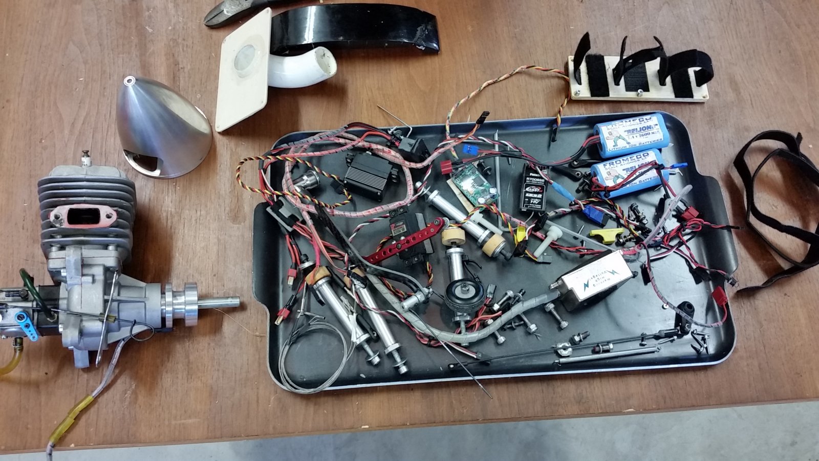

    Pretty much everything that'll go back in this Extra.

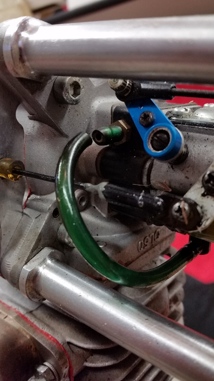

    When I was stripping the Aerobeez I discovered the cause of the deadstick. Lesson learned.....REPLACE ALL old tubing when redoing a plane with old equipment!!!!! The pulse line was the ONLY one I didn't do....:lol2:

    Here the motorbox kit is glued up with Hysol 9462 epoxy. Great stuff, doesn't run and very strong....although long cure times. By buddy Terry also suggested Hysol E20HP which cures faster.
    Also, since the datum line on most, if not all of these aerobats is the top of the fuse where the canopy sits.....I used some ply and scrap lumber to make up a flat "bench" the exact length of the canopy base in order to sit the fuse on (upside down of course). This will help keep things squared up and straight during the reconstruction of the missing elements.
