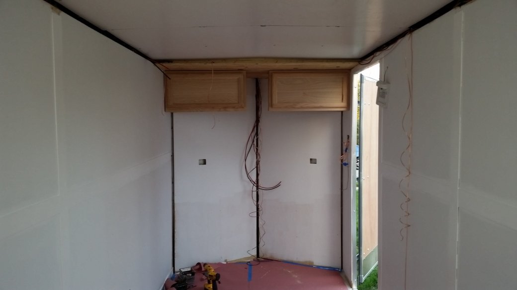

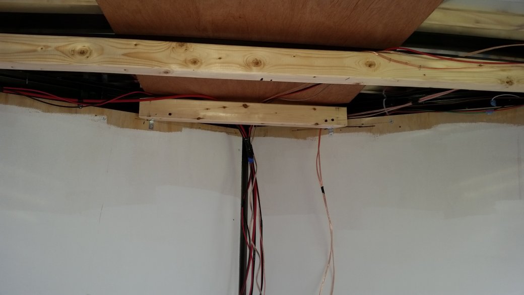

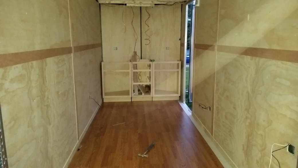

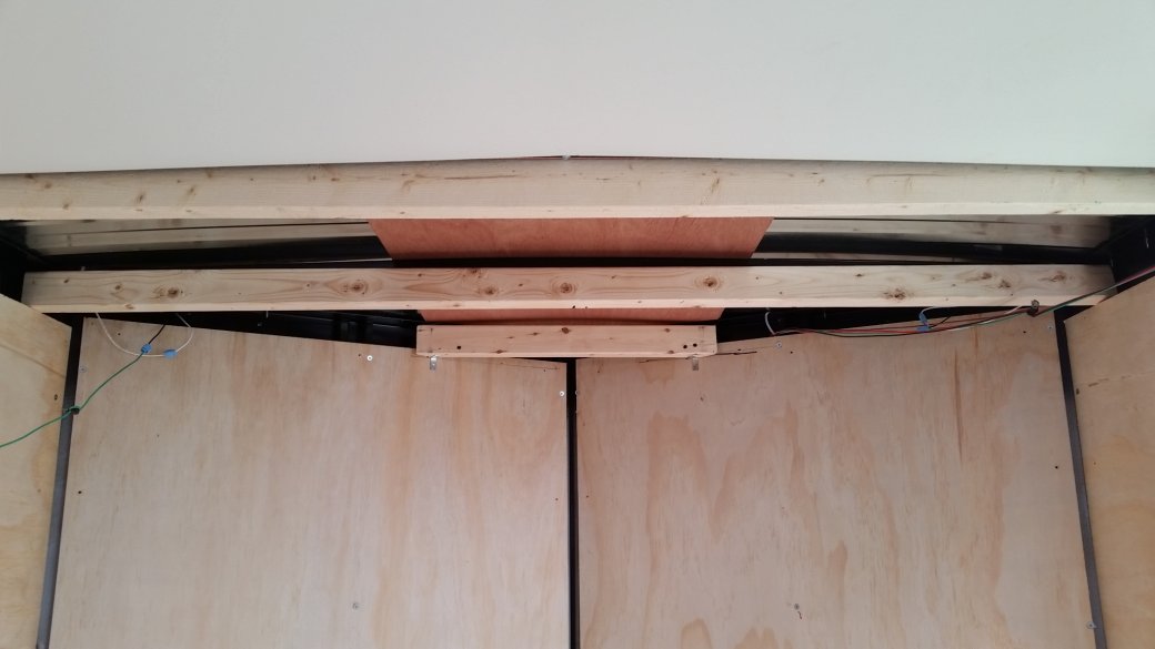

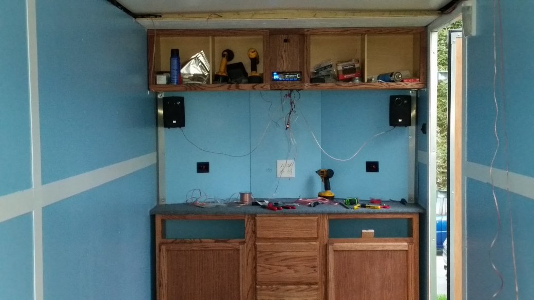

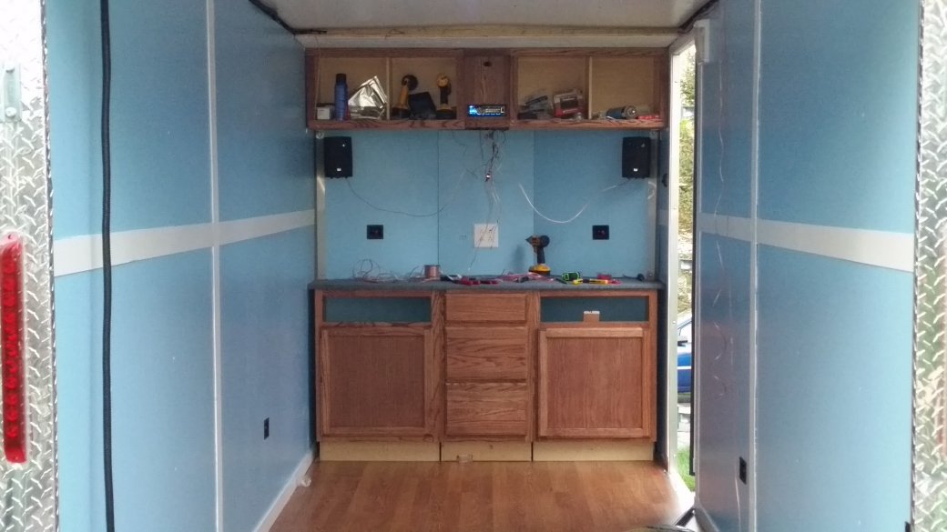

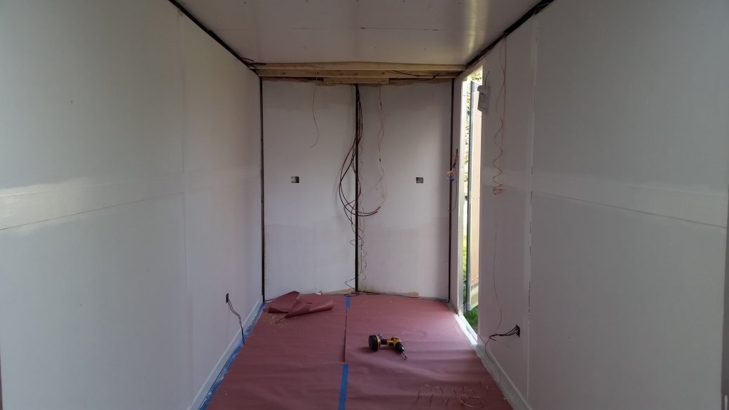

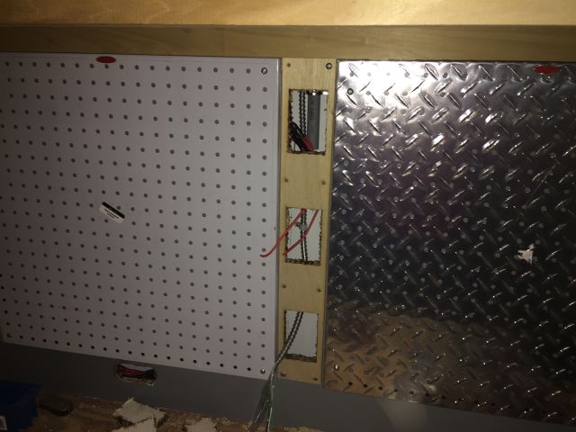

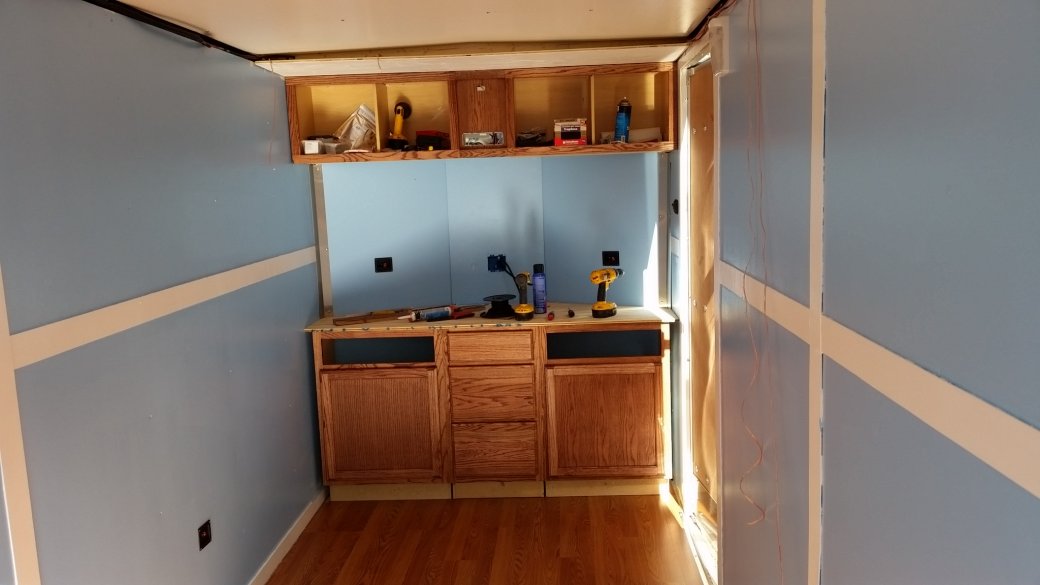

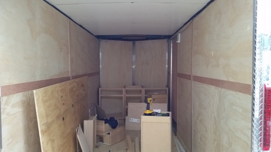

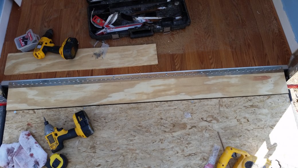

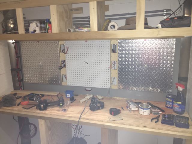

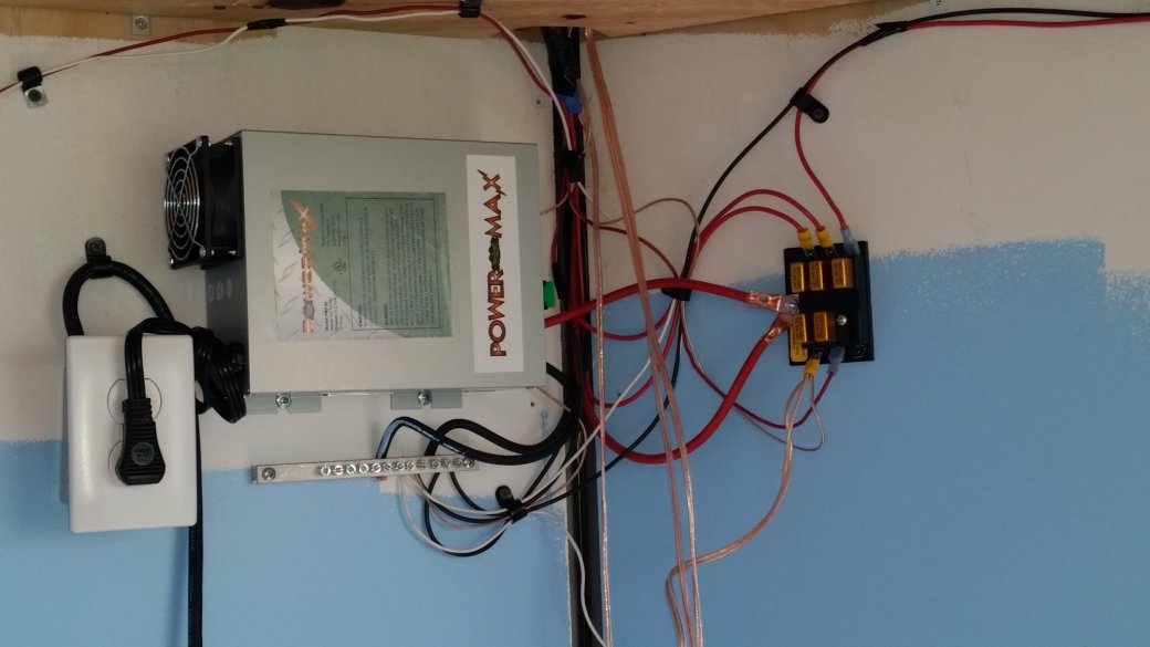

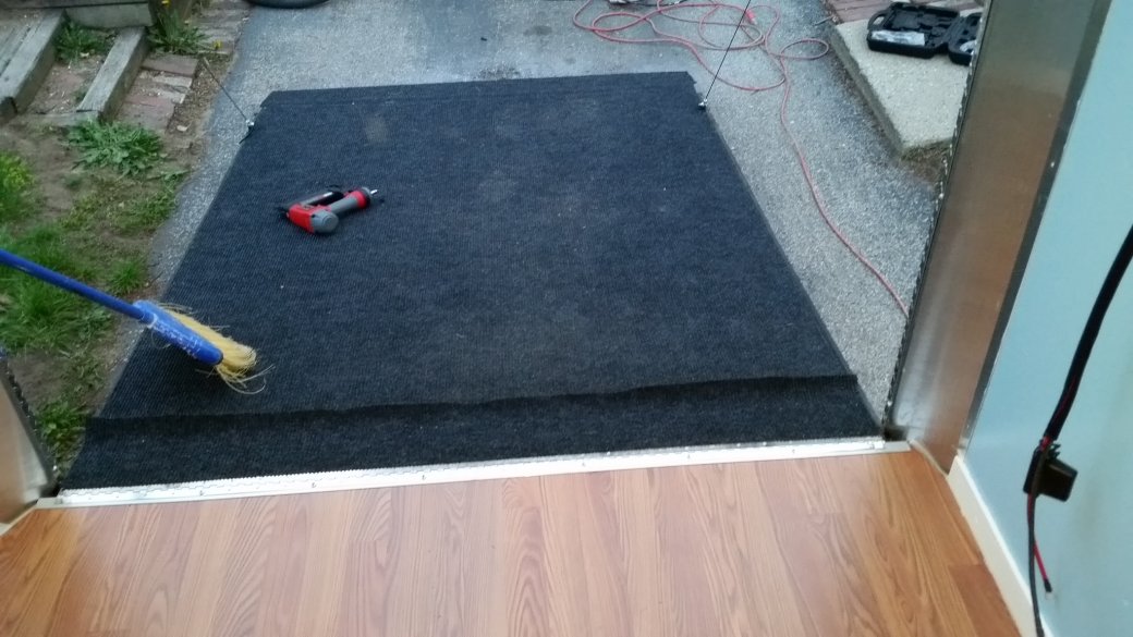

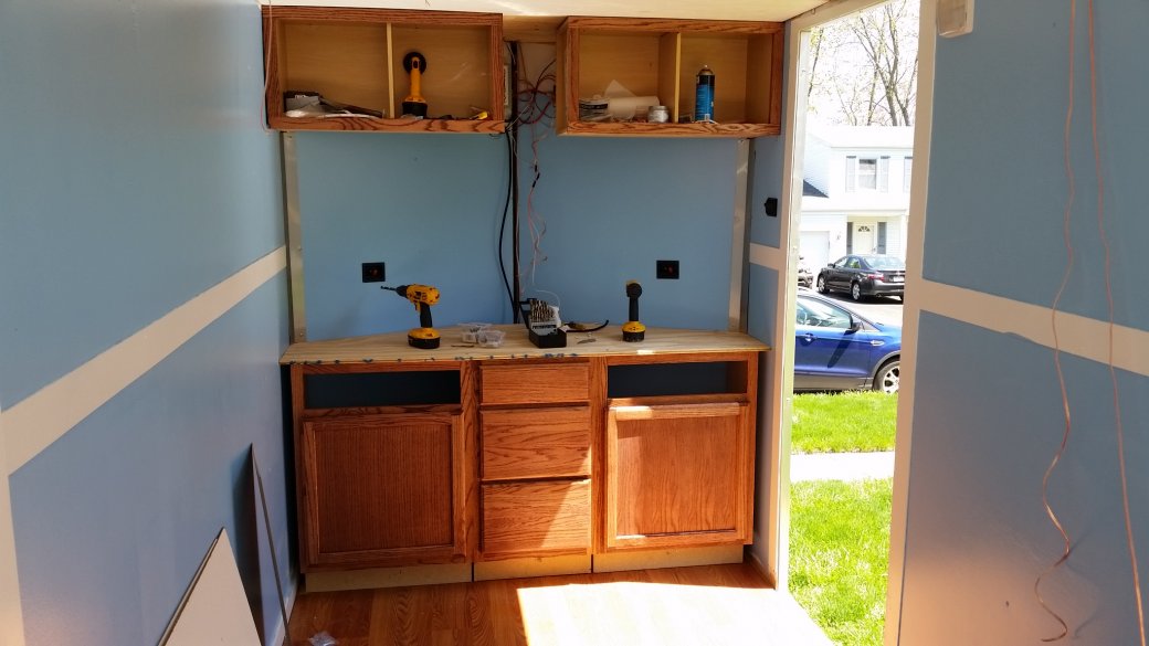

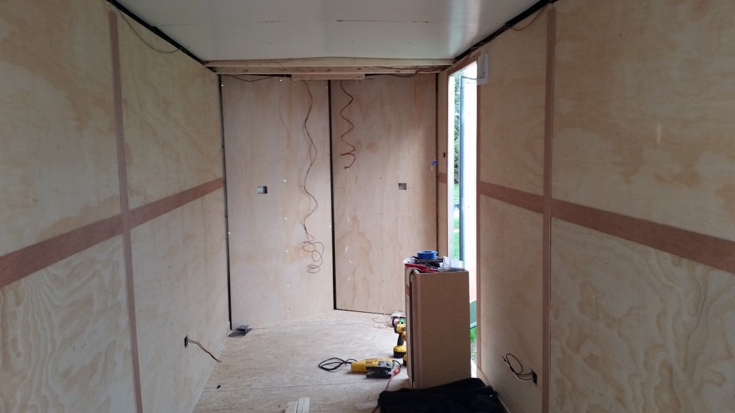

Started on my trailer monday. Coming along nicely. I ordered a rv power supply with 3 stages of battery charging and rated at 55amps. 10 gauge wire to multiple charge ports on the bench and on each side wall with an extra by the back door. There will be a JR radio powering 2 Kenwood 6 1/2" speakers up front and 6X9s in the back. Putting the battery in the back of the trailer to try and off set the weight of the cabinets. The ceiling cabinets are supported by 2nd ran across the trailer and supported off the side walls and roof rails. Want to make sure it is supported well. Pergo style floor. That was a hard choice. Didn't know if I wanted that floor or carpet.

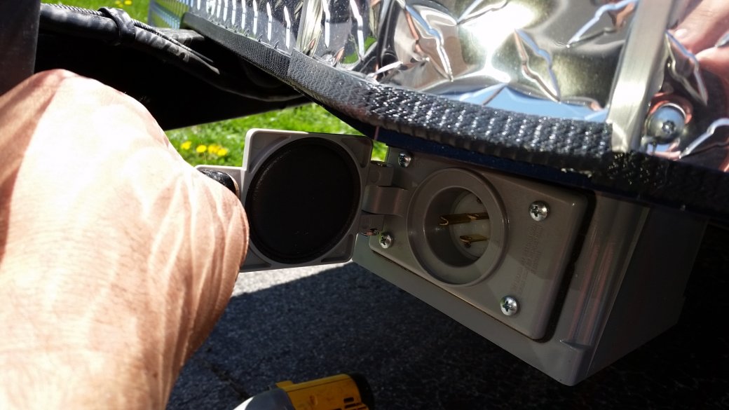

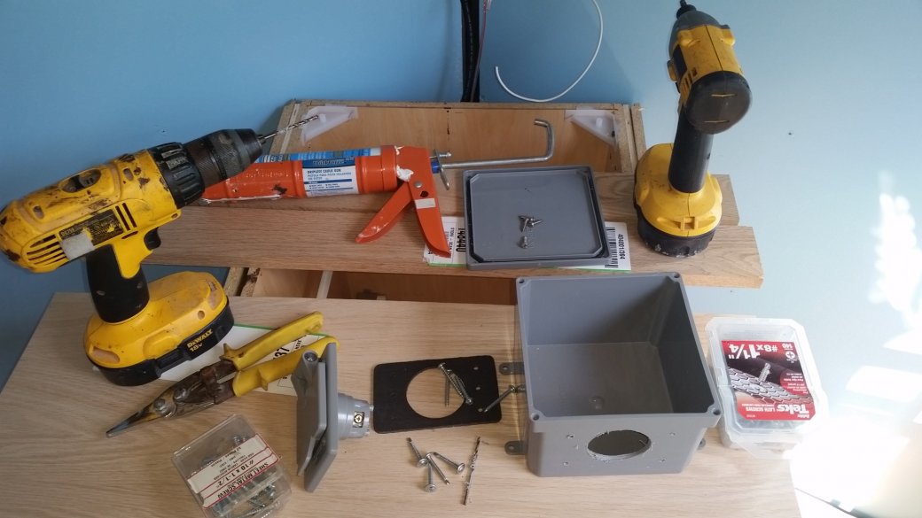

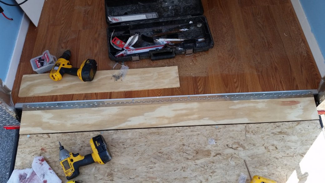

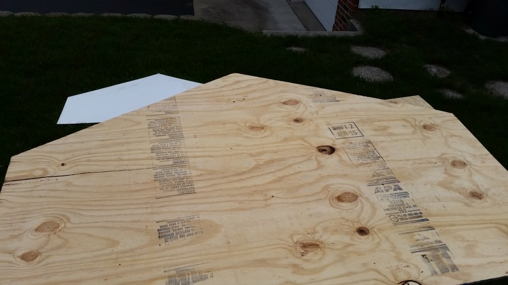

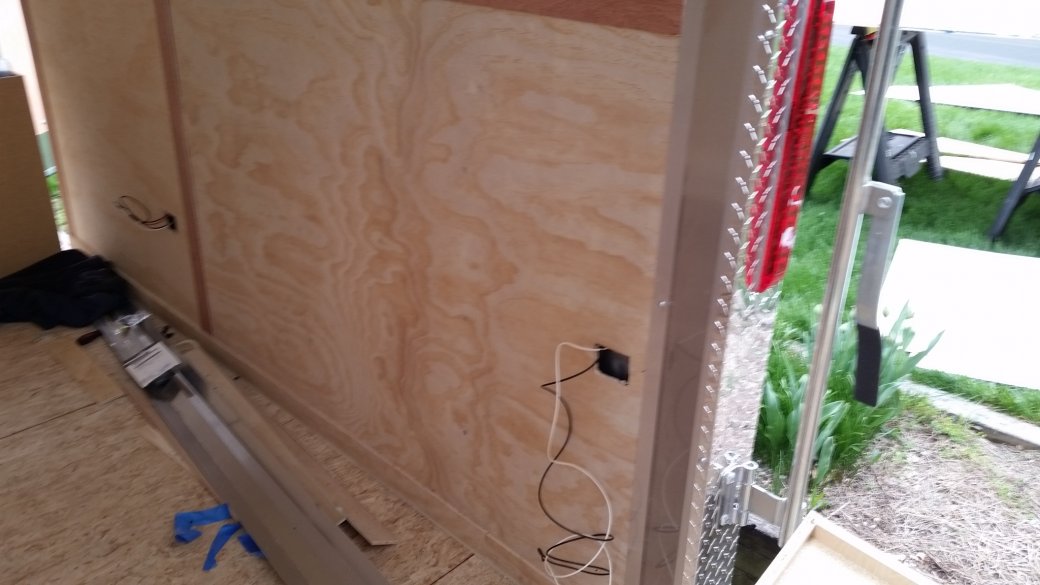

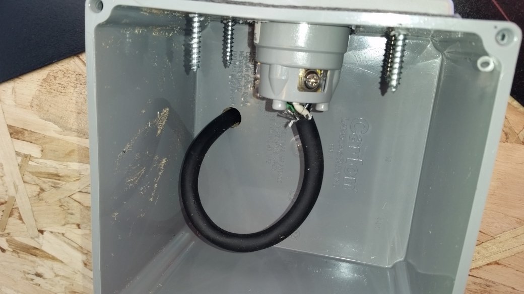

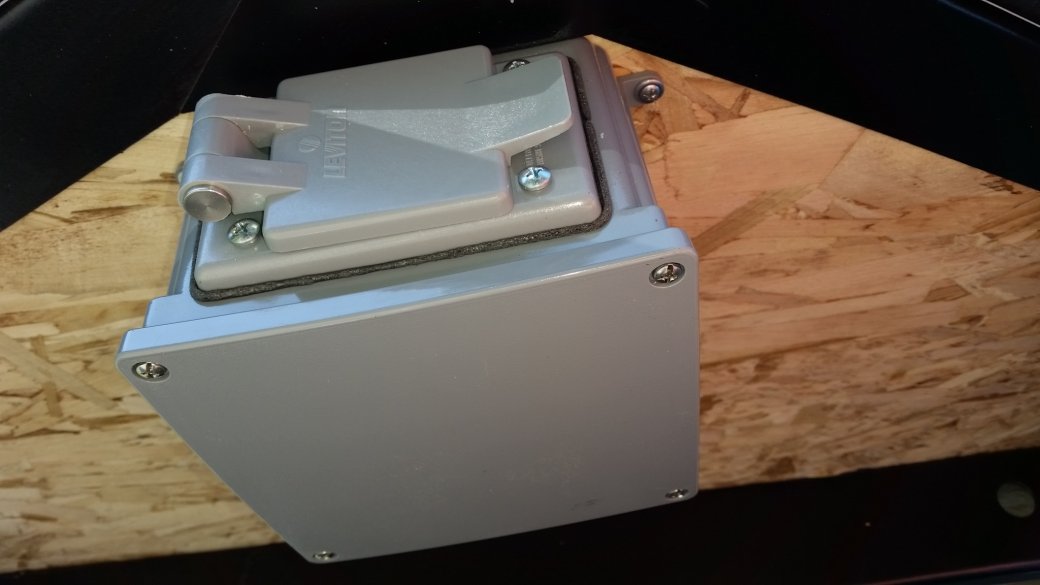

Got a lot done on the trailer today. Should have it done tomorrow. Final trim, plane restraints, back speaker wiring and poly on the cabinets. I did not want to drill a big hole in the side of the trailer for the 120vac plug so I came up with this under the trailer.

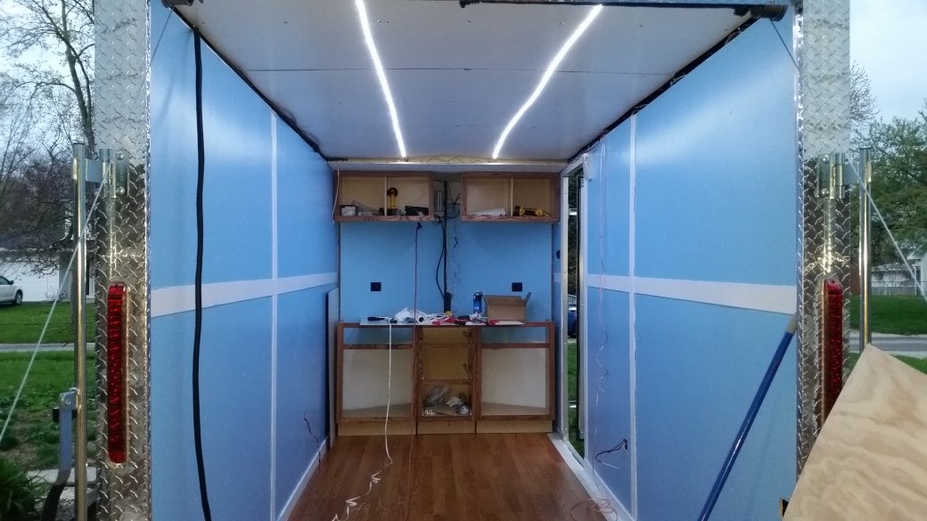

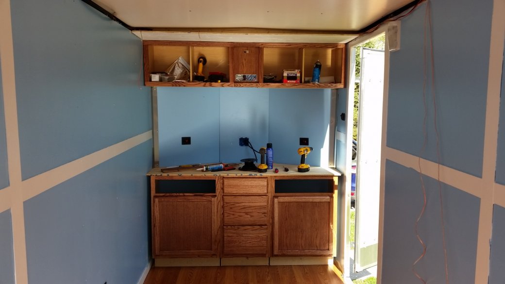

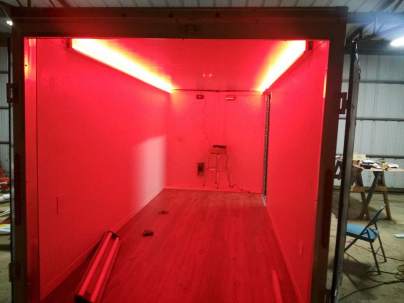

Interior.
