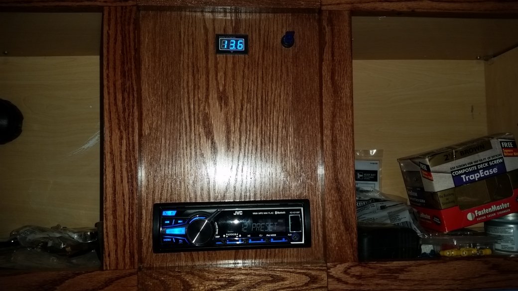

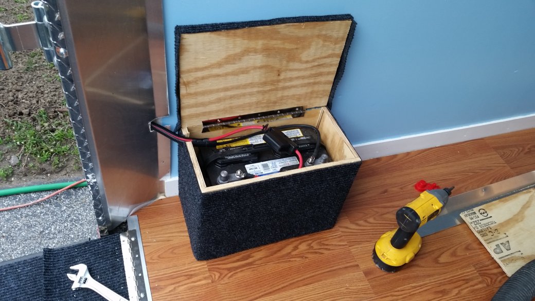

Well, I'm not a master cabinet maker by any means but they are going in. :D

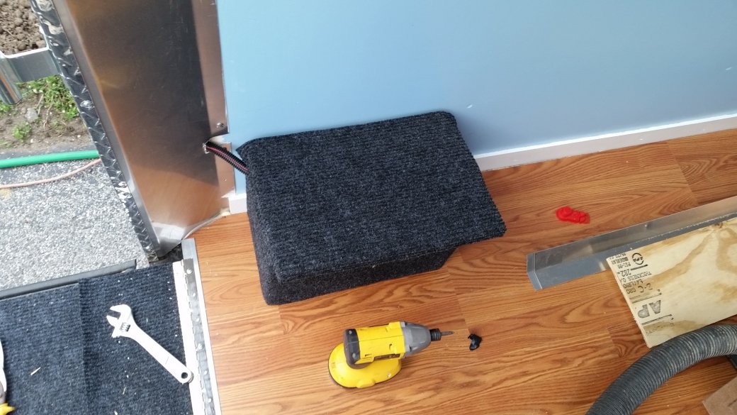

Today was spring yard work day so I had very little plans on finishing up my Trailer. But I did get 2 coats of poly on the cabinets, built my battery box and hooked up the radio.

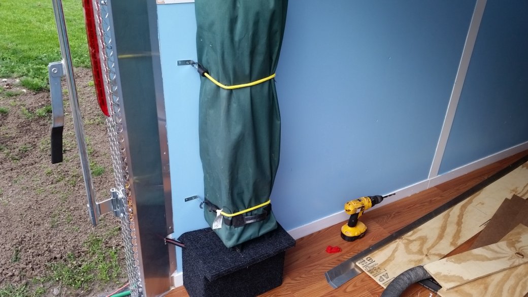

@jamesrxx951 , looks great! Just a suggestion, but you need to put some ventilation holes into that battery box! Put a couple more notches in the edges just like the one you cut for the cables to allow airflow, that will be enough to make sure you don't build up hydrogen and cause an explosion.
