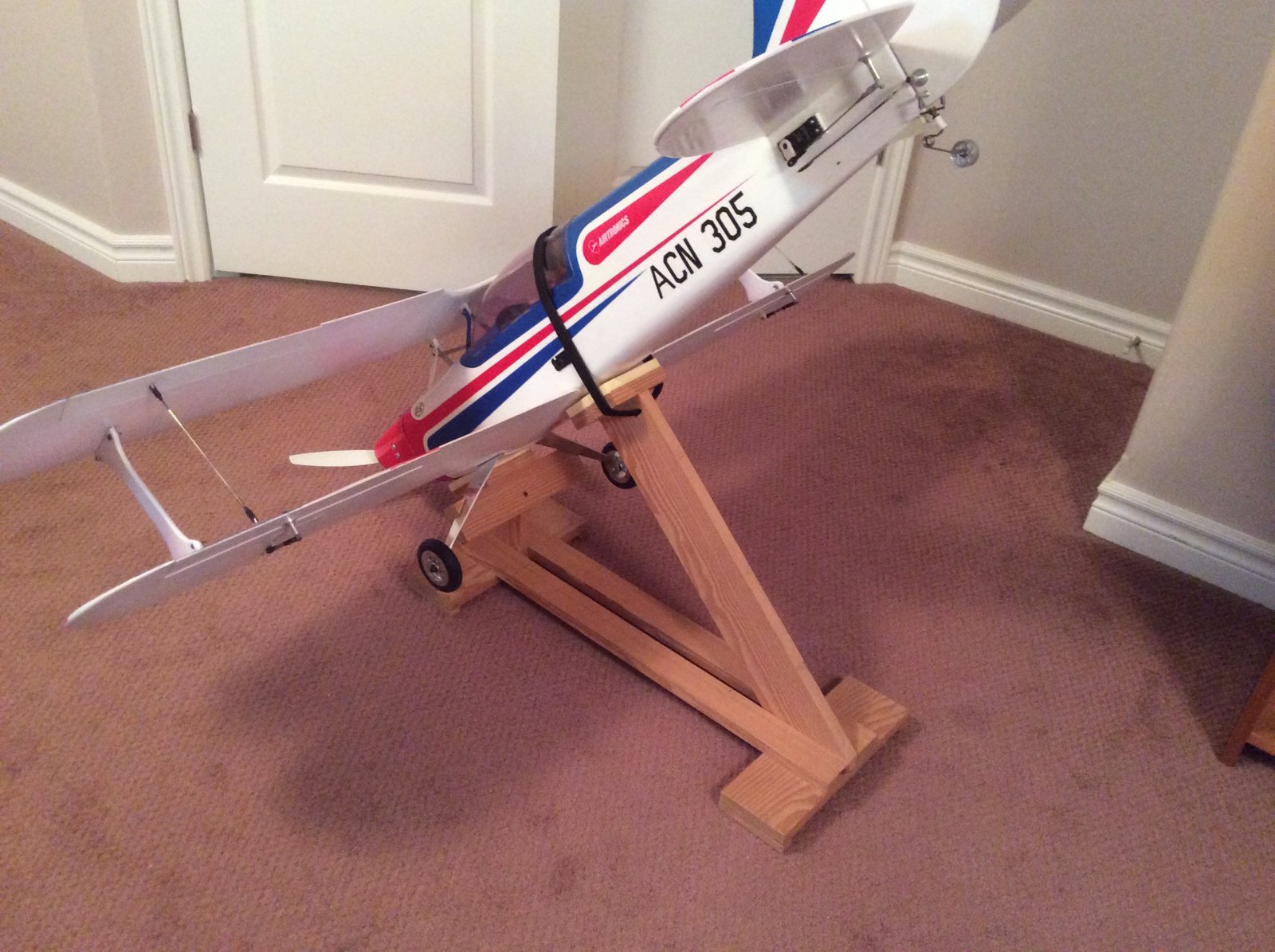

    Well got the stand built for the Skybolt it will now fit into the mini van without have to remove the wings.
  3. Hinckley Bill
    Hinckley Bill 50cc
    77
    70
    18
    Very cool....could you share some dimensions, materials list for those of us who would like to copycat that stand please?

    I will be glad to do that but you must know that the stand will only fit the Skybolt and it was scratch built but the GP Skybolt was used as reference. The plane is a 120 size Skybolt if you still would like some info on the stand let me know .

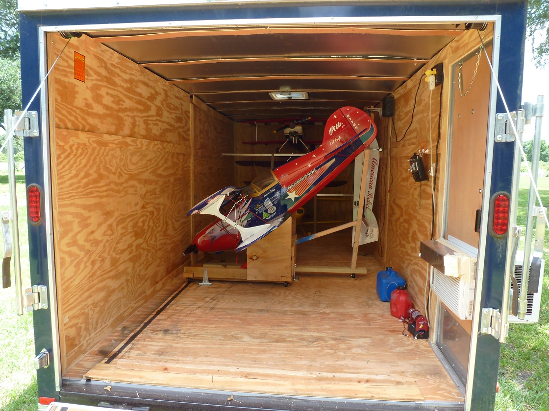

  6. I do the same thing. Well, similar, for larger birds. Easily roll them in and out without having to assemble/disassemble.

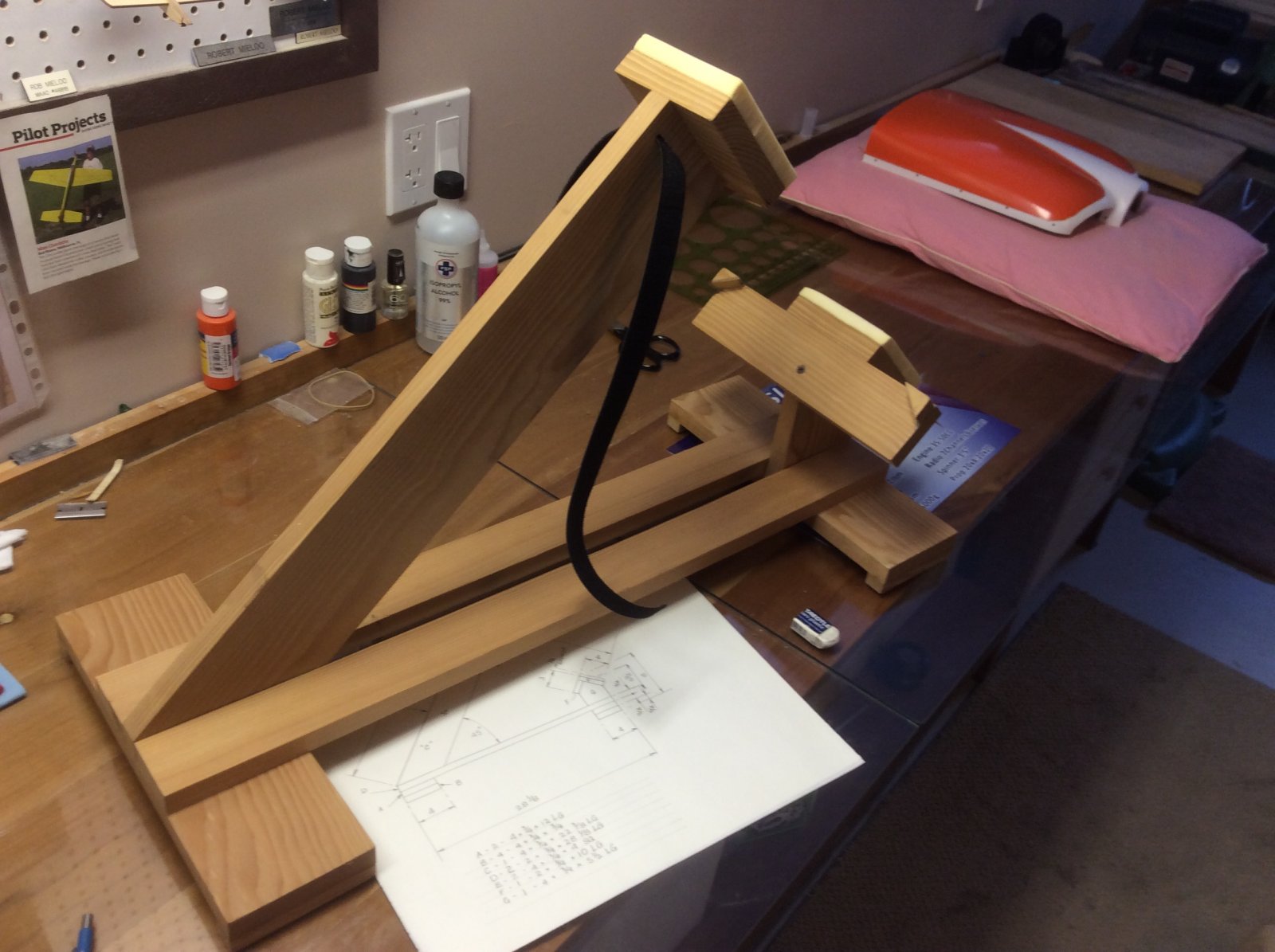

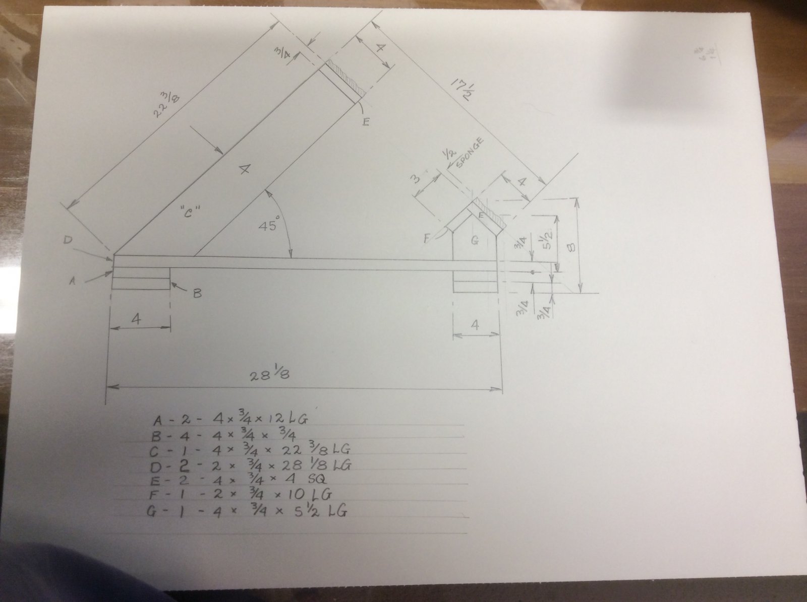

    As requested one picture, drawing and material list. This should be sufficient info for you to build the stand.

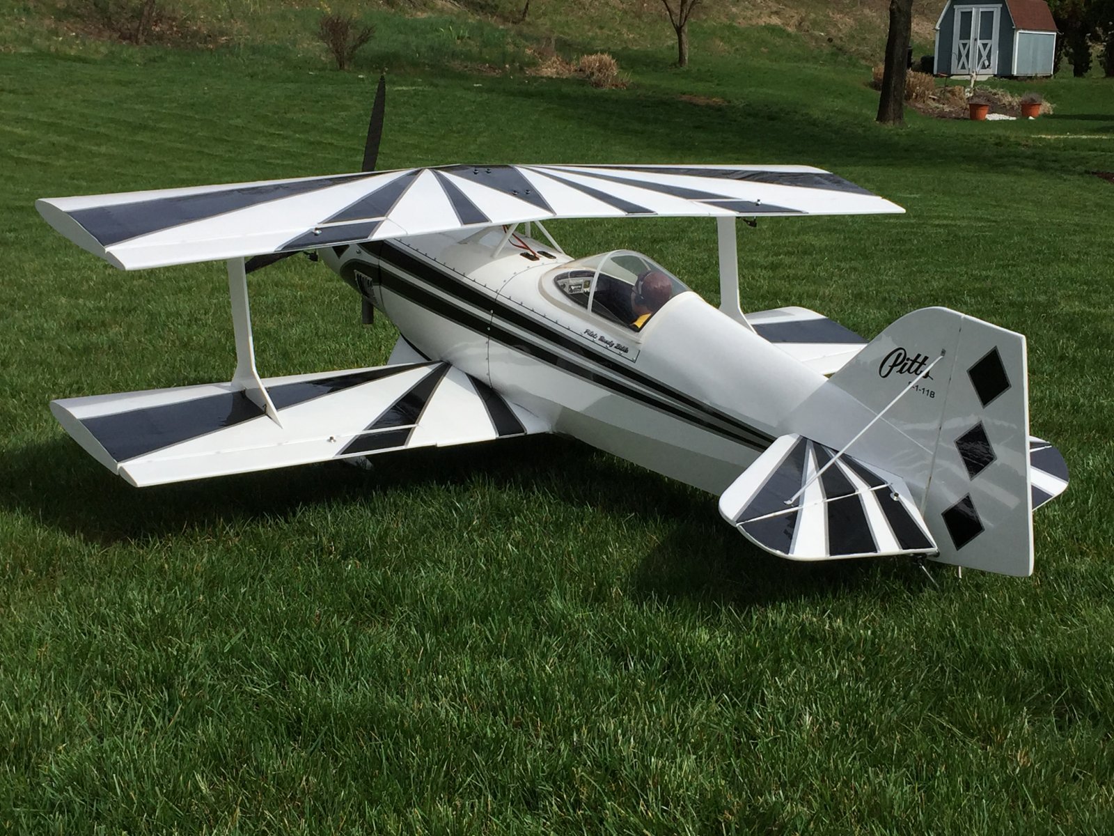

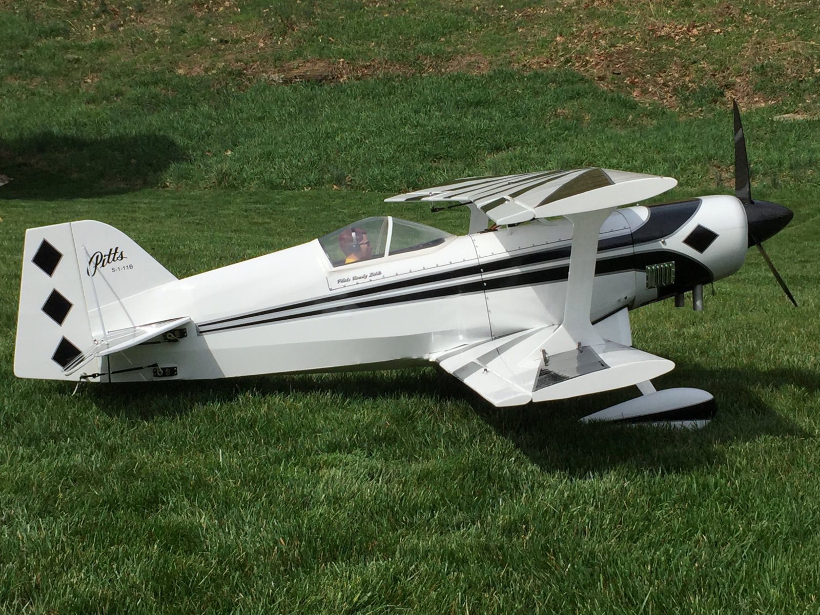

    DLE111, covered in Monokote. Weighs 23 pounds.

    Awesome airplane! Have you flown it yet?
  10. I plan to maiden it this Friday. Taking a vacation day. Getting nervous already.
