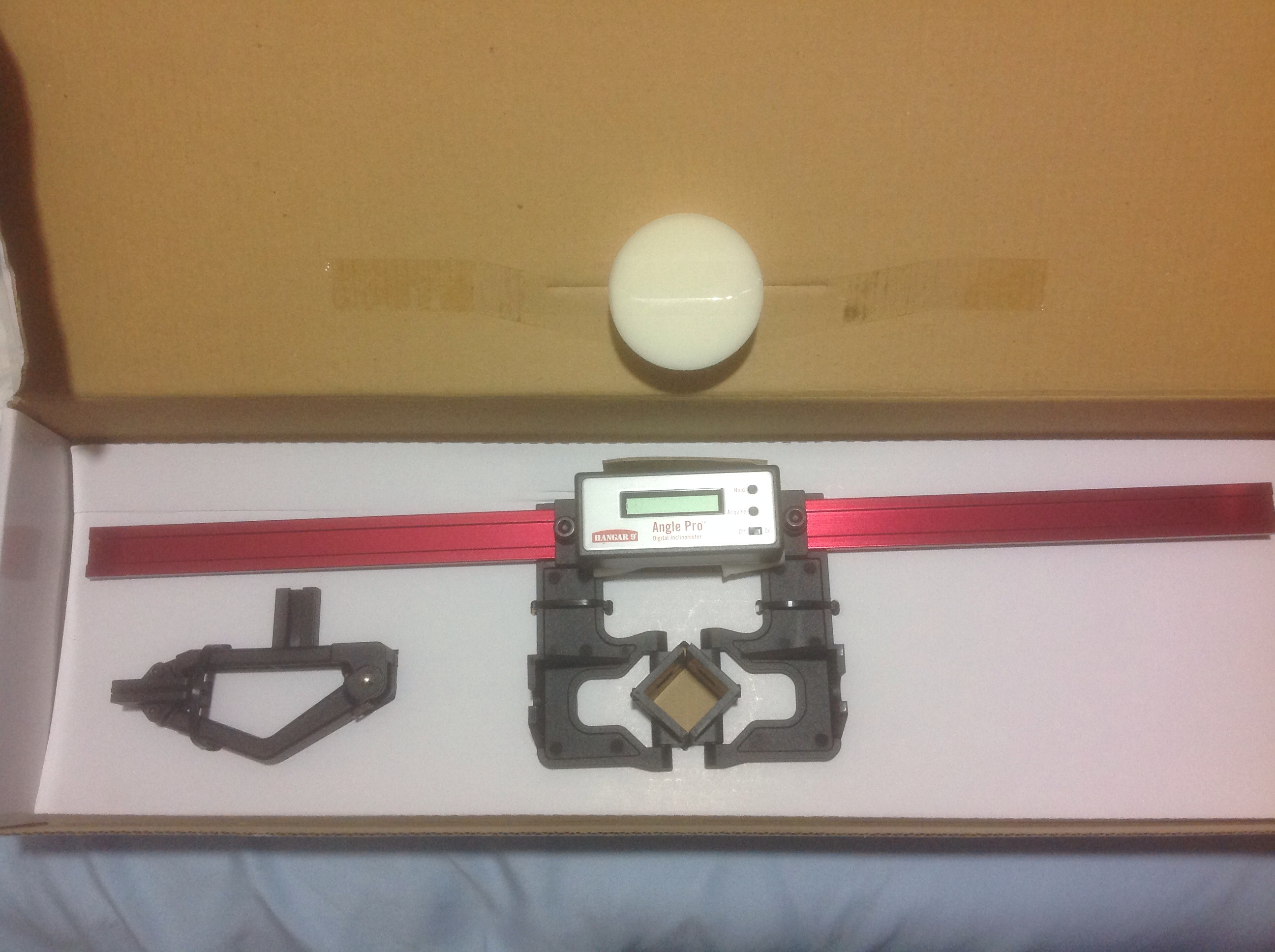

Got my birthday present, the wifey paid priority shipping from Horizon on the 4th it just came today on the 12th. Well it's here now, and I can start to learn how to set up planes like the pattern fliers do. I want hands off in every attitude, and as I understand the angle of incidence (AOI) is a key factor. It's the relationship between the horizontal stab AOI, and the wing AOI. Many other considerations, but the key is setting the AOI.

When building IMAC planes, we took the canopy off, place a level on canopy frame platform, lift the tail until the level is, well, level, supported the tail to hold that attitude, then mount the incidence meter on the main wings first to make sure the incidence was correct for both wings. Then moved it to the stabs to do the same thing.

The main reason I bought the Angle Pro is to try to learn how to set up a a plane to be hands off neutral in all attitudes like a pattern plane. I know this will make for a boring 3D plane, but I want to fly some I-Mac stuff with my 35% Extra 260. I plan to buy a set of Dalton wings and make them work on the scratch built plane I have. With that said, I need some tools to know where stuff is at a I build this thing.

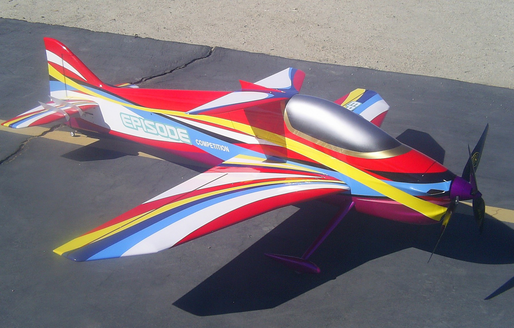

That's the plan, to make it as good as it can possibly be. I saw an Episode at the field the other day, my Jaw dropped. It was over 5K of awesomeness. It was somthing like this.
