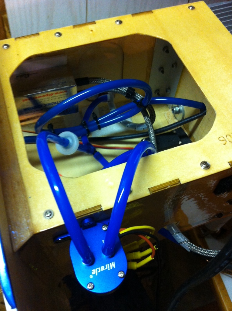

I'm installing a smoke system from [MENTION=2470]RedwingRC[/MENTION] and 4titude on the Pilot 35% Extra 260 today!
Bipenut53
Ive been looking at those...... what do you think Mike? How does the brushless motor work? Are you using the flight battery to power the smoke pump? Did you test it yet? Easy to regulate?
Sorry for the barrage of questions lol

looking forward to your review. We've sold a lot and they seem to be working out great so far. If you get some video etc let me know
It was an easy installation. I am using the ignition battery for power. I'm working on programming my radio with a throttle mix and end point at 20% as I've been told anything beyond 20% is a waste of fluid and not good for the pump. I'm using Fortitude tank and smoke pump plumbing kit. For smoke fluid I'm using the robart smoke oil. I really wanted to use the fortitude dual tank tray but it was just a hair to wide for my fuse.
After I get the mix done it will be time to iron everything down and do my best to seal her up.

Nice Nate! Got the Futaba 8fg super mix programmed for the new smoke pump!! It wasn't as hard as I was thinking it would be. So the mix starts with toggle switch sf turned on and the throttle at 25% and it maxes out at 20% throw (for the smoke pump) at full throttle. It's nice to have the graph showing what each servo is doing from the radio with out having to go to the plane and turn it in etc....
