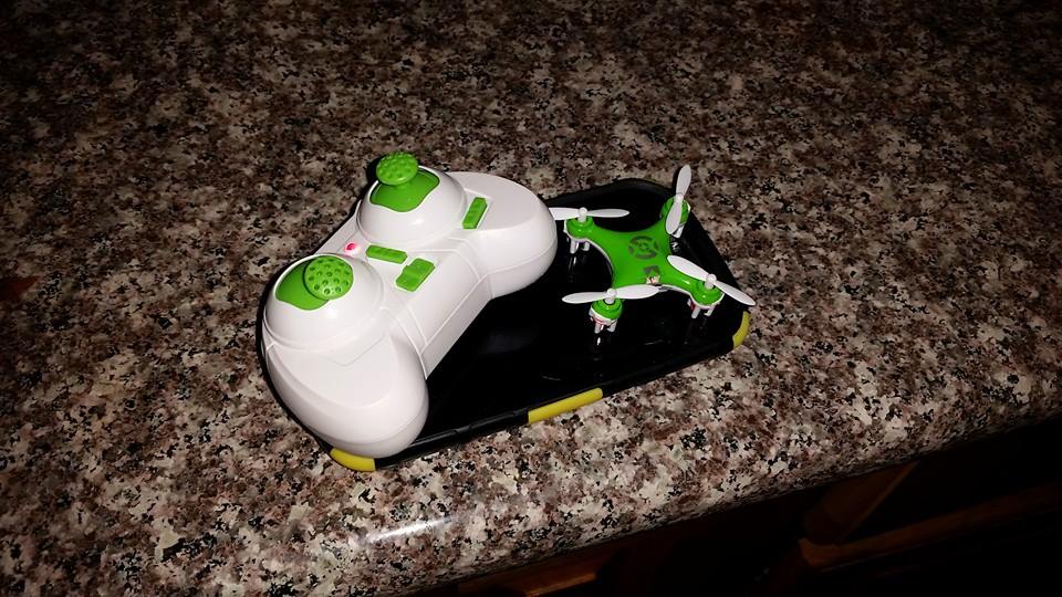

I just bought this the other day. It's a CX-10 micro quad. Best $25 I ever spent. Can do flips and is full 4 channel.
It's sitting ontop of a Samsung Galaxy S3! So much fun doing missions in the living room.
