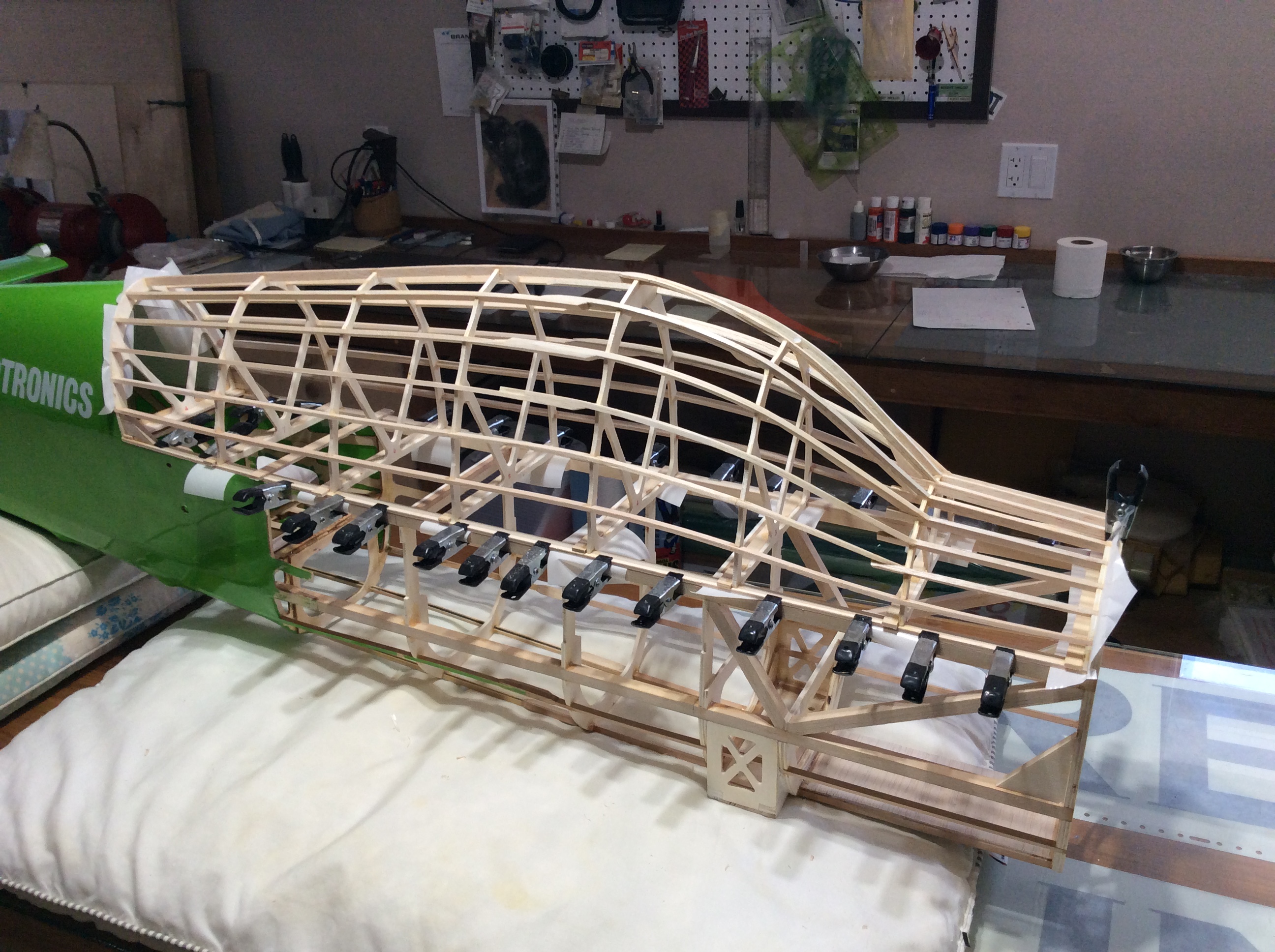

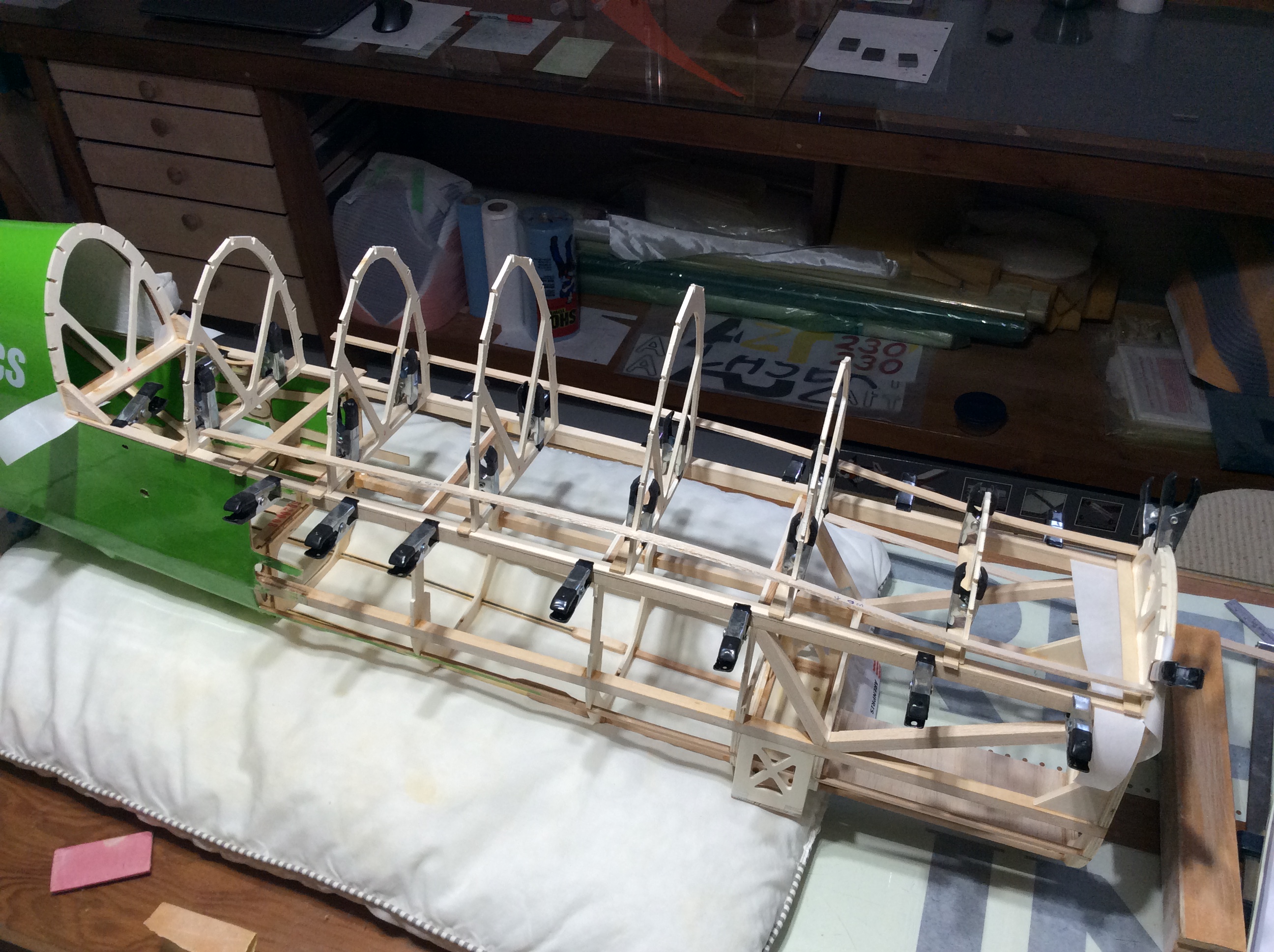

Got bulkheads in place for the canopy and all set up. But no matter how I try cannot get the stringers to conform from the front to the back. Even tried cutting 1/8 square stringers and soaked them in winded but bib not work.
Need to find another way to make a canopy and change my thinking but this is not working
I would seem to me that the canopy and the front section need to be separate pieces. I believe your problem occurs when the bend reverses?

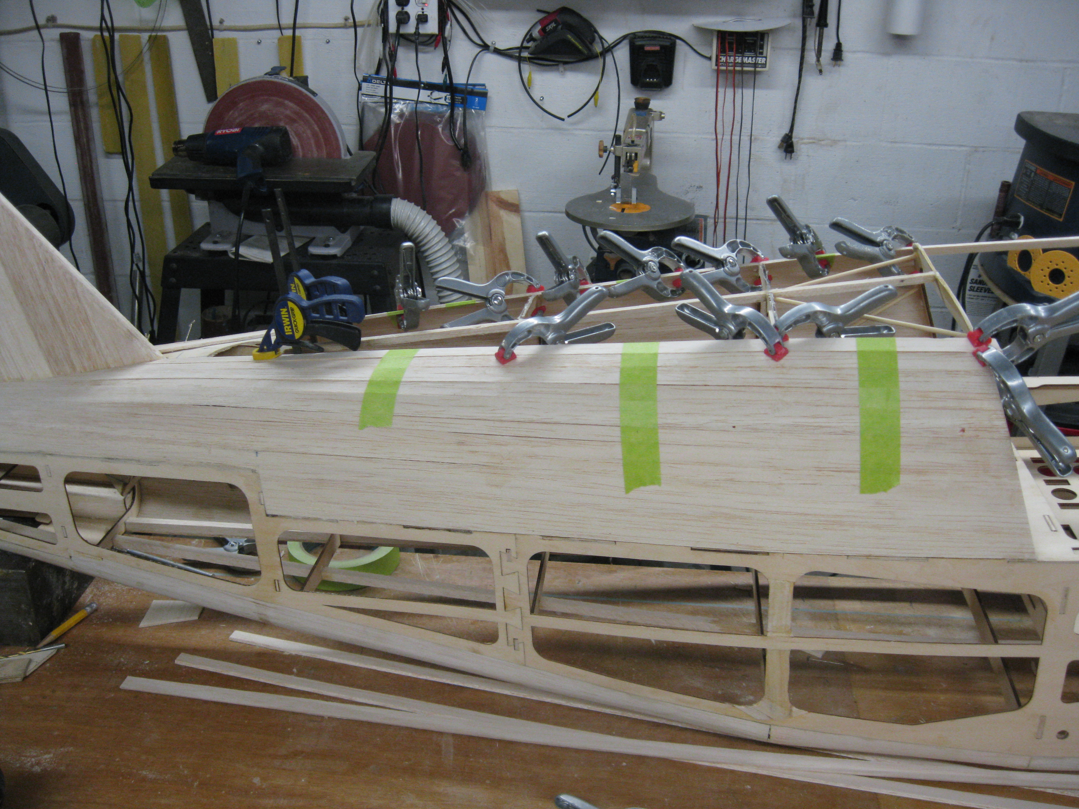

It does take some time, I strip planked the turtle deck on my Cherokee, it's the best solution when the surface is bending in two or more directions. One strip at a time!
Thanks, working on it slowly and I mean slowly. The only size I can get to work is 3/32 square wet so trying to see if it makes any sense. Got three strips in place and deciding if I should continue. Keep you posted.
You are correct the reverse bend cannot be done or let me say I cannot get it to work. Yes I will make split there and see how it goes. Thanks
