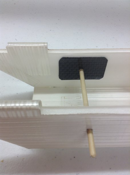

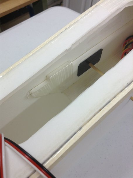

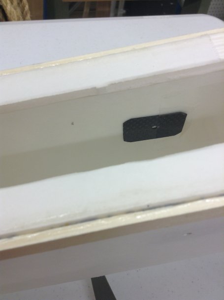

Here you can see the carbon fiber reinforcements I added to the power pod. This should greatly improve the life and durability of the pod.
Also added some carbon on the inside of the fuse.

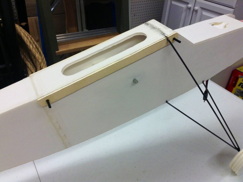

Some people have had problems with the foam crushing around the wing saddle. My method to address this was to split a paint stick long ways. Then I drilled a couple holes in each one so I could slide them over the rubber band pins. Then glued them on. I also ditched the bamboo skewers and replace them with carbon rod. I was afraid the skewers might snap off it I got over zealous with the rubber bands.
What a great idea. :way_to_go:

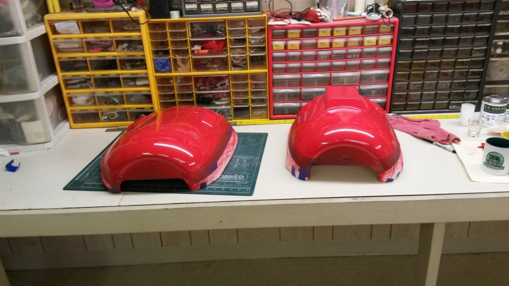

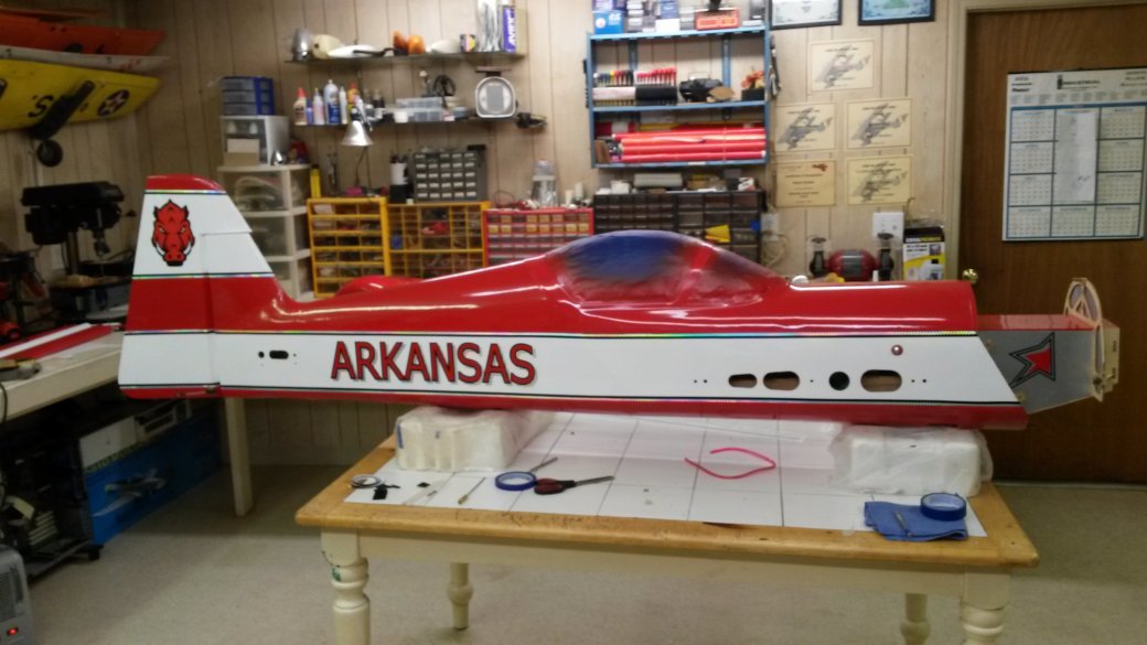

The paint had a bit of an orange peel look so I lightly sanded the cowl halves and canopy this afternoon. I mixed 4 Oz. of paint and went a little slower for the third coat and the finish is a high gloss now. Cam mentioned that it would take about four coats to get a perfect match with the Missile Red Monokote and that is turning out to be about right though it matches pretty well even now with three coats.

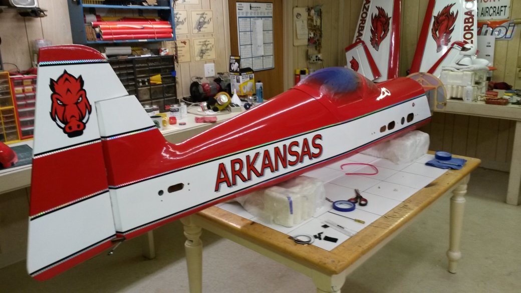

View attachment 51716 View attachment 51717 View attachment 51718
WOW!!!! That is just absolutely BAD ASS!!! I like!!!!:yesss:
