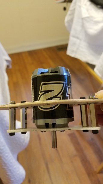

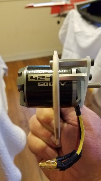

Honestly, looks like a bearing went south, and then overheated and heat developed loosened the magnets.
I think that is what happened to the motor in my Trex550e. I pulled it apart after a crash and the bearings were shot. I installed bearings and a shaft and checked the magnets and everything looked fine. But when I test ran it after just a few seconds the heli started shaking violently. I could see the motor can shaking so I pulled it back apart and two magnets had come loose and moved causing a bad balance issue. I'm sure the crash helped it along to.

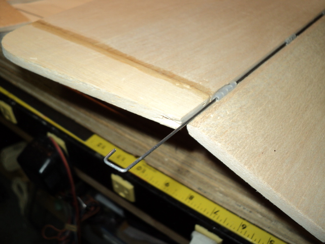

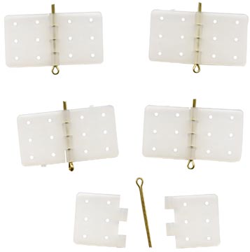

Hey there Snoopy1, those look like Dubro Heavy Duty 1/4 scale hinges (Dubro part # 257). They come in a package of 15 hinges with cotter pins as in the attached pics. I take the cotter pins out and replace them with .047 music wire to get remove-able controls as shown in the attached photo. Just use some tape to hold the 90 degree bend in place and you're done.View attachment 53547 View attachment 53548
Thanks found them at Toledo and bought a pack you were correct from Dubro and the number thanks.

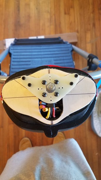

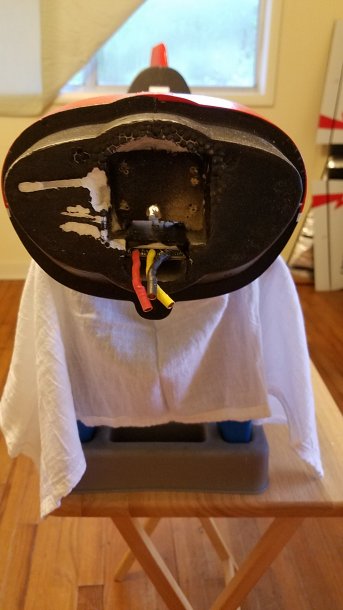

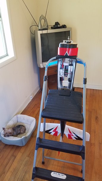

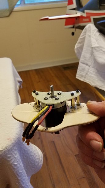

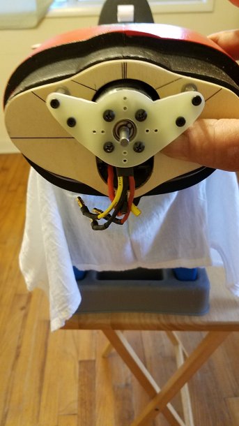

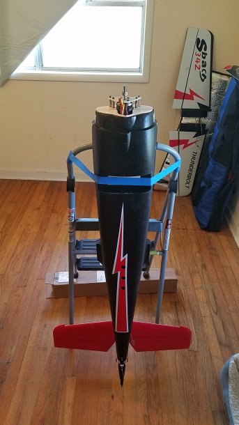

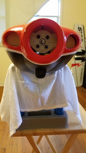

Got a little progress.......every thing is lines up and centered and now just let the epoxy cure :)
. Next I will drill a 6mm hole on both sides of the new f-1 plate. This will allow me to install two hollow carbon rods 24" long that will get glued to the inside of the fuse sides in order to give strength to the front of the airframe so the front won't break off during high G maneuvers.
