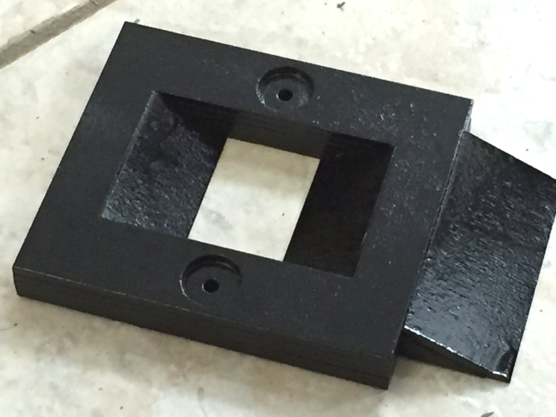

Two things.... first, I cut out these new wheel chalks for the trailer.... they fit the diameter of my whiterose wheels, perfectly... four layers of low cost luan ply, some glue and some paint... real simple and they work great.

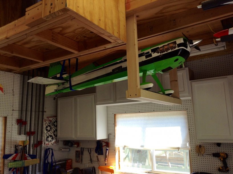

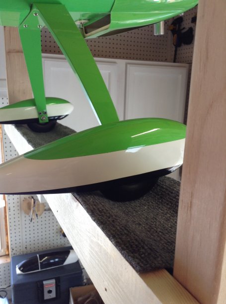

So I tried the bicycle lift idea to store my MX2. But I didn't really care for it. Seemed a bit sketchy and kind of a pain to use.
So I came up with this setup today. I like it much better. Sturdy and easy to use. I'm going to build another one just like it for my Stinson.

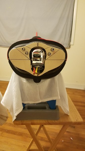

A bit more done. Completely opened up the "box" where the stock motor mount screwed in. No provision for cooling air to get through:concern:. Motor was doomed right out of the box for sure. The debris I found in it was just the beginning.

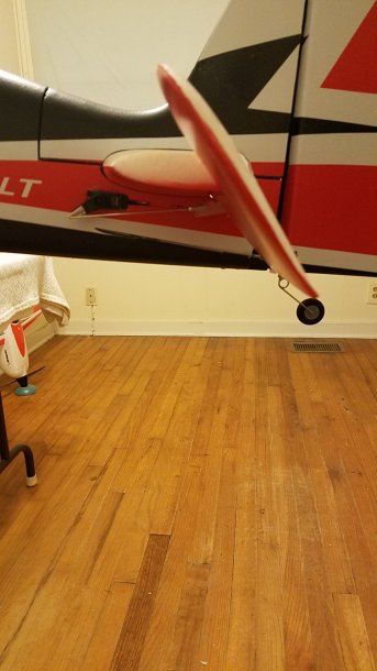

I relocated the elevator servo to the rear of the fuse for better control surface throw and offset any bit of additional weight up front.
