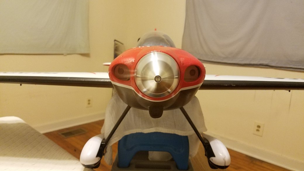

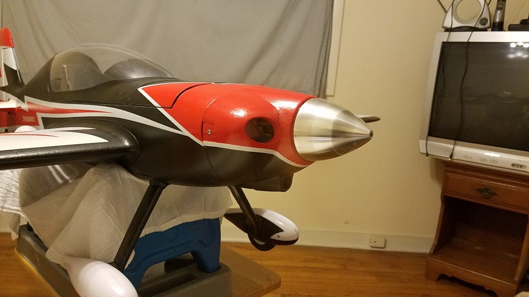

View attachment 54098 View attachment 54099 View attachment 54100 View attachment 54101
That spinner is sweet looking however! Shame the motors keep going south.:gnashing:
got the spinner and prop drilled and cut tonight. Now I just need to paint it.

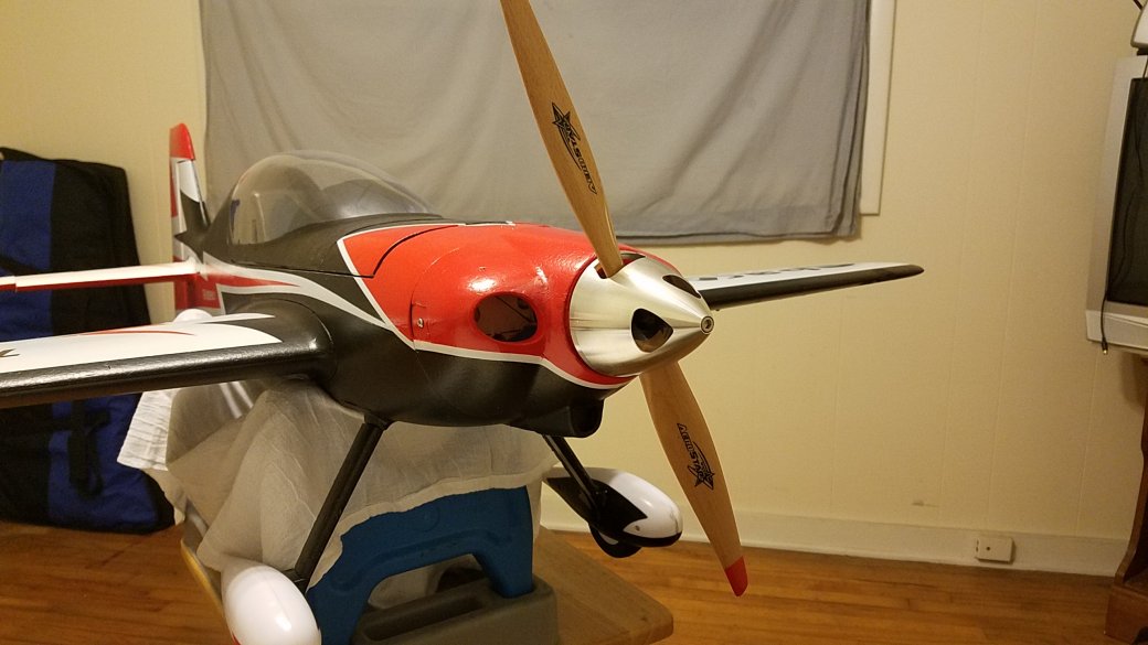

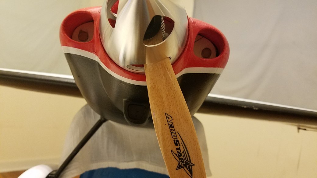

I got the 3 blade prop in from Adi in Israel today! Everything is perfect on the prop. @TazmanianDevil KNOWS how to pack a prop!
So, I was turning a 29 x 12N at 6300 on the ground. I bolted the 29 x 12EVO on and it is turning 5450 after everything is warmed up! I am confident the 176EVO has enough grunt to pull the plane with this prop and I love the fact that the rpm is down. It looks like Wednesday or Thursday are the best chances to get the plane back in the air. I pulled the 32 x 10 off the del-170 in the Edge and put the 31 x12 on it. We will see how it acts if I get a chance to get it fired up soon. We have got winds blowing 20 to 40 here today so it is not even a good day to just put a plane together and test run it. I had to do it with the Extra though :) One thing I just thought of, the wind was blowing against the back side of the prop while running it so, I probably have a few more rpm than what showed up today.

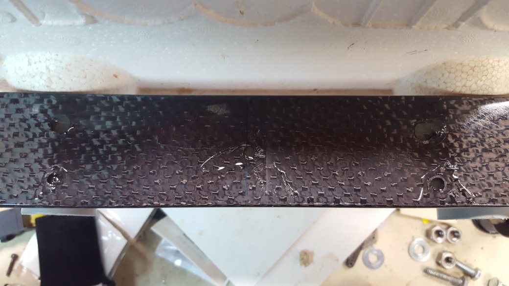

Trying an experiment. Had a nice cf landing gear from an old 40% plane that met its demise due to an engine failure long ago and figured I would fill the mounting holes with 30 min epoxy so I could redrill the gear for the 330LX. We will see how things turn out tomorrow after work becuase I am giving the epoxy plenty of time to cure before I try to drill the gear.
