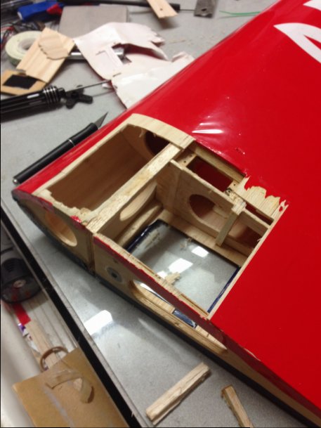

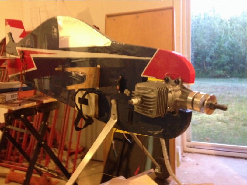

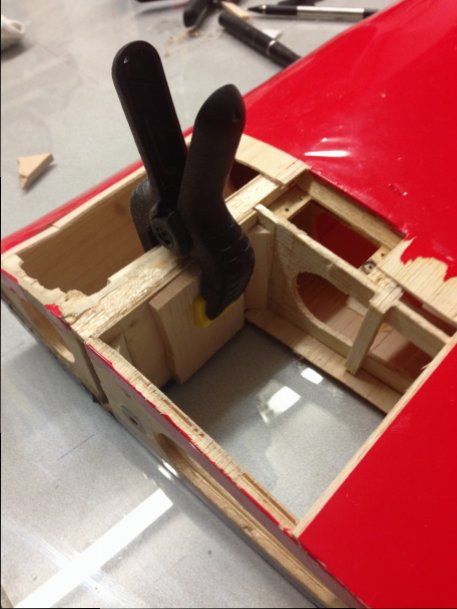

Working on repairing the sbach65 profile that was giving to me. Basically only thing that was damaged was the joiner box on the left wing. Basically it's the wing tube socket cept no wing tube its a joiner block (you can see it in the last pic of the fuse). So I removed some covering and some sheeting so I could free everything up. Then mixed up some epoxy and clamped everything in as well as adding some extra tristock around things. Then I installed my dle20 while waiting on epoxy to dry.

i'm undecided, it's got a G62 with magneto ignition and a big chunk of lead for weight under the tailwheel spring....so I'm thinking if I"m really seriously in love here I should either convert the engine (which is like new) to electronic ignition or replace it with something similar that is going to be much lighter. Between the weight savings in the nose and removing the weight in the tail the thing should be so much better off....but don't want to spend any money at the moment to do this.....decisions, decisions
The answer is sitting on your shelf Bart;) Slap that DA50 on there! Sell the G62 to help fund the project.:way_to_go:

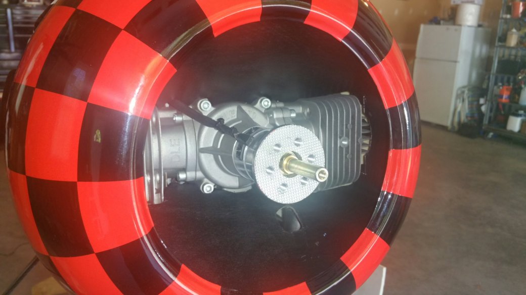

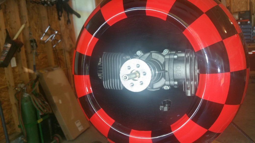

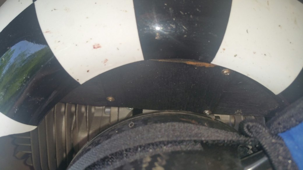

The top pic is of my 35% .if you run stock muffs you have to put that removable plate in to get the cowl off. The bottom pics are of my 37.5 yak i already had the prop off so took pics of it. Same as my 35% baffling except for the removable plate. They are made out of light ply shaped like a half moon angled back to the cylinders. Glued in with goop. Make them long and slide the cowl on and mark where you need to cut out for the engine. Keep doing that till the cowl goes all they way on without the baffling hitting anything.
