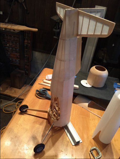

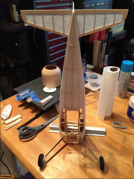

are you seriously covering it with paper towels? that'll be great for absorbing spills but how does it do with the paint?
Ha! No. Papertowels are because I'm messy.
Covering is Polyspan. Slightly time consuming, but I wanted something a little different. Dope the entire structure, sand with 320, apply Balsarite, and iron on. Shrink with the iron. Then, one coat of full shrink dope, another of non-taughtening dope. Finally, prime and paint.
