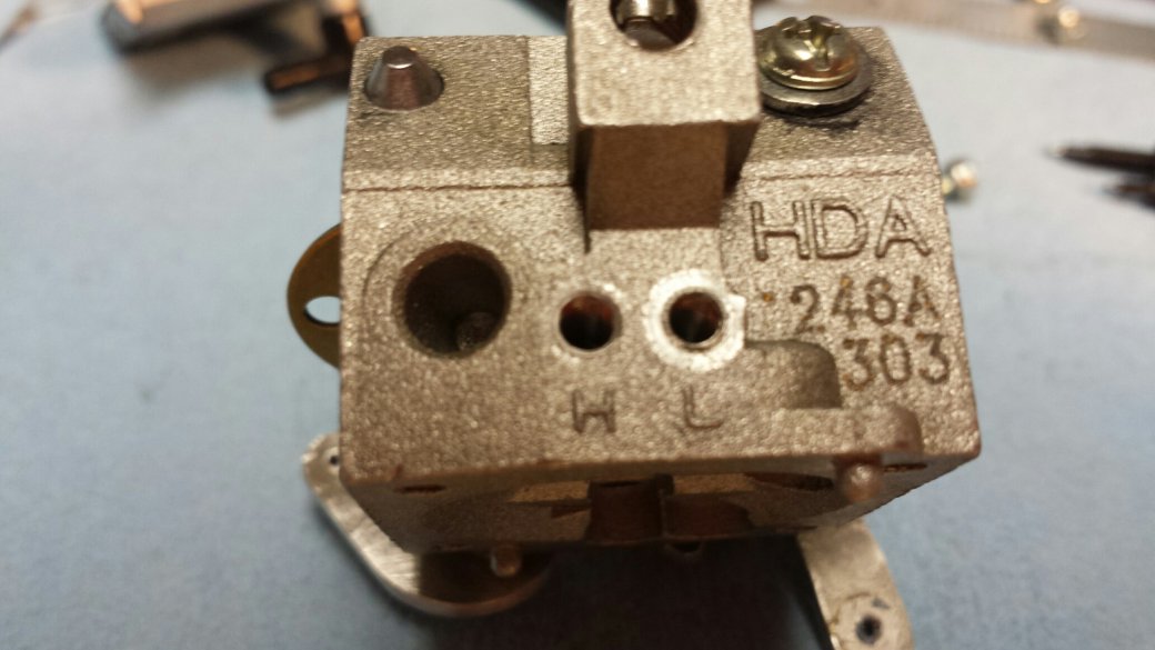

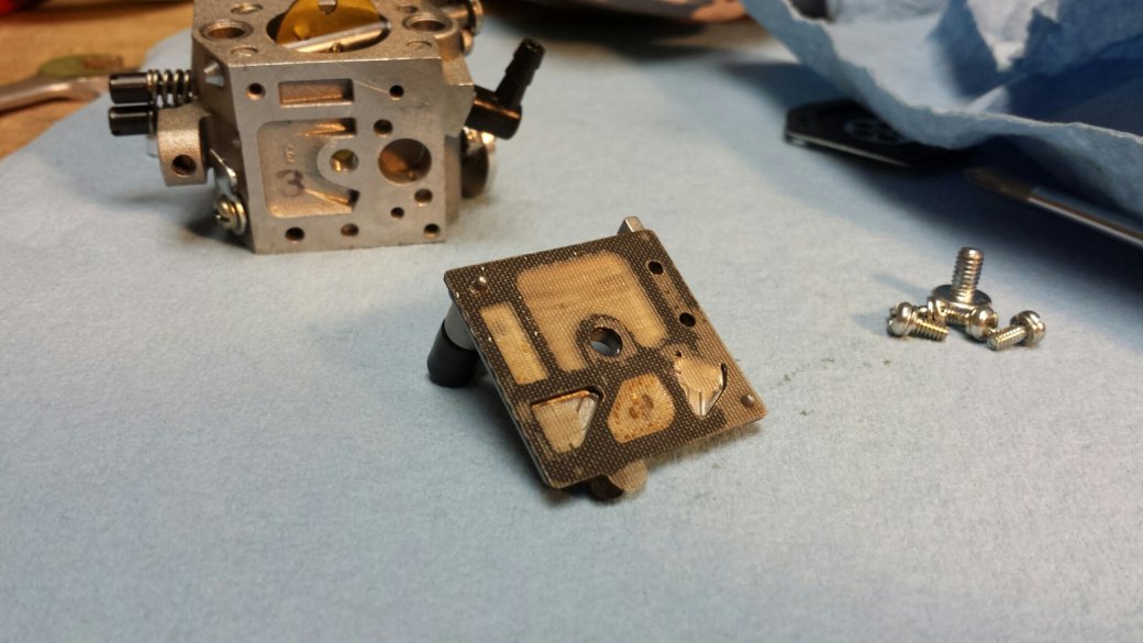

I've been working on the carb on my GP61. Ever since it was new I had to run the needles at 2 3/8 on the low and 1 on the high. It ran fine like that for over 3 gallons, but I've been having some issues with it lately and I decided it was time to take a look at the carb. This engine always amazed me with how dry it stays inside the cowl. There has never been a drop of fuel anywhere. When I pulled the cowl off the other night it was obvious something was leaking. It turns out there was a leak at the metering diaphragm cover.

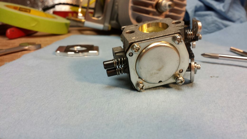

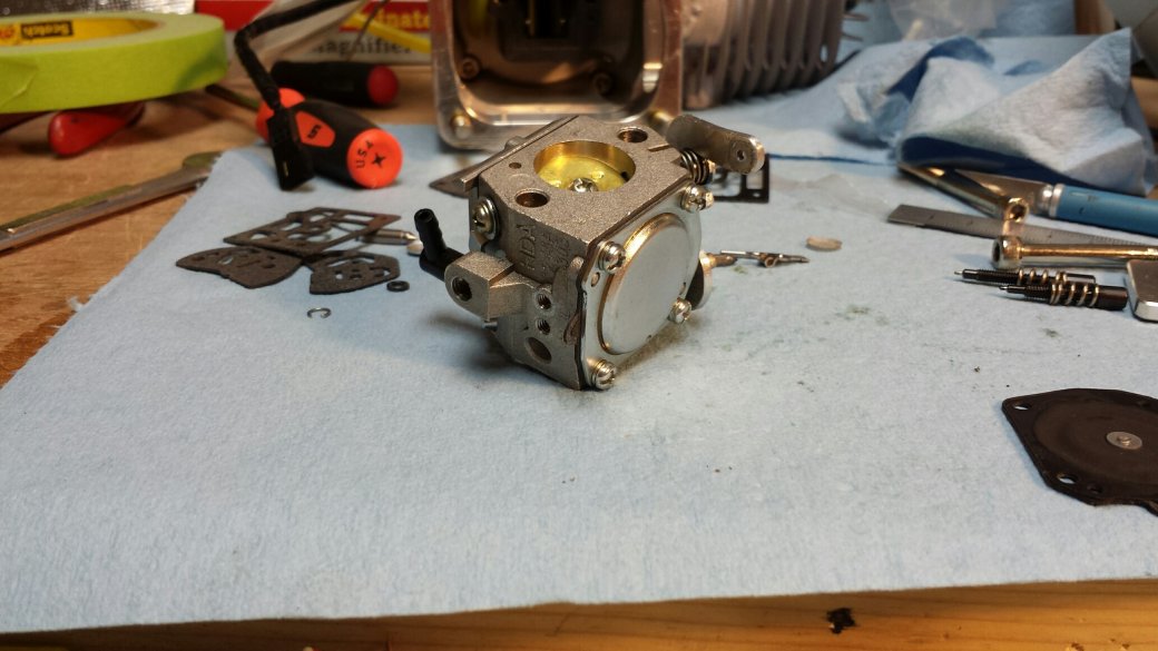

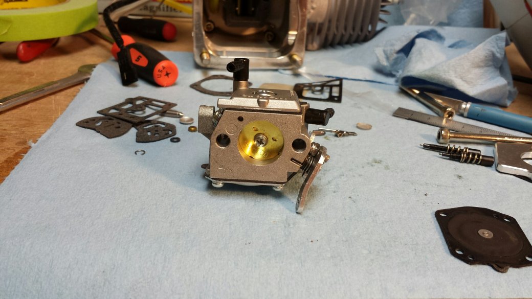

When I took the carb apart the metering cover was tight, and all the gaskets look fine. The carb screen was very clean and everything looked great. I ran some carb cleaner through everything and made sure the three idle holes were clean, open and flowing. I blew a little air through everything, checked the metering lever height and reassembled it with new gaskets.
Before I reinstalled the carb, I checked the reeds and the gaskets and it all looks good. I've got the carb back on and everything is mounted to the removable engine dome. I'm going to try and get it back together tonight and test run it Saturday.

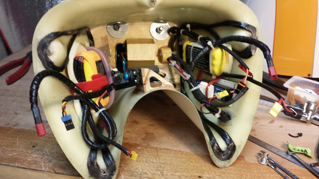

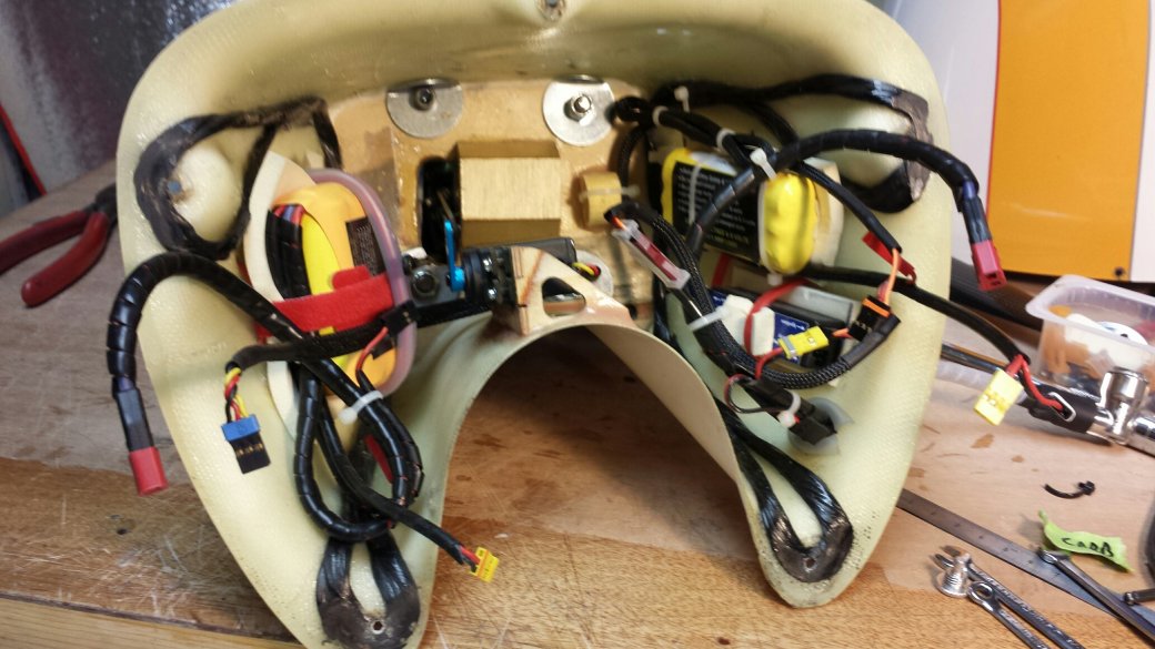

I've talked before about how crowded the inside of the engine dome is so I added a picture of that.

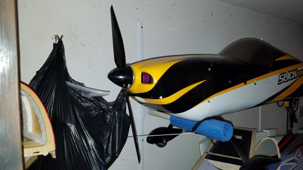

Lastly, my 25% Slick got some much needed love with a new propeller. Replaced the old broken Xoar PJN electric with a Falcon Carbon electric. The Falcon is 1/2oz lighter than the Xoar, and it's a 20" prop vs the Xoar's 19". Pretty stoked to go out and fly the Slick again, it's been my go-to travel airplane when space is tight and I still want to fly something big.
