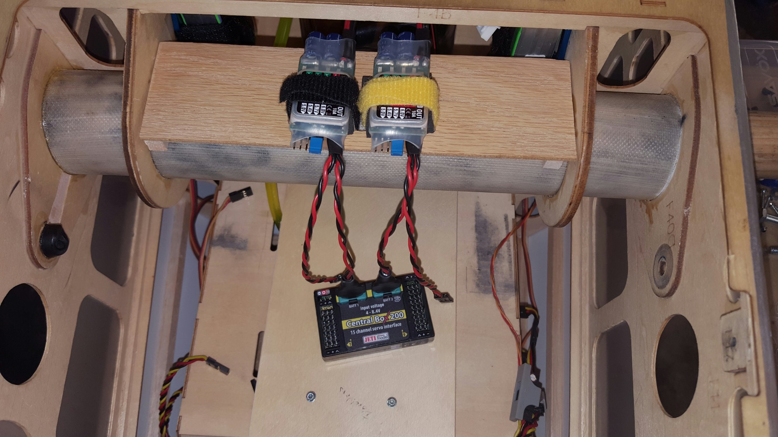

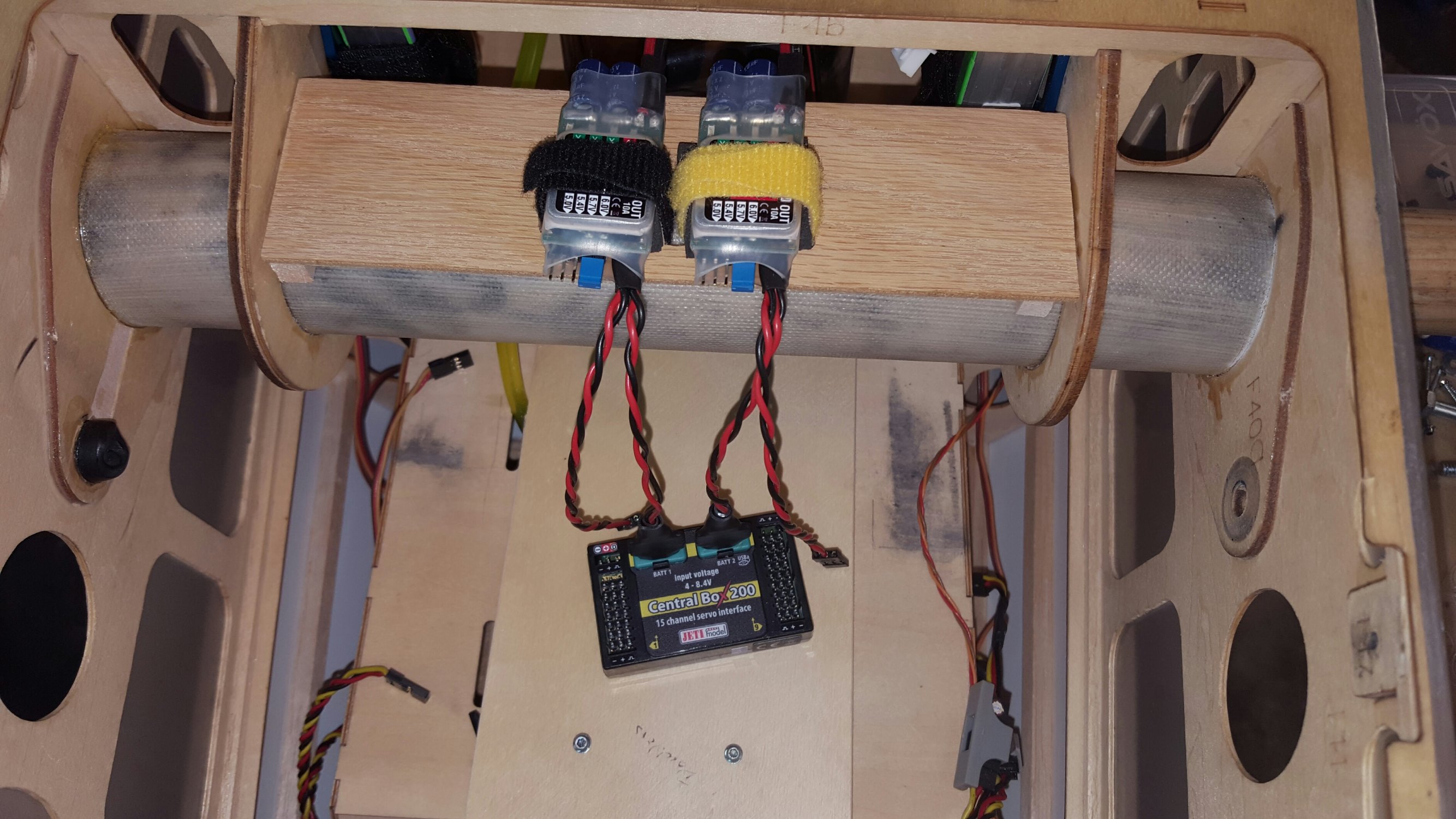

Started the electronics upgrade in the Edge tonight. Smartfly EQ6 is out and JETI CB200 is in :)

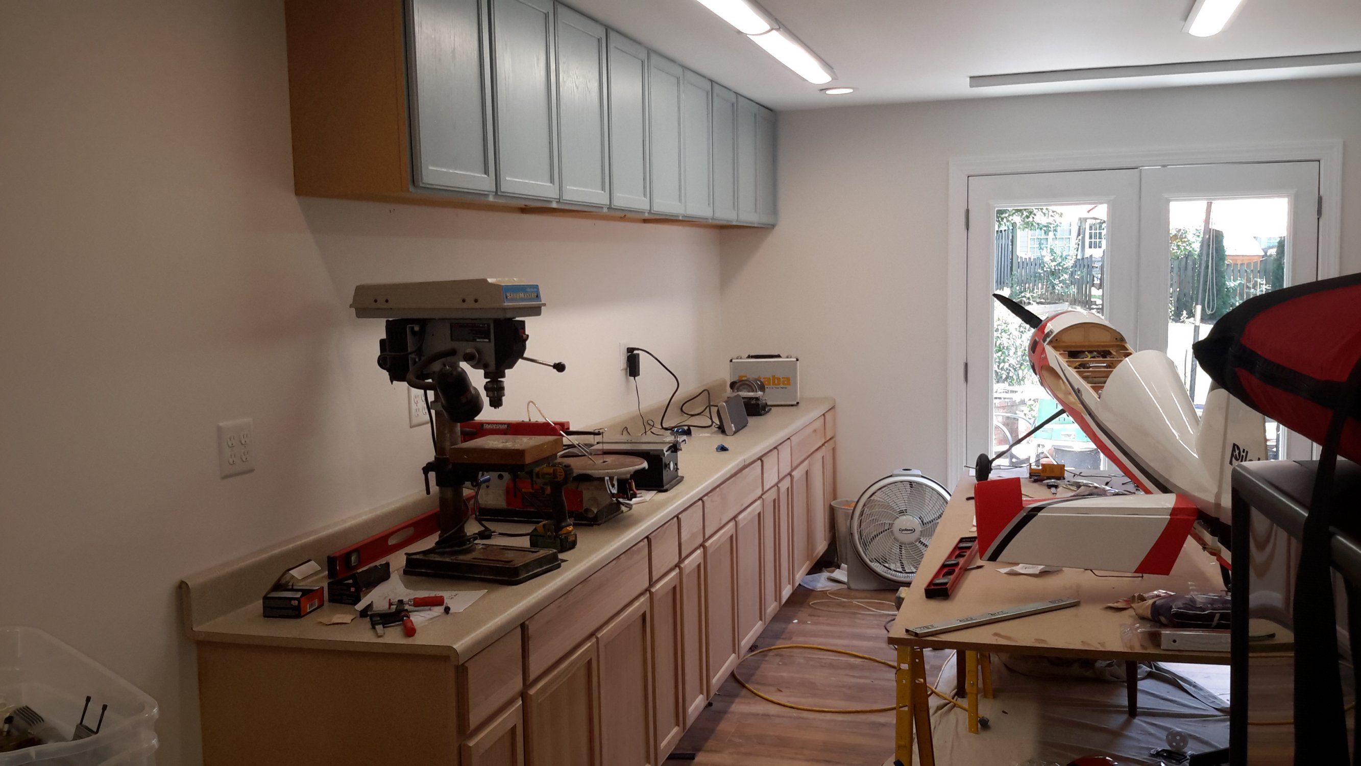

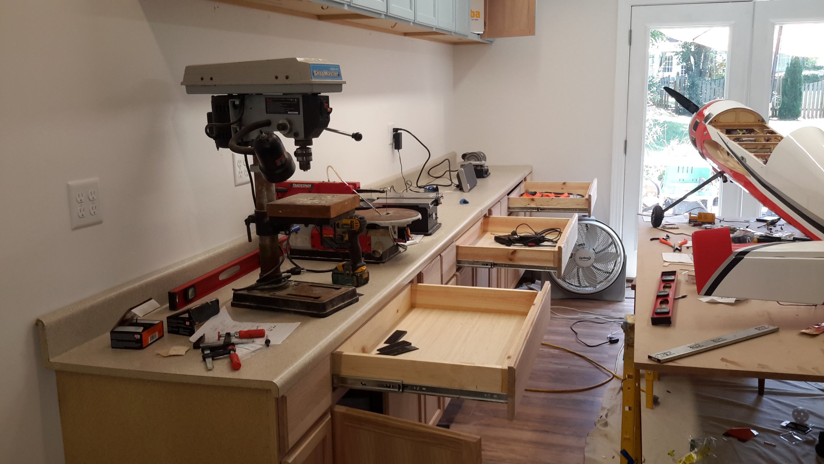

Should the countertop not be a nice piece of aluminum plate 1/4 thick all bent to fit the top now that would be special.
