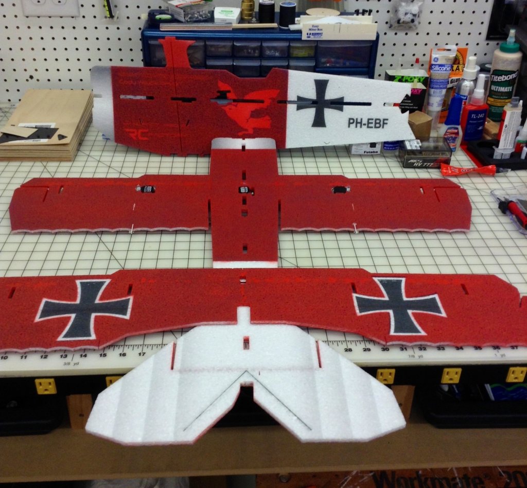

Paint work is done on my Crack Fokker and a good start on assembly.

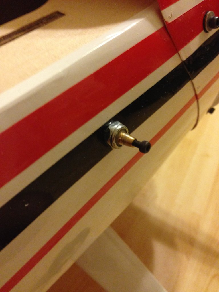

So this is the fuel filler I mentioned yesterday that I made. Pretty simple to make and I think will work well. All I did was take a 3" long 10-32 brass screw (I'm sure anything will work I just choose brass as it was on hand and is a soft metal. Chuck it up in the lathe and cut the head off of it. Now square up the end and then bore a hole right through the middle of it. I went an inch deep to provide me with enough usable material. While still in the lathe go ahead and tap the end of the hole to 4-40 and only go about 1/4" deep with the tap. Now go ahead and cut the whole thing to the length you need. Use a disc sander to taper the ends a little so the fuel tubing will go on easier. Finally use two lock nuts to secure it to your fuse and hook it up. Once in I just grabbed a short 4-40 bolt and thread it in till its hand tight.

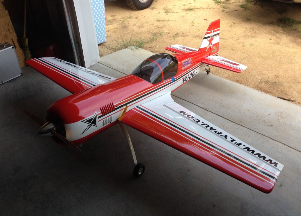

So my 20 some odd year old fish scale said my sukhoi weighs 18-1/2 lbs. just checked it on my nice digital bathroom scale and it says it weighs 15.8 lbs. if that's the case this thing should have some grunt coming out of a Hoover.

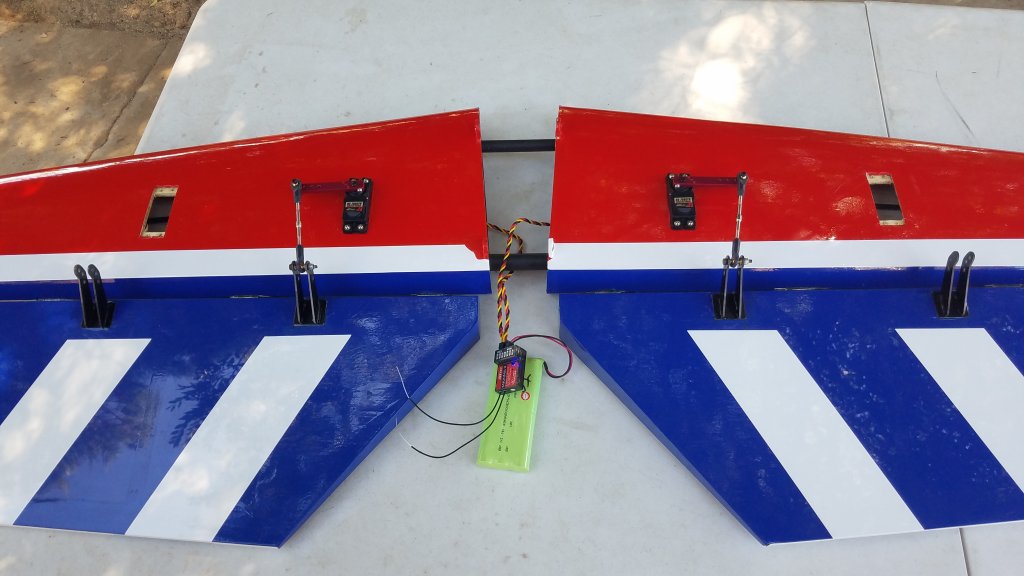

Nice, been working on the aileron and flap turn buckels. So far I have all eight turned and right hand threaded clevis completed. Forgot needed to order left hand tap and die 4-40. I guess I will do that this evening.
