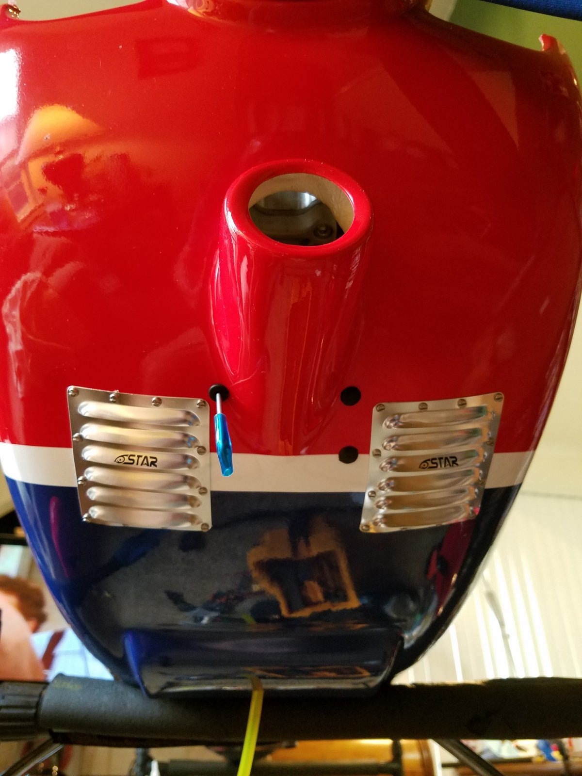

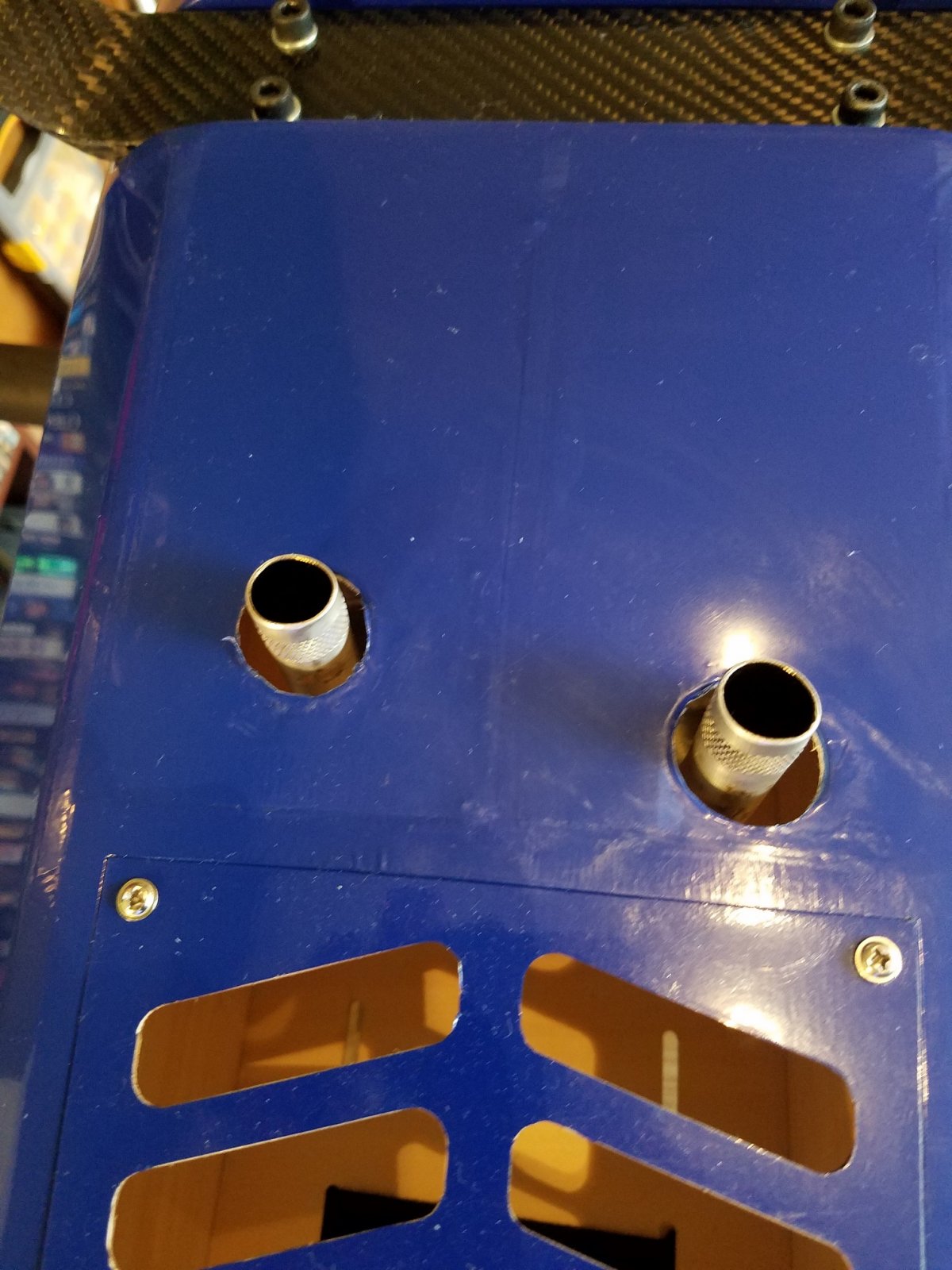

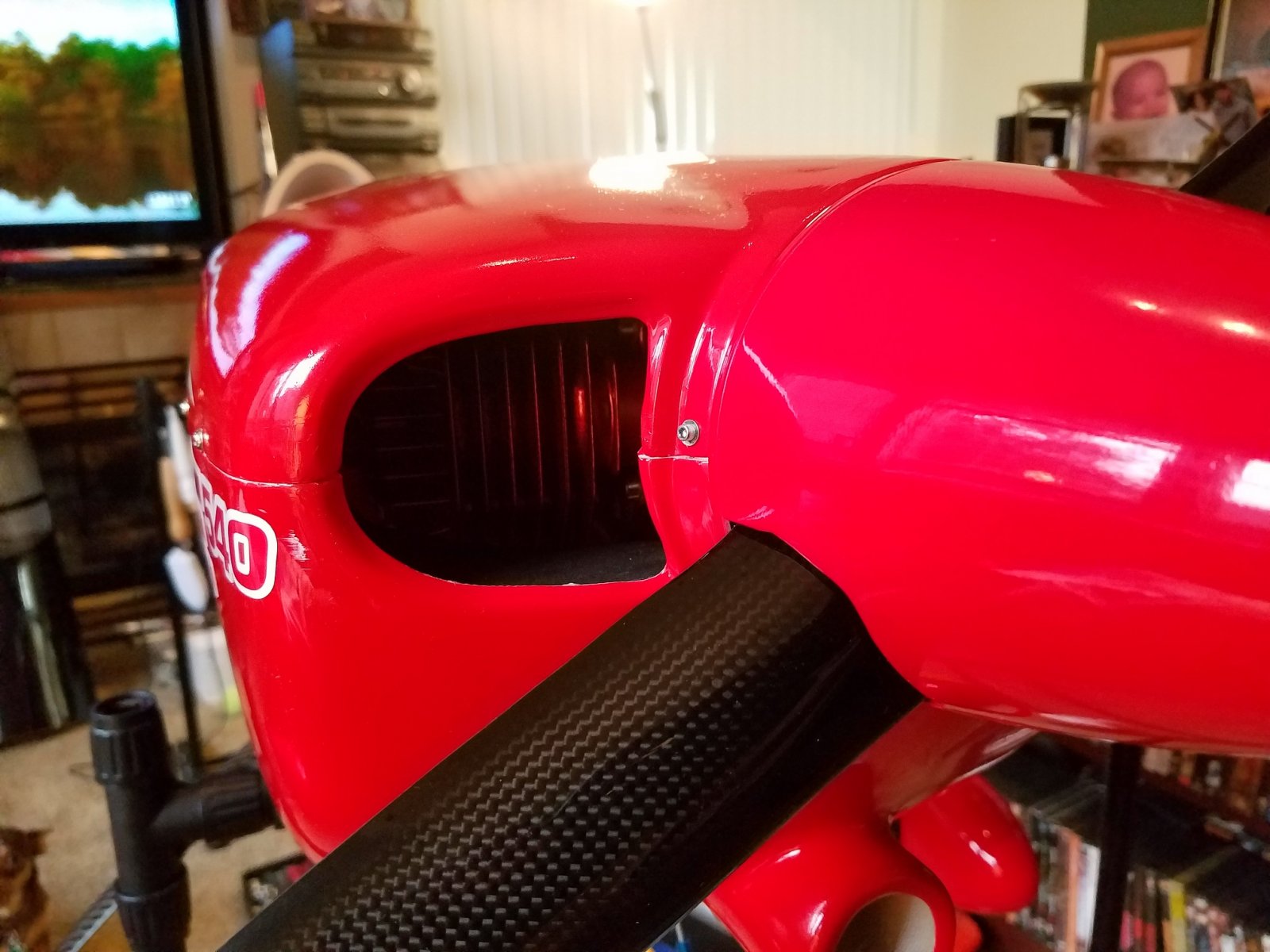

Worked on the control horns and landing gear on my new 104" ARS!

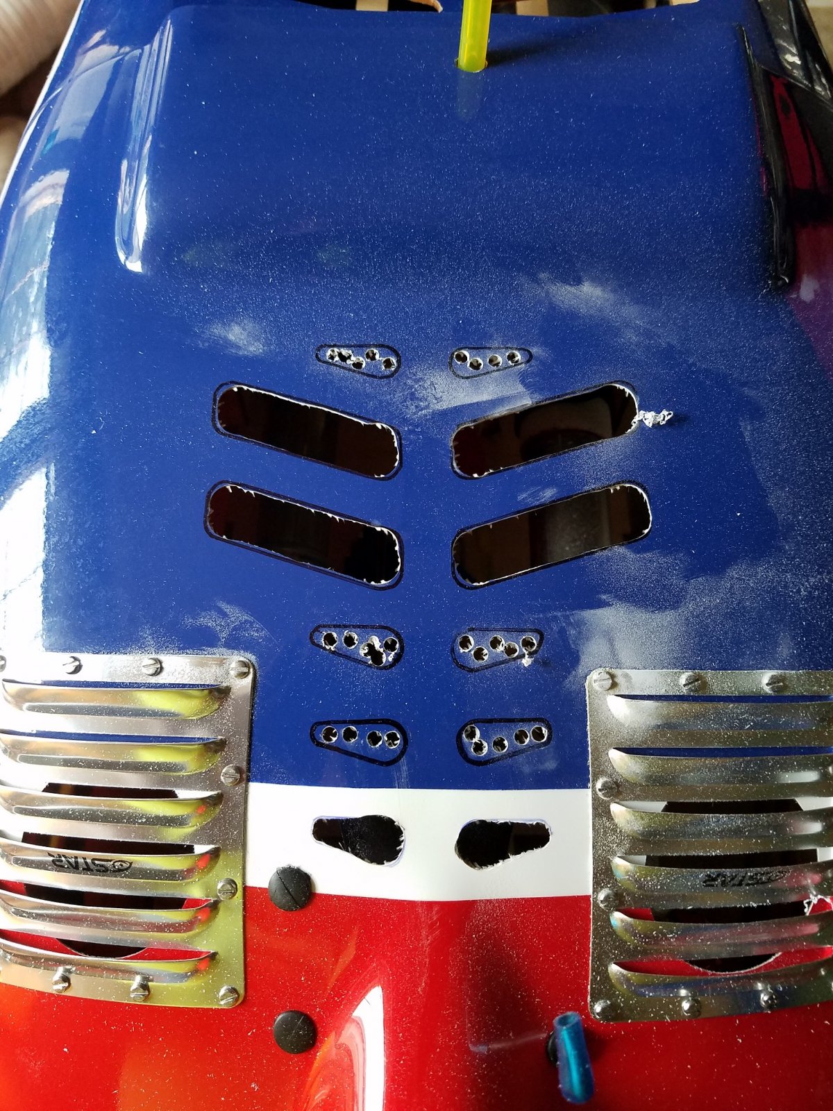

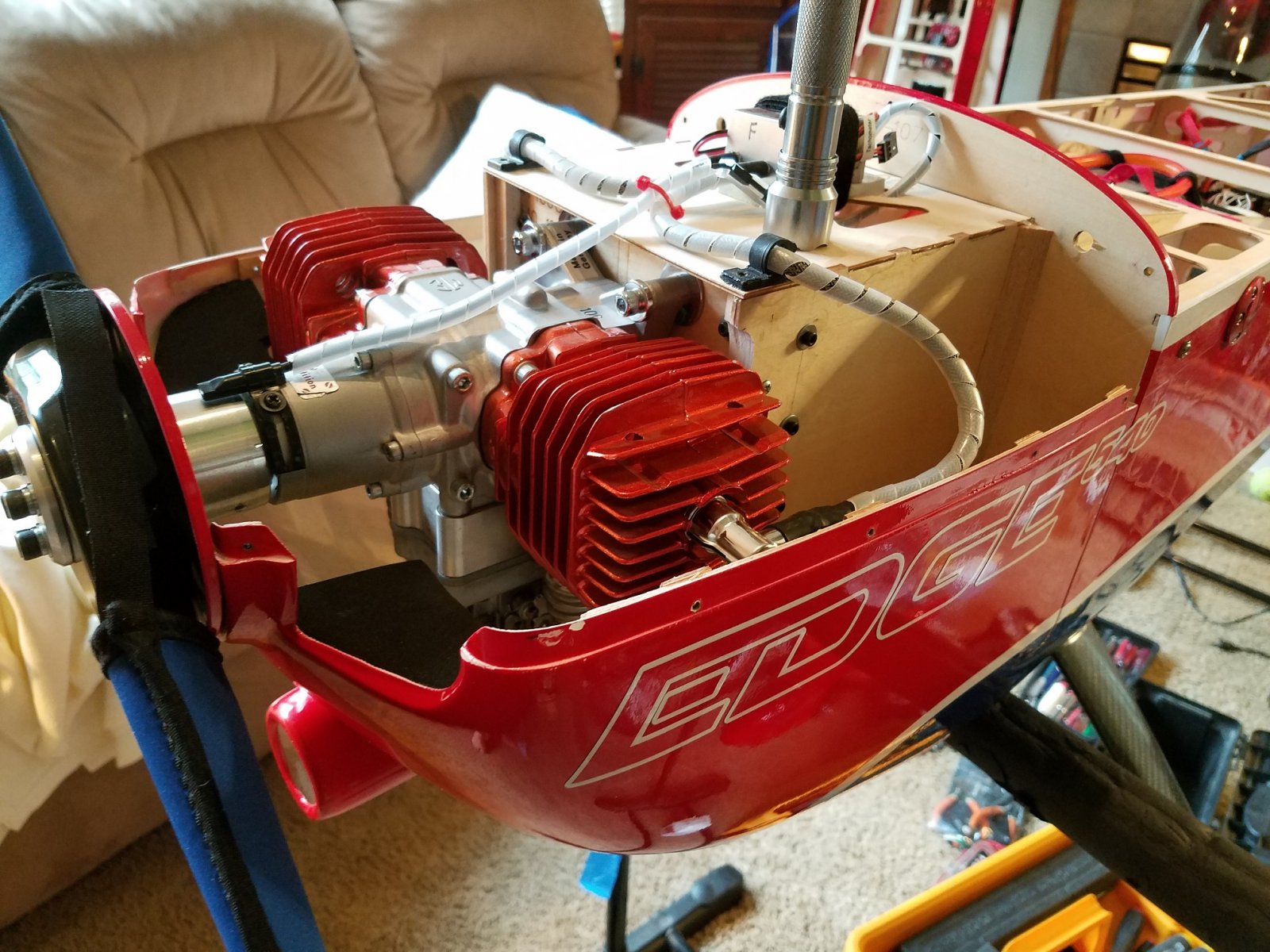

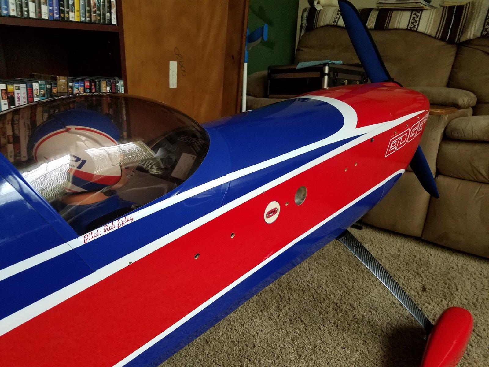

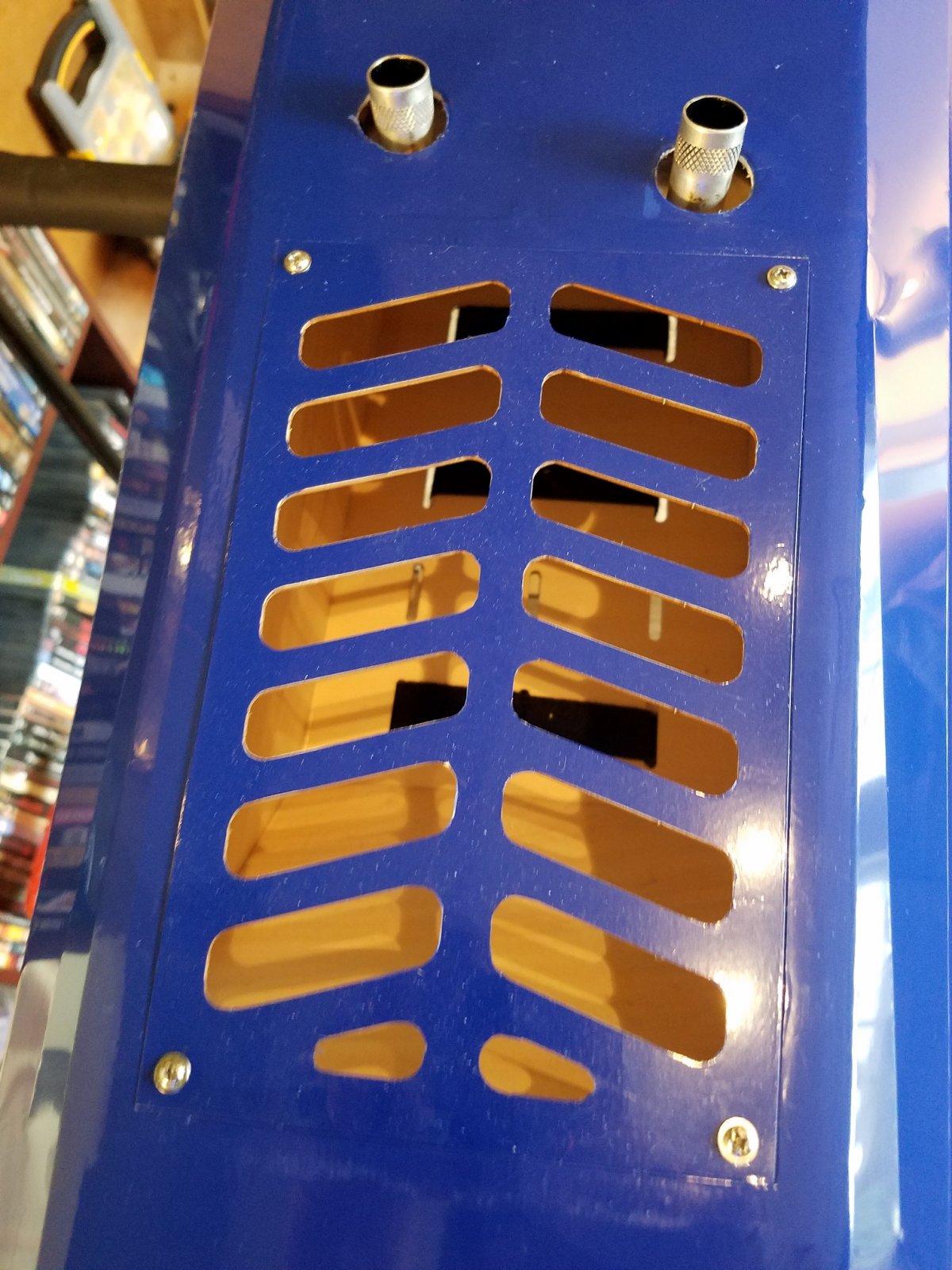

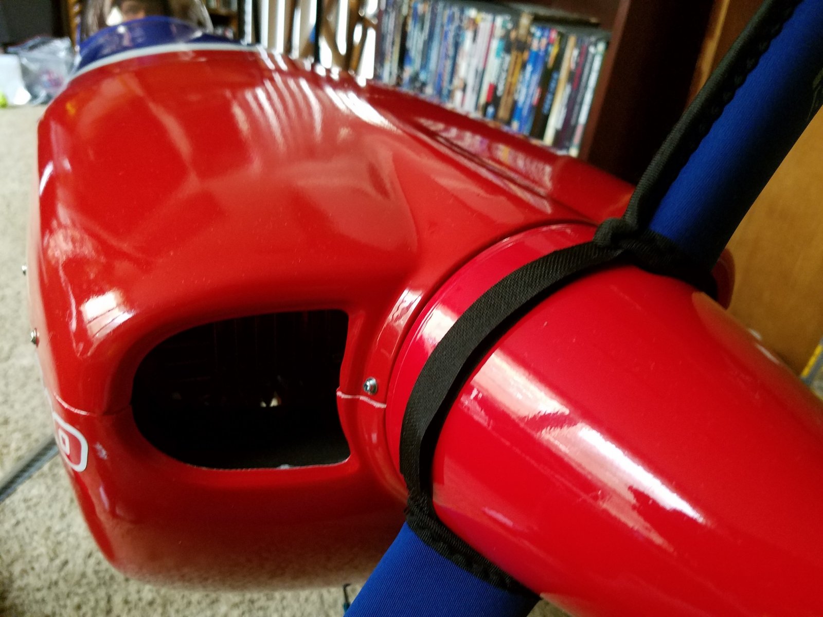

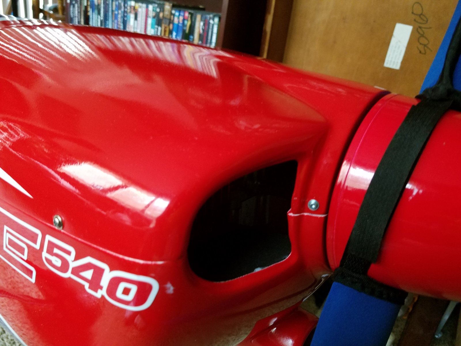

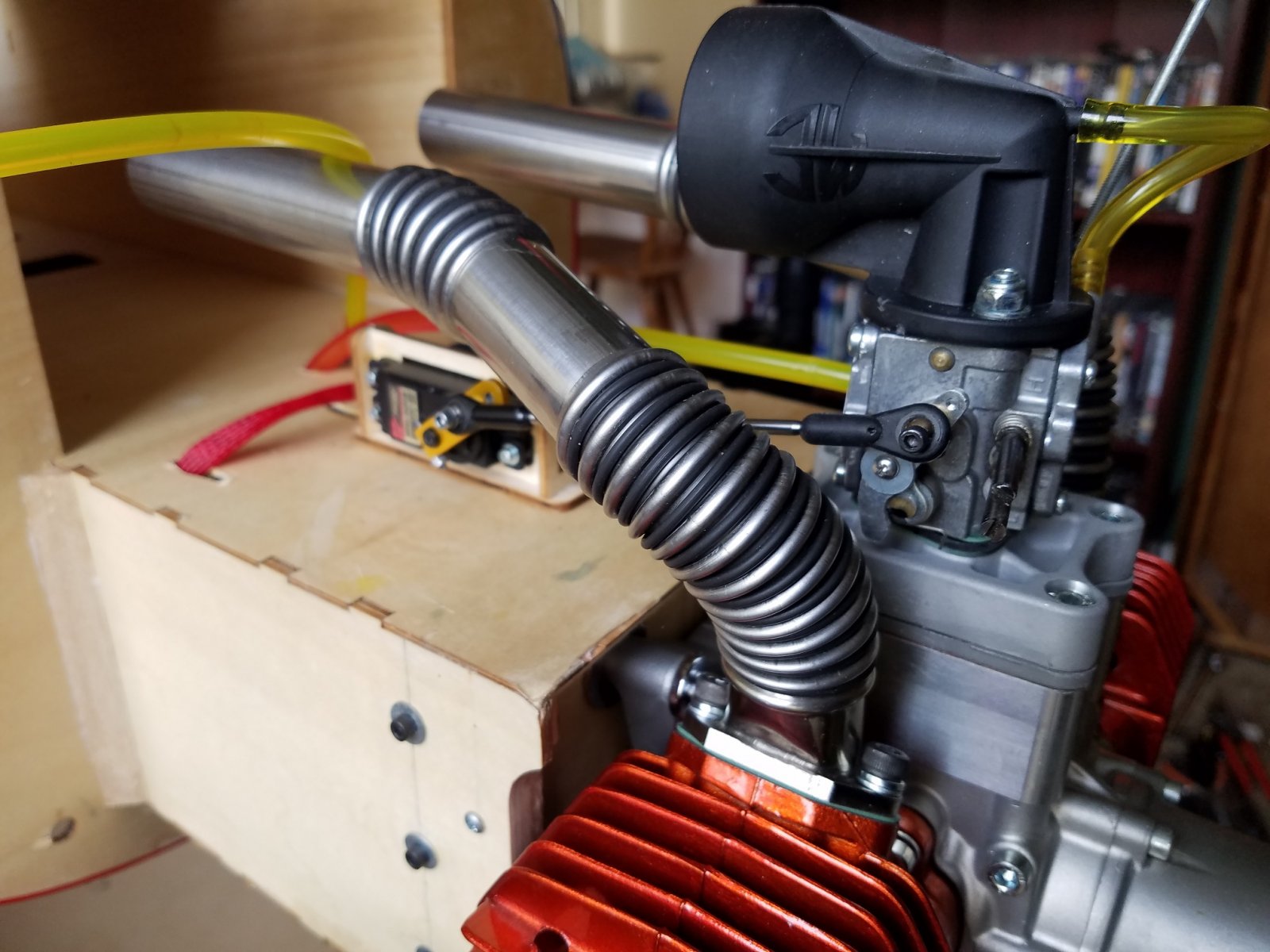

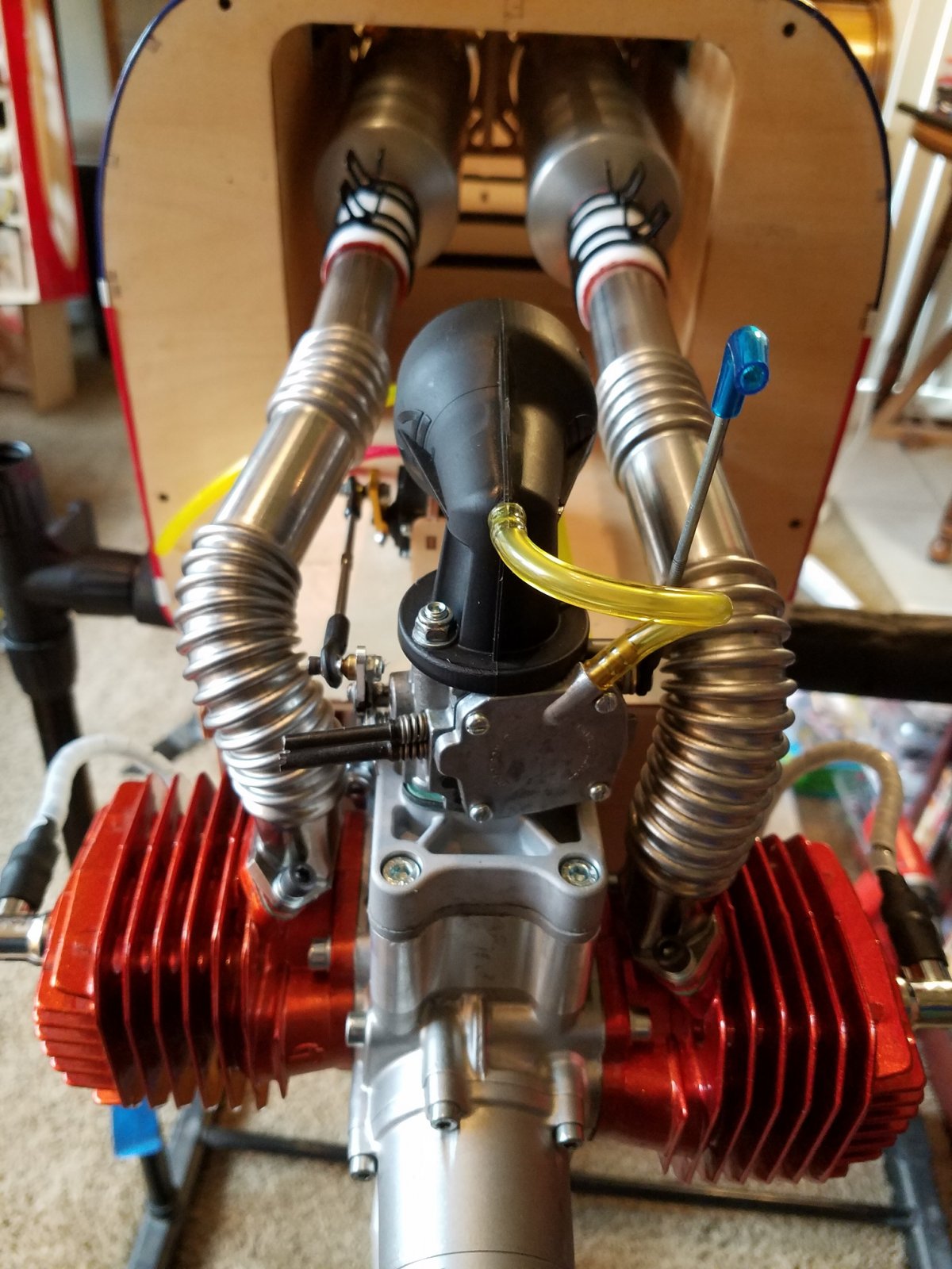

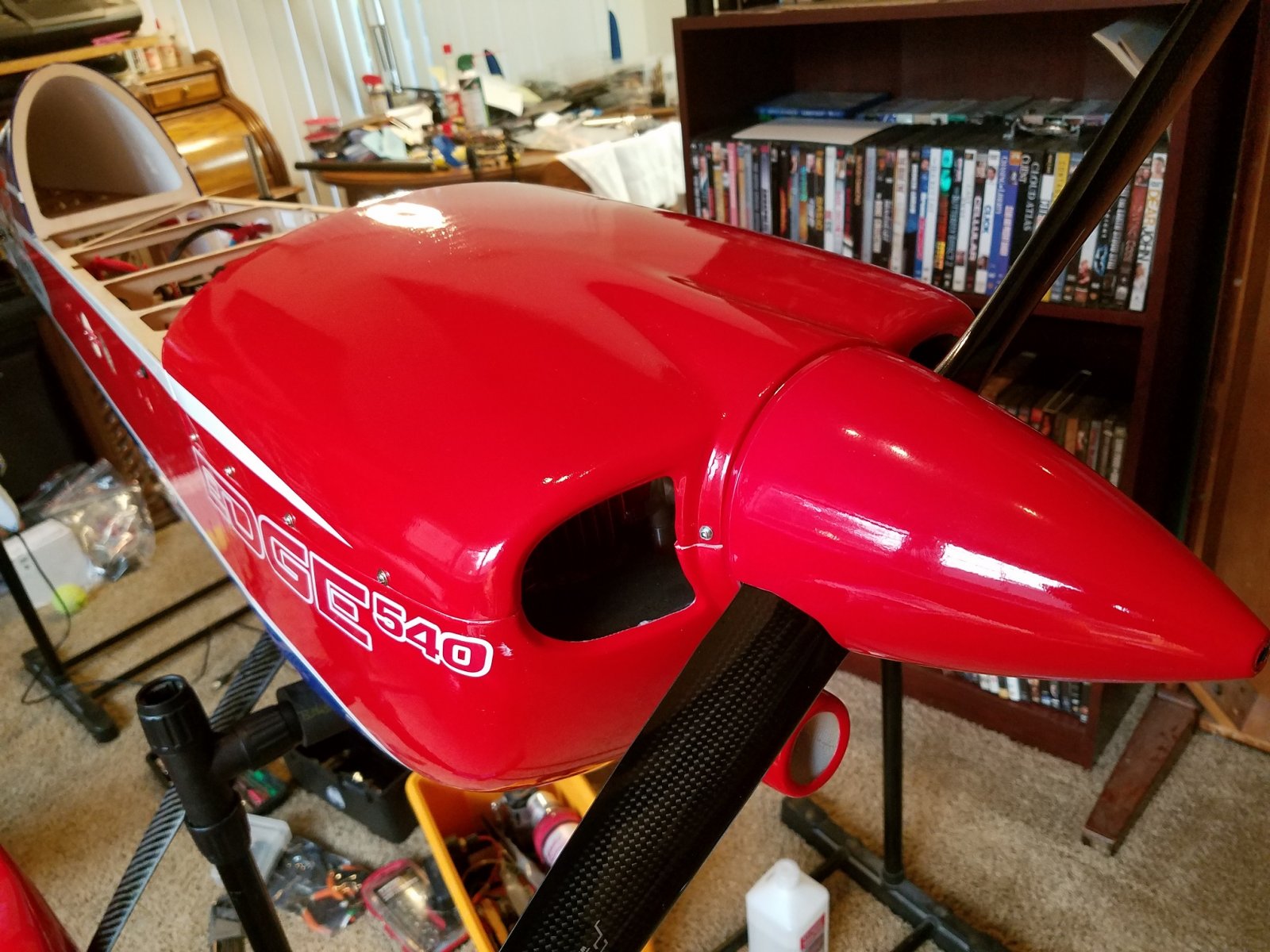

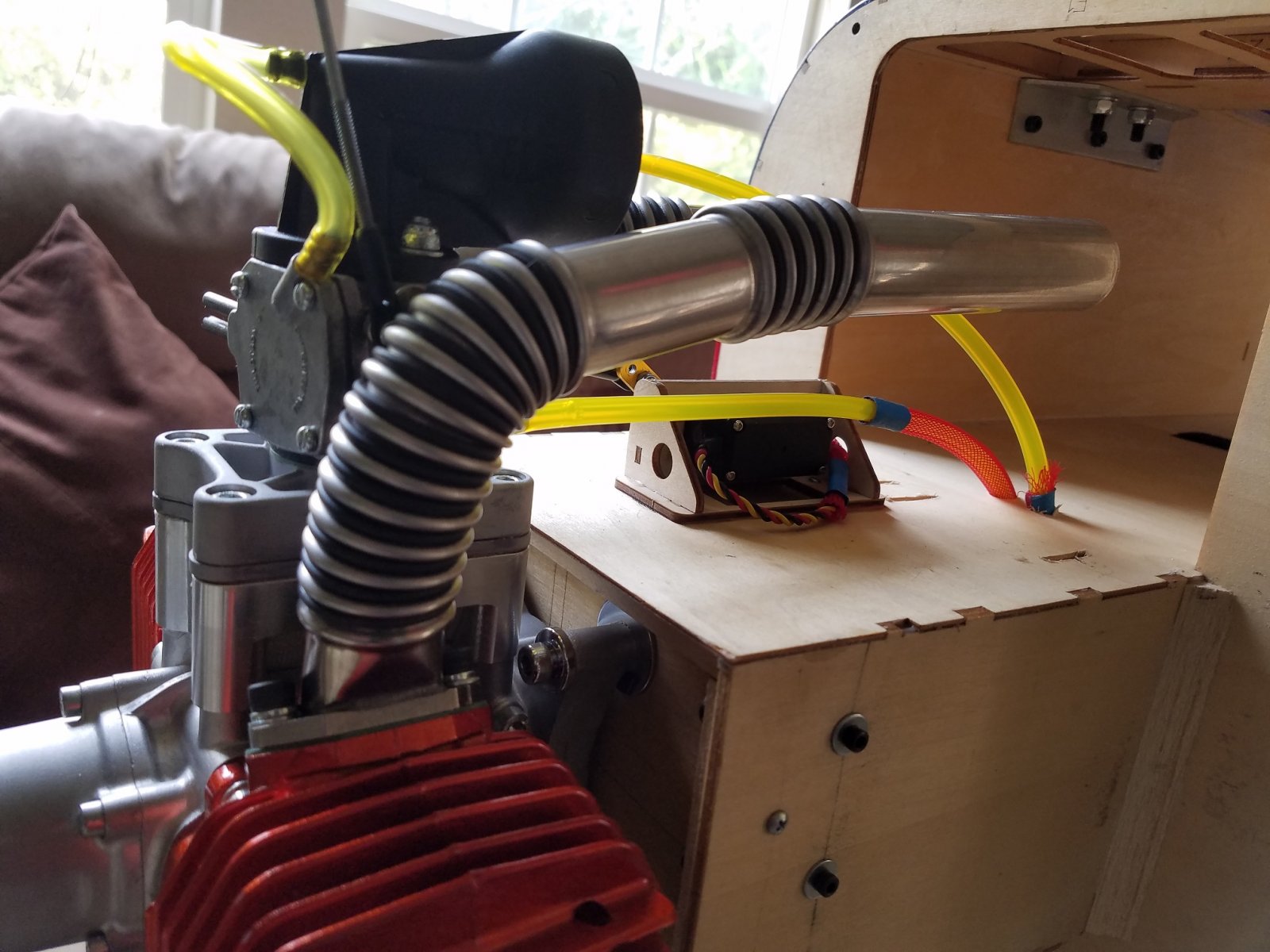

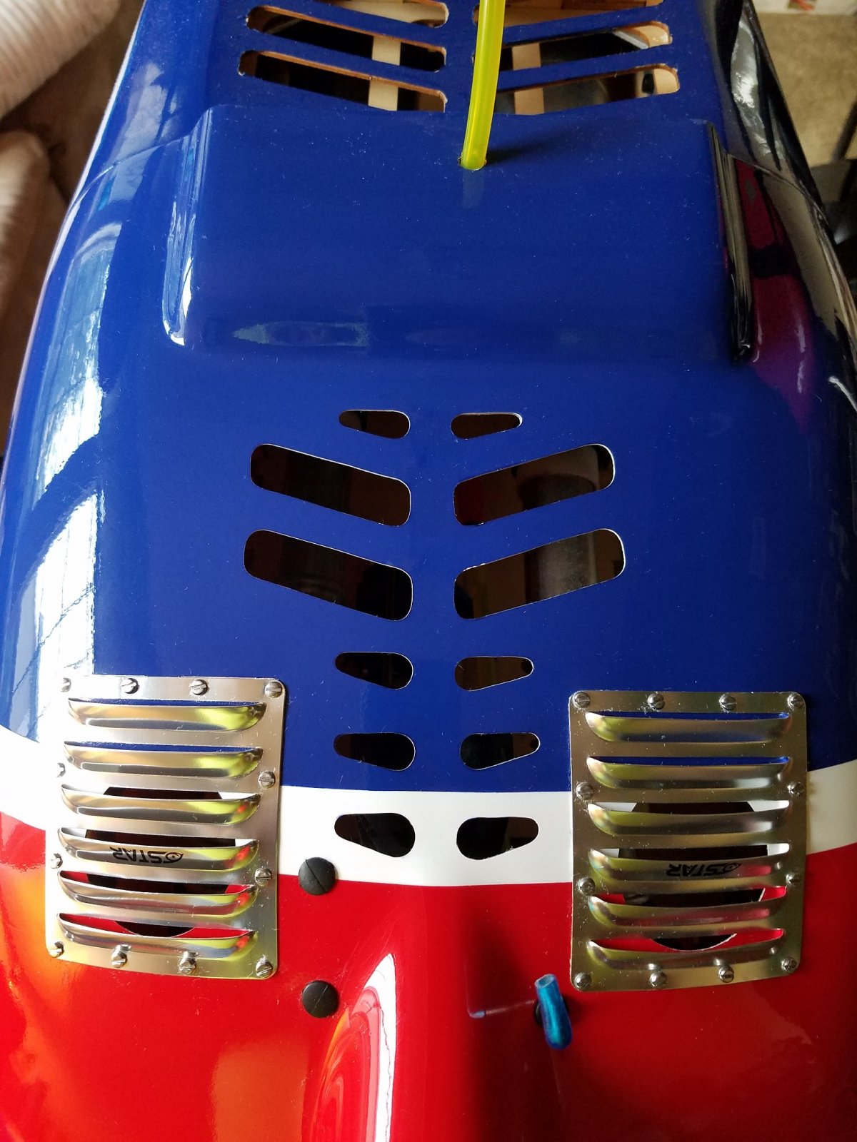

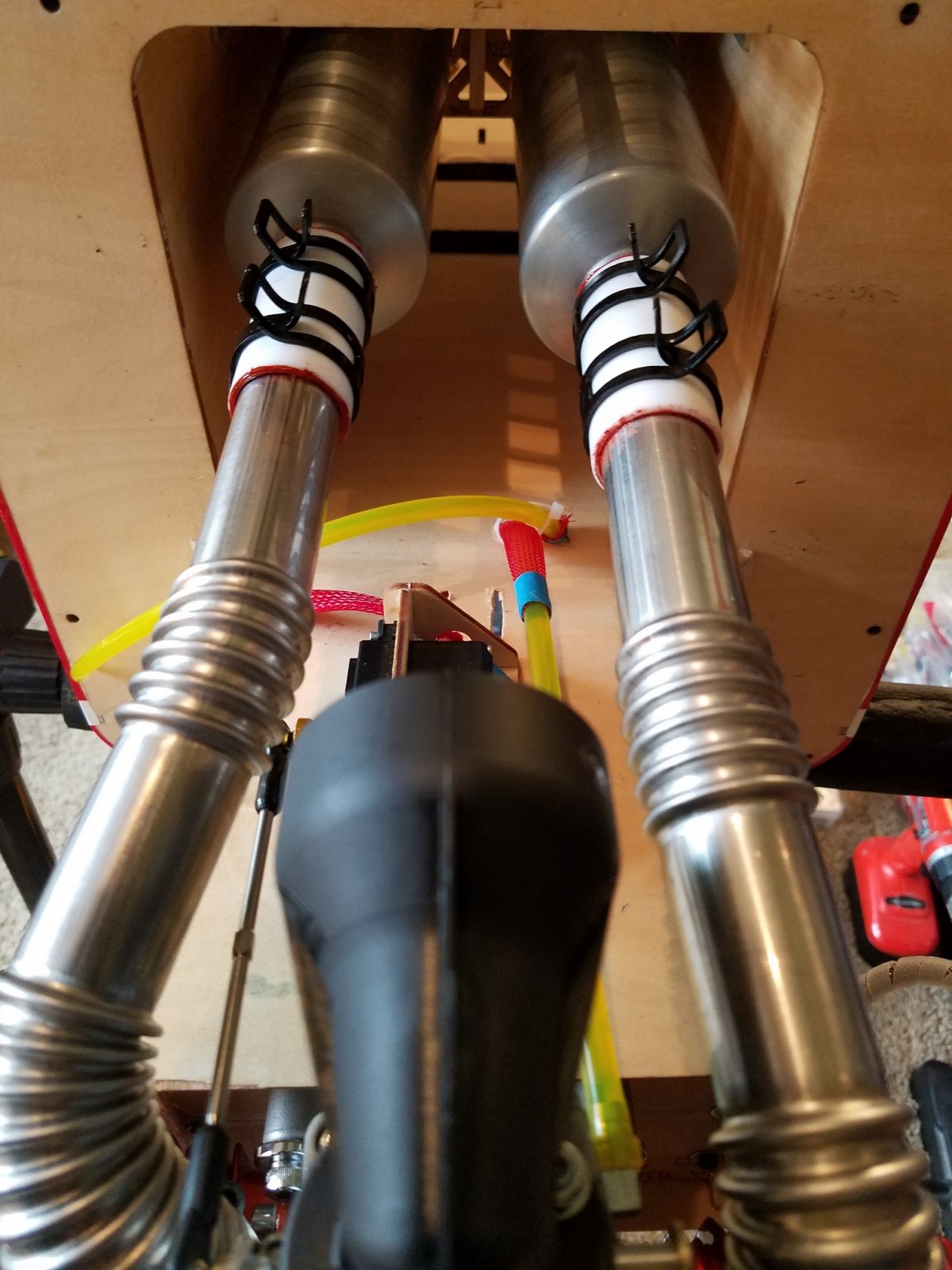

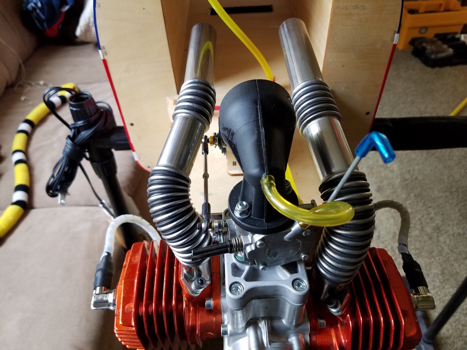

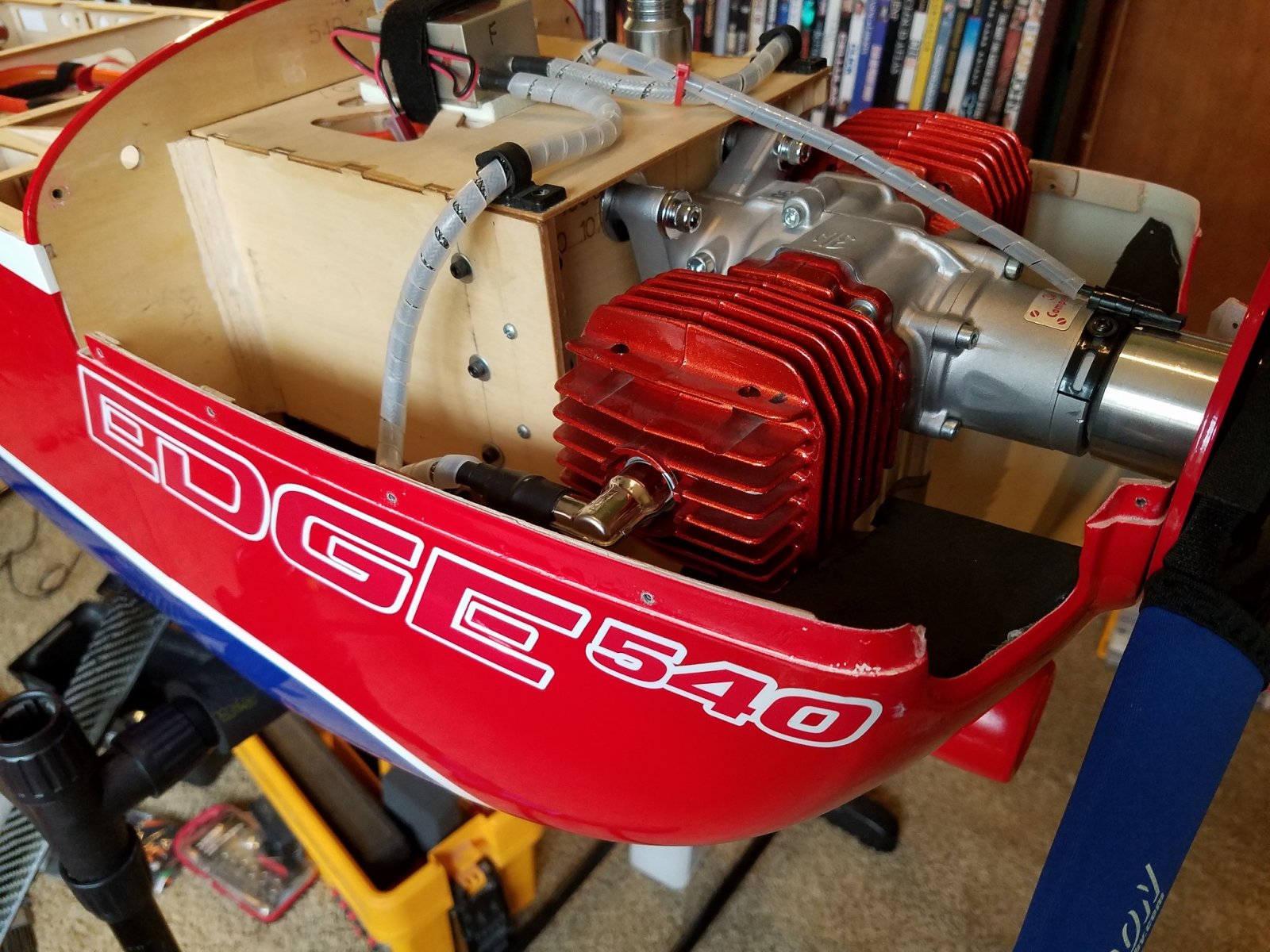

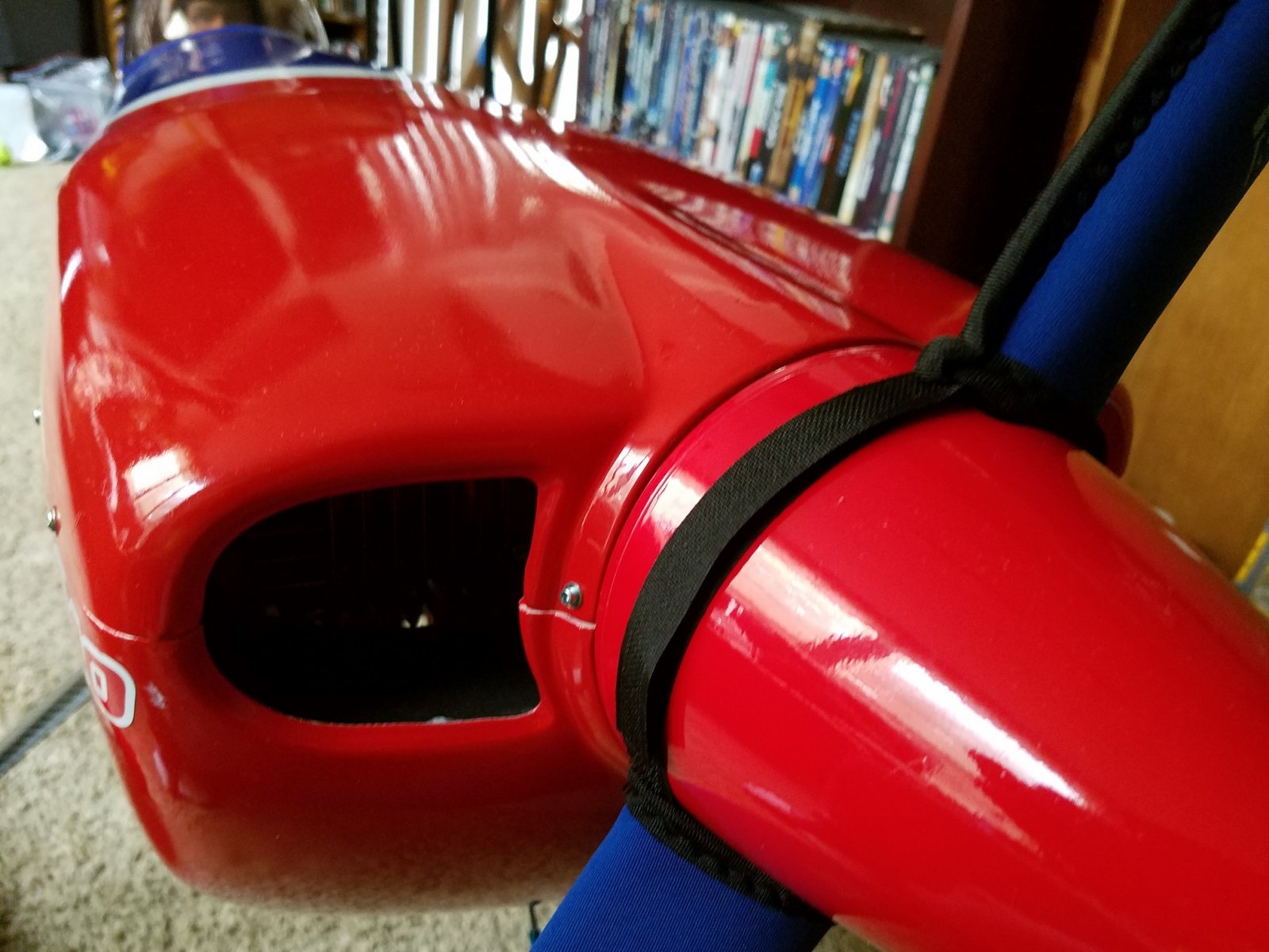

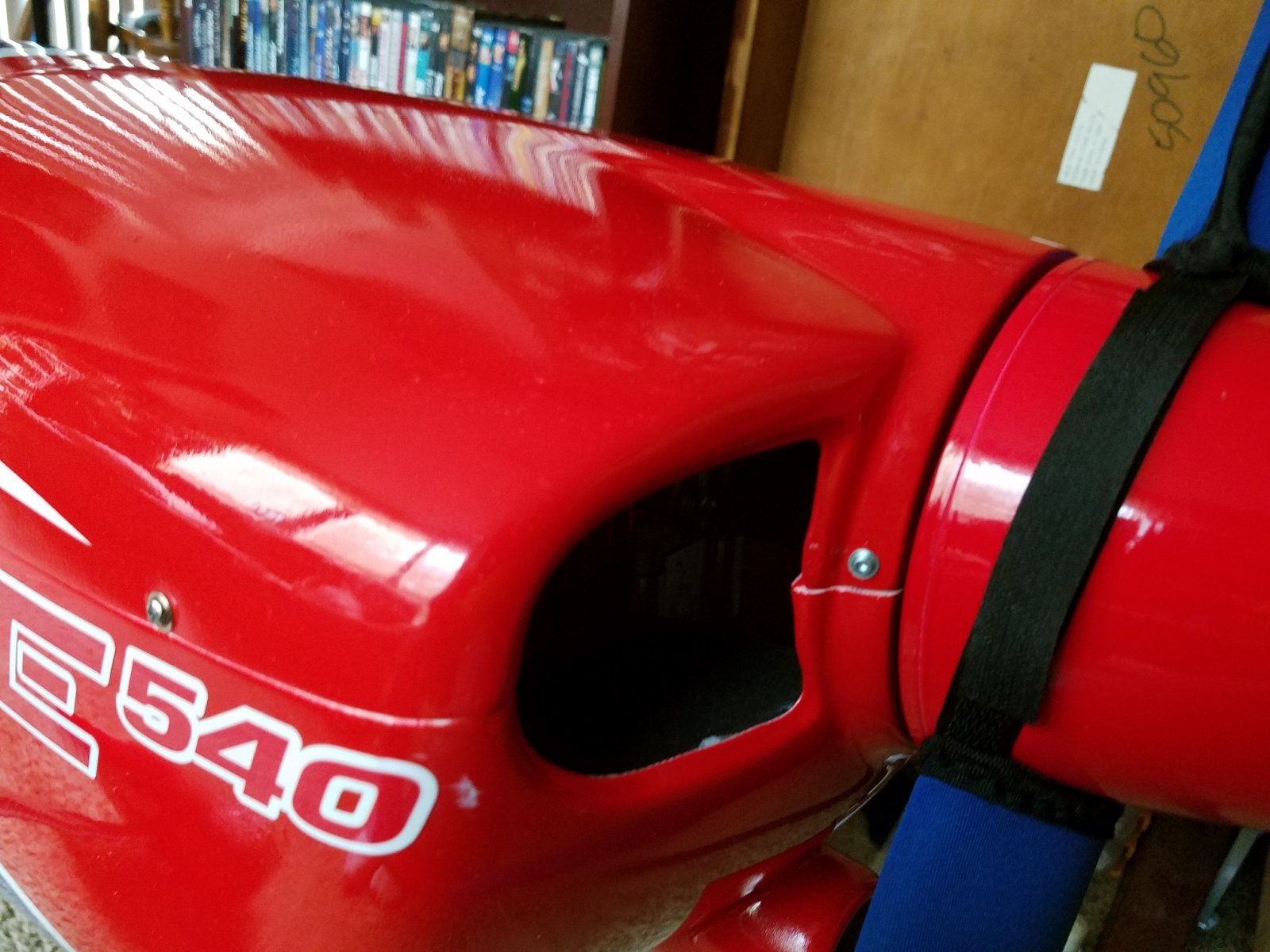

Besides working on the Behemoth Yak (2), I found time to get the Brand New 3w 106cs mounted on the Pilot Edge. What an undertaking, but it's done. Dang, bending those KS Comfort Headers is a chore. Turned out pretty good though. I did get the Edge out for 5 flights today. Love the "dub" 106 twin. Just really not certain about the canisters though. I think they are just not enough flow for the beast twin. So tomorrow, ordering up two brand new MTW 75 rear dumps. Here are a few progress photos of what I have done to the Edge.

Looks nice Rob! What canisters are on it now?
They are KS 5. Or according to DA, KS 1011's. They say "60" on the end of them. They are supposed to be for 100cc engines. But honestly, for a DA 100 they would probably do just fine. The 106 cs having a 40% larger transfer port probably is what is causing the "anemic" feel. On the ground, it runs really strong. Stronger than any of my 111's or even my sons 120. But in the air, she is just not coming on like I feel it should. My sons 120 is actually stronger at some points. I really feel the difference is the MTW 75 rear dumps he is running. We'll see in a few days.

Rob......Do you think shortening your headers an inch or so might help ? Cans have their "sweet spot" too not just pipes.
I actually have considered it. But honestly I have no idea what I am doing when it comes to that kind of stuff. (Never done it before) So I have no idea where to start. I am also afraid if I shorten them too much, I may lose what I already have.
The thought I have right now is based on past experience. The MTW 75's did a really awesome job on both my DLE 111's. The longer length/smaller diameter on my PAU Extra seemed to work better than the shorter length/larger diameter on my previous Edge. Ok, that is in my knowledge bank for reference. Next enter stage left my sons 120 on the longer length/smaller diameter 75's on his 330. That motor just sings. However, he tells me it appears the headers have been shortened a little. The normal length headers on my 157 and 170, as well as my 212...they all perform wonderfully. So my thought process is this. The KS Comfort Headers are pretty long. I think the plan of attack is going to be to shorten them 1/2" then add the MTW longer length/smaller diameter 75's. Unless someone with more experience and more knowledge can chime in and help me that is. As I said, I'm a little reluctant to start "whacking" away at those spendy headers. Dang things are $98.00 bucks a piece. But I also know that 106 runs like a clock on the ground. She just seems a little anemic in the air when the prop unloads. Really hoping the shorter headers and the 75's will be the ticket.
I am seriously open to suggestions guys.

How long are the headers? Maybe a shout out to KS with the length and what is going on will yield a good place to start :)
