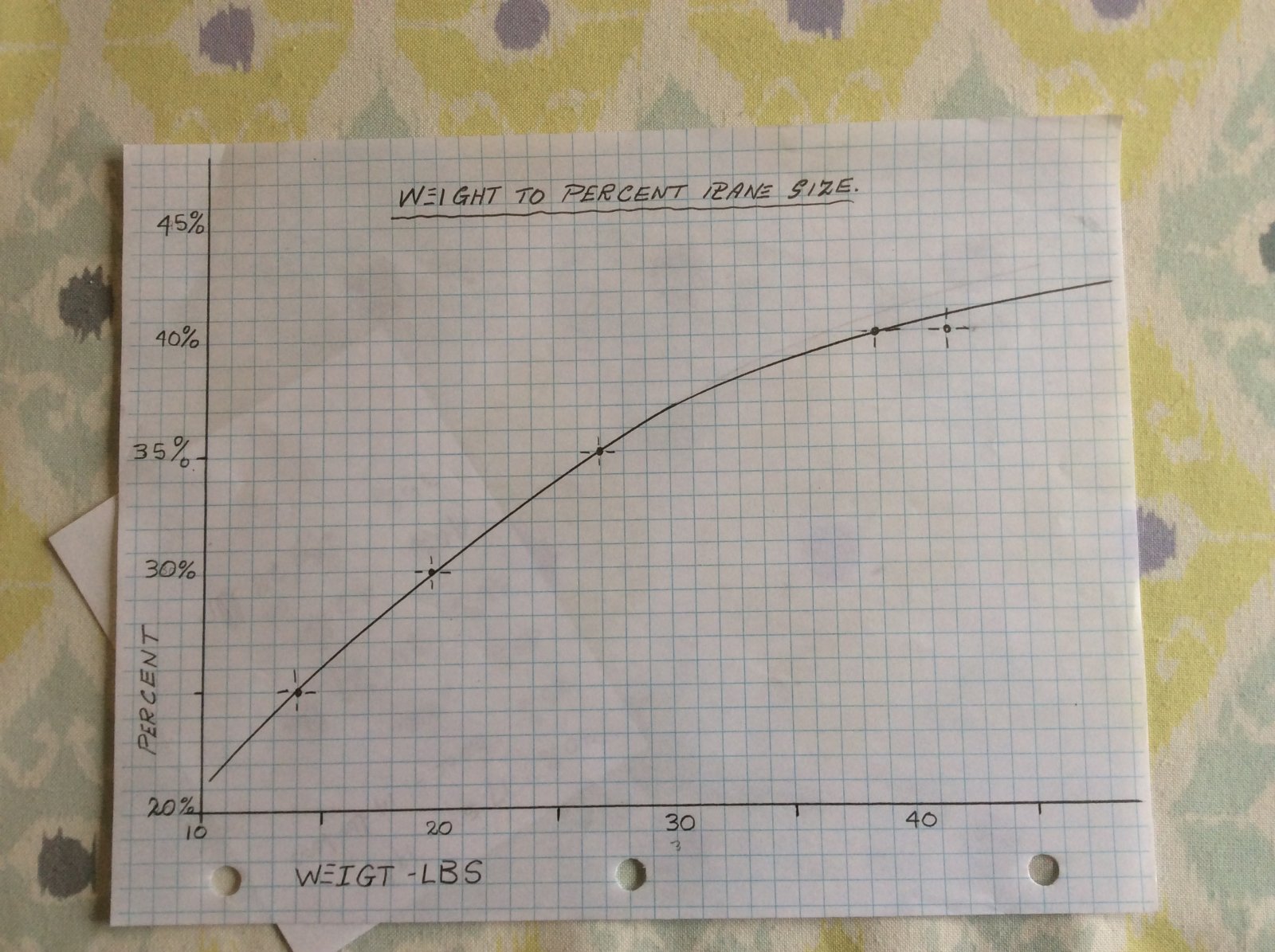

From the information from you guys the following graph was made. Studying it does explain some things. But this is how the chart looks with a small sampling, but line is very linear telling me that the data is good. As we collect data on what is light and heavy the graph can be expanded.
Looking at the graph it seems that up to 36% is the ideal ratio for 3D and as we continue on to the 40% the weight increases at a higher rate due to the inflection point on the curve.

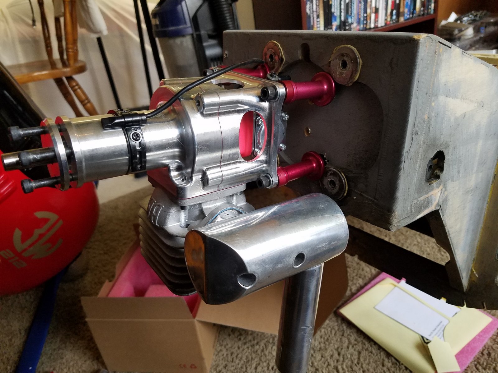

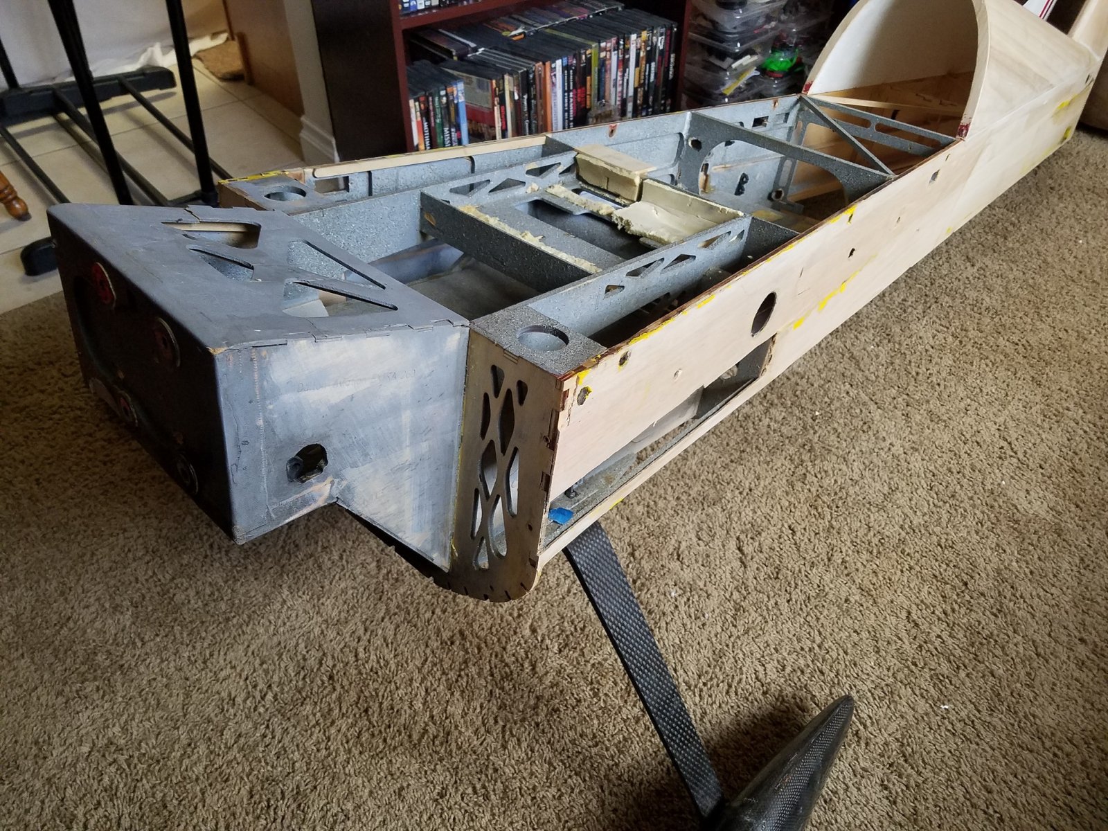

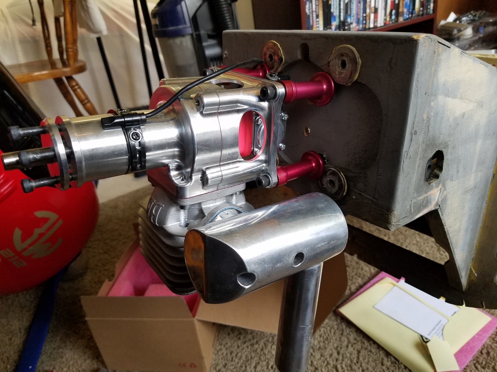

So, how many of you have a Dalton 260 engine test stand? happy-wink-smiley-emoticon.gif
I have a really bad habit of not tossing out the trash when I think there still might be a use for said trash. Such is the case of the Dalton 260 I "WAS" going to rebuild for my friend. That is until we discovered it just was in too beat up shape to even mess with.
That is when it became my engine test stand. I have already tested three engines on it thus far. And number four will be the BE 62. happy-nodding-smiley-face-emoticon.gif

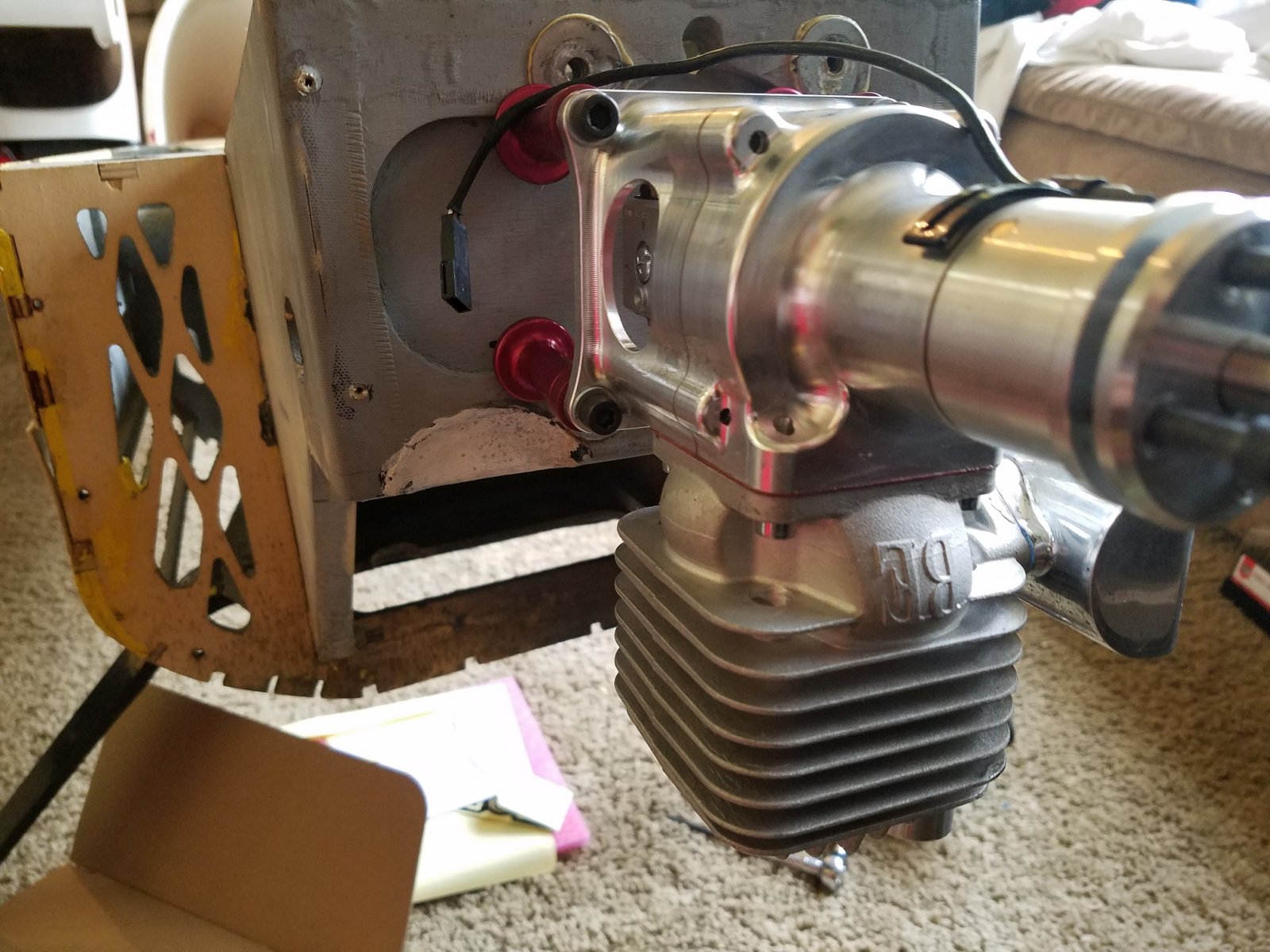

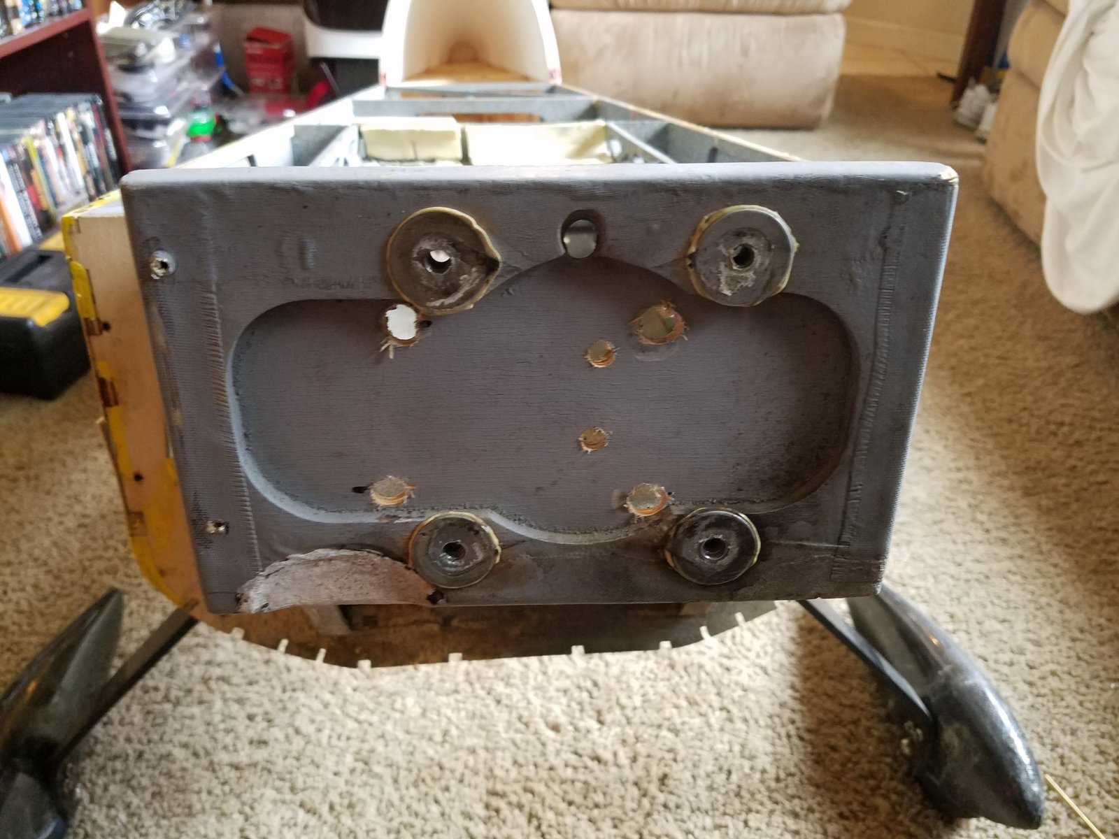

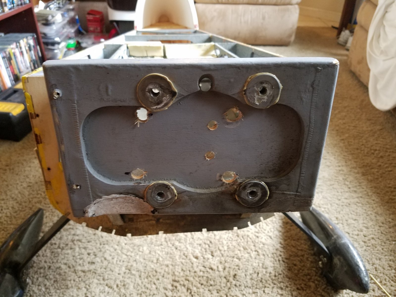

So I dug it out of the storage shed and proceeded to mount that 62 on it.
It might be beat up but it can still support an engine, right? LOL

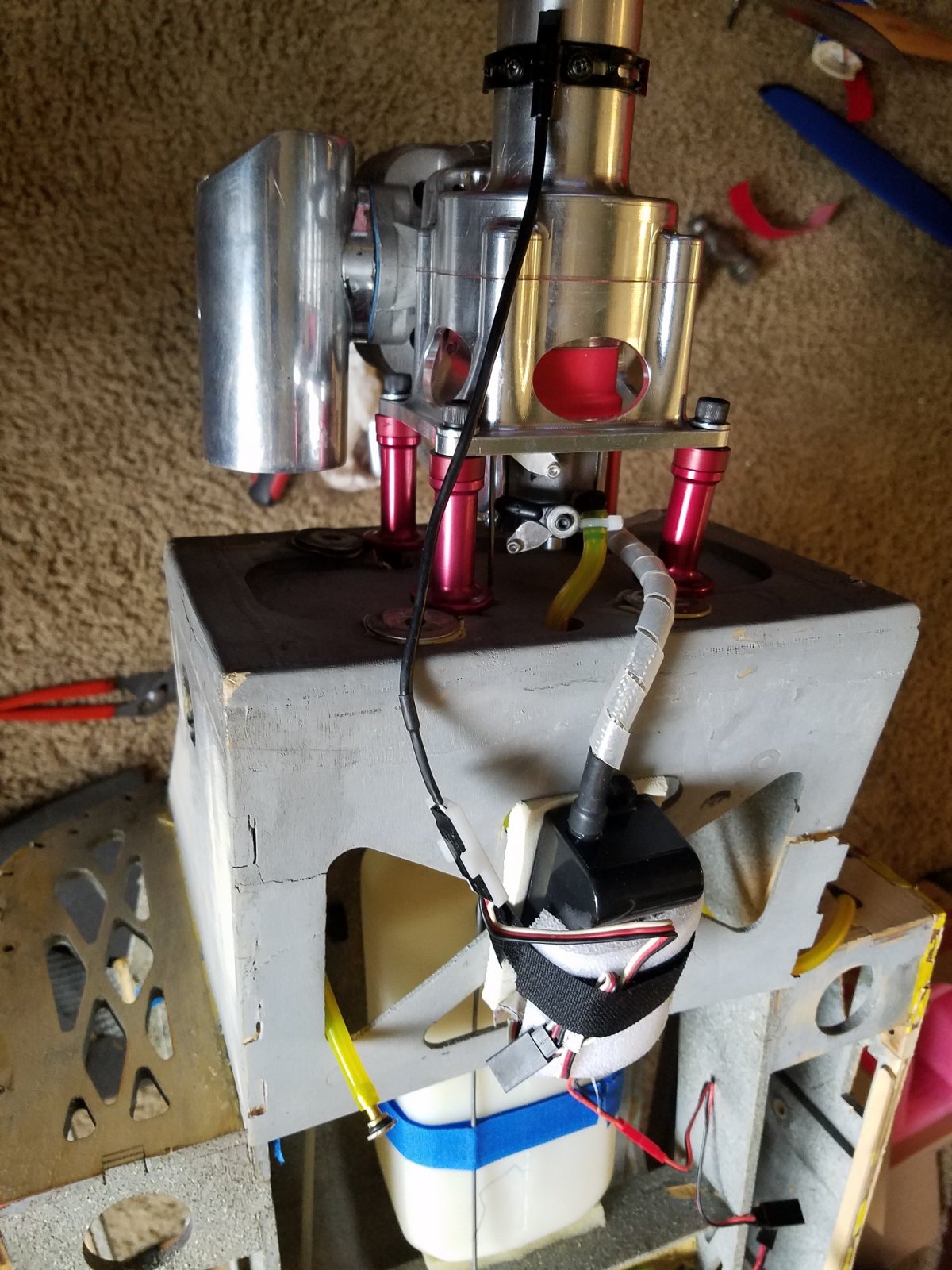

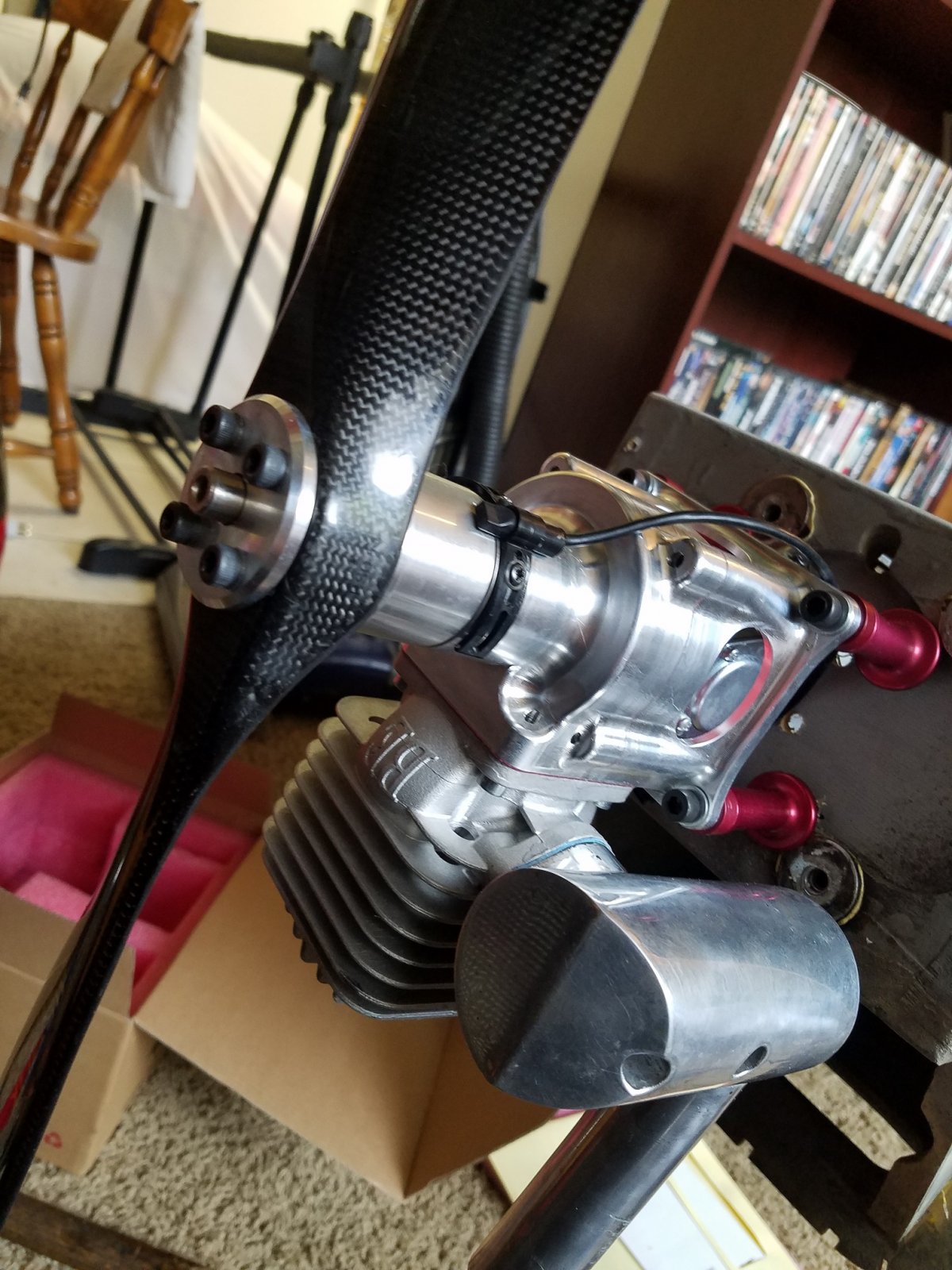

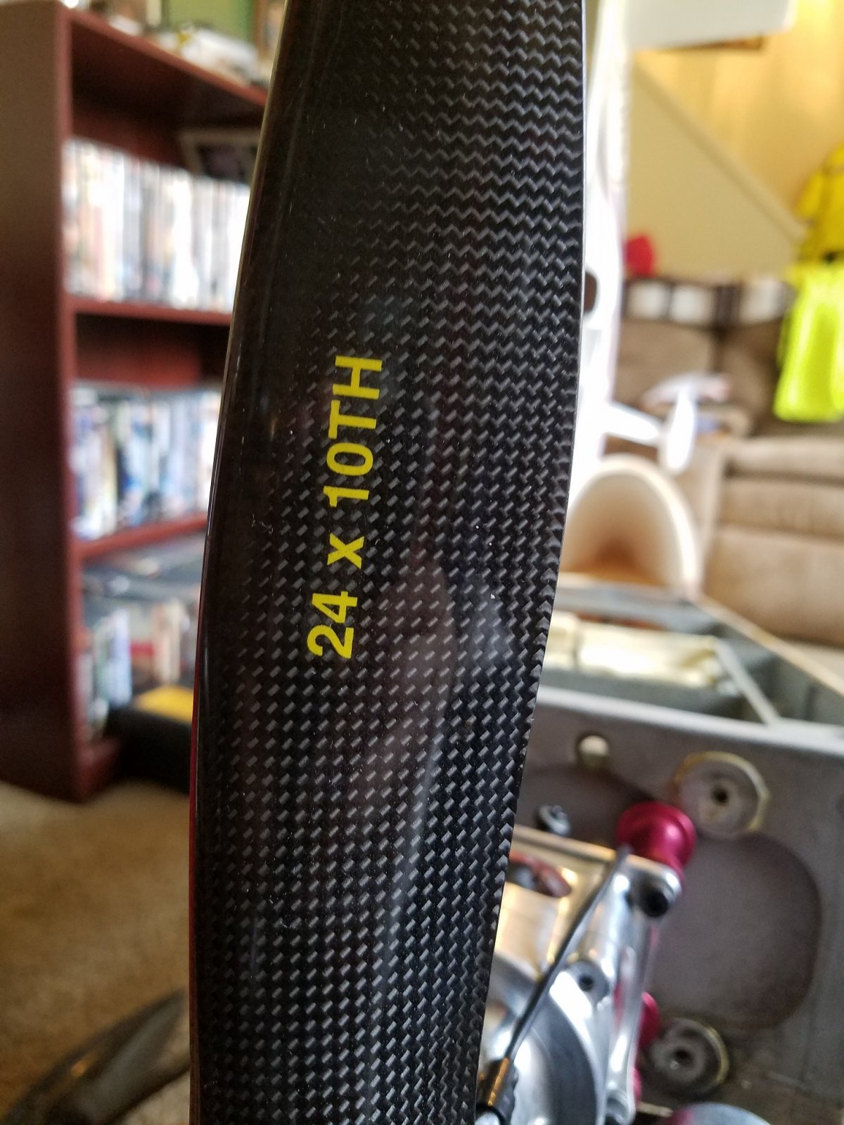

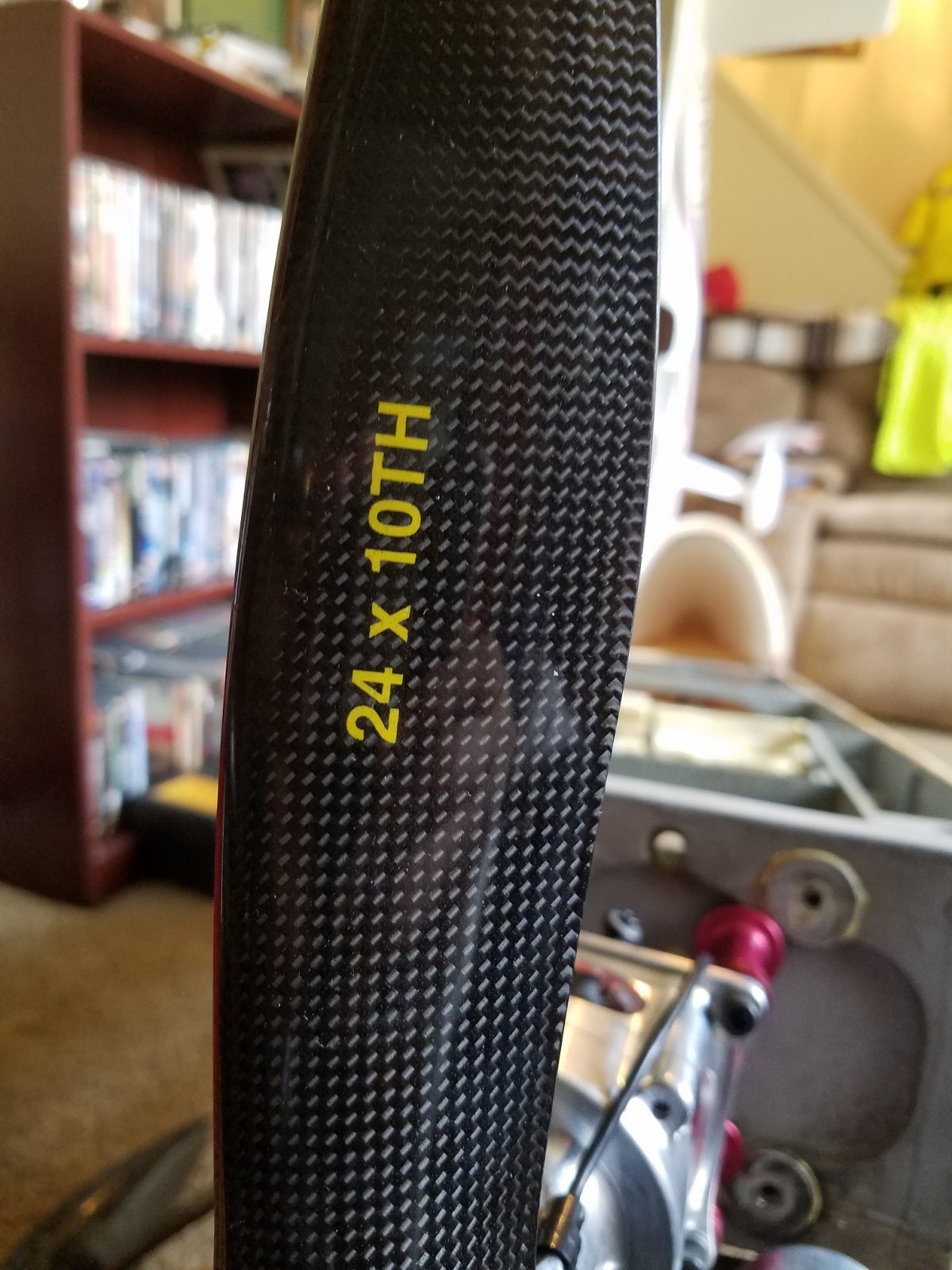

Now for the amenities. Prop, ignition, ignition battery and finally the tank.
This little project killed most of my day. Not like I was doing anything else worth while. LOL. Oh, I guess I did work a little on the "little" SD/TOC Yak also. Revamped the rudder servo cables and double offset servo arm. I just didn't like the way it was done. I also weighed everything airframe related. As it stands, the Yak comes in at about 12 pounds. Course we need to add the combined weight of what ever engine and exhaust I end up using. So it could come in around the really high 17's to maybe the low 18's. At outside worse case, maybe 19 pounds. That is pretty good for a 95" 33% Yak, right? I would think pretty much any engine of the 60cc on up class would do a really good job on that plane. I really wanted to use the "dub" 70 twin from the Pitts, then get a lighter engine for that. But I am just not really keen on the idea of the extra 1.5 to 2 pounds the 70 weighs over a 60cc engine.
Anyway, back to the BE 62. I did get it fired up, but it really didn't run very well. I am going to do a little more tinkering with it before I toss in the towel on it.
So, how many of you have a Dalton 260 engine test stand? View attachment 99335
That is when it became my engine test stand. I have already tested three engines on it thus far. And number four will be the BE 62. View attachment 99336
View attachment 99337 View attachment 99338
