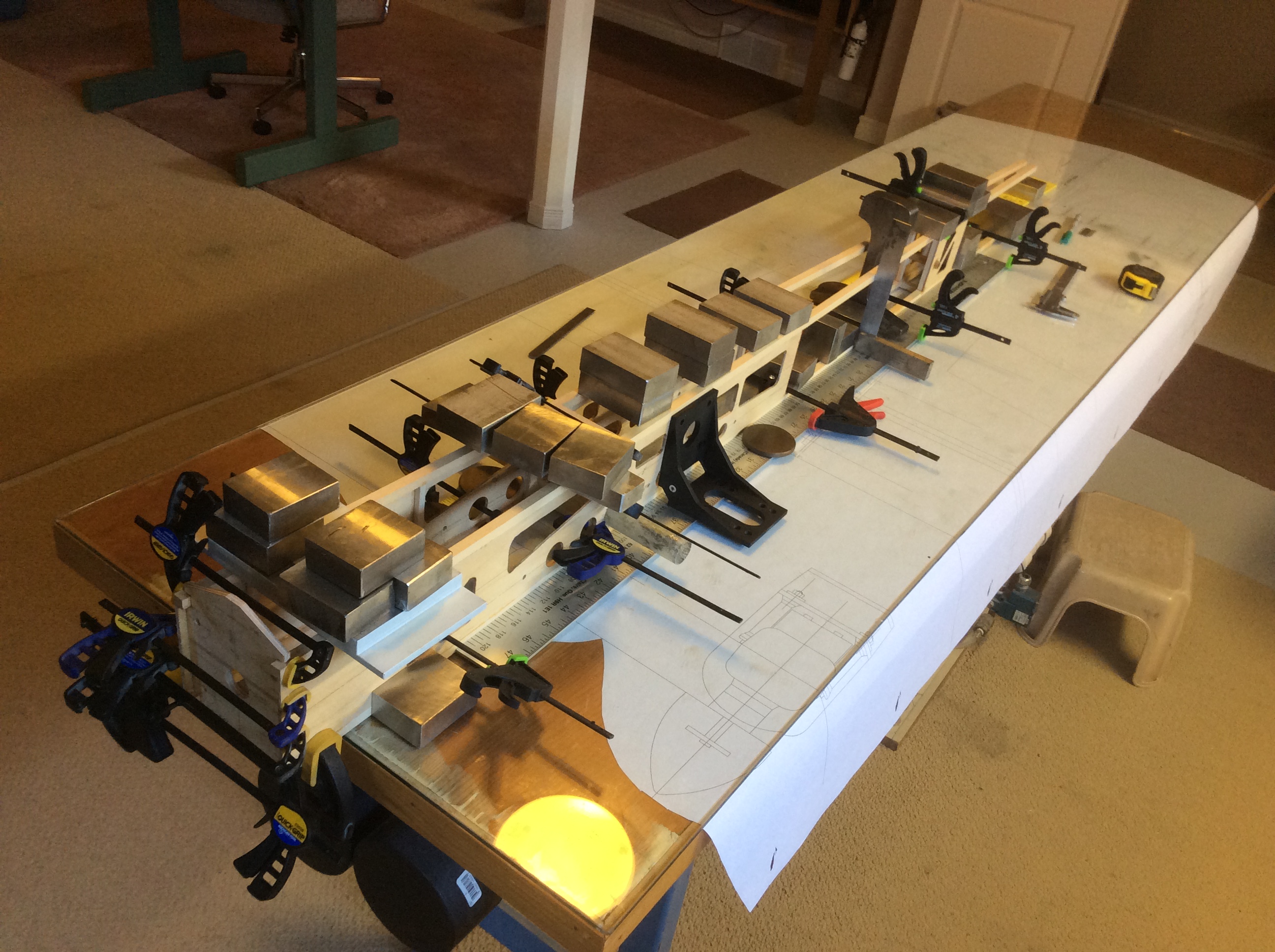

    Thanks BalsaDust it is coming along. The fuselage is 1/16 wider than the mounting plate required for the motor trying to keep everything to a minimum. Just completed the elevators and stabs only needs final sanding and covering. The stabilizer and elevators came to 3.0 oz except covering, total for the two.

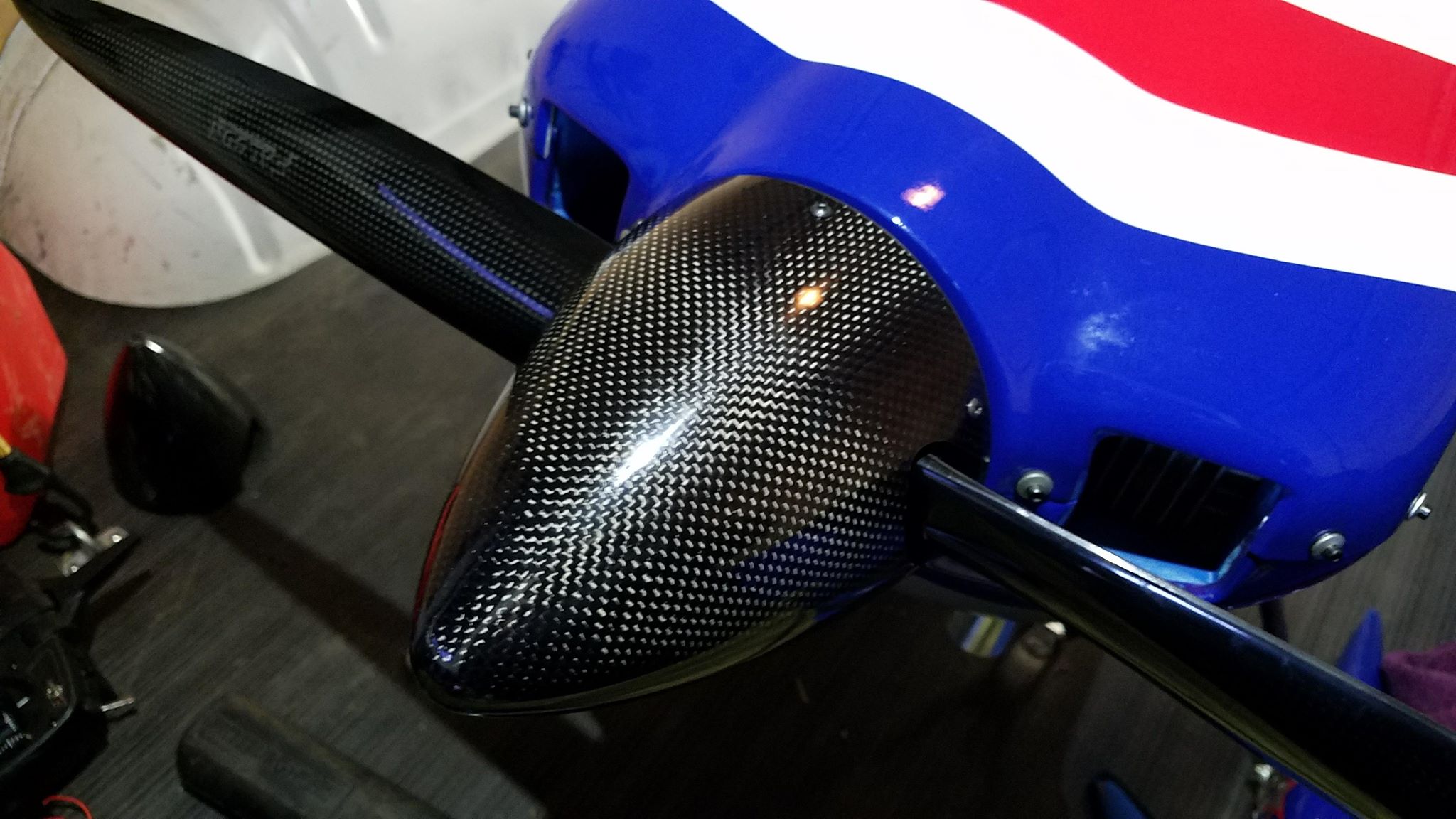

    Put my shiny new Falcon 5" spinner on the AJ Laser :)

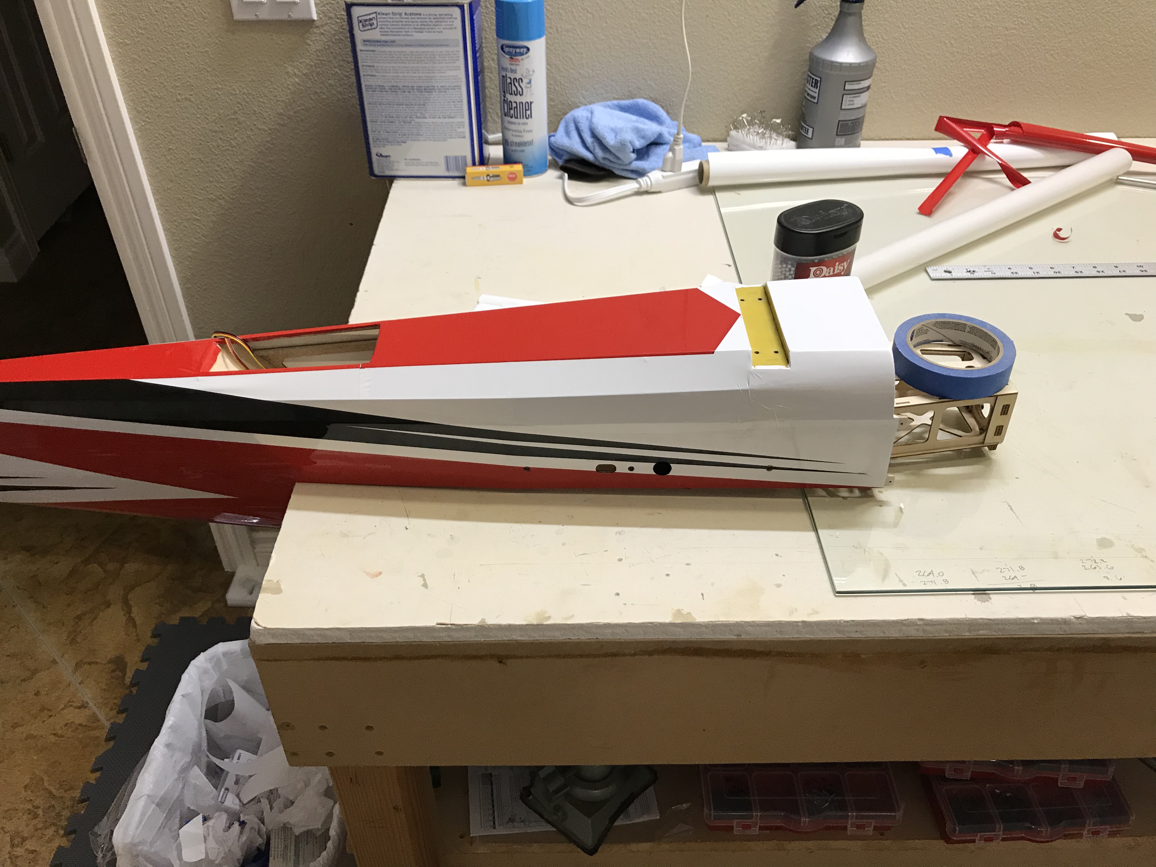

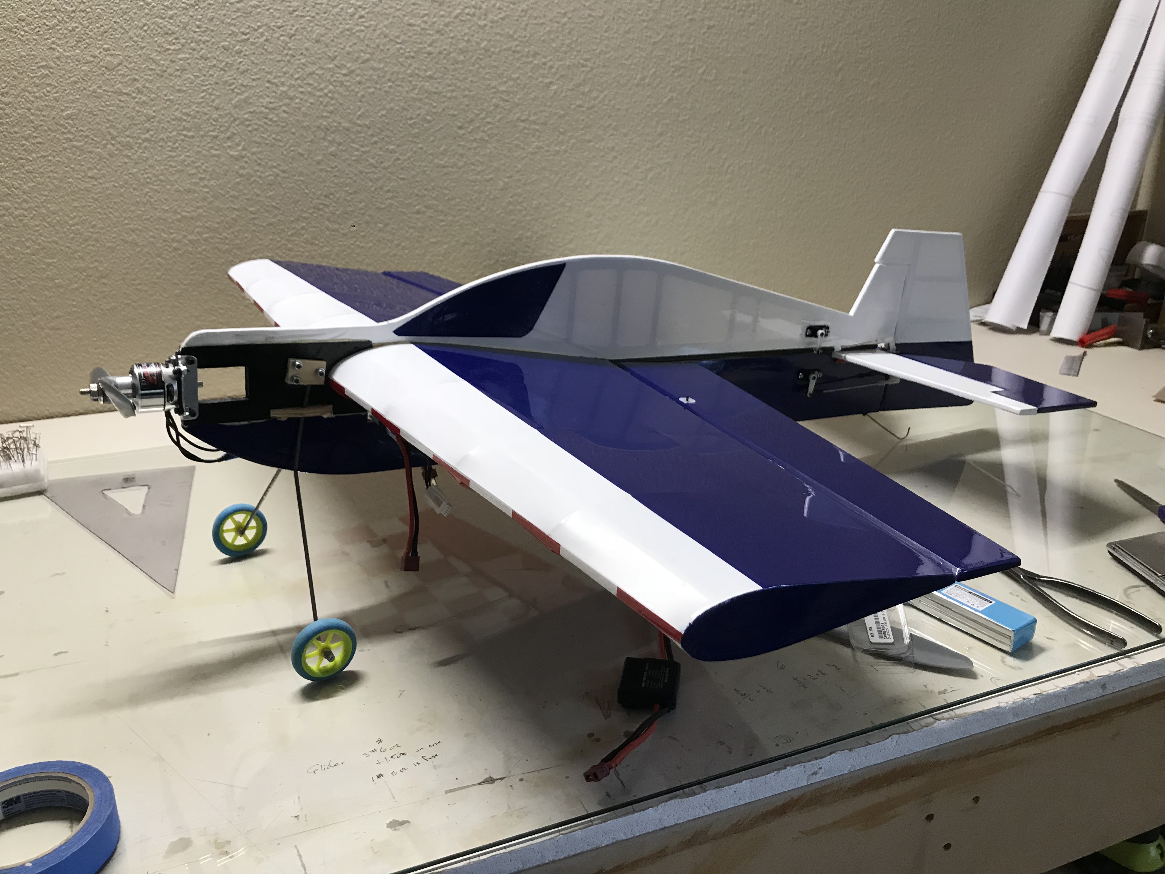

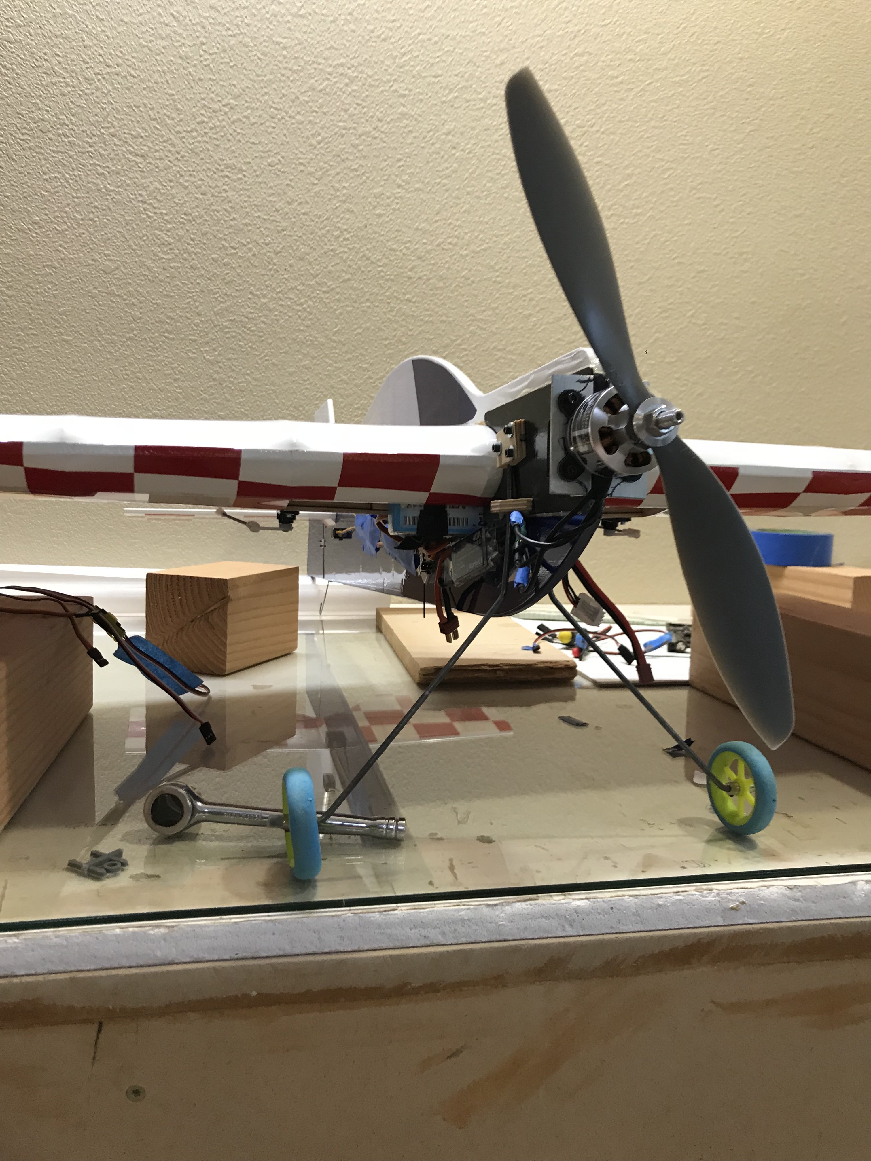

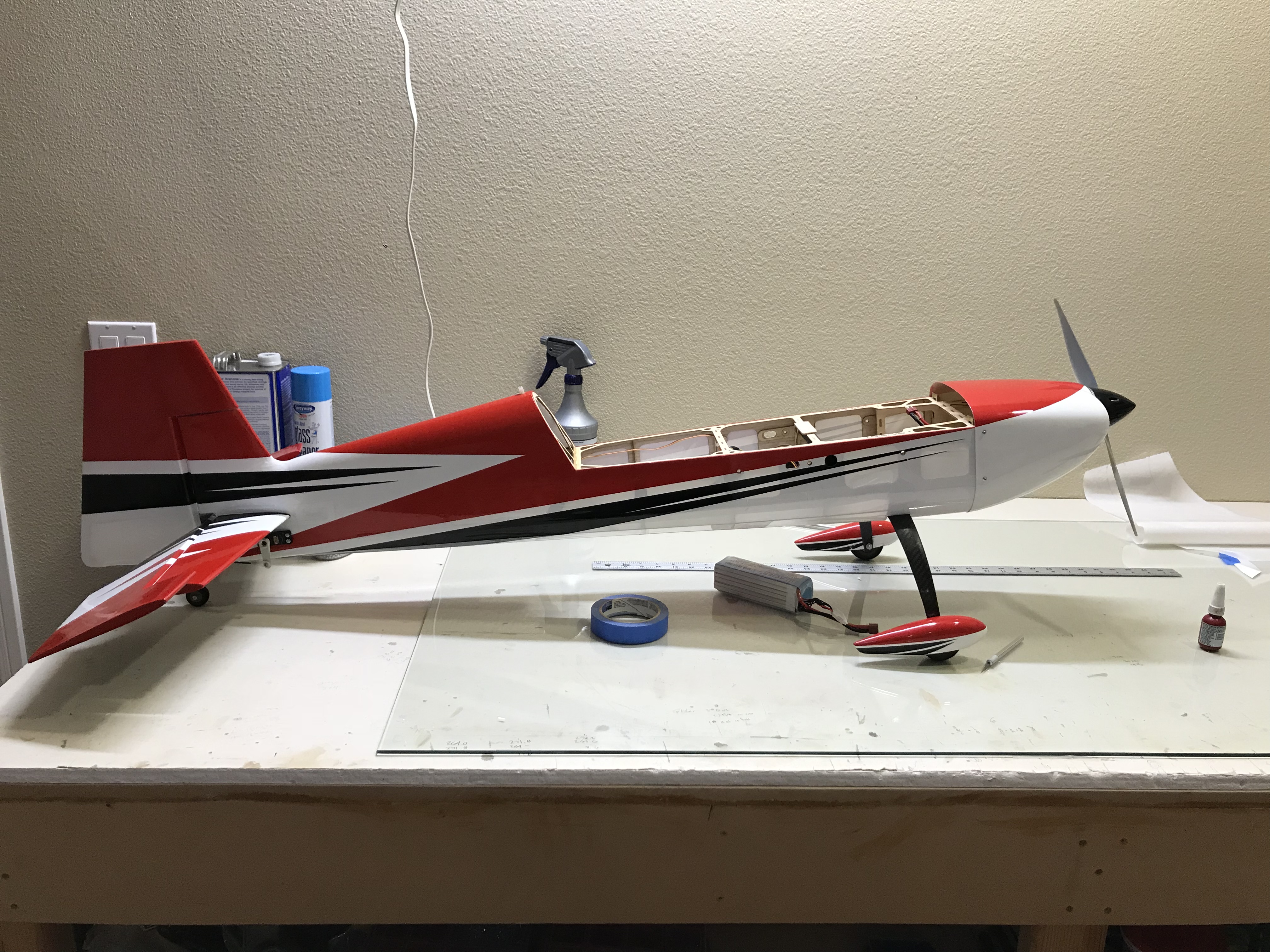

    Lots of updates. Mojo 25 done and flown (quite a bit actually). It has a lot of coupling in knife edge. Also needed down and right thrust added to it. The SKF 3536 is way overpowered for this but is fun to fly. I think if I could get the wing loading down, it would help considerably. Fun none-the-less. Compared to the Mojo 65, there is no comparison, but hard to ask a lot of a 36” ws profile with a high wing loading.

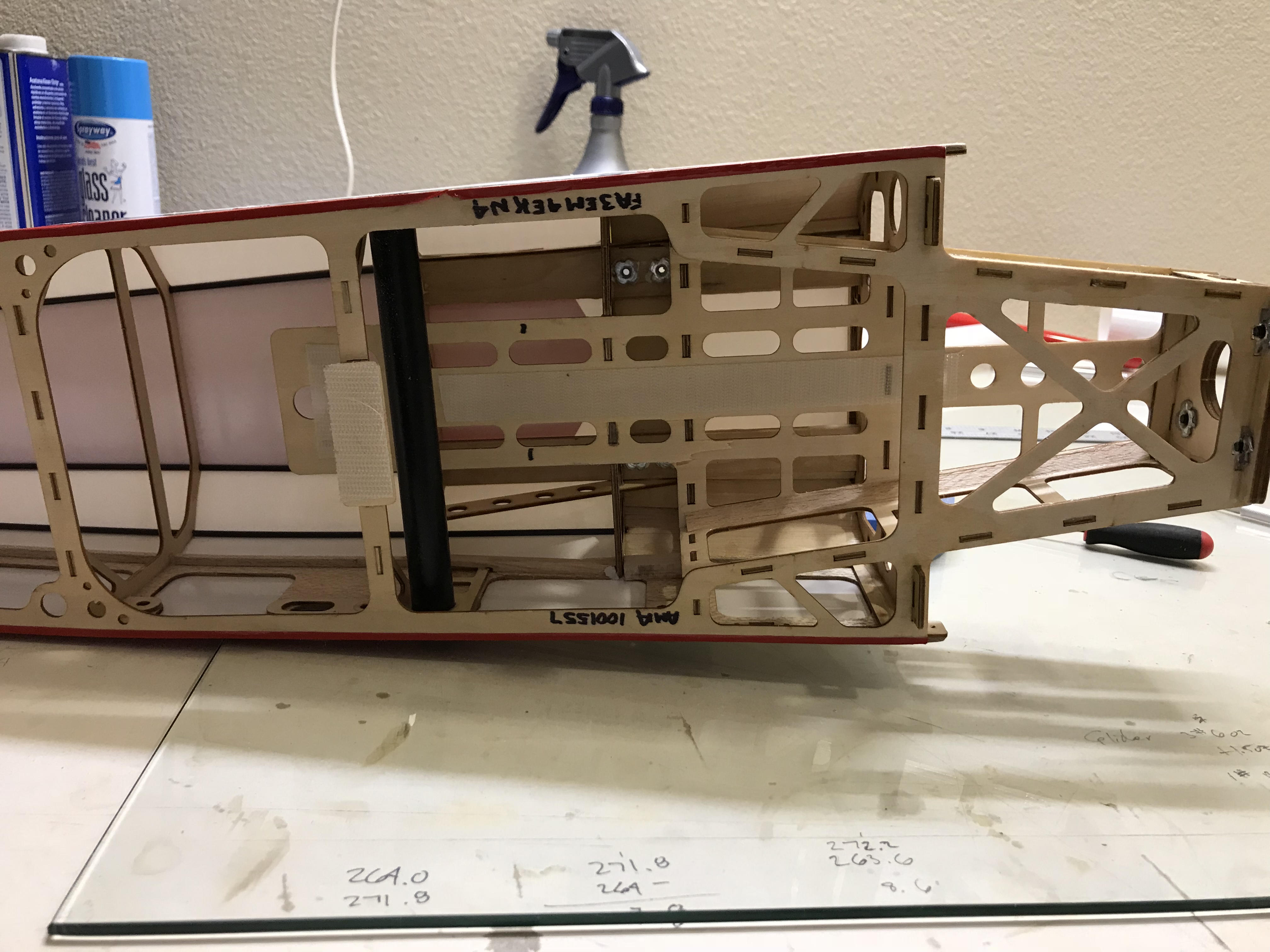

    Got the EF 60” landing gear support replaced. Good as new and went flying for lunch today. Glad to have knocked out another project.

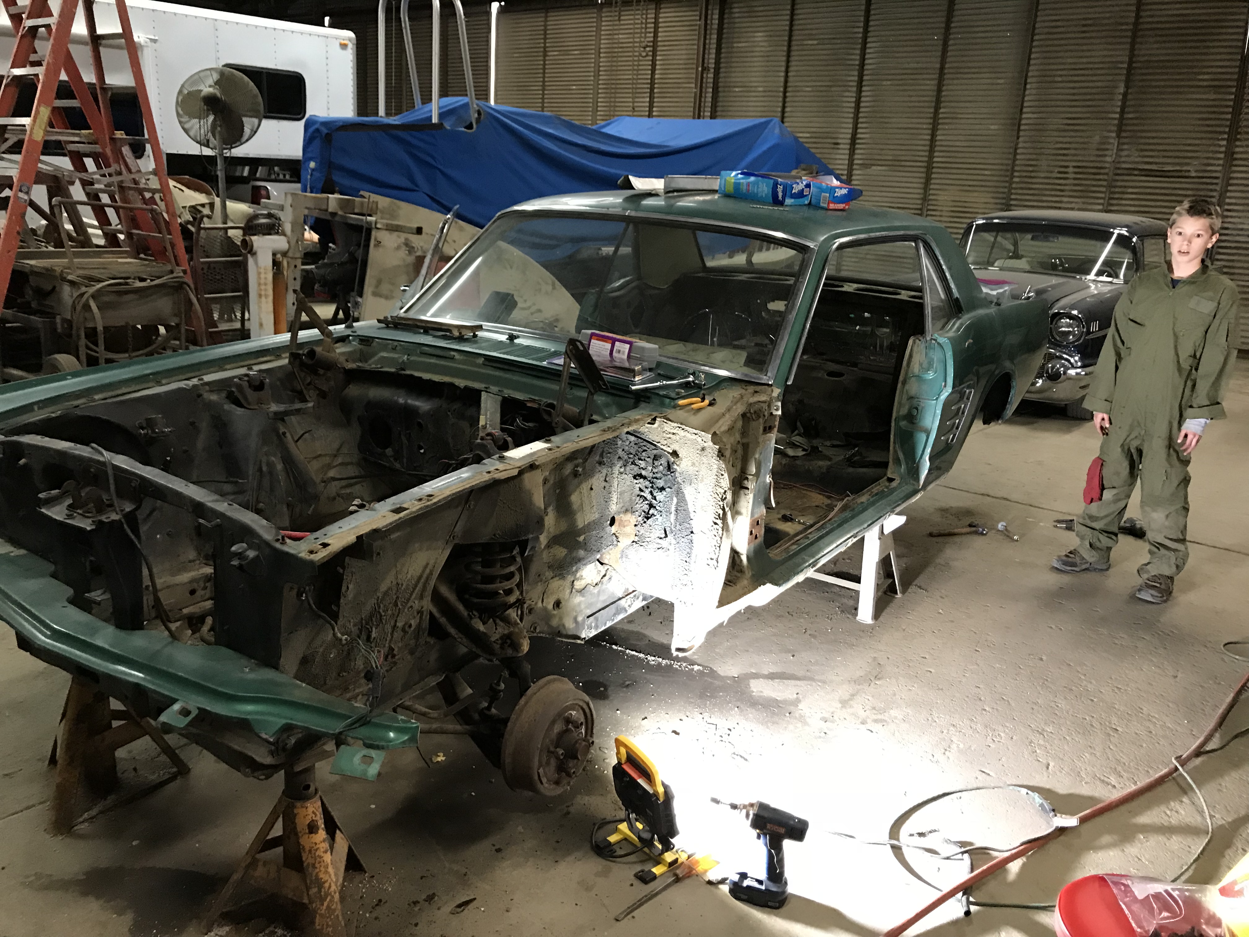

    The last pic is some work my son and I have accomplished tearing his 66 mustang apart.

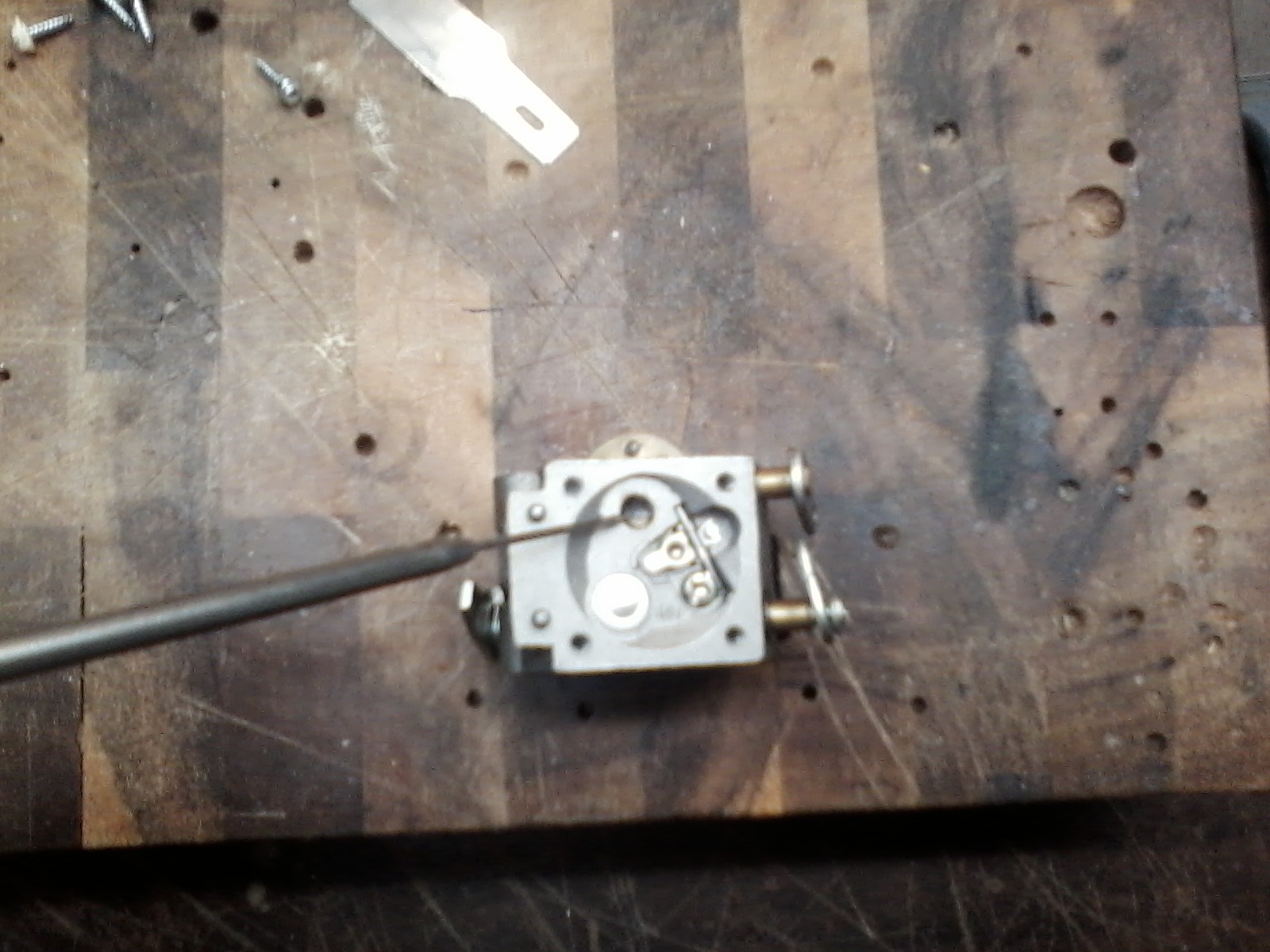

    Carb on the cub needs replaced :(. Suspect sticking check valve. It's always something!!! Just when you think you got it :fist_pump: you don't.
    Stupid motors :omg:. lol

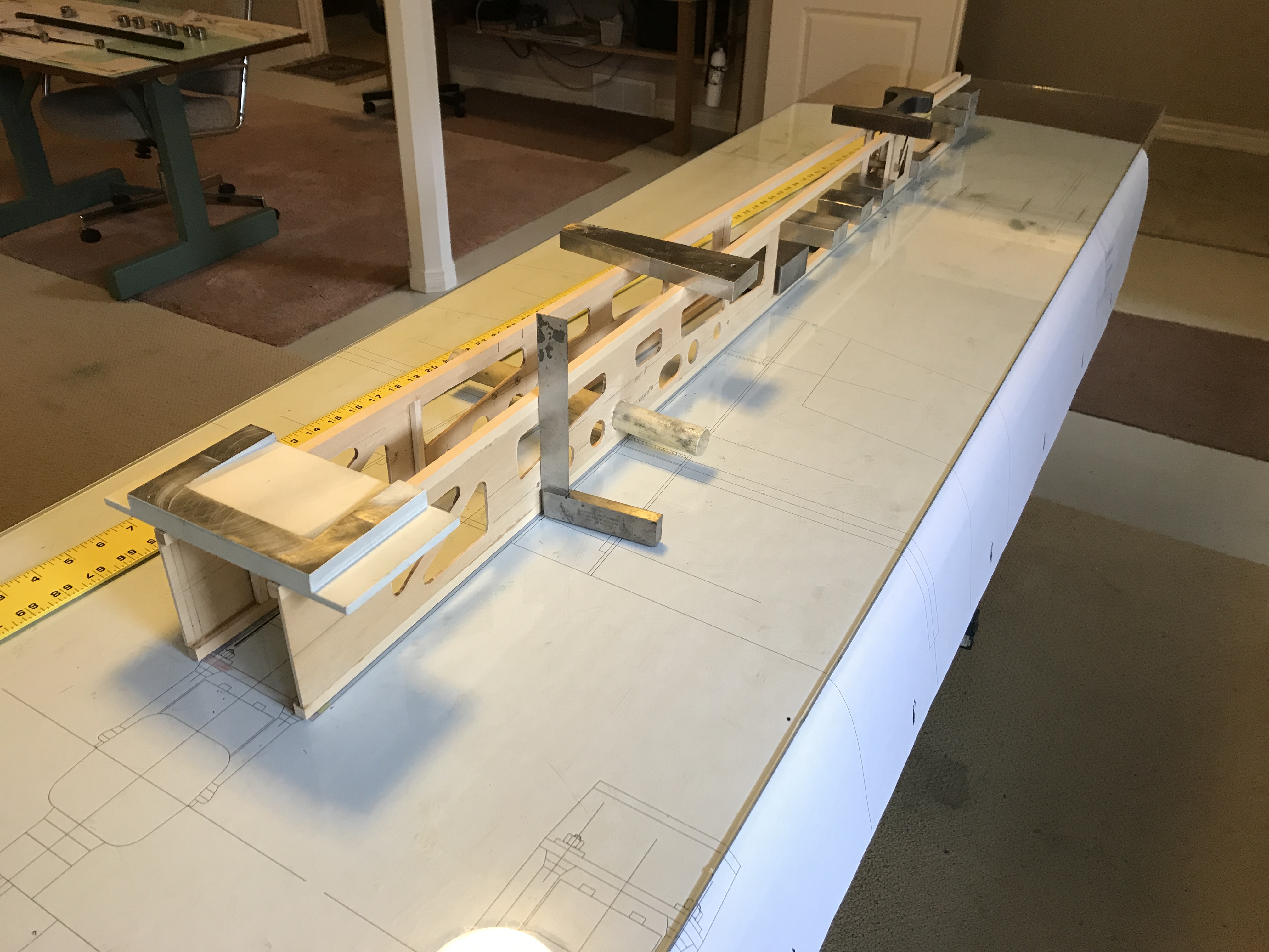

    Well you know when you get to a stage and you just say this is it it is square straight and the tubes are parallel and motor mounting plate is square. You grabbed the glue and it is what it is.
