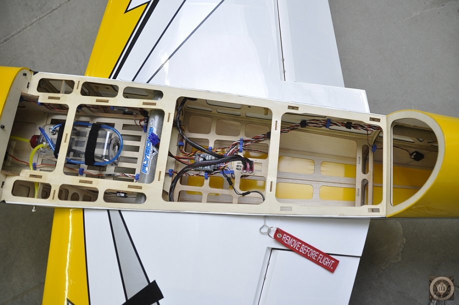

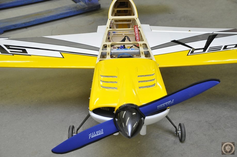

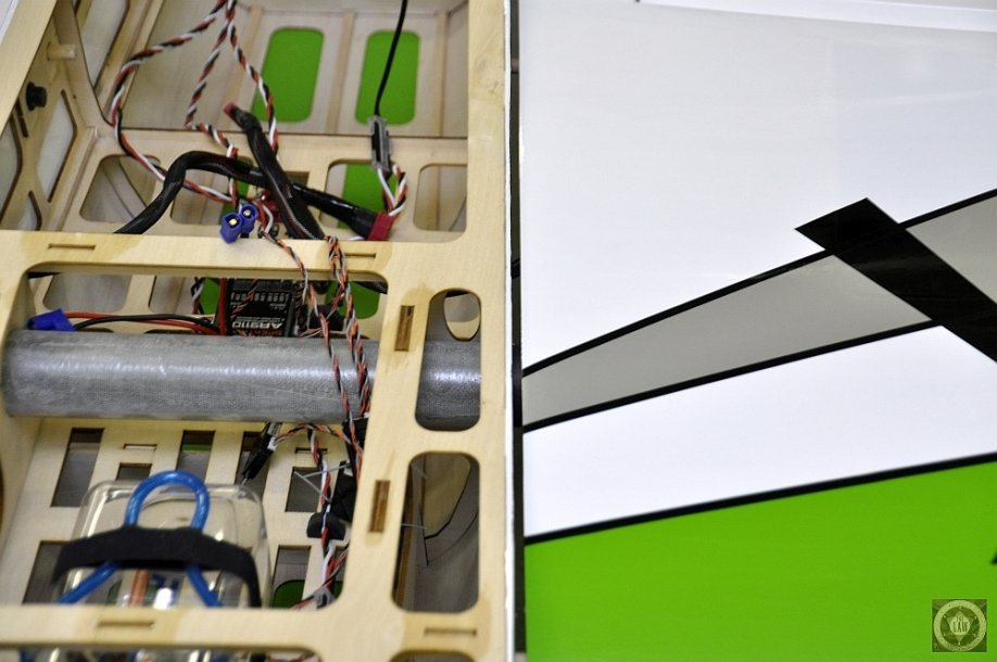

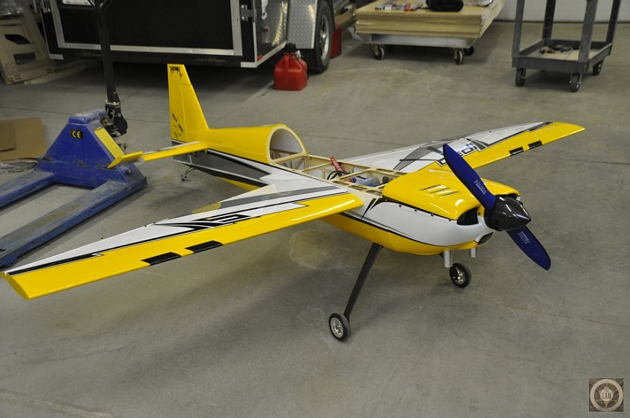

Well, I got the two Vipers I'm building all wrapped up today. Super excited with final weight.
NOTE: Both mine had the wing tube about 1/8" too long, I talked with Herve and he wanted to make sure to note that. He has addressed it with the factory. If anyone needs help cutting theirs PLEASE PM ME and I can give you a couple tips. We have not confirmed if they are all like that in this first batch.

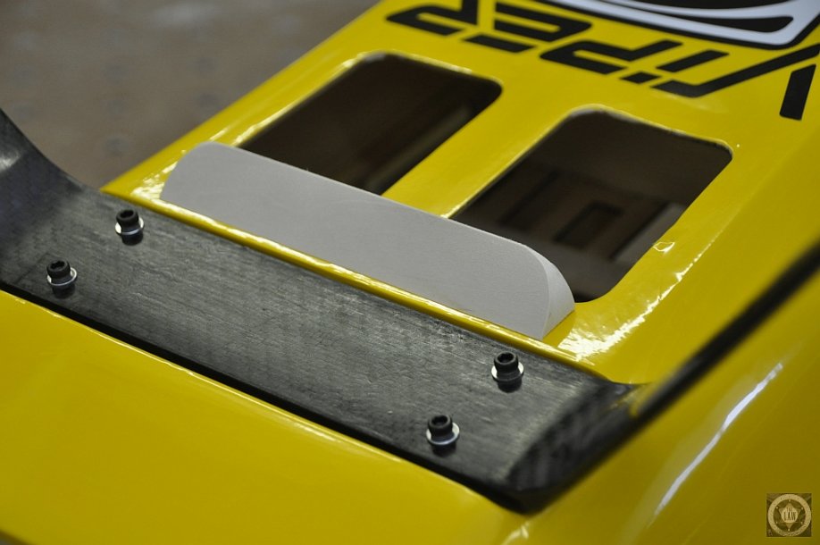

I tidied up the wiring for both and also installed a low pressure lip on the bottom and cut out two bays for air extraction. This is a highly effective way to basically "suck" air out of the fuse.
All up weights:
Yellow Viper with J&J tail-wheel, White rose wheels and no pants (yet) = 26lb. 5oz.
Green Viper with stock tailwheel, stock wheels and wheel pants on = 26lb 11oz.
These are going to be ballistic performers with DA120's on the nosehttp://www.GiantScaleNews.com/forums/images/smilies/200.gifhttp://www.GiantScaleNews.com/forums/images/smilies/198.gif

We had to shorten the wing tube on Marks before he flew it Sunday. It flew awesome! Very light. DA120 / Viper outperformed my DA120/104 in stability/wing rock. My 104 is 28.5 lbs and IMO does not like the weight and increased wing loading. As far as DA 120 knowing the difference in weight.......NOPE. Viper lands way better than the 104 too!
