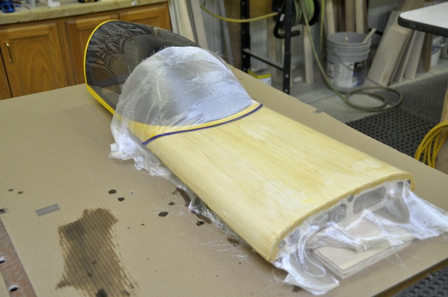

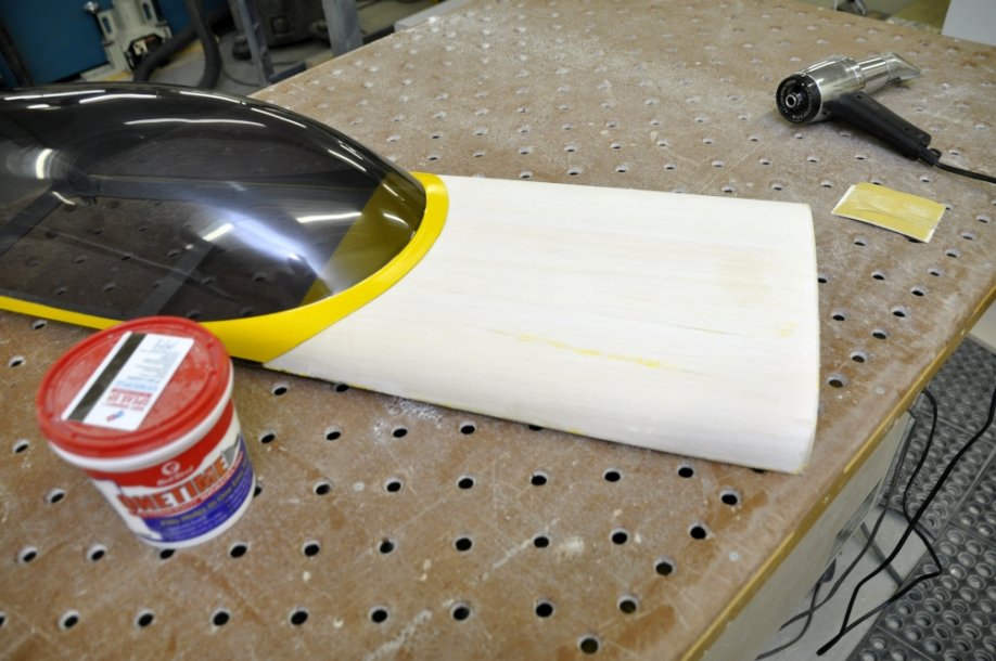

So on the prototype Viper the covering with Pearl yellow and they did not do the greatest job of matching my canopy shell (also why the production one's are cub yellow). I also have a new "production" cowl to put on my prototype so I can fit the DA120 or other wider engine. Since I have to paint the cowl pearl yellow I decided I would glass the hatch and paint that and the old canopy hatch to matchhttp://www.GiantScaleNews.com/forums/images/temp/Banane34.gif
I would likely damage the other shell as I glued it on with Goop, so instead of removing it I removed the covering to it. When the resin is cured I will sand the leading edge of the canopy shell down quite a bit so all there will be is a slight bump where it attaches.
This is a cool custom thing that anyone with glassing and painting skills can do that give the plane a cool custom look. I'm going to be doing some airbrushing on the top as well as just painting......
