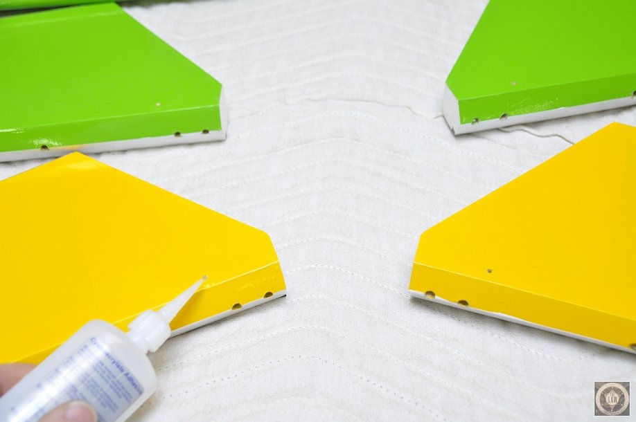

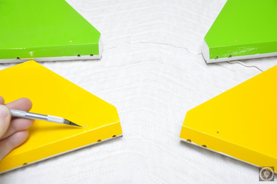

One thing I like to do while I'm hinging just so the glue can cure on it's own is to harden the "hard" points where the control horns will be.
To do this I cut the covering on ONE side of the control surface. Put a generous amount of thin CA into the hole and let it soak in and cure with no accelerator. Later we will cut the other side, clean out the hole with a drill bit and install the screws....... I'll cover that when i get there with more details on the hardware and a few options for the builder.
