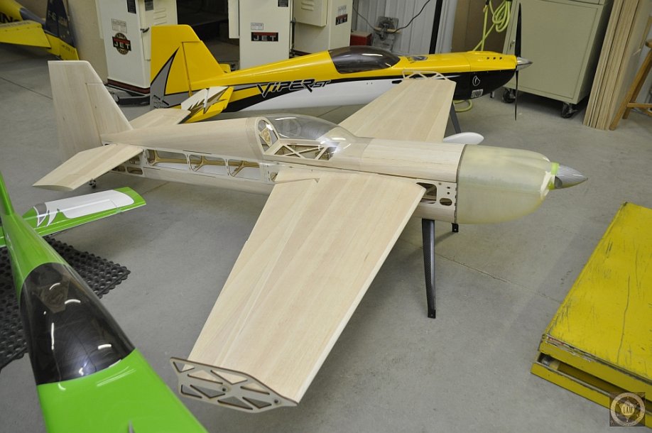

OK kids, one half day and two fairly long days and we have a complete Viper except for canopy shell, some hinge adjustments and final sanding. Ready for paint and covering!!
We spent approximately 31 hours with two of us over three days plus my few hours of pre-assembly on the engine box front. The build order was adjusted slightly to keep things rolling with no waiting for glue to dry and no "head scratching" for what to keep us busy. Super cool that we did this.....but it is a little fast. I do recommend at least two minutes between processes to gather your thoughts:D

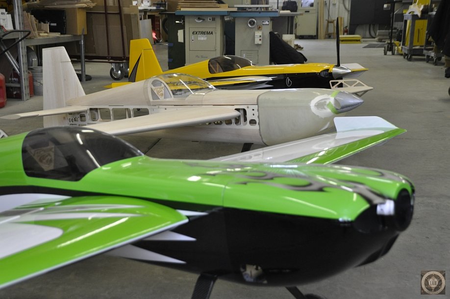

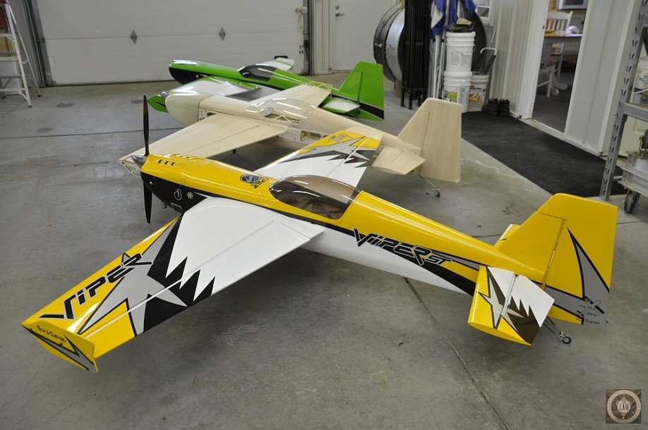

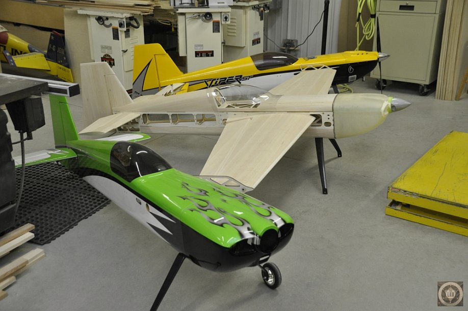

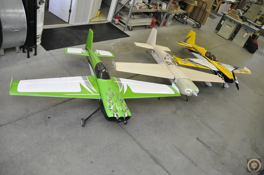

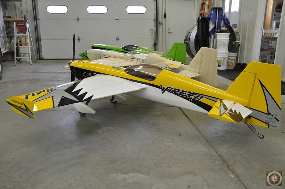

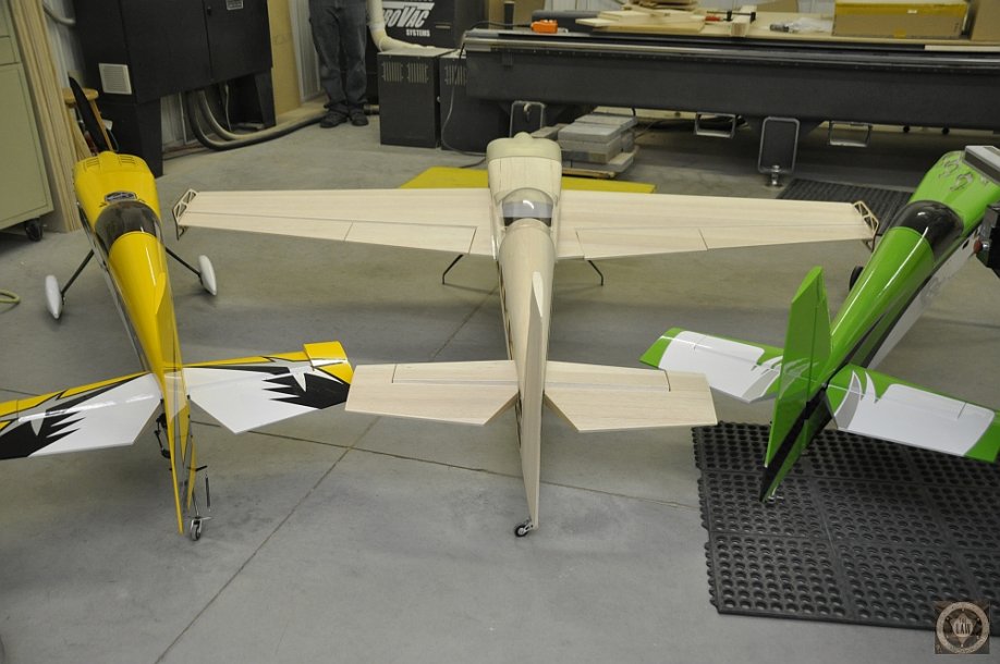

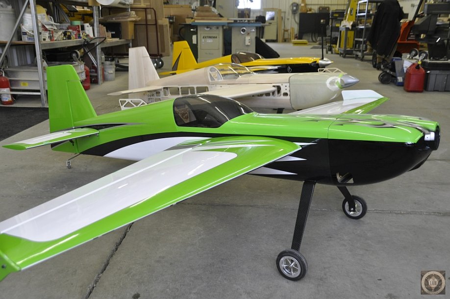

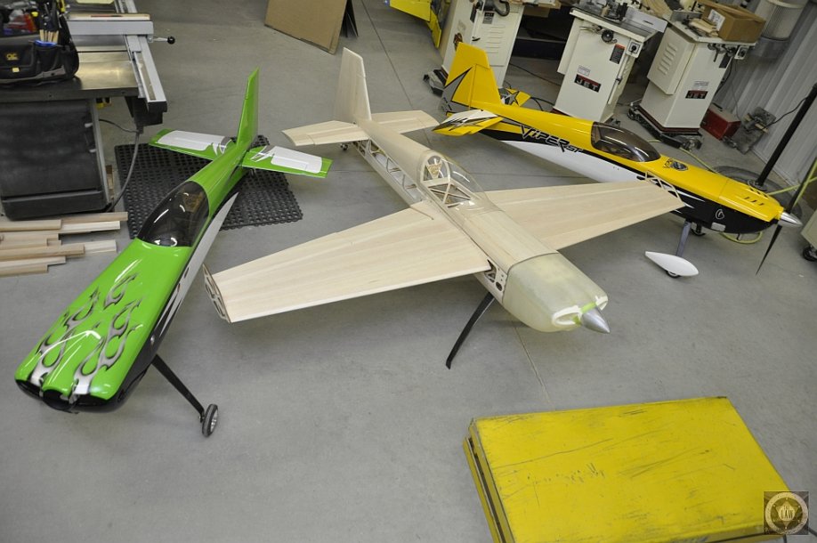

Before we sent Tyler out on his way home we did core his belly pan to save a couple of ounces and took time for a couple of glamour shots of the three Vipers. Didn't even think to have Eric bring his we could have had four of the five I've built all together. But, that will be more fun at the field after Tyler has his covered anyway!
