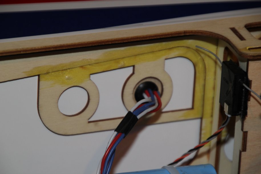

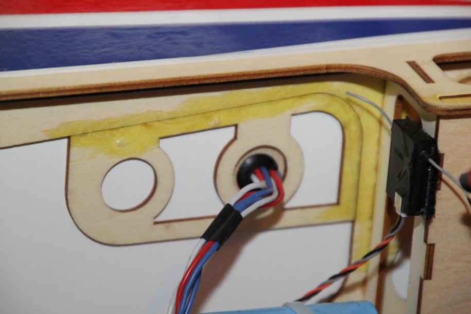

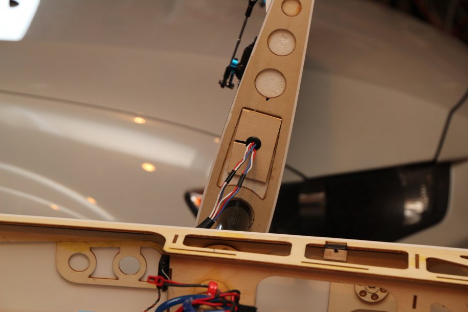

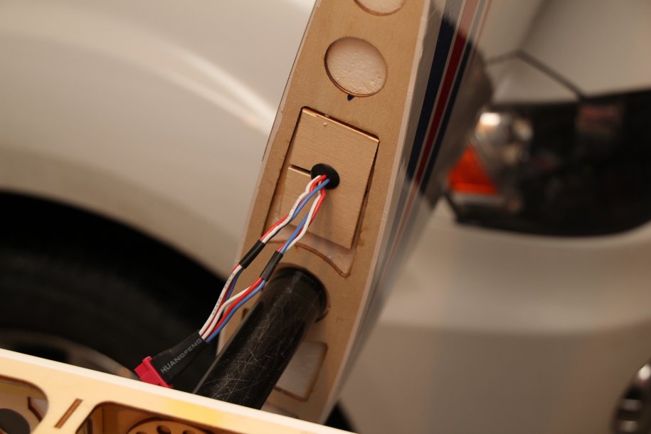

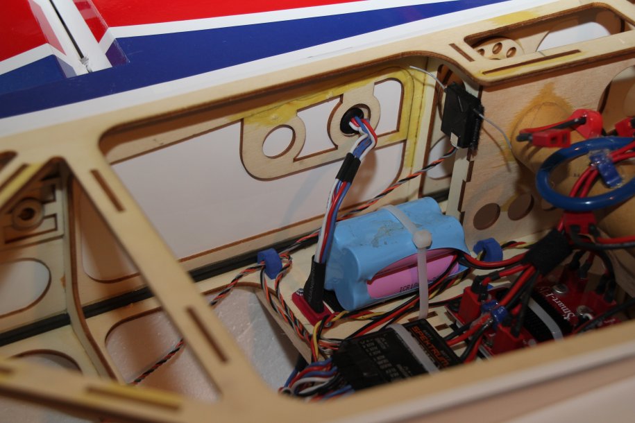

I added some "holders" to hold the awesome servo plugs in the wings. I added a small piece of ply and put a grommet in the middle to hold the wires where they should be. Keeps the connectors inside the wings and makes it even easier to hook up.

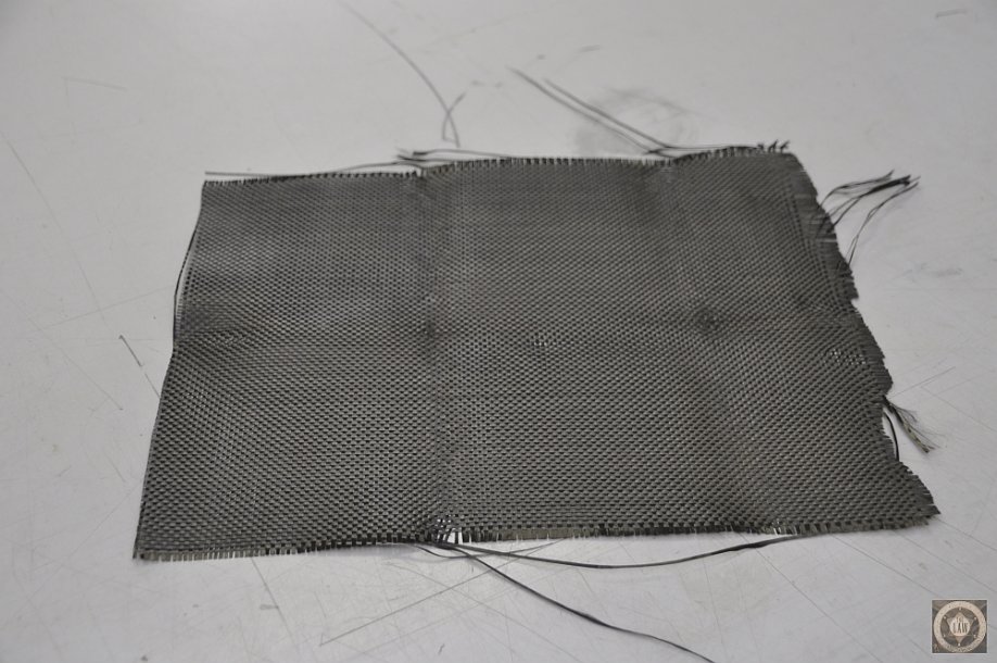

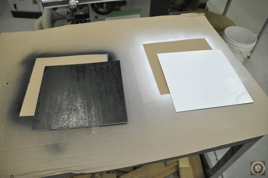

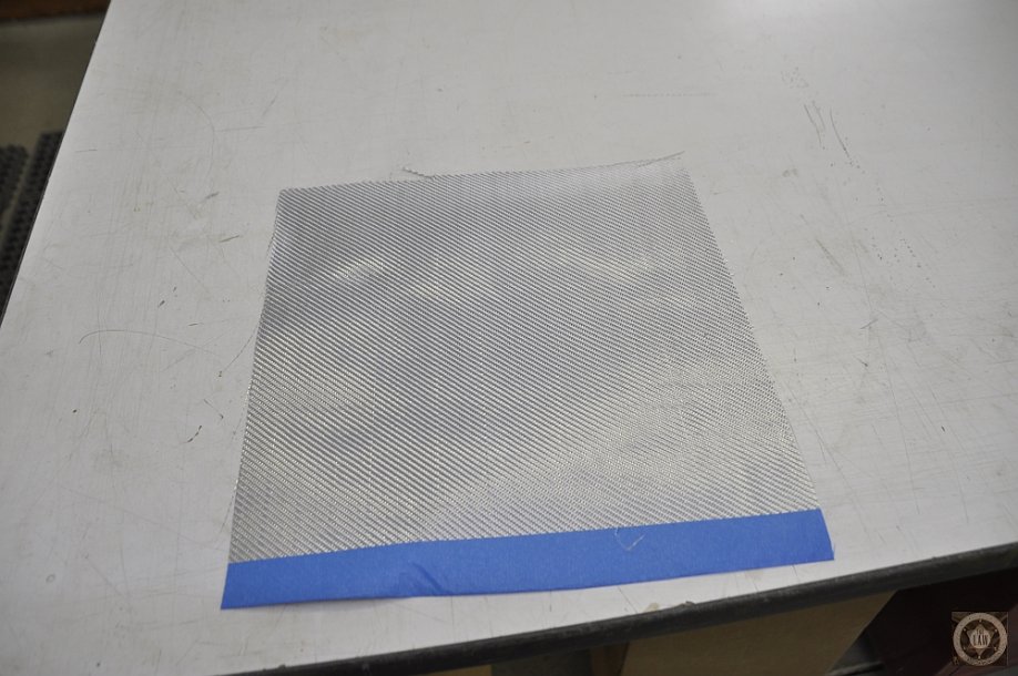

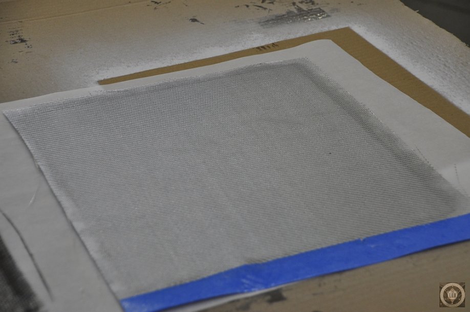

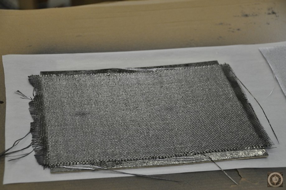

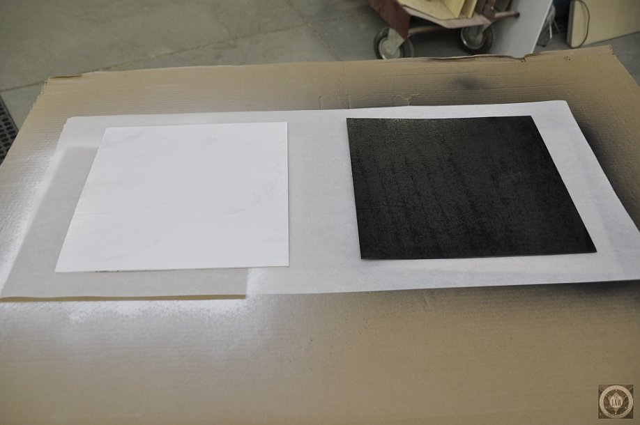

In preparation I wanted to lay up some baffling material. Had not decided yet so I laid up some carbon and texalium fabric on lite ply and I'll see what looks better. With just one layer of cloth I've found it best to paint the lite ply with some rattle can paint to both seal the wood and give it a base color so wood does not show through and discolor the fabric.

The Laser 200 I am building has a huge opening in the front of the cowl like a large cat fish. I plan to use lite ply for the baffling. I normally use lite ply but your idea of covering the lite ply with carbon cloth or even fiberglass will and should look awesome. I will follow your movements in building baffles. I think you are on the right track and the carbon fiber fabric will look great inside the cowl, keep up the great ideas and work.
