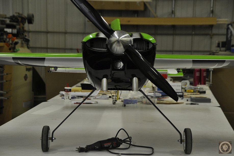

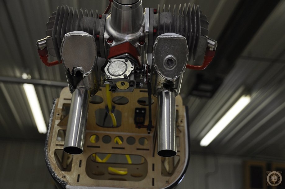

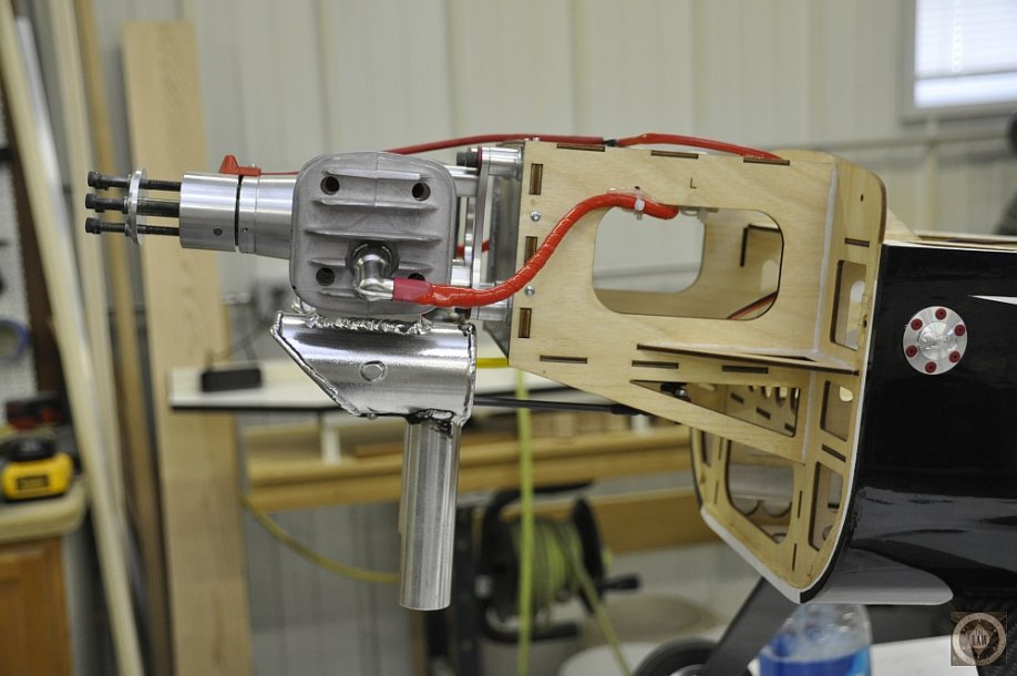

I have Jtec's on my production Viper / 100L

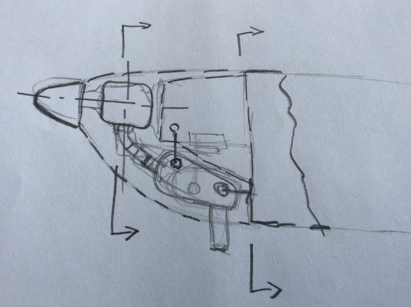

Hi Terry going to ask for a favour from you please. I would like to design my own muffler for this plane that is noise effective and will not cause the engine to overheat and loss of power. The muffler will fit below the throttle servo. The engine will have two header pipes with 90'degree elbows facing back c/w silicone couplers to the muffler. I know a person that can build mufflers light. Spoke to him and he said he would do it but needs a detailed drawing.
Ok what I need from you Terry is one side view of the engine area and two sections one at the bulk head where the cowl fits to the plane and a second section 1 inch ahead of the exhaust. Do not need all the detail just an outlines to size and fit the muffler and make the necessary hangers. I will understand that you are hesitant and I understand you can remove as much detail from the cad as you need, the cad file will never leave my position. If this is ok with you please let me know.

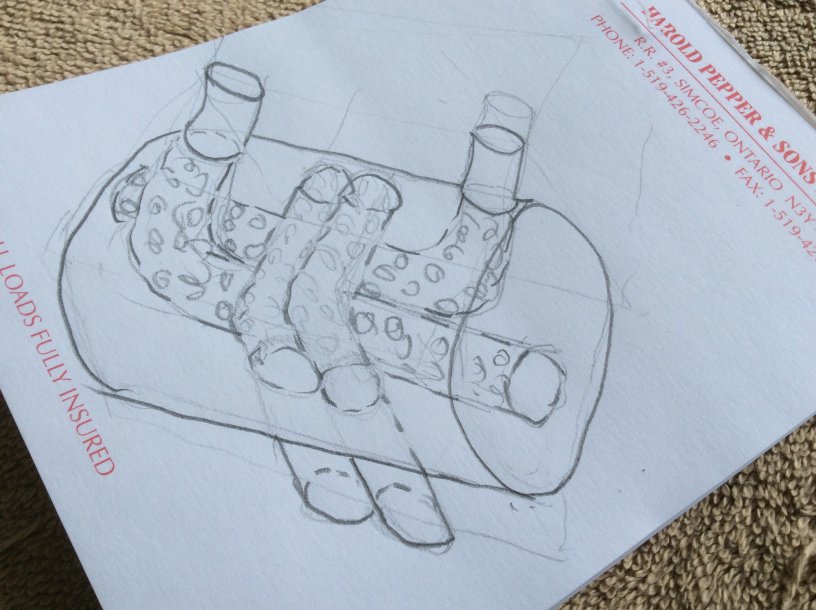

Hi Terry just doodling on how to fit a good efficient and light muffler into the Viper-ST. And how the muffler may be built. Once the sizing has been done, do the calculations for the hole size and how many holes and out let diameters. Add the necessary hangers which will be four. Have it built and see how it works. Does stainless steel steel wool exist?
Husker
You would likely have cooling issues with that setup. Pipes and cans work because they are behind the engine cooling exits.
Run this type before. This gives you one advantage. you can get the hot muffler can away from the cylinder heads and are able to duct more air around the heads. This is not much different to a pits style muffler. The Jteck muffler showmen mounted on the Da100l is very small and from my experience when a muffler volume goes down the motor temperature goes up. This muffler probably works well because it has no internals and is almost a straight through. ( am guessing to make it work) Two tune typ headers pipes are connected to the cylinders then connected to the larg volume muffler with the same type silicon couplers as used on tune pipes. This give you the ability to make the muffler lite and support it on its own. All I am trying to do is come up with a muffler that is efficient and will pass as a cannesters. To be honest I hope you are not correct because after all the work and the engine runs hot I will not be happy.
