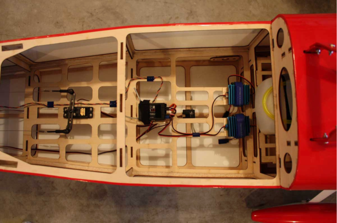

@acerc The self adjusting tray gives you one feature you can't get in the hard link. If one servo locks up, quits, or goes hard over one direction, you still have some rudder control. Even if one goes hard over one way, opposite stick will center the rudder. Also, the purpose of the third (bellcrank) arm, is to take the cable load off the servo bearings. I've seen a 40% Sukhoi kill the lead servo's bearing in less than 20 flights. Might have been a fluke, might not. The same airplane has flown many, many times with a 2 servo SWB self adjusting tray with no issues.
Do you think I could mount a bellcrank arm to the ply, I have one and could add it? The pic is from the manual.

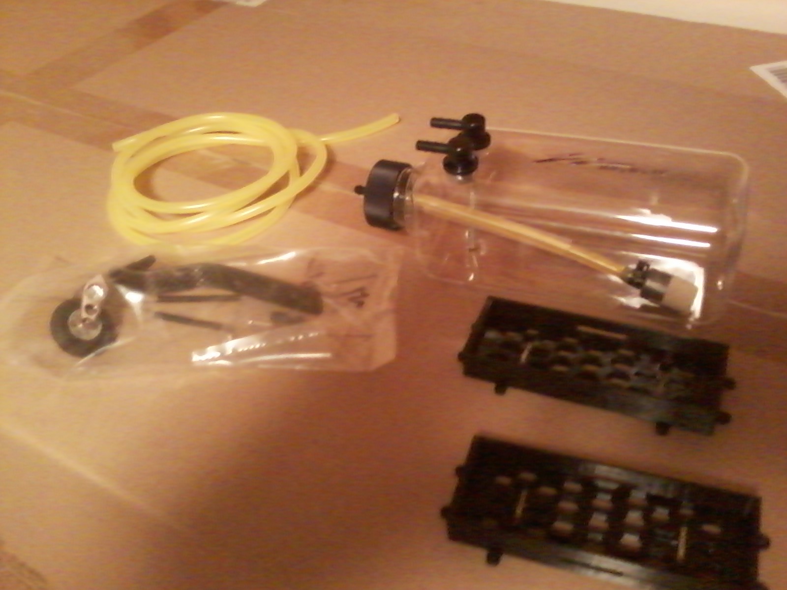

Got some more RC goodies for the 78" Extra in. The new VVRC fuel tanks are nice. The fill line is all metal and goes to the bottom of the tank. Pick up line is backed with an anti flex sleeve and has a fuzzy clunk.

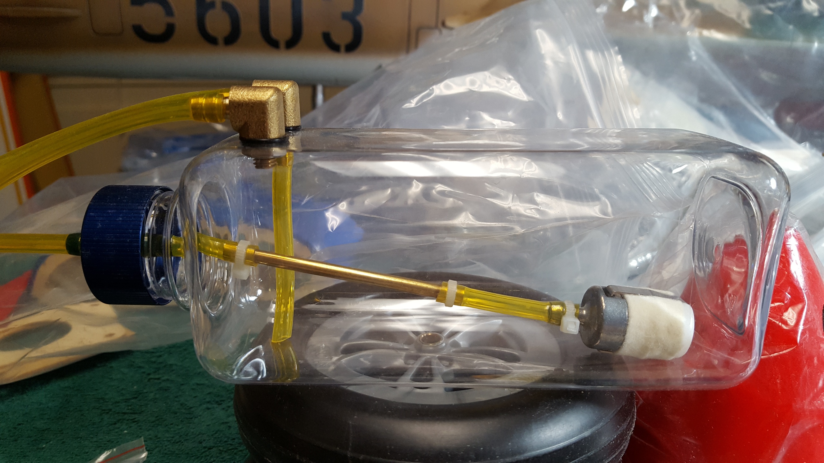

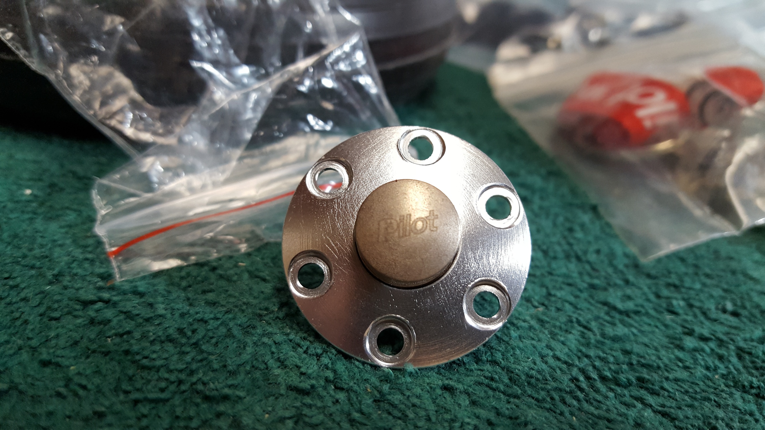

Looks pretty nice. Check out the one that came with my new Pilot Decathlon. This is the first stock tank I've ever wanted to use before. Aluminum cap, brass fittings, brass line in the tank, and a filtered clunk. The fuel dot is pretty neat too, it's uses a magnet to hold the center in, not an O-ring.
