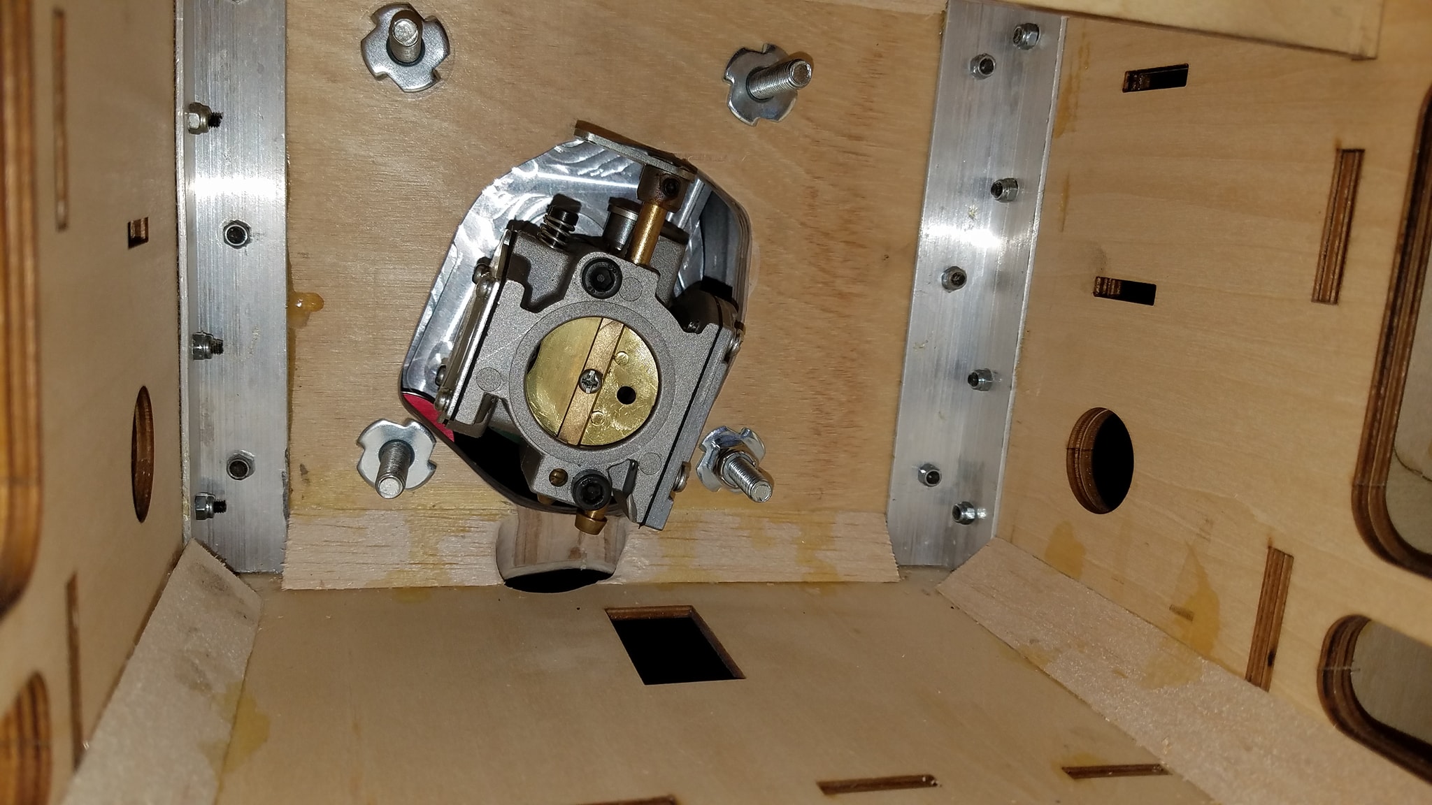

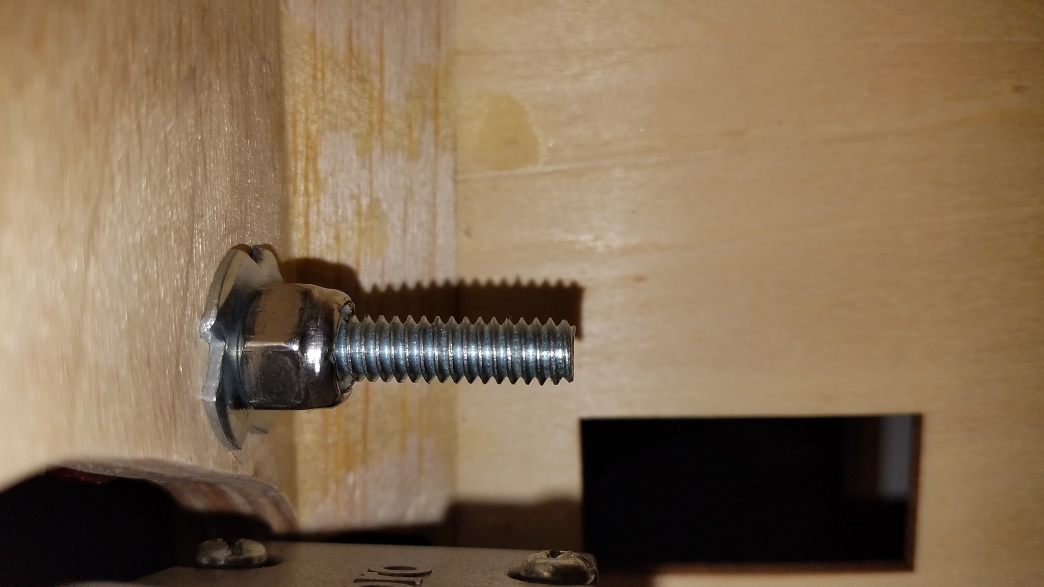

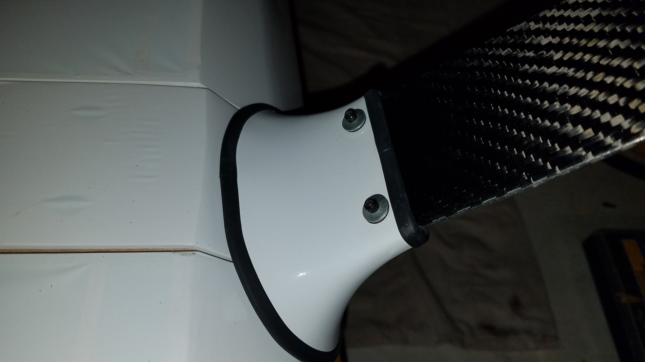

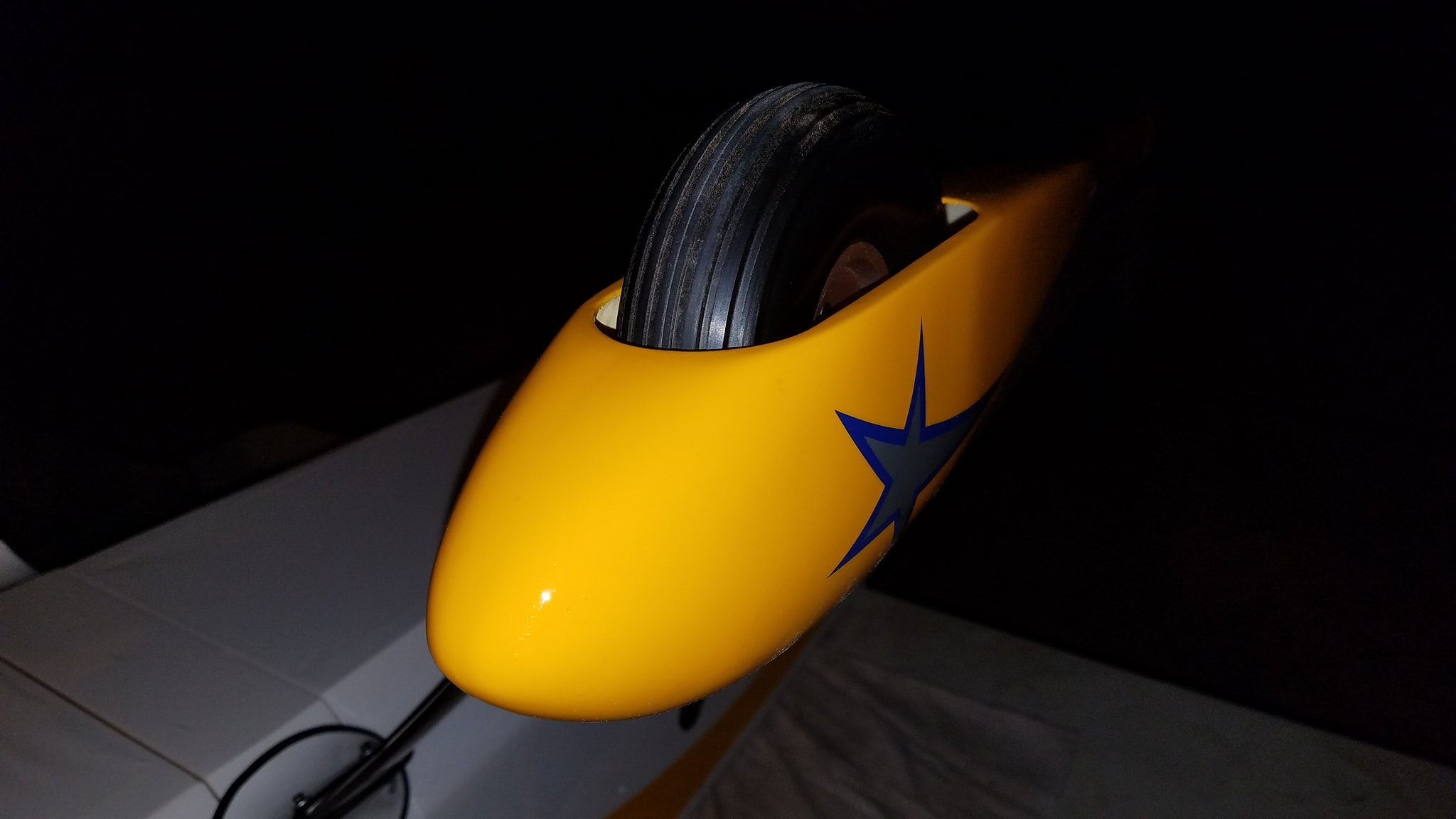

    Only a little bit of work on the 115 this weekend, I fitted blind nuts to the back of the firewall (makes removing the engine SO easy when building the airplane (since the engine goes on and comes off 10 times during the whole assembly)) and bolted the cuffs and wheel pants on.
    I like to use blind nuts on my firewalls, backed up with a locknut, as it essentially prevents the bolt from ever loosening.
    The cuffs and pants were bolted in place using 4-40 bolts and bonded washers.

    Looking at the pictures the one with carburetor coming through the firewall. Will be left just like that or will you do something to stop the carburetor from spitting fuel into the fuselage.

  9. I could be sarcastic and say that a well tuned engine does not spit back, but I won't.

    I have a Da and it is not bad but I have 3W I don’t care hoe tunes it spits fuel all the lime and quite a bit, ever since then I hav always done something about it. I was just wondering with the ZDZ engines it has rotary plate as an intake control, now that setup does not spit fuel back.
