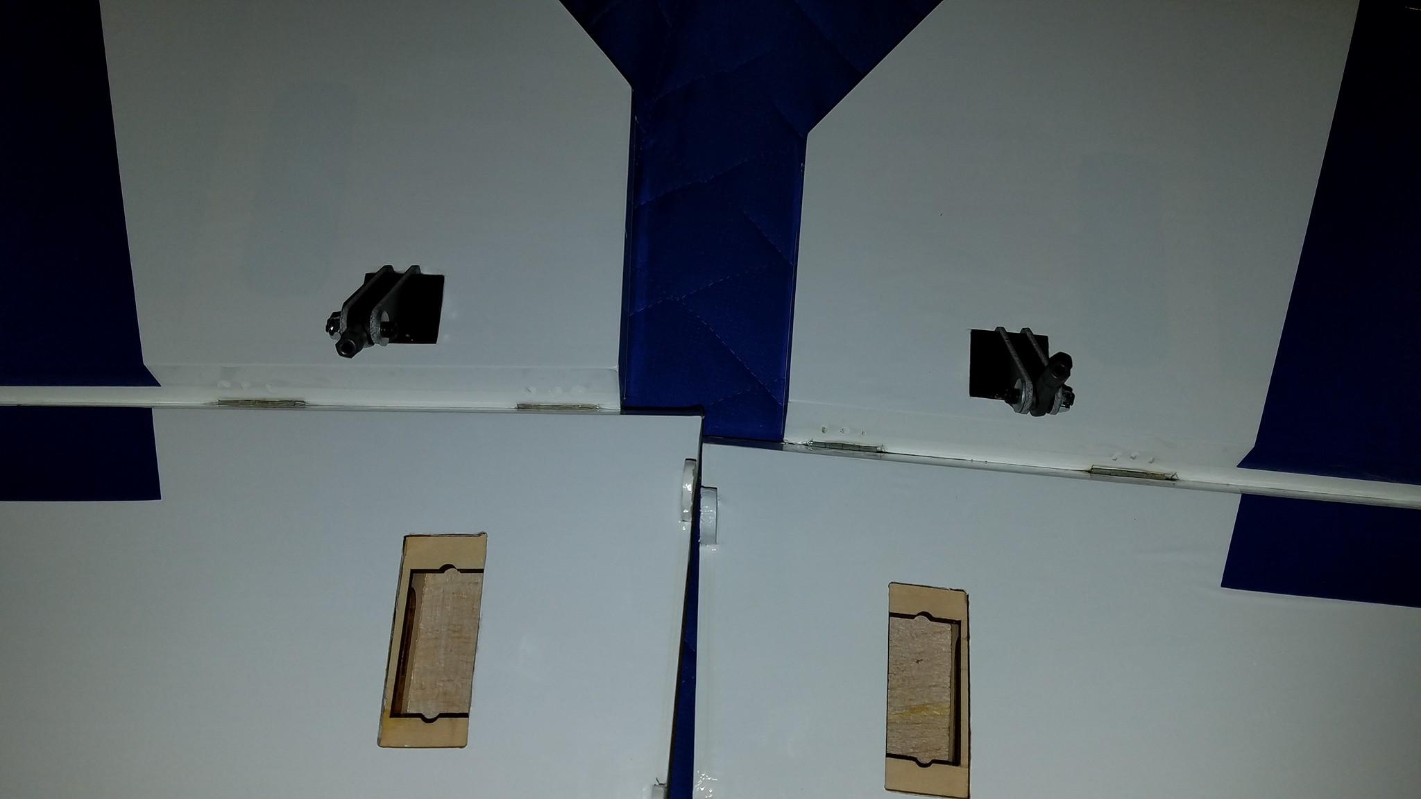

    Nothing major last night, just glued control horns to the stabs and cut out the servo pockets. Using my iron set to 600F I was able to quickly melt through the covering relatively cleanly. I also opened up all of the slots for the 2 vent plates that bolt to the bottom of the fuselage using the same method.
    I used these syringes to help inject the epoxy into the slots and spread it more evenly. They work great, and are cheap enough to where you can order a bunch and just toss after using them. I was able to mix up the epoxy inside of a plastic sandwich bag by squeezing 2 large pools of each part into the bag, then closing the bag and mixing the epoxy using the handle of my xacto blade. Snip off a small corner of the bag and pour the mixed epoxy into the syringe tube :)
    https://www.amazon.com/Easy-Glide-C...qid=1524069881&sr=8-3&keywords=curved+syringe
    The only mod I did to the syringe was slice off about 1/8" of the tip of it to open the curved tube up enough to let epoxy flow more freely.
    That's 2 surfaces and horns done, only 6 more to go :oblong:

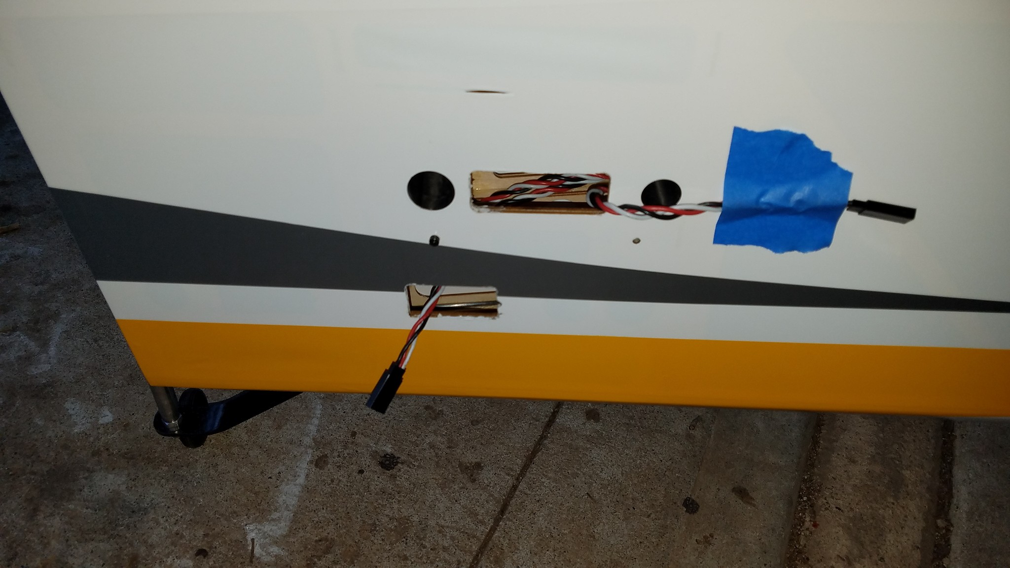

    Little more work on the Laser tonight. Chad Wilson at TDRC coming through with the goods as always!

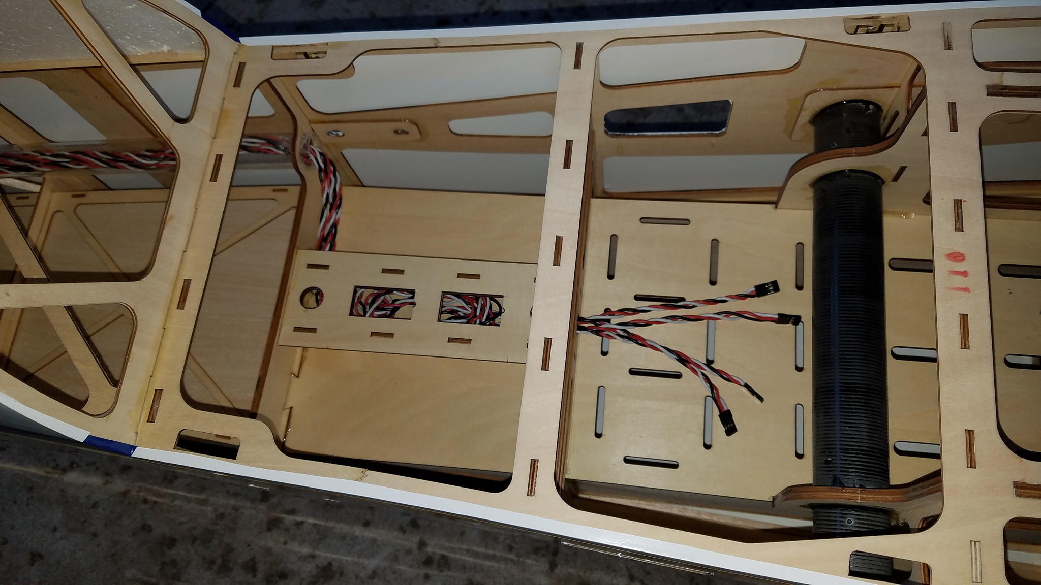

    Cut out the holes in the fuselage for everything, and ran the extensions to the tail.
    Tucked the excess wire into the servo tray.

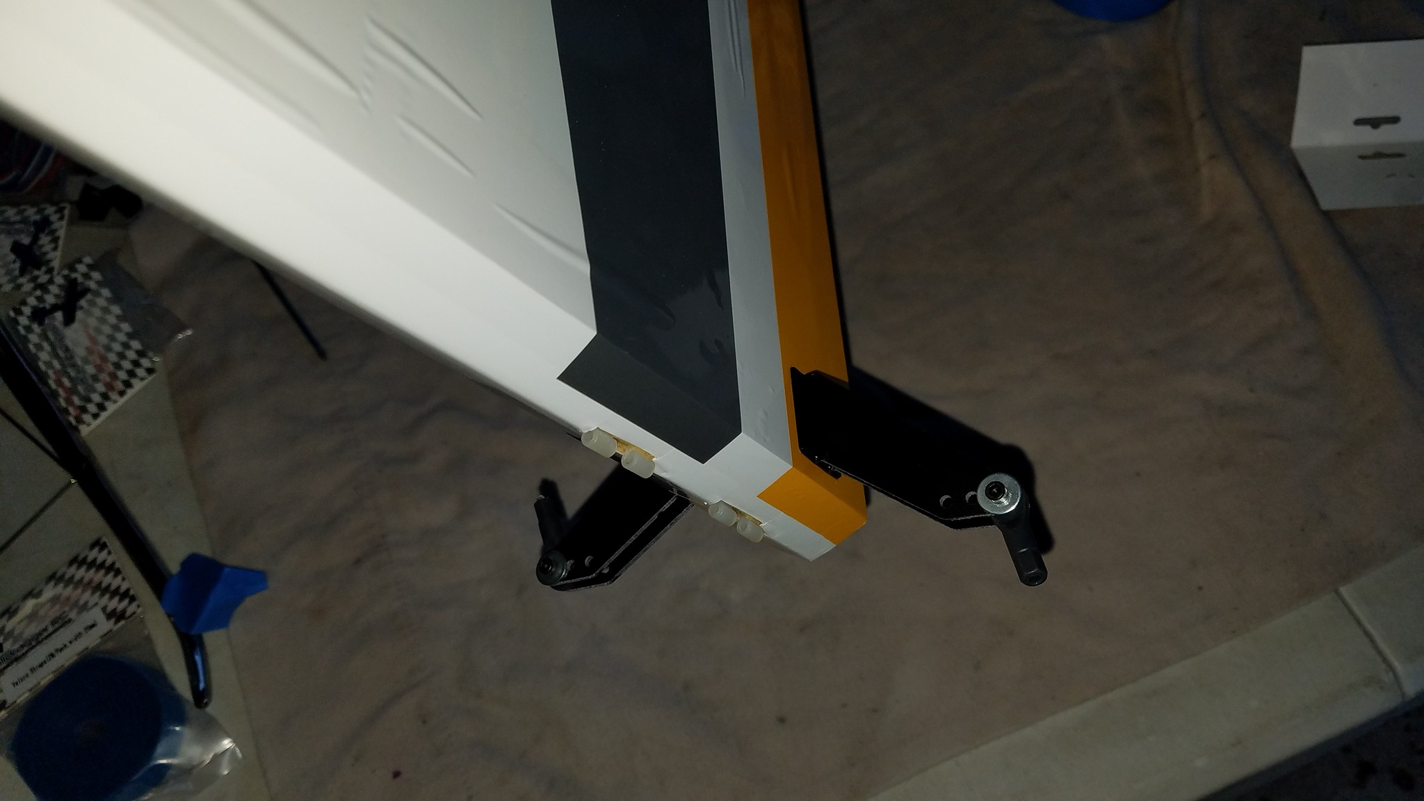

    Epoxied control horns into the rudder.

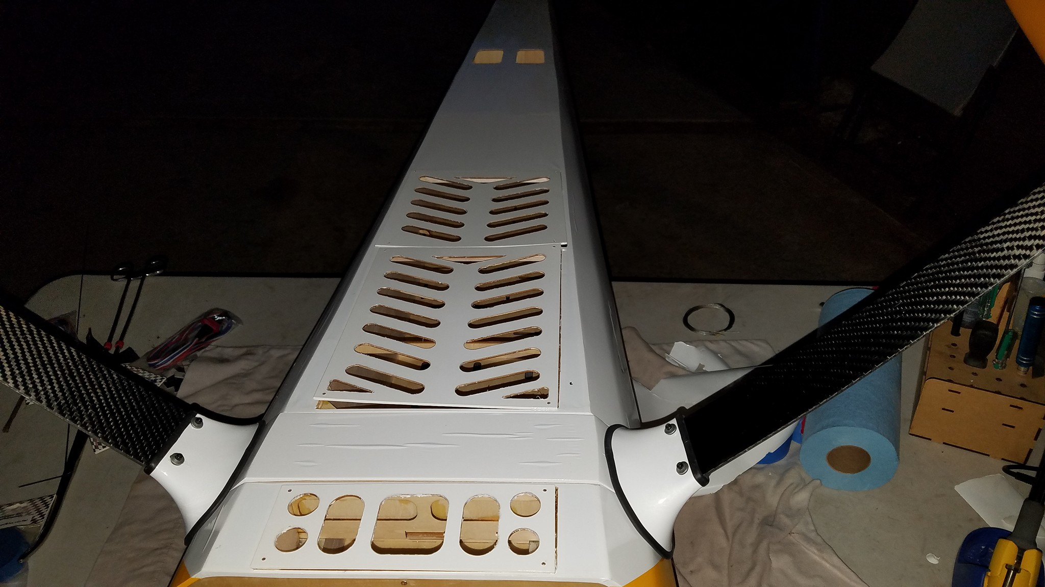

    And got the holes in the belly cut for the vents.
