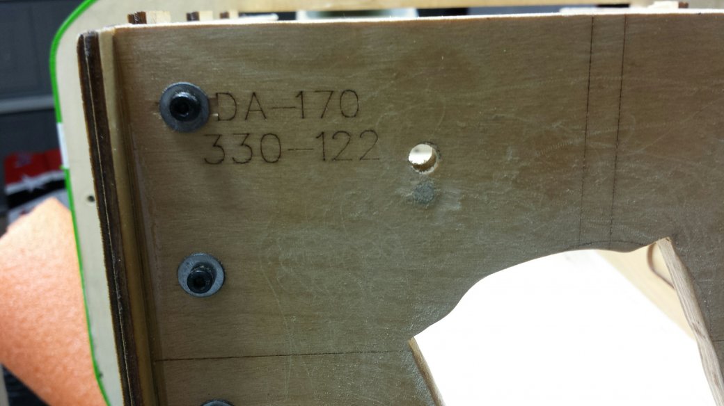

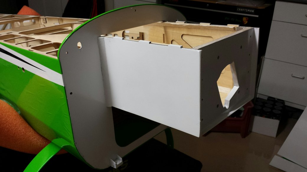

Strength is not an issue as Terry say's as long as you use fender washers. I also drill a 1/8" hole next to the engine bolt hole and epoxy a dowel in it to keep the wood from crushing under pressure from tightening the bolts. I have also found the engine has a better atmospheric pressure with the carb in the fuse so transition is smooth.
Flyrcjoe
I have some questions about the rear carb. An engine this size does it weaken the firewall cutting a hole that size for the carb? Are you guys cutting holes in the fuselage for needle adjustment?
Yes you do have to cut a hole in the firewall. Yes @Terryscustoms and @Spats are right on with using the fender washers and the dowl trick. In my opinion you should be doing that to any motor. My wife was out back helping me toon and she actually commented on how nice it is that I am very clear of the prop as I am tooning it. Unlike bottom carbs where your hand has to be right next to the prop, with the rear carb your hand is at a safer distance from the prop.

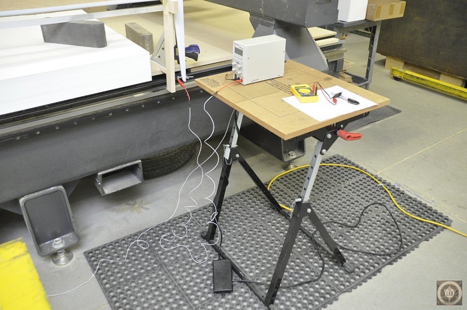

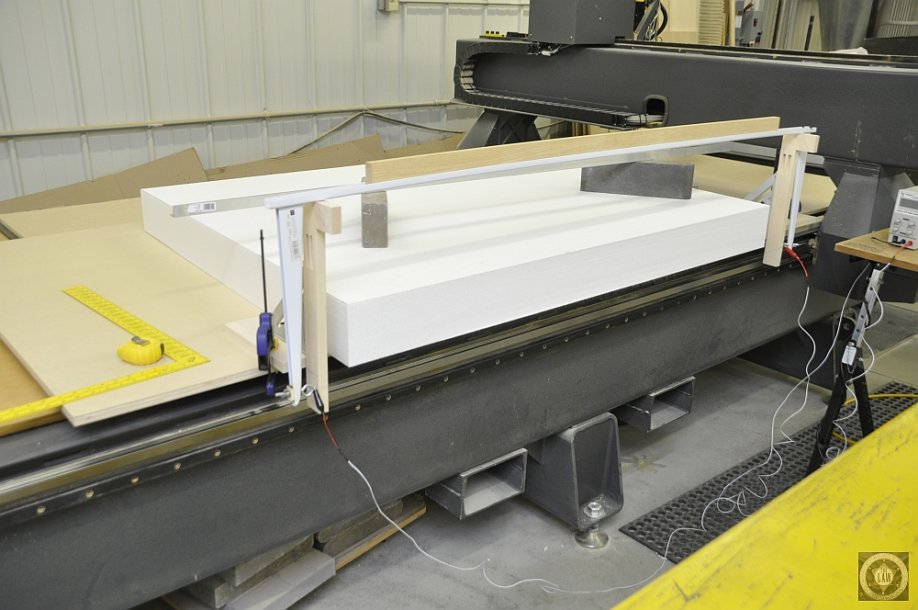

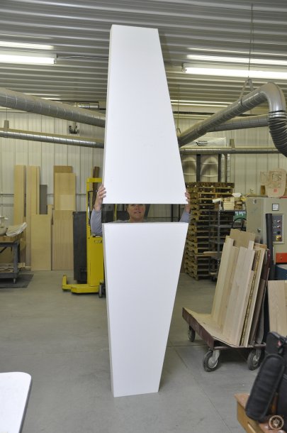

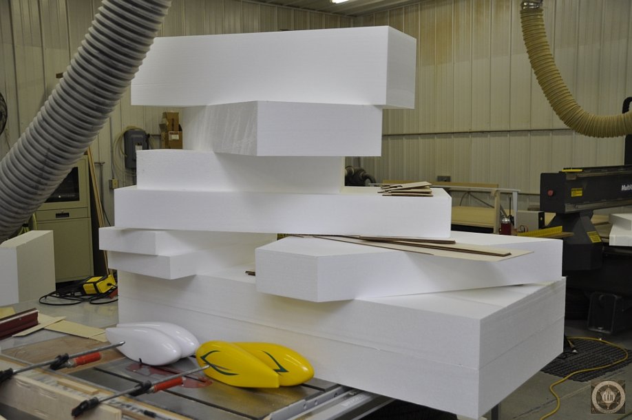

Started cutting form for my new 180cc bird, I have high expectations for this perdy little monster (the ZDZ180, no my plane or @thelaw)
