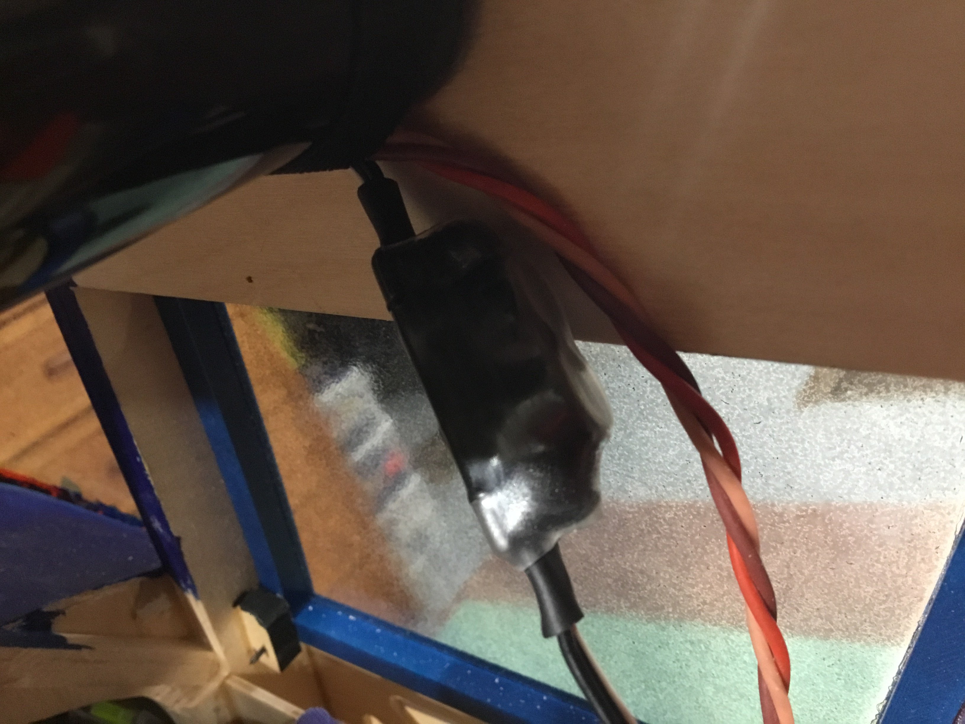

Just plodding along and doing all the wiring and making all the extensions as required. Made my usual voltage drop checks and found I needed to add some servo boosters for the 2 outside ailerons had more voltage drop than I would like so add two boosters for the ailerons the rest was ok.
