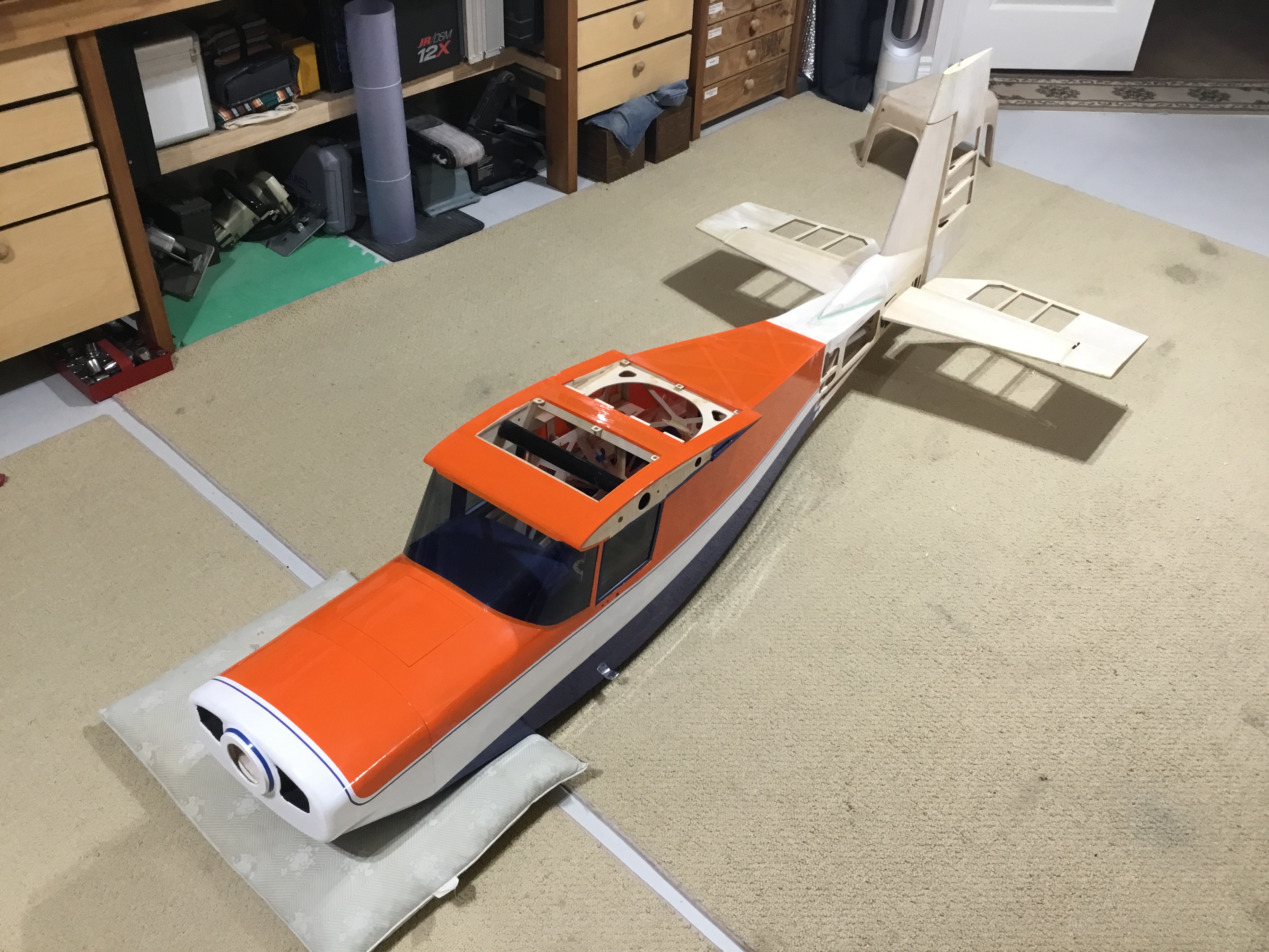

Yes it was a big disappointment, spent a lot of time and effort to build the plane. and flew like crap, and could not fix it. Hopefully this change will do it if not into the 🔥 pile.

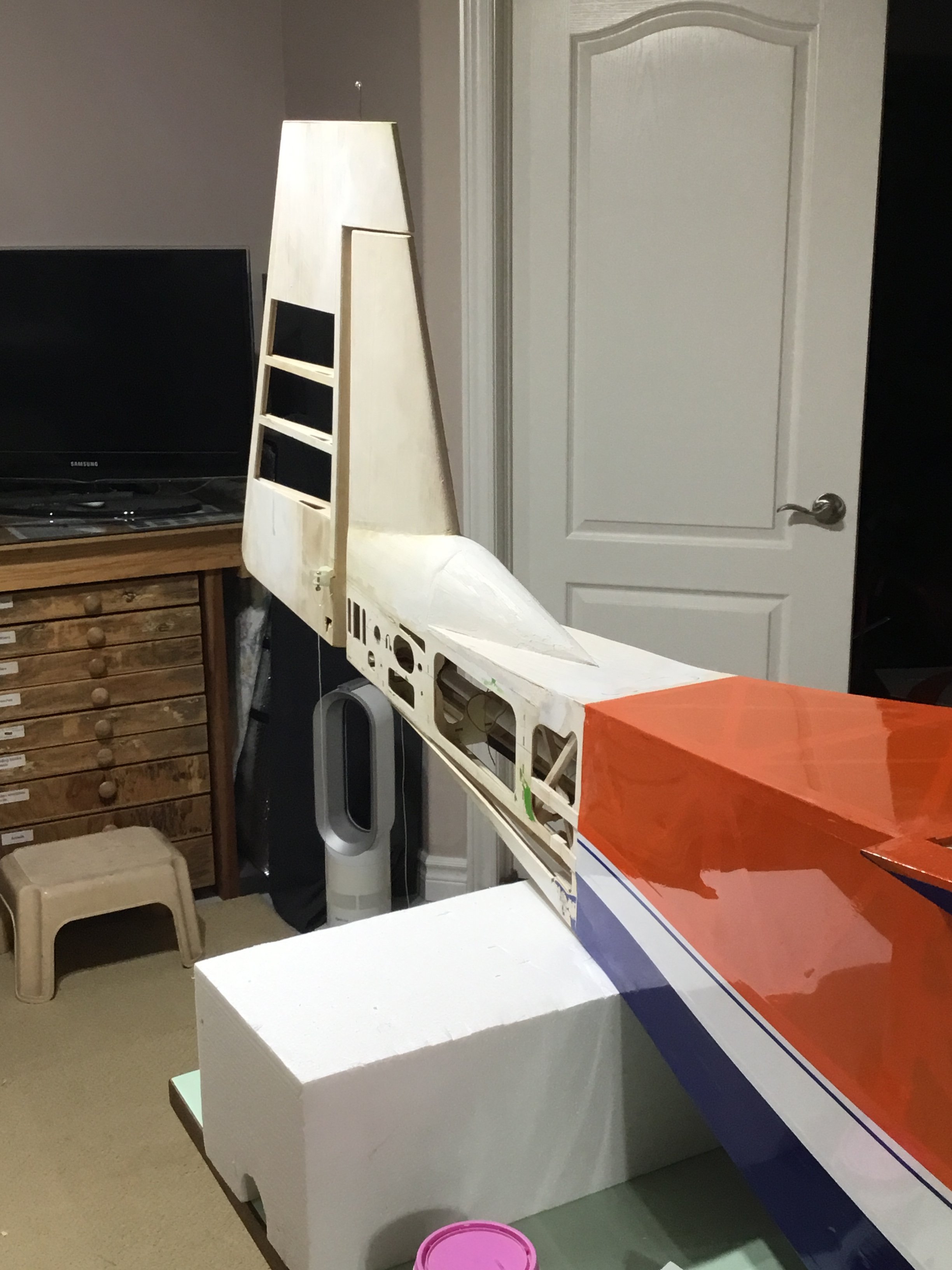

The tail section is now connected and sturdy. Now just have to try to blend the leading fin of the rudder into the fuselage. It will be difficult to make it look good but as long as it flys properly I will be happy. As soon as the rudder is done I will take a picture.
Fixed a lot of landing gear and bashed front ends of planes but this is first putting a tail section on a plane, not as easy as I thought it would be.
Well it’s all connected and the rudder blended into the fuselage, difficult to blend a round section into a square fuselage. Now just have fill some holes sand everything smooth. The rudder still needs some work.

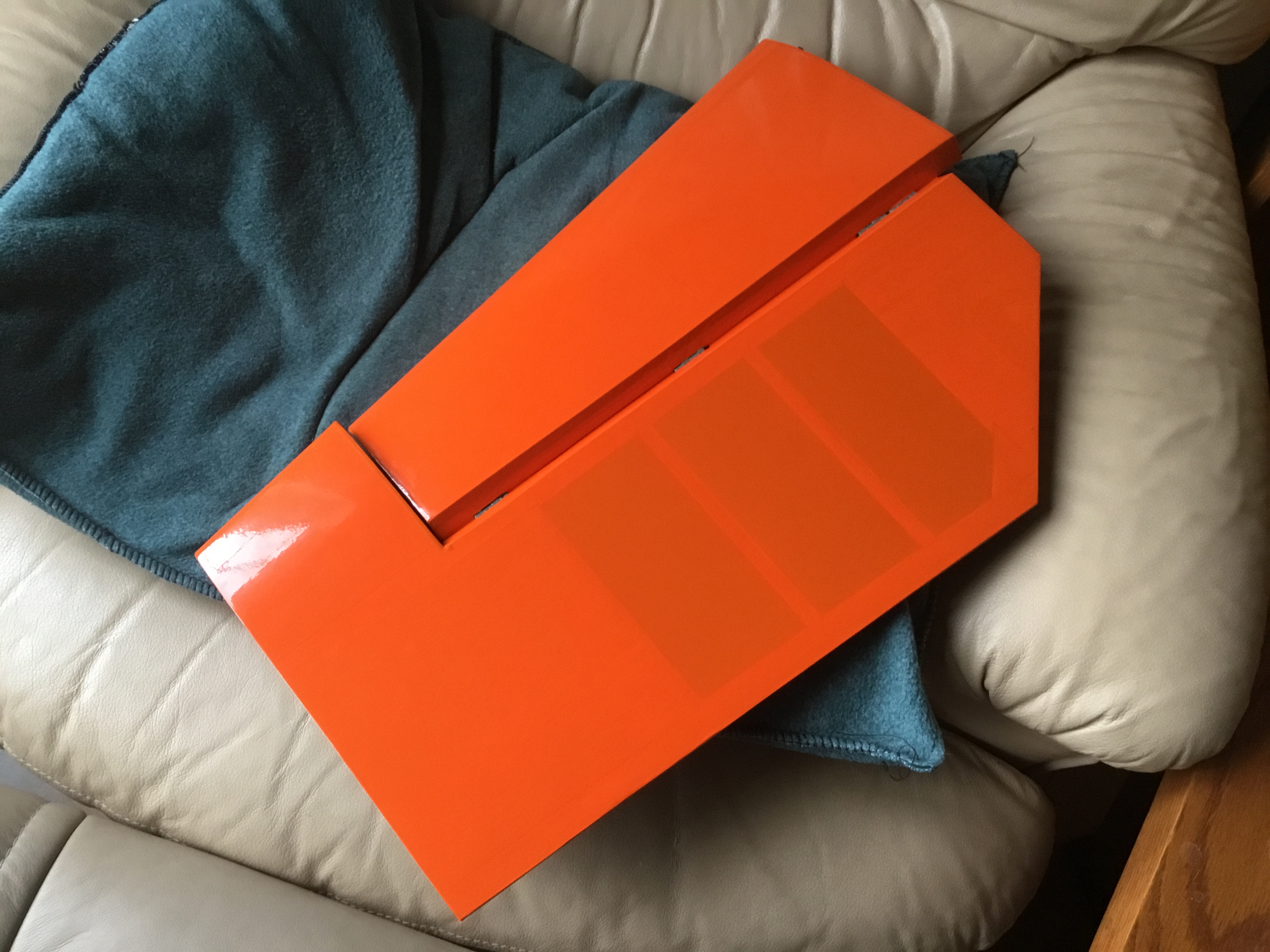

Working hard on getting everything covered. All I can say is I have always used Ultracote and just got use to how it works and stretches. But all I can say is the new stuff is not the same still works but different. Also if buy the same colour and at different times the colours change not a lot but it is noticeable.
