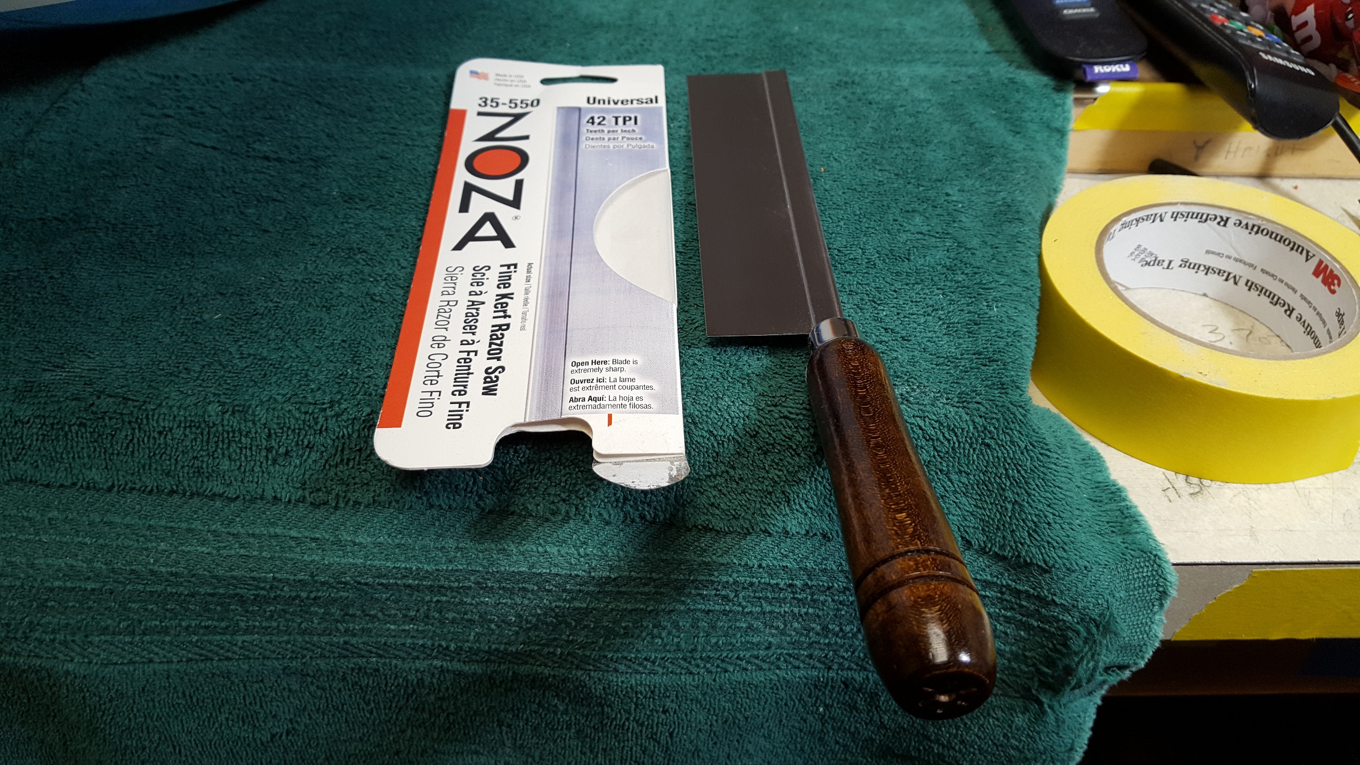

Cowl splitting can be a bit unnerving, but not really all that bad.

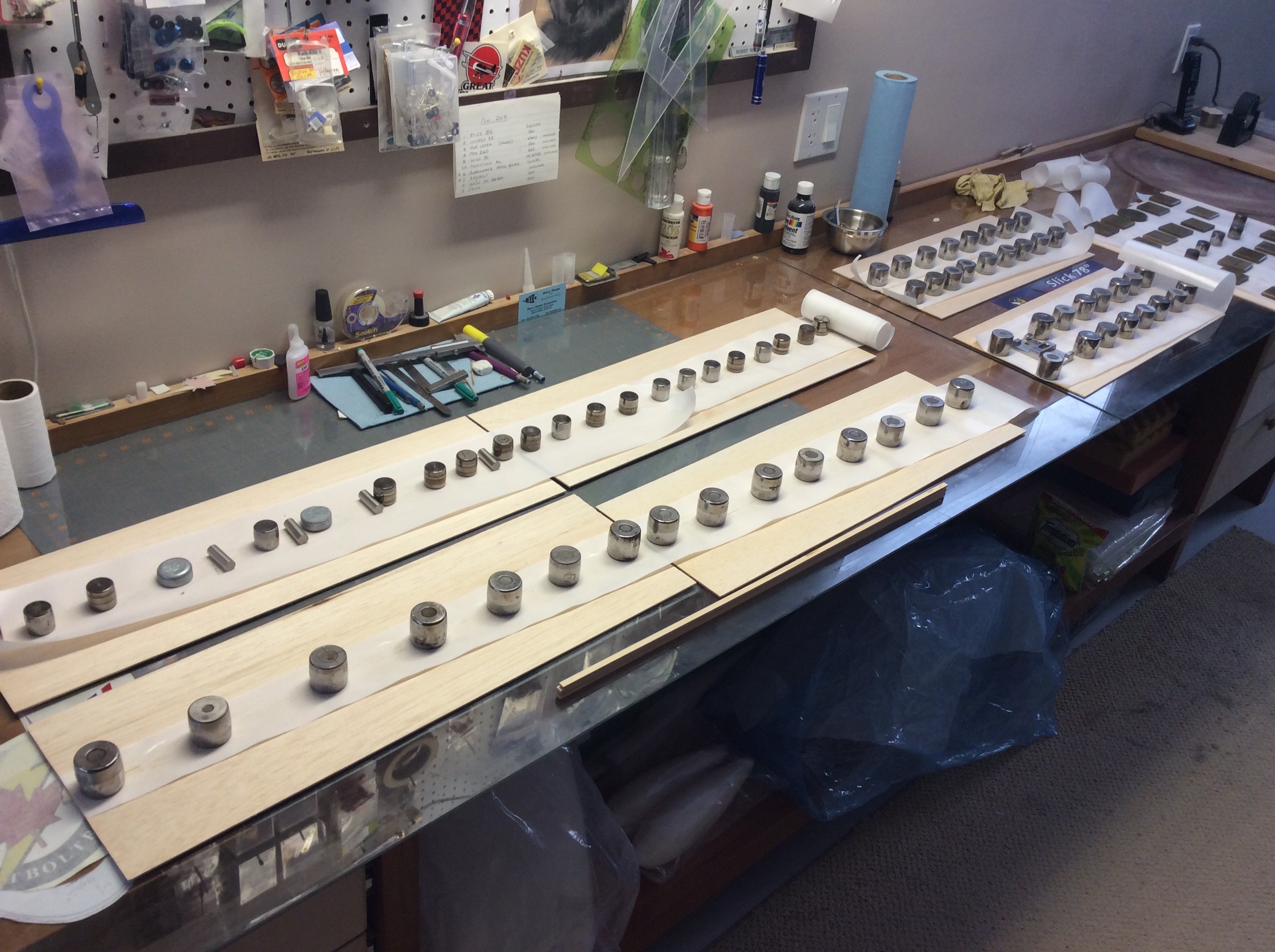

As BalsaDust said let the glue fly. Well today I made start and would you know it had to make the sheeting for the stabilizer and rudder first. Well it is edge glued and will sand it smooth tomorrow on one side and rough sand the other. Getting all the edges straight and no gaps takes time and patience.
I use wood glue because it sands better and smooth, not left with hard ridges.
