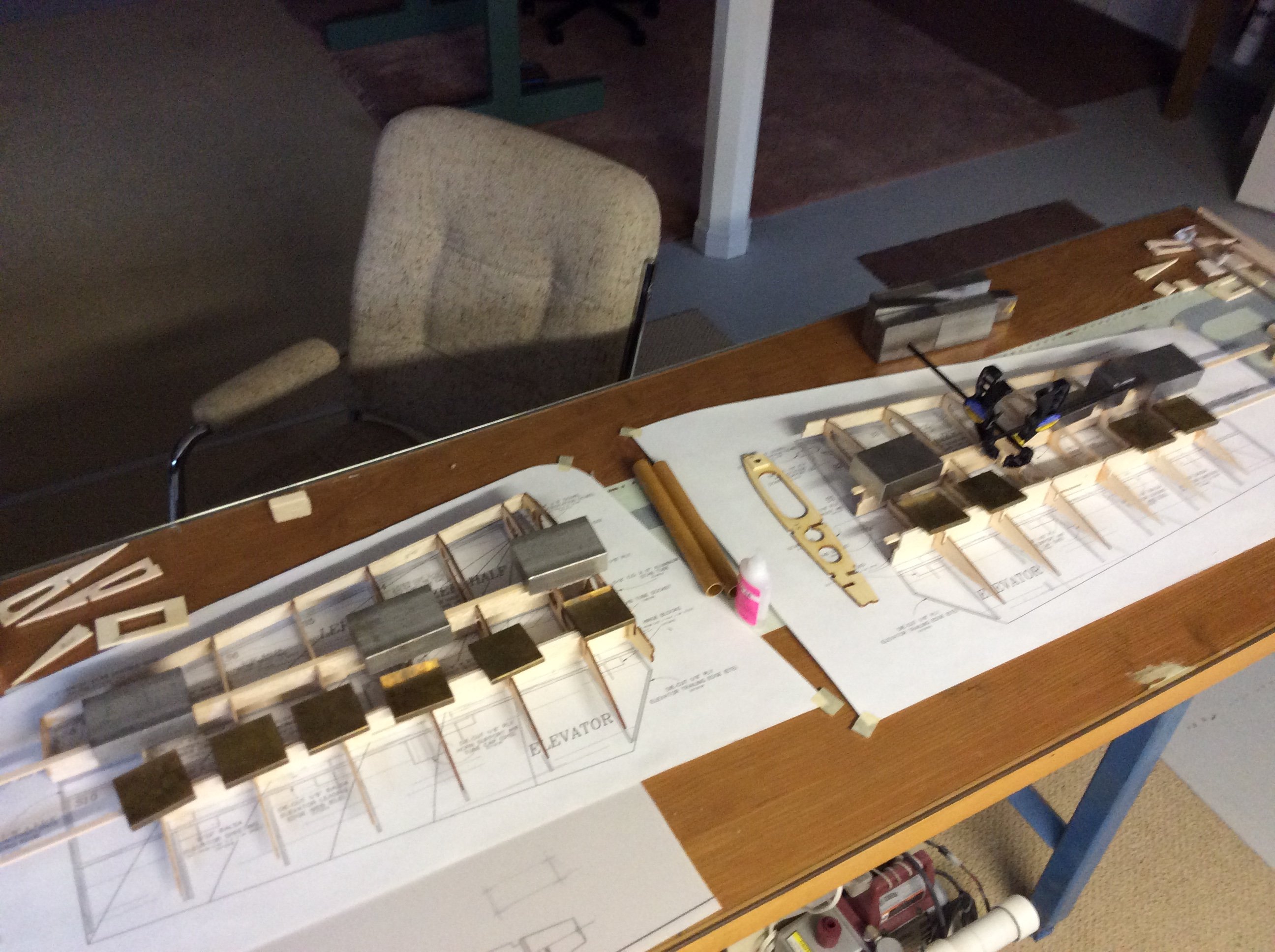

Got a little work done on the plane. Built the two stabilizers well not built I started the stabilizers. Must have snapped half the ribs getting it setup a little frustrating but the structure it together straight and square just have to finish a few small things and then I can start to sheet the stabilizers. Have to make two S1 ribs with tabs so that the stabs can be bolted in from under the stab. Change from the original design, just like it better than small screw through the tube.
The screw through the tube works fine, but it's easier to get a tight fit with tabs and bolts through the end rib.

Spent some time cleaning up and sanding all the sheeting for the stabilizers. Cannot make up mind if it going to be painted or Ultracoat, that will all depends on the final weight. If it is going to be painted I only need to sand it down to 150 but if Ultracoat down to 320 or 400. And also make two new S1 ribs so that they can be bolted to the fuselage.
Question, if i glue the stabilizers in I can do a nice radius fillet between the stabilizers and the fuselage.
