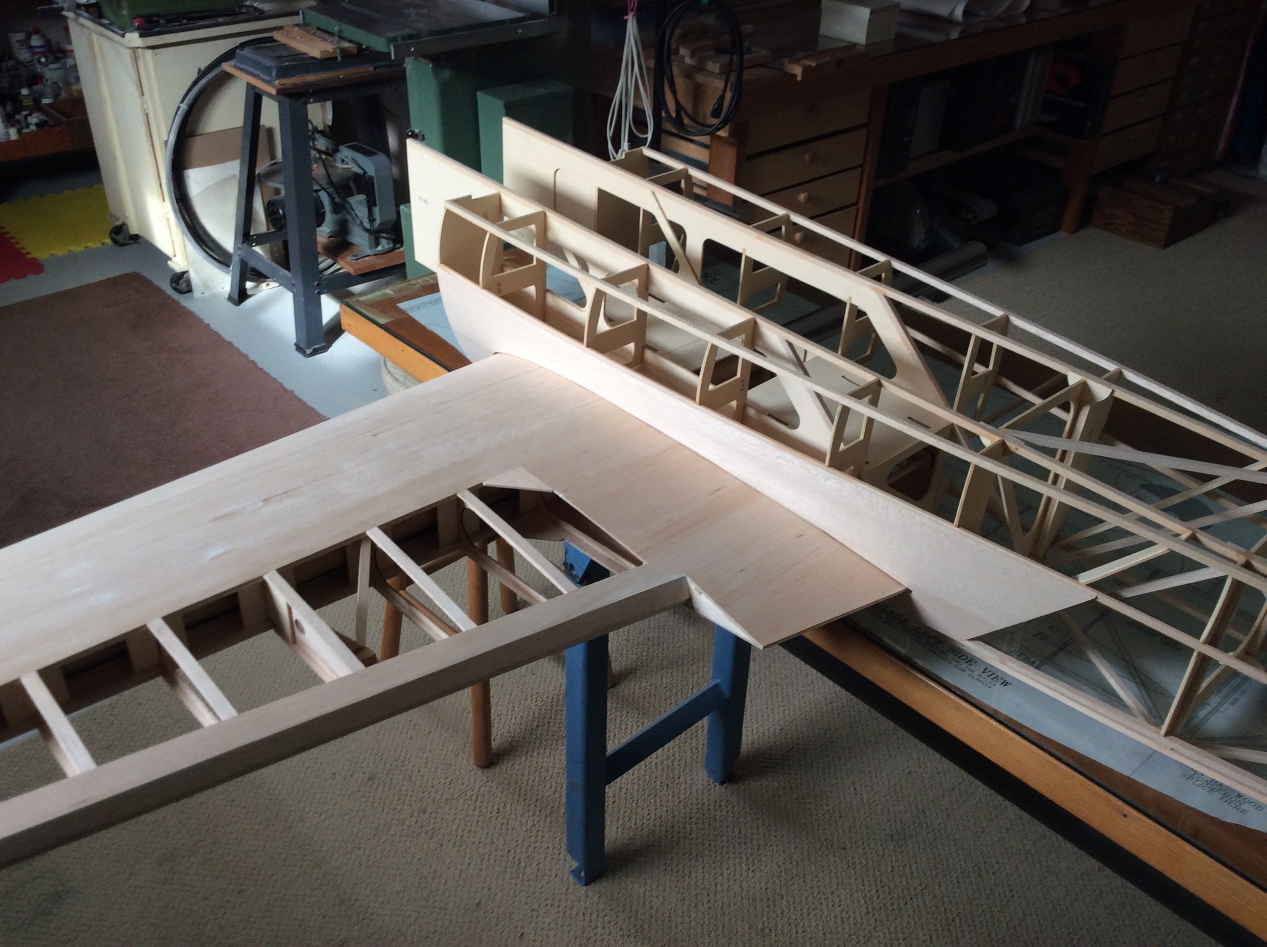

Ok got the side sheeting on the one side and the wing fitted all I will say it really tried my patience. Will not start the other side till I have a better way of doing it. Cutting the opening for the wing was difficult and extremely time consuming. I must taken the wing off 50 times measured cut a little measure again cut a little and on it went. It’s done but there has to be an easier way. Looks ok but 2 hours to get the wing to fit the fuselage.
