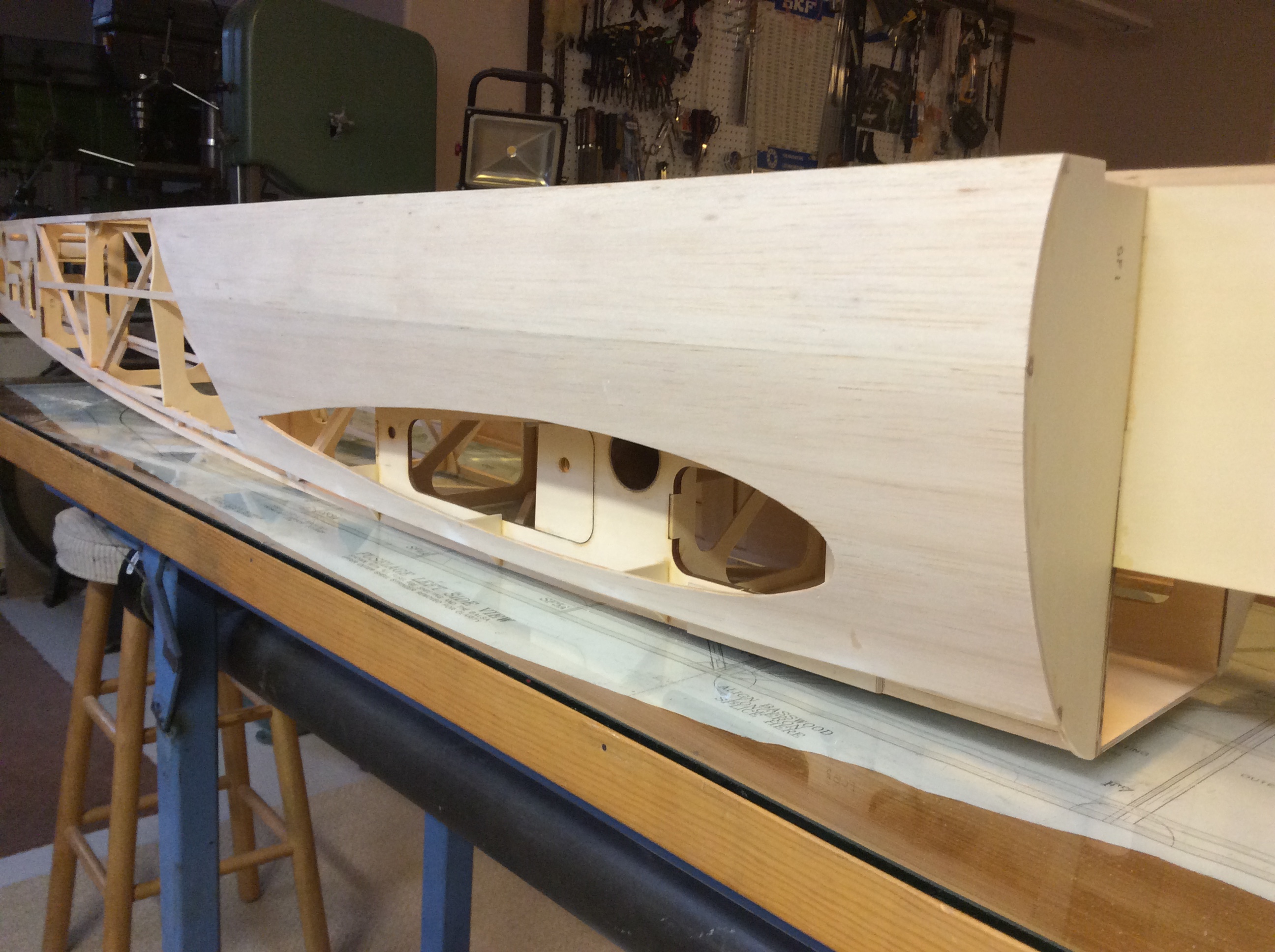

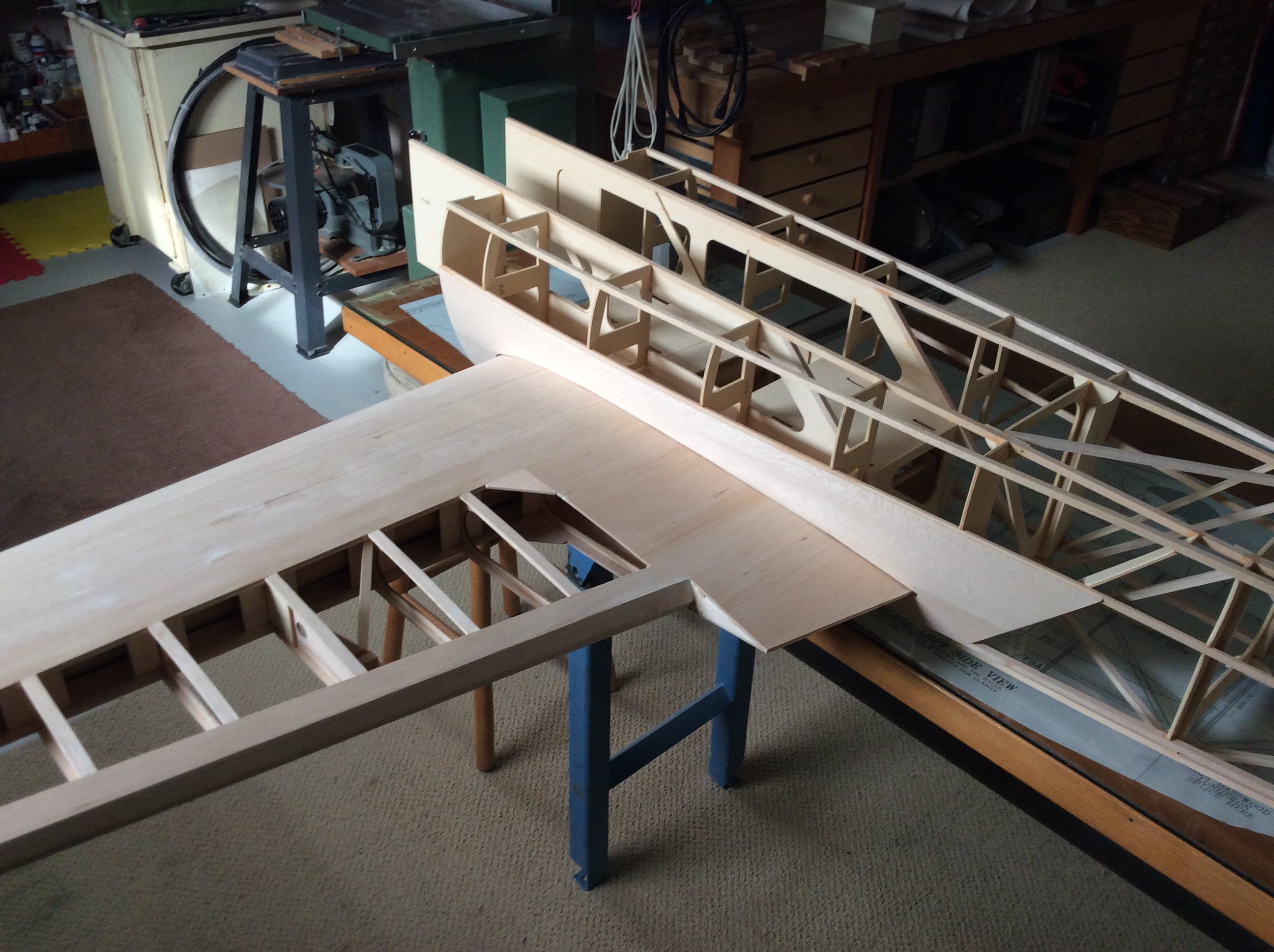

Ok got the side sheeting on the one side and the wing fitted all I will say it really tried my patience. Will not start the other side till I have a better way of doing it. Cutting the opening for the wing was difficult and extremely time consuming. I must taken the wing off 50 times measured cut a little measure again cut a little and on it went. It’s done but there has to be an easier way. Looks ok but 2 hours to get the wing to fit the fuselage.

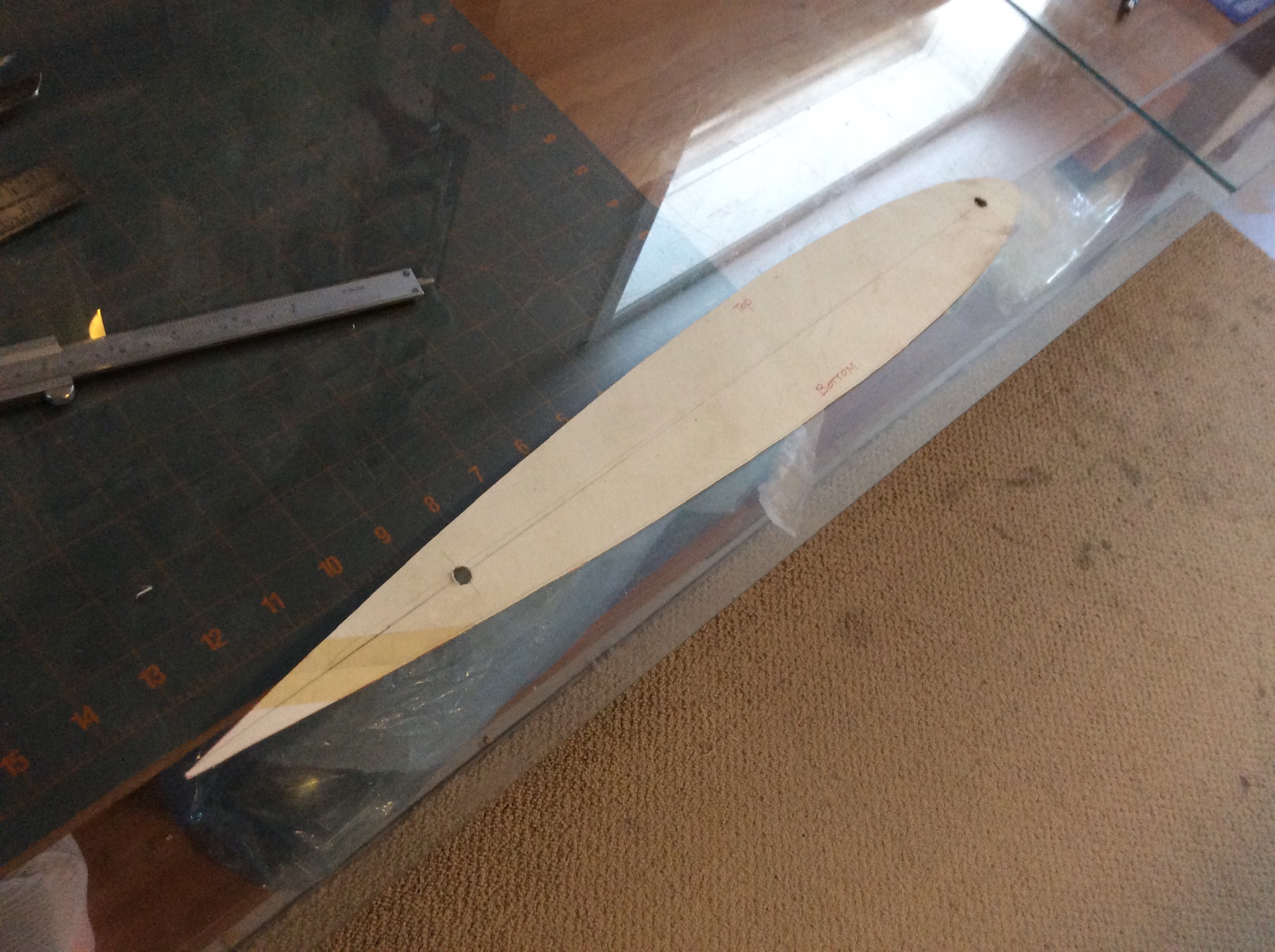

Use the wing to make a template that slides over the wing tube and rotation pin. Slide the template on and mark the outline, then cut it a quarter inch small. Then slide the wing on, up to where any point butts the sheeting, then use a 1/2" putty knife with the corners rounded to slide on the wing surface against the fuse sheeting to mark the wings outline perfectly.
I actually skip the template part, I slide the tubes through, slide the wing on and then use the putty knife. Some areas may be quite a distance so I do the close up parts then slide the wing further on to mark the rest.
Well from the looks of it I would call it a success, nice.
@acerc thanks for that like the template method. I did slide the wing on the tube and try to make an outline with the wing but the wing taper was what made it difficult.
Thanks but it took a lot of work and thinking of a better way of doing it.

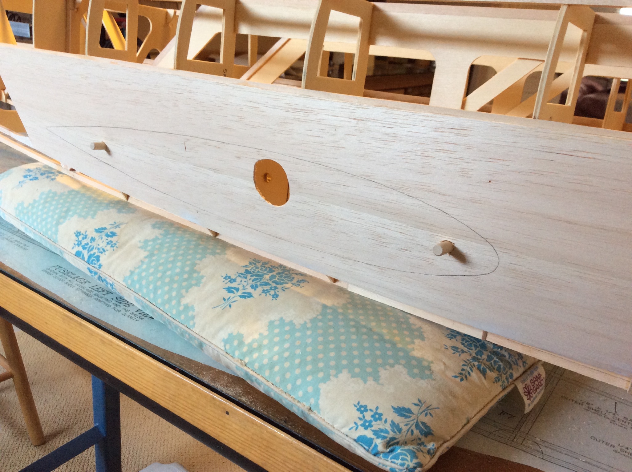

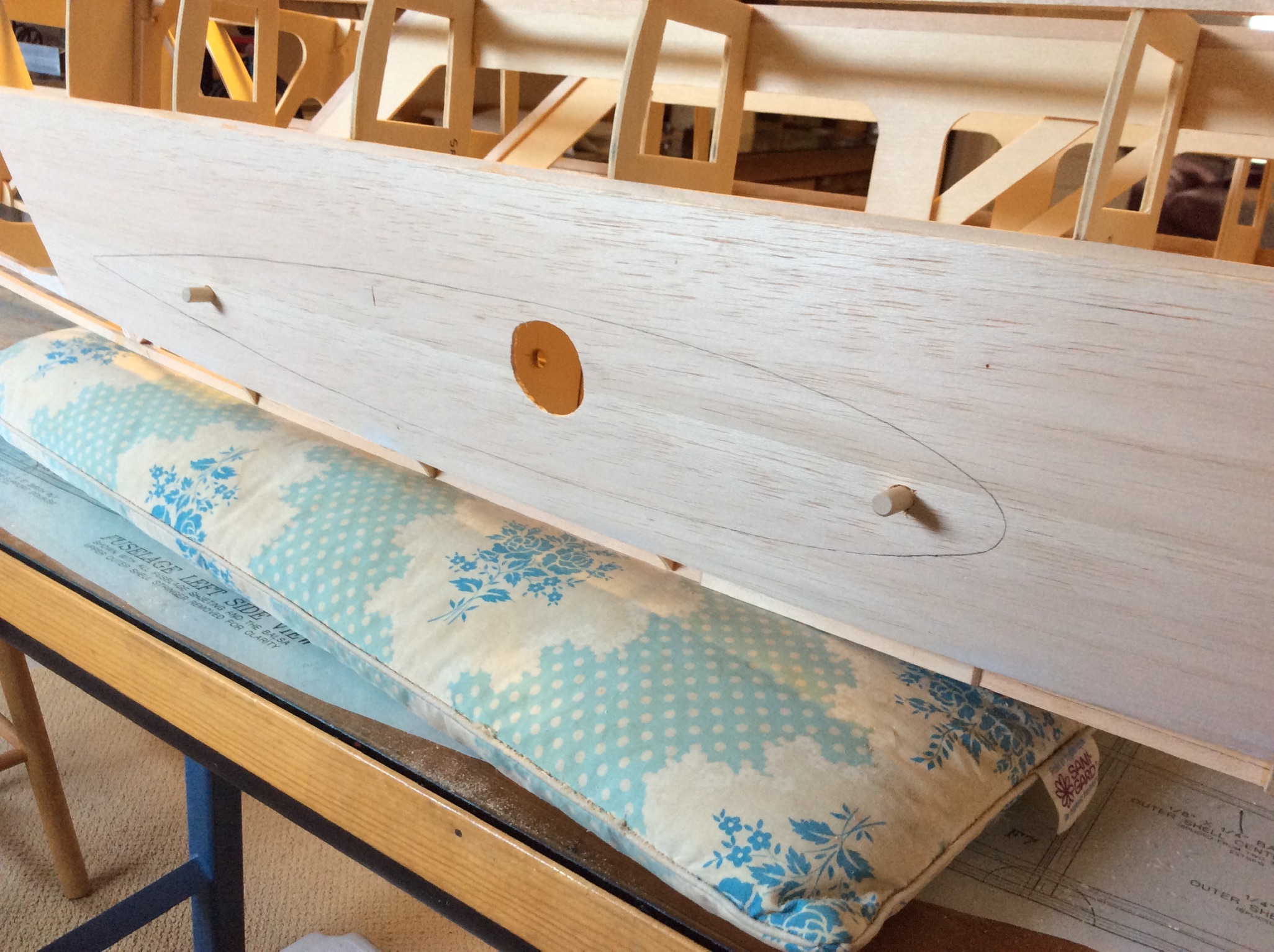

Second side sheeted and holes made for the template. The template is made from the wing. Template fitted to the the fuselage by the 2 wing anti rotation pins. Marked the out line onto the fuselage now close my eyes cut it along the line and see what I end up with.
View attachment 109798 View attachment 109799
@Snoopy1 I have been out for a week on work travel and you go and finish the plane without me !! It looks to be coming along well. I did not like cutting the sheeting holes for the wing, took me forever and I still did not really like the outcome as it does leave some gaps around the wing as I mentioned before. What is really important though is to add the 1/8" square balsa support around the opening (on the inside of the skin). This strengthens the opening and helps reduce hangar rash, while also making it a little easier to cover as you have more surface to adher the covering too when you round it into the skin.

@MuttsyFlyer , Thanks for all the tips and guidance it is appreciated. Yes the sheeting is the worst I have ever had the pleasure of working with but this time I said I am going to use what is supplied. Every time I buy a kit I end spending hundreds of dollars on replacing the wood in the kit and all that bad wood gets stockpiled and never used. Cutting out the holes for the wing was tedious buy it is done now. And yes the turtle deck is going to be a challenge.
The picture is of the one side sheeted and the wing hole cut. Any all the additional support is glued on the inside of the sheeting, made a big difference.

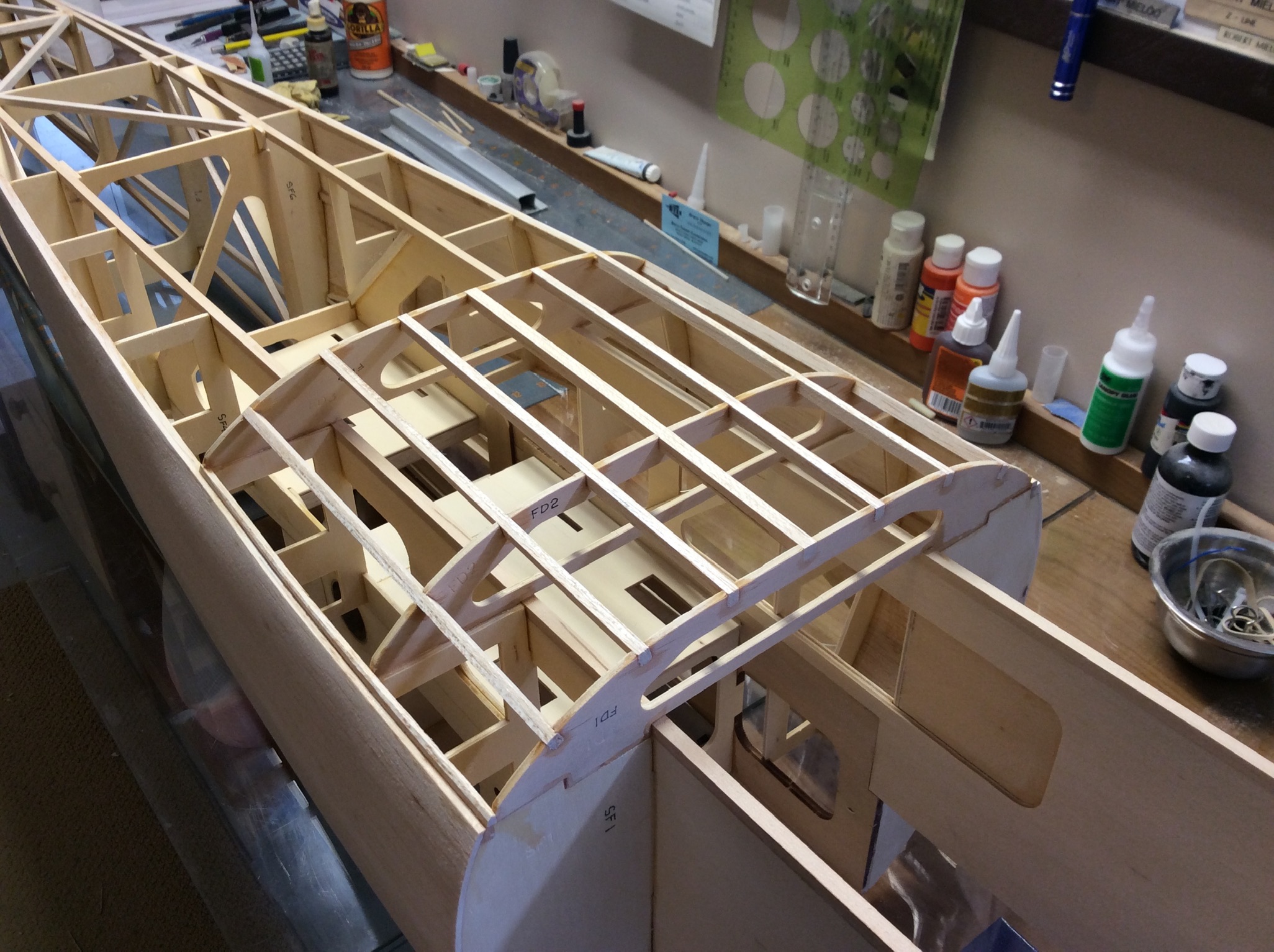

Well the weather is just not giving up it is snowing right now NUTS. well started the front deck structure it was straight forward everything fitted and glued in now the tough part sheeting the front deck it will take some time and a large quantity of water but we will see. Try to sheet the front deck with almost hard wood should prove interesting.
