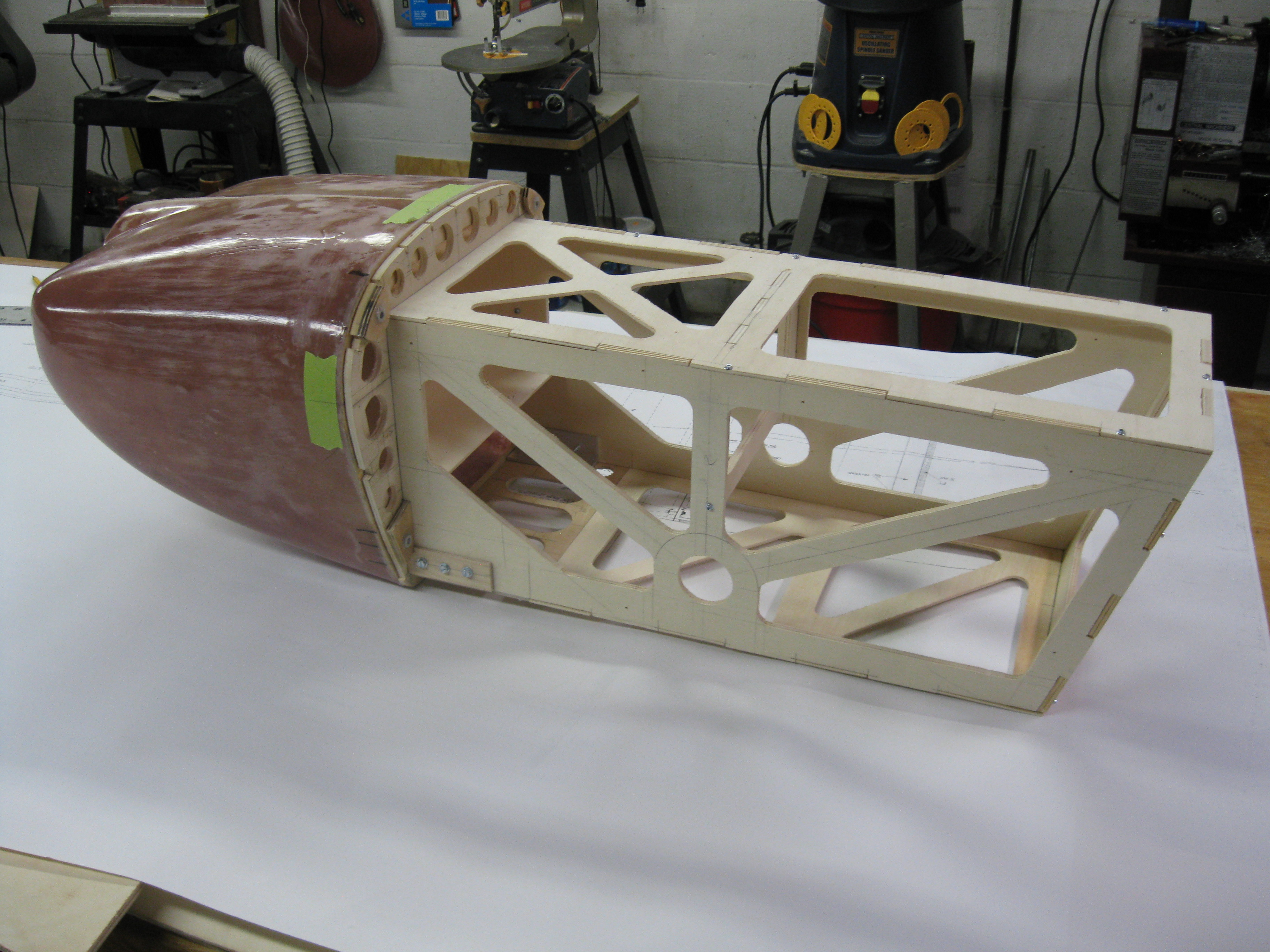

I like to mount the cowl square to the fuselage, matter a fact I normally start by mounting the cowl to the firewall before starting to build the fuselage, what is your reasoning for having the engine in hand? Maybe I'm missing something?
I can remember years ago I built an Ace 33% Extra 230 kit, Quardra 52 with a Byron Purr Power muffler, the engine box was redesigned for the muffler mount, I guess my measurements were a little off, when the cowl was mounted to center of the spinner, it was pointing left and was noticeable. I wasn't upset when I put it in. From that day I began mounting the cowl to the firewall first. Attached is an example.

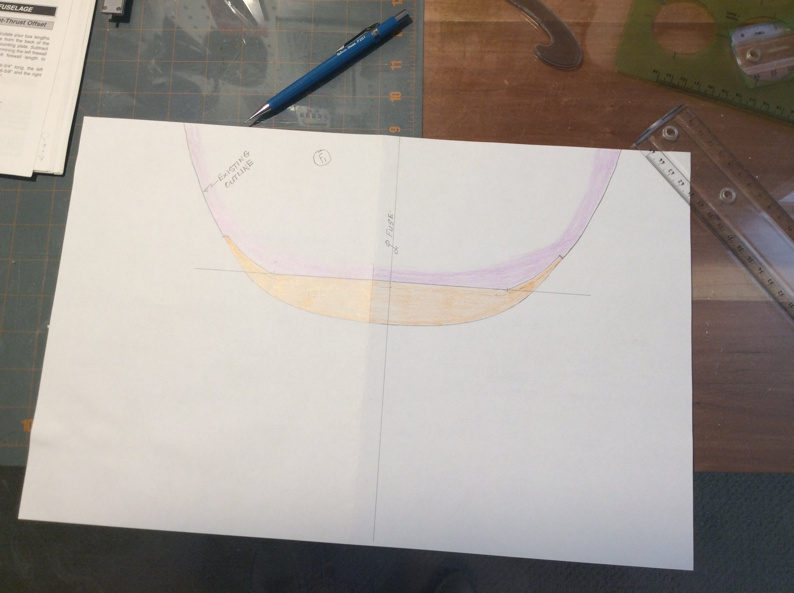

Ok as you gentlemen know my cowl is considerably bigger than the F1 bulkhead when I fit the cowl to the bulkhead there is about 3/16 of an inch clearance all the way around or there about. So been thinking about that because it has been bothering me because it really takes away from the lines of the plane and the finished product would look like hell.
So if you look at the picture of the drawing I made of the bottom of bulkhead F1. The out line of the bottom of the bulk is in purple. There is a added section in orange added to the bottom of F1 and the shape is blended in to F1. If I do this and add that piece to the bottom of F1 it will take up the excess cowl material. Will have to do some shaping to blend that backwards into the fuselage but that can be done once the extra piece is added and the cowl fitted. What do think.
